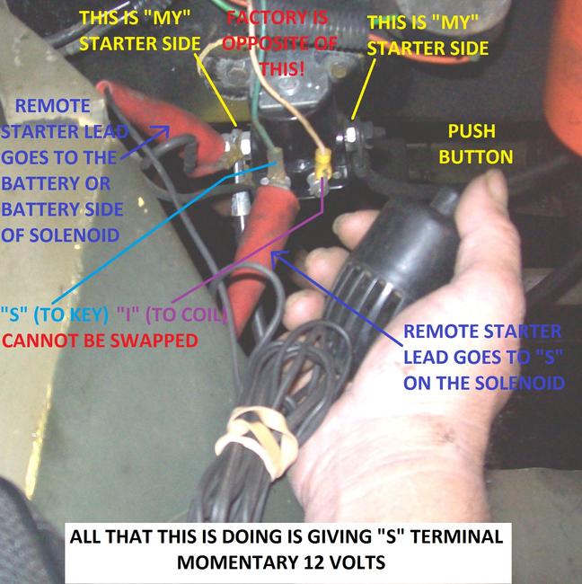

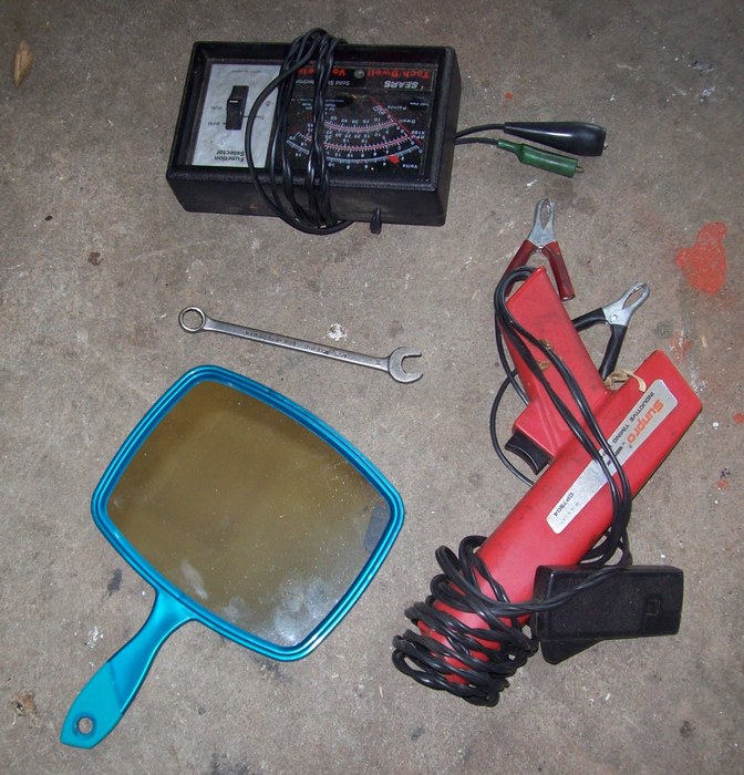

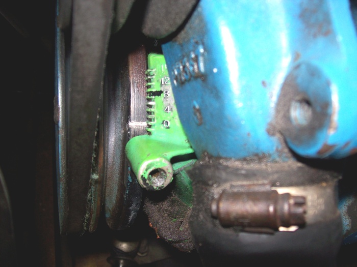

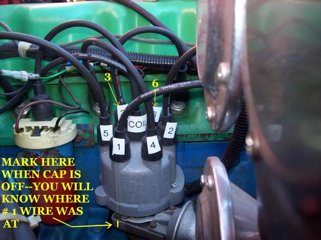

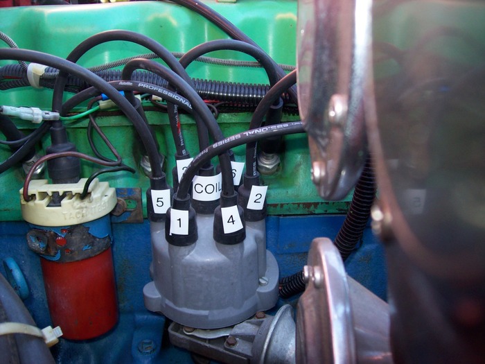

Loosen the distributor clamp so that the distributor is still held down with some pressure but will move and stay put, if you turn it with your hand.
Have a pal crank on it while you ease it in either direction

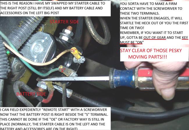

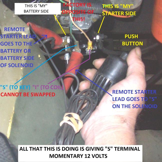

You can do all of this all by yourself if you turn the key to "on" and have a remote starter switch to use (see my pic)
Again, the two teaspoons of fuel into the carb barrel might help

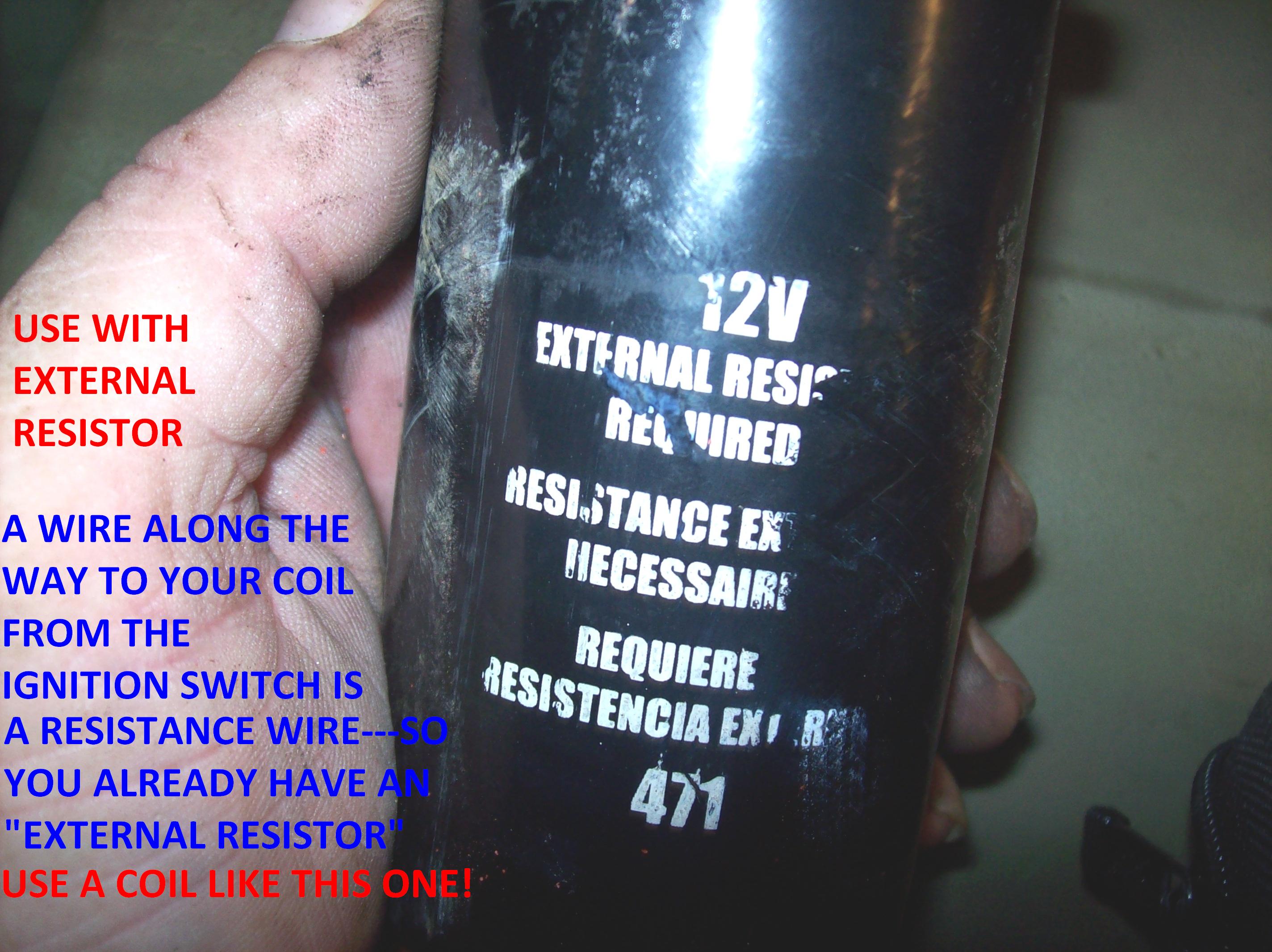

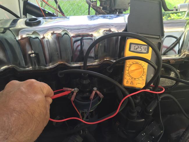

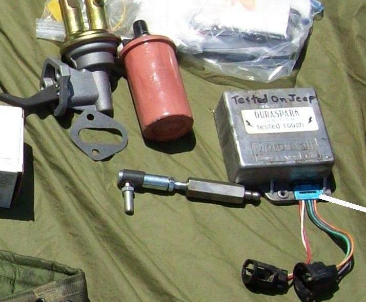

This is where i become your bestus buddy!
We're gonna test the coil with the help of morris
I have the "1979" paper manual that was left in my '79 cj 5, by mistake when i bought it in 1983.......i did not take care of it, when i realized it's value, i started treating it like it was a sacred scroll
Using the drop-downs, install: cj 7
.........then 1980 (76-78 ign is different than yours [prestolite]...............79-80 is the same as yours [motorcraft])
They did not replicate the manuals, so "1980" is gonna be you, when you look stuff up!
Now then, last thing......."power plant-ignition system (1,961kb)".......you have just entered "the book"!
Scroll a bit
(these pages can be printed)
You will run into diagnostic chartsthey are like flow charts
The "specs" you need for the tests...are further on.......on page "1g-18"
They also assume that your "mechanicals" are in order when you begin ........(stuff i was trying to pull out of you..like distributor in right?, timing gears right? Modifications other than factory?)........that stuff is found in here too, you just gotta have a librarian (me) guide you to them, at the right times!
Forget trying to test the module yourself, you can't do it all--at once, as fast as the parts store tester can over and over, you will be fooled by the test in the manual
In fact, you'd be better off buying one---if it was not the problem, you would have a spare
I keep a spare coil, ignition module, and a fuel pump in my console.........so far, 2 other cjs were glad........one needed a fuel pump, the other an ignition module!
I have added lots of storage---made lots of stuff "user friendlier" (like roller and spherical plane bearings incorporated into my clutch linkages (never have another linkage problem again!)....many other things too!)----i pretty much carry a condensed tool shed w/ me!...............i can show you a lot of this, if you are interested

it fired up!
turns out the coil was bad. thank you for pointing me in the right direction with the testing of it. turns out it was weak, very weak.

I really did not think it would be coil failure
It's been very seldom i have seen a "coil" go bad in a cj
I have seen people put the wrong one in many times
95% of the time.......it's the ignition module that messes up!

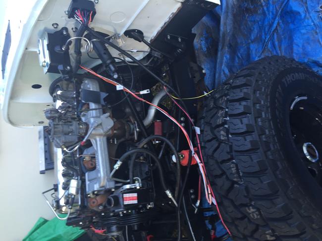

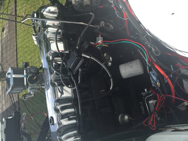

Hi there sorry for the delay work is crazy. Ok update I sent some time on the CJ today , it's no longer a spark problem. It's a fuel issue. I got it started for like 15 sec what I've noticed is I have to open up the throttle about half to full for it to want to start. I look down into the Carb and the intake is full of fuel. Now it's more like flooded. What do you think? Thanks

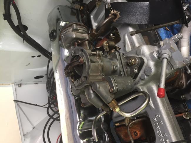

This is the original 1 bbl carter yf?
Or is it a 2 bbl-carter bbd?
Or is it something different?
The medic
The medic
Jul 13, 2019 at 11:46 AM
(Merged)
Gimme some history about this particular carb-who/ what/ why/ where/ and the rest!
Your jeep is really lookin' pertty!
Back on page 3, center of fuel filter feeds carb, little one on the edge is the return?

Found on the side of the road?
Buddy give it to you?
Has been on the jeep since it left the factory and no man has ever been inside since?
Jeep was in a barn for 20 years, never was fired up during that time?
It was rebuilt by the petty racing team 2 weeks ago?
I was sorta looking for a reason why it's "possibly" dumping gas!

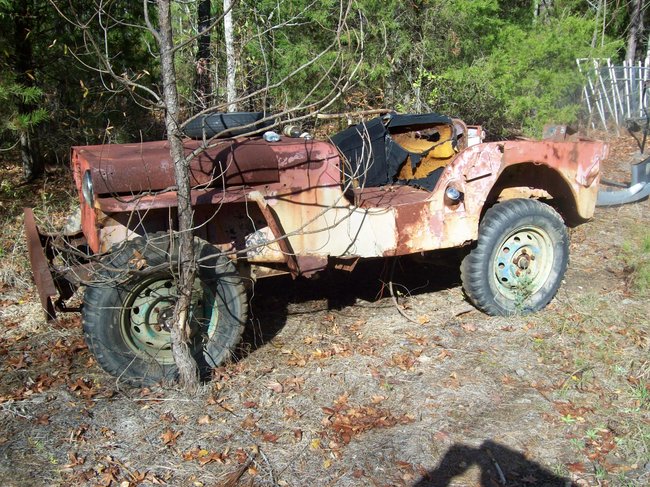

Actually he ("willy") is a 1946 cj-2a, willys jeep made just after the war. In the 1st pic (if you can see it), he's like the one 3rd row down, forth to the right.
I really wanted a "mb" (2nd row, forth to the right, but back in 1991 there was no internet. All the mbs i came across were incomplete or crap, none even close to running, however, the owners considered them gold, the lowest priced one was $750, junk! I had limited fundage and no time to travel to find what i wanted.
I got my '77 cj-5 in 1991 also. He ("mr. Jeep") was in excellent shape, he cost me $2200, he's my 6th cj-5, never had anything else! Now that i'm older and more responsible (and still broke) "mr. Jeep" has lasted the longest
(i started out with nuthin' and i still have most of it left)
Along my quest i came across "willy", willy was complete (less one brake drum), the body was shot (a 55 gallon drum of bondo held what was left together, the body was not a keeper)
1946-1948 cj-2as were a really close enough relative to the '41-'45 mb for me, so i jumped on this one. I gave the man a whopping $100, he signed over the original title, and i loaded him on my buddy's trailer.
Here's the kicker!
They all laughed as i unloaded him (family, and neighbors) and my buddy shoved him into the one car garage of the duplex i rented with his push bar.
Two years later, he rolled out looking real close to a "mb", i am still making improvements to make him get closer. The numbers on the hood is my daughter's birth date. She learned how to drive him well by age 10, took her driver's test in him too! (yep, with no seat belts, and she hand cranked him, instead of using the starter)
He's not perfect, he'll get called out as an imposter by those who know their jeeps, but for the most part, he'll fool the majority.
Although there are many subtle differences, a quick way to tell a wwii mb from a korean war m-38 is the shovel and ax is on the drivers side of a mb, and on the passenger side of a m-38. Notice where i did the body work to make my shovel and ax fit!

Update: today I took one of our Acura Tech to the house so could take a look at the CJ. I work for an Acura deal in south Florida. He went over everything I have Timing, Spark, Fuel Delivery,TDC... all of it the only thing he came up with was the battery I have is not enough cranking to get the jeep started. So I'm getting a Extra battery to see what happens. He did want me to ask you a Q. when we take the Carb off the intake Man looking down the port there's a small amount of fuel there, is that common.? let me know what you think thanks.

Hello there ... will haven't had much time to work on the CJ, I did have to put in a new starter. One Q. I do have I took the carter 1bb yf off the manifold and look down in the port and found a puddle of fuel. Soaked it Up with a a shop towel , I guess the Q is that normal? Let me know thank you.

Usually the intake sucks/ vaporizes any fuel in the intake while the engine is running, so it's dry when you shut the engine off
If it has not run, you have been actuating the pedal/ throttle. Each time the accelerator pump has moved up and down and squirted a stream of fuel down the carbs throat.
So, however many times you throttled it you have puddled fuel in the intake.
Holding the pedal to the floor and cranking the engine will "un"-flood the engine, as fuel is sucked on thru
Usually, when i wanna try to start a stubborn engine/ or diagnose one quickly (like, does it have spark without testing, a splash of fuel is fast and ez) i'd guess that i'm putting in no more than about 2 teaspoons of fuel
Still no start?
Loosen the distributor a little and slowly move it both ways while it is being cranked. Does it start or at least sound more like it wants to in the different position?
Is your firing order clockwise?
(my motorcraft below, clockwise rotation like a prestolite)

Hello there I'm so sorry for the long delay.. But I have great news "it's alive"!! I bought a 2BB Webber still would not start, I got the carb in late Dec. Is I read more about the prestolite sys the more bad reviews, as a last hail Mary I ordered a HEI then one early Tuesday morning I installed it and Walla on the first turn it ran awesomely!!!! I'm sending you a vid hopefully you'll see it. But I do want say thank you for all your advice I did learn a thing or to thank you.
