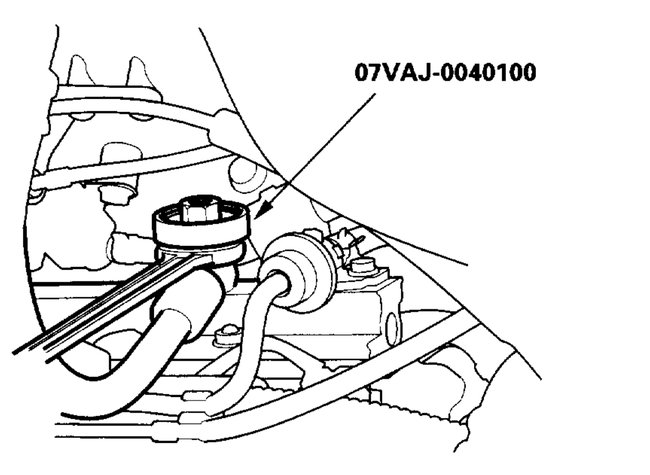

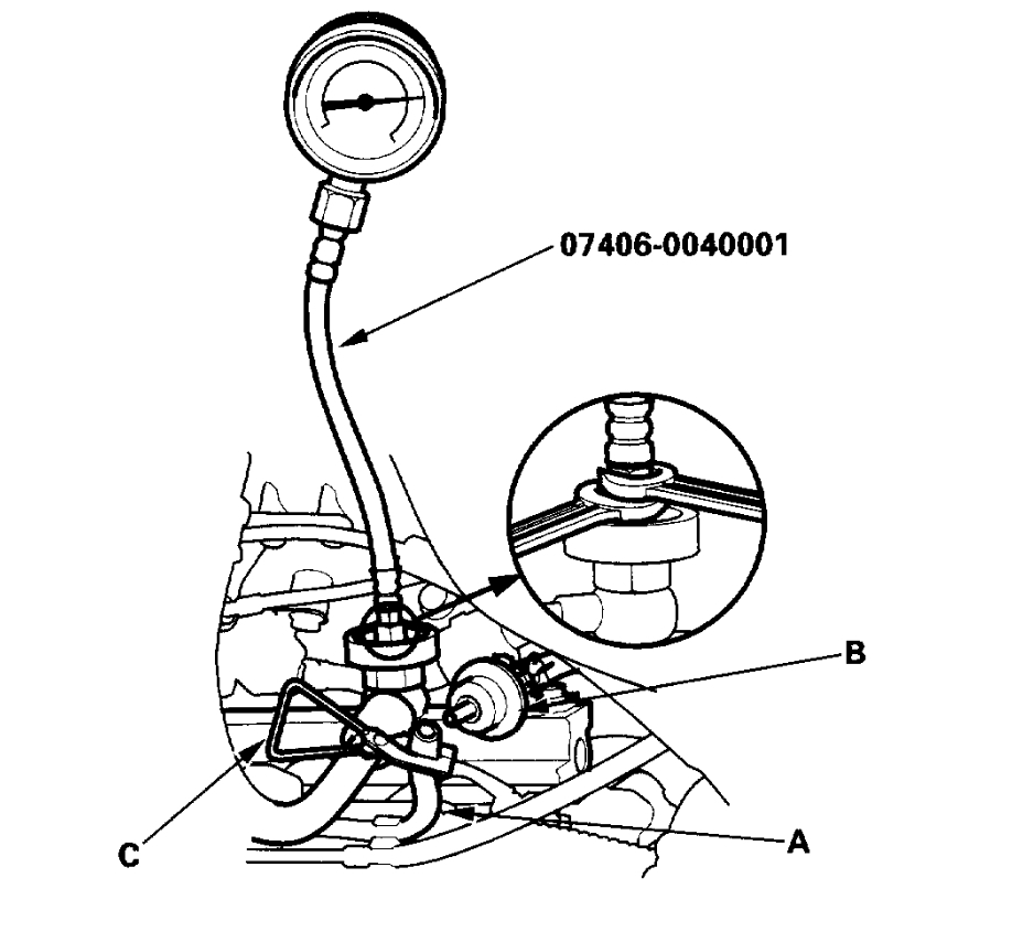

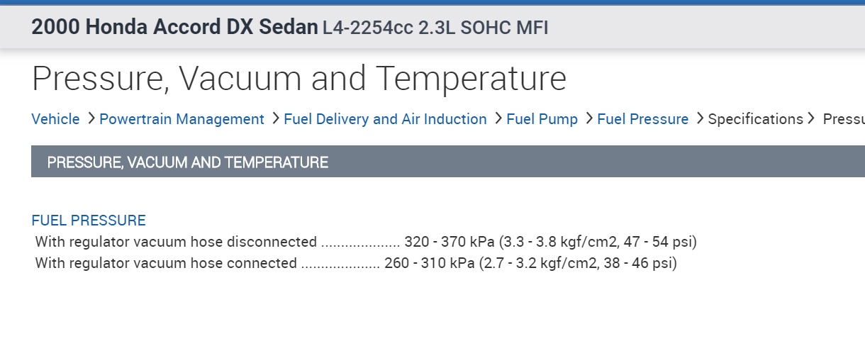

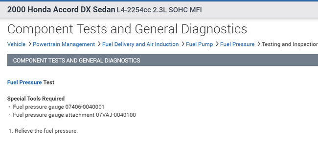

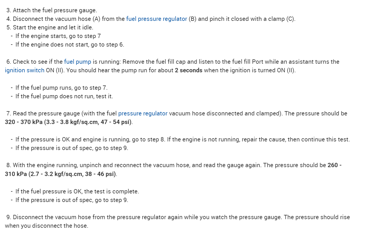

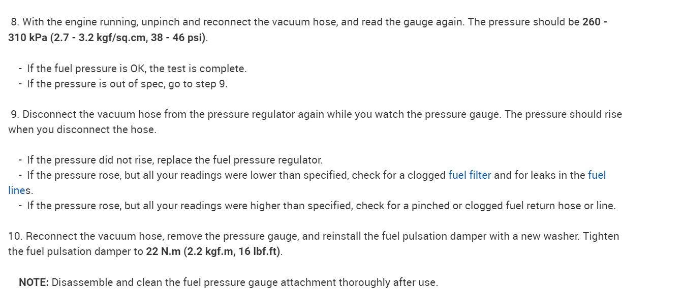

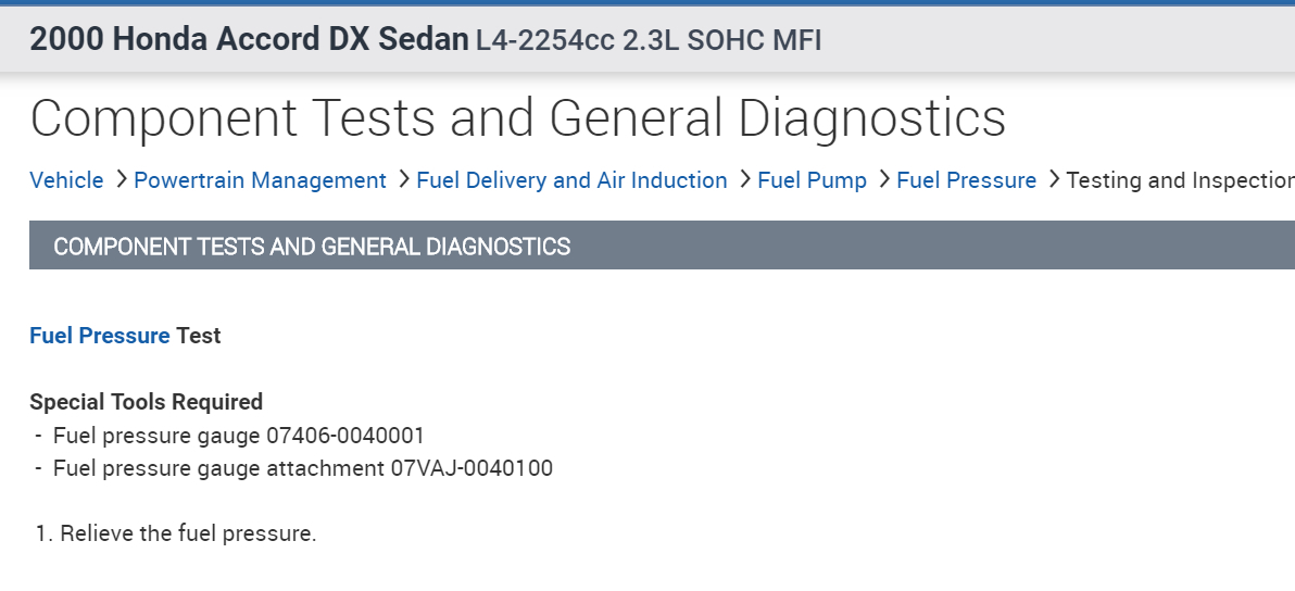

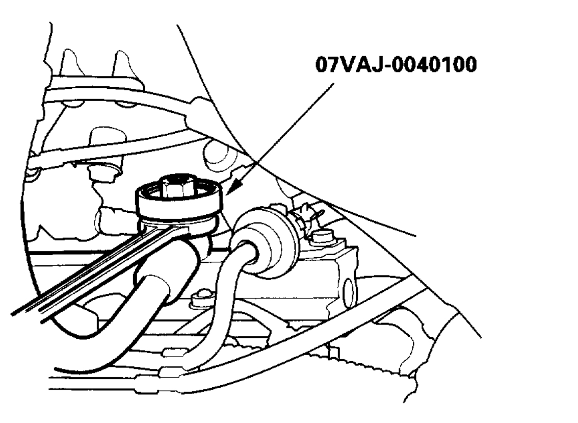

This one's puzzling, if you have spark, fuel, and compression then your vehicle should start. When you turn the key to the on position without cranking the engine over can you hear the fuel pump run in the tank for 5 seconds?
Your vehicle might be getting fuel, but not enough pressure for the injectors to run properly. I have included the fuel pressure specs and testing procedures for your vehicle in the diagrams down below. Please go through these guides and get back to us with what you are able to find out. We can go from there.
