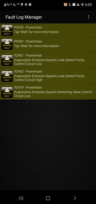

Codes P043E, P043F, P2401, P2402, and P2419
2012 TOYOTA RAV4
Have you replaced any parts since last month's post? Some of your live data looks strange. On the first recording at around 4:19 the engine RPM goes to around 480 and most sensors are reading negative. And your MPG is up to 20, so what's changed? No codes stored.
Jul 31, 2022 at 2:24 PM
Yes, I have replaced EVAP filter and EVAP purge hose.
And isolated the borders of the EVAP pump by using silicon.
Jul 31, 2022 at 3:52 PM
But you didn't replace the Evap Canister assembly? I ran some of your data numbers through the Volumetric Efficiency calculator and they came up somewhat low. Does it feel somewhat sluggish? It might be something you don't notice since you have been driving it like this for so long.
Jul 31, 2022 at 4:19 PM

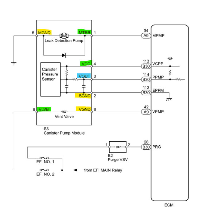

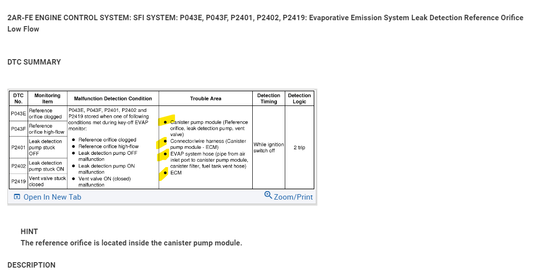

Have you replaced the Canister assembly yet? These are your 4 possibilities for the 4 codes youre getting. The only thing left you can do is check the wiring from the ecm all the way to the Canister by measuring with a multimeter from the ecm connector to the Canister connector to see if theres any open circuits or high resistance. The rest of the testing needs to be done with a high end scan tool that will tell the ecm to run through the entire check procedure. Which takes 18minutes for the self test to run.
Below is the oem diagram from Toyota for the Evap Canister assembly. The green markers are where a voltage reading would be, the yellow are Ground marks and the Blue is a Signal from the canister pressure sensor. But this system only turns on when certain conditions are met and there is no way for you to know when it will run a self test and or run the evap system.

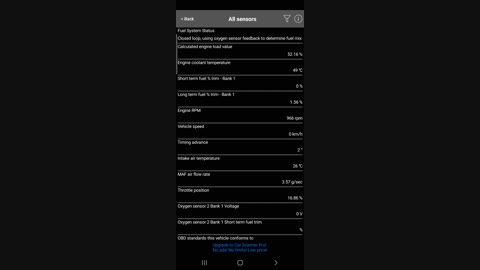

Why does your live data keep dropping on the RPM to 480 quite a bit? Are you having some type of stalling issue? The Volumetric Efficiency test I ran with the numbers from your live data suggests the Catalytic Converter may not be in good shape. 51% and 60% are not good numbers, this is because of the positive fuel trim numbers reaching over 10%. Along with all the codes you're getting, the fact that you were smelling gas inside the vehicle means you either have a gas leak somewhere or you have cylinders misfiring and making this whole situation worse. If the Catalytic Converter cannot allow 100% of the exhaust to escape the engine, it cannot take in 100% fresh air, and the result is misfiring cylinders. Misfires allow more unburned fuel down the exhaust, this causes the Converter to overheat, and the cycle continues. And we really don't know what action the ECM takes when there are four codes for the Evap system, we don't know if it disables the system or runs in some default strategy.
The vehicles running condition is only going to get worse, until it doesn't start one day. You've had the same codes for months now.

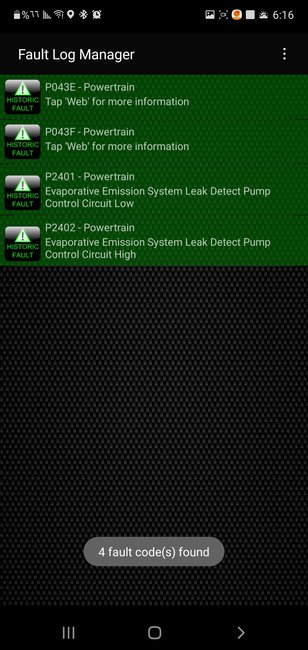

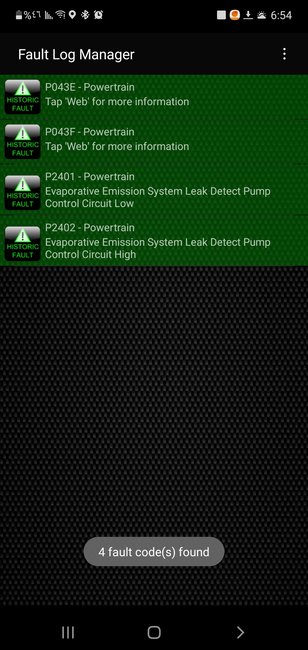

Today scanning
Car Scanner ELM OBD2
DTC report
Selected brand: Toyota
VIN: 2T3BF4DV2CW234743
============1==============
P043E
Raw code: 043E
ECU: Engine control unit[Archive (inactive)]
Status: Permanent
OBDII: Evaporative emission (EVAP) leak detection reference orifice - low flow
============2==============
P043F
Raw code: 043F
Status: Permanent
OBDII: Evaporative emission (EVAP) leak detection system reference orifice - excessive flow detected
============3==============
P2401
Raw code: 2401
Status: Permanent
OBDII: Evaporative emission (EVAP) leak detection pump, control - circuit low
============4==============
P2402
Raw code: 2402
Status: Permanent
OBDII: Evaporative emission (EVAP) leak detection pump, control - circuit high

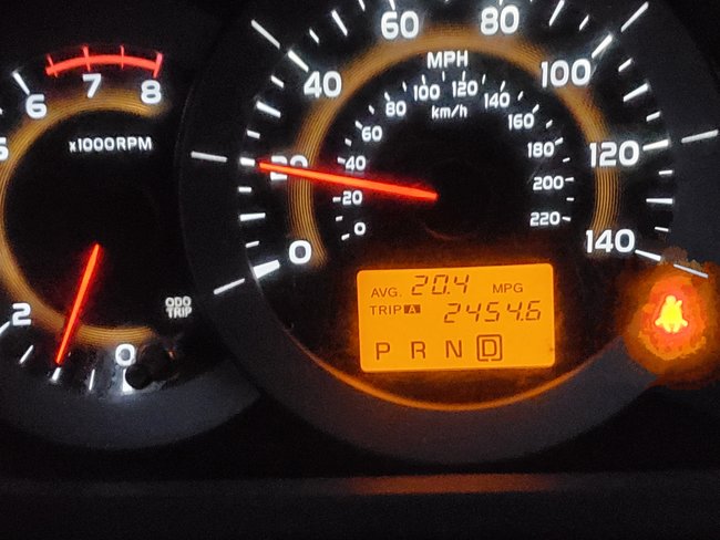

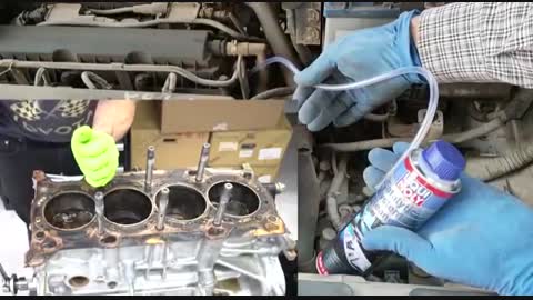

Aug 4, 2022 at 12:43 PM

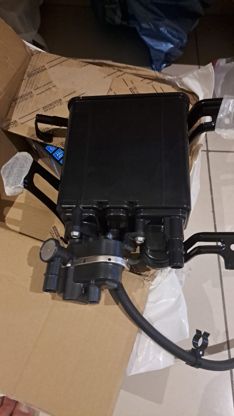

This picture at the same day when I changed the evap.
Jan 4, 2023 at 7:55 AM

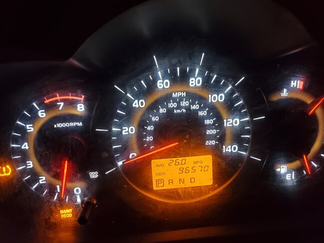

Jan 4, 2023 at 10:29 AM
Hello.
I'm comeback again.
I have changed a new evap assembly for my vehicle.
All code have dissappear. And fuel consumption gauge have raised to 26 mpg for only one day and it then decreases to 15 mpg .
I need your help to know what's the problems in my vehicle.
Thank you so much .
I'm comeback again.
Thank you so much .

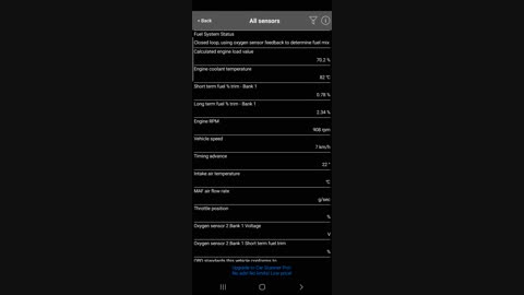

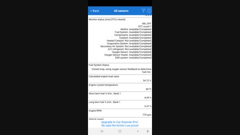

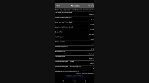

May 27, 2023 at 12:12 PM

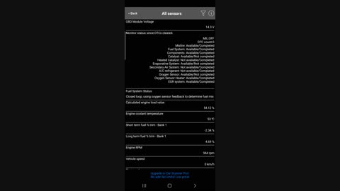

This data is just at an idle not even moving, I see 1 DTC at the top, what code is it?
The Calculated Load is very high for idle, 57.25%. The Barometric pressure is 78 kPA which is around 11psi that doesnt look right. And the biggest worry is the Catalytic Converter temperatures, 800 degrees F at the inlet and 480 degrees at the outlet.
As well as the OBD2 voltage reading there is low, 12.3-12.7, but that might just be a Toyota charging strategy at idle.

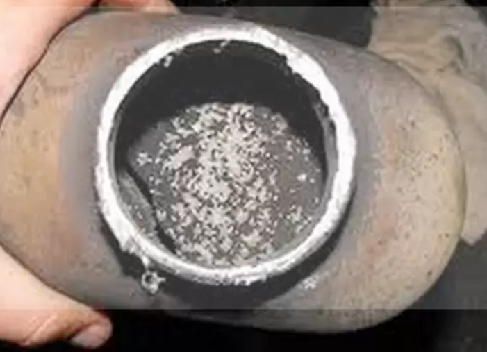

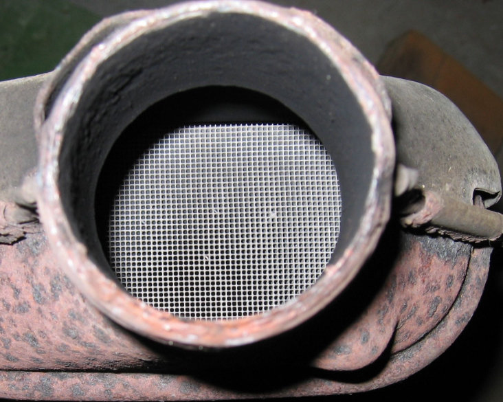

But the Calculated Load almost looks like the Catalytic Converter might be failing. Is the vehicle sluggish when taking off? The Calculated load should not be that high just sitting at an idle. I saw a couple places where the Mass air flow sensor was reading low, but would jump back up.
Let me know if there is a code stored, the proper way to test the Catalytic Converter is to remove the front Oxygen sensor, and do a back pressure test at the Oxygen sensor hole. Remember that the Evap system was not working correctly for awhile, and a rich running engine is what causes Converters to fail. If those temperature readings are correct, 800 degrees at the inlet and 480 at the outlet is way off.
But doing a back pressure test at the front oxygen sensor hole with a vacuum gauge that can read some positive pressure, (most can read up to 10psi for positive pressure). and taking a reading with the vehicle idling, and then rev it up to 2000rpm. You should have no more than 1-2psi at max for a back pressure test. Really there should be almost no back pressure. But I think youre going to find a high reading, The guide below will help with testing.
Just dont stick the rubber section of the vacuum gauge into the exhaust and melt it. Try to put some kind of adapter on there that wont melt, and you only need to get a quick reading.
If you start the vehicle, stick the vacuum gauge on there for a second and its reading a few psi, rev it up real quick, see what it reads and youre done with the test, I have heard of people sticking the rubber adapter of a vacuum gauge into the exhaust hole and it melts the vacuum gauge and adapters, dont do that.

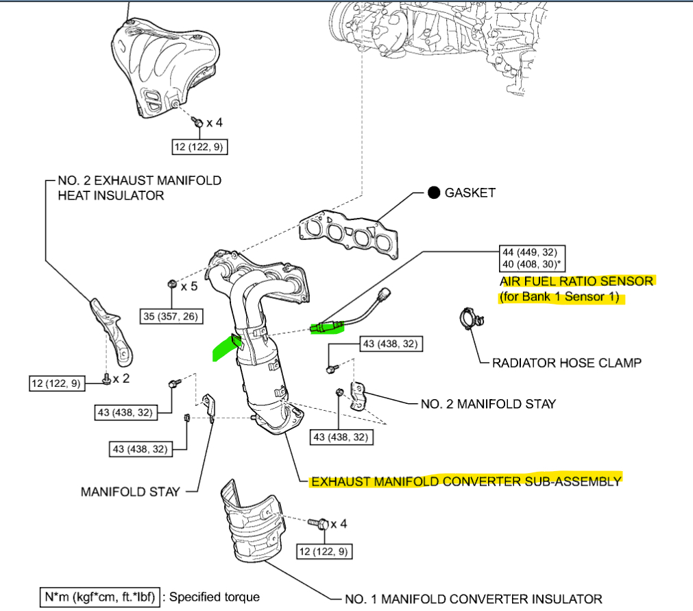

Here is a diagram of the exhaust manifold below with the location of the front Oxygen sensor(Air Fuel Ratio Sensor).

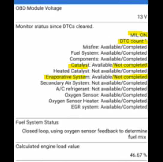

May 28, 2023 at 1:04 AM

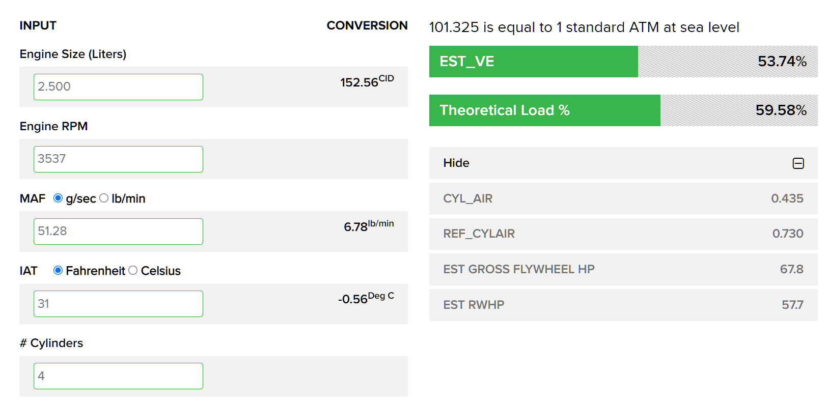

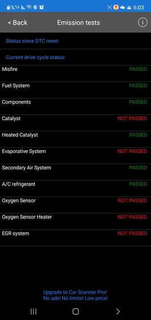

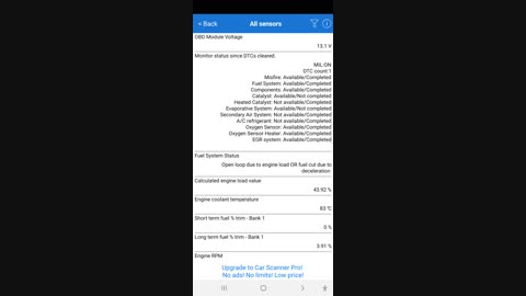

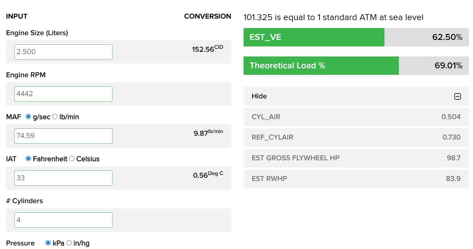

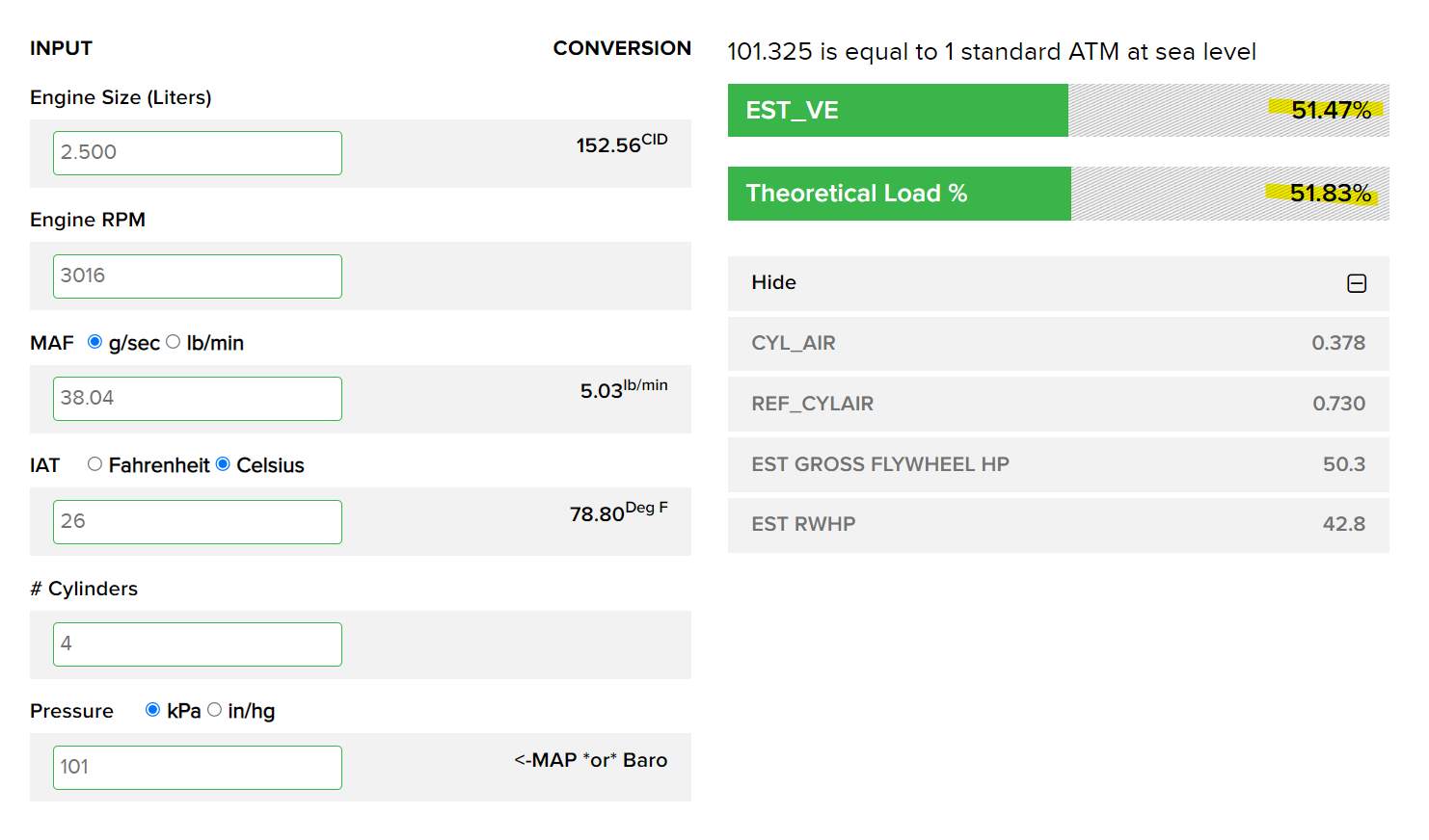

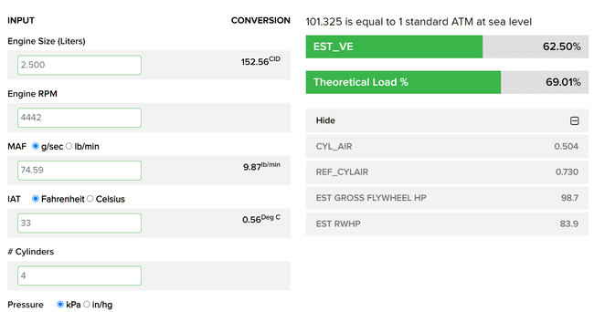

Okay, the numbers look pretty much the same as yesterday. At some points I noticed the Calculated Load reaching 97.25 percent. That was at about 2300rpm, MAF 32.82g/s.
Then another spot was at Calculated load of 91.76 percent at 3000 RPMs, 97 percent is extremely high, for 11mph (19km/h). Does the vehicle feel very sluggish, can you do a wide-open throttle run, such as getting on a highway and see what the highest RPM you can reach and then let off the gas. Not hold it at that highest RPM but just to see what you can reach and record the live data, rpm, MAF, Intake Air Temp. I can go through the data on your videos and find the highest rpm like I have been so far. But I would expect the vehicle to be very sluggish if these readings are correct. Not being in the vehicle with you, I can only go by the data numbers I see.
But having the Catalytic Converter back pressure tested is one of the first tests to do. Just because over the past year dealing with the Evap system not functioning correctly, it could have overwhelmed the Converter over that amount of time.
This is a Volumetric Efficiency test (VE test) with the numbers you had, and 3000rpm was the highest I saw, and the EST_VE is the results of that test, 51.47%. Thats technically how well the engine is breathing, taking in air and allowing exhaust out. It's possible the scan tool data is not entirely correct, but you did notice a low mpg, and is there a code stored in the engine computer?

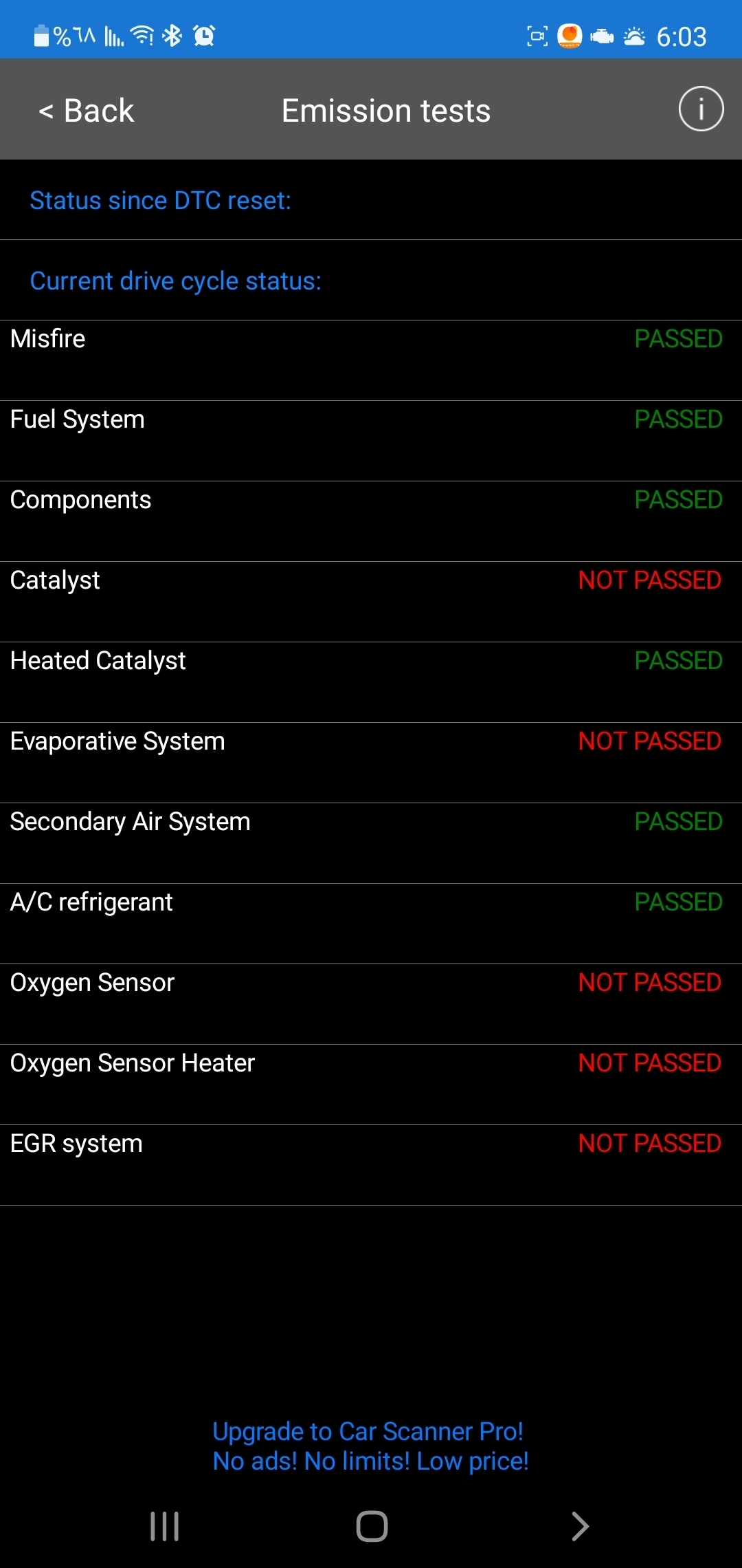

At the top there, MIL ON DTC count: 1 (code stored),
Catalyst: Available/Not completed, Evap System: Not Completed.
So, the Readiness Monitors have not been able to pass the self-tests. For some reason the Evap has not either, but the Evap Monitor has to be certain conditions to run its self test. Most have to have a certain amount of gas in the tank, a certain amount of cold soak (off time) has to have gone by, things like that.
So, I'm more concerned with the Catalyst not being complete.
