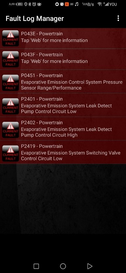

Codes P043E, P043F, P2401, P2402, and P2419
2012 TOYOTA RAV4
90,000 MILES
NADHEER
  • 132 POSTS
P043E - Generic
Type Powertrain - Auxiliary Emission Controls - ISO/SAE Controlled
Description
Evaporative Emission System Leak Detection Reference Orifice Low Flow
P043F - Generic
Description
Evaporative Emission System Leak Detection Reference Orifice High Flow
P2401 - Generic
Description
Evaporative Emission System Leak Detection Pump Control Circuit Low
P2401 - Mazda
Description
Evaporative emission (EVAP) pressure pump - voltage low
Cause
Wiring, EVAP pressure pump, ECM
P2402 - Generic
Description
Evaporative Emission System Leak Detection Pump Control Circuit High
P2419 - Generic
Description
Evaporative Emission System Switching Valve Control Circuit Low

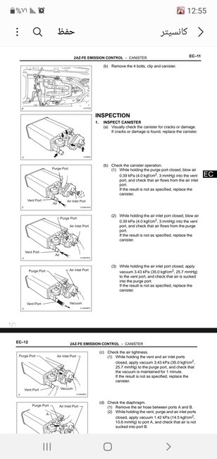

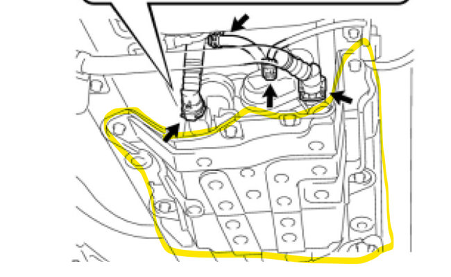

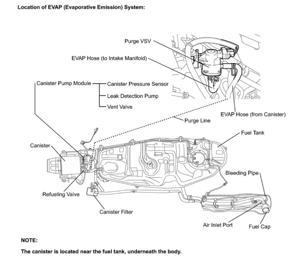

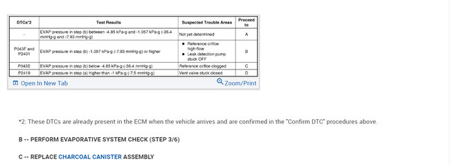

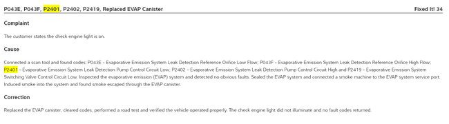

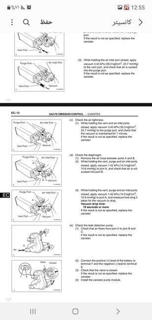

It looks like the Evap Canister Assembly has failed. The assembly has a leak detection pump, pressure sensor, and vent valve all contained in one module, but with those particular codes stored together under the testing conditions, it looks like the Evap module itself has failed. The vehicle runs self pressure tests when the engine is off. The leak detection pump will pull the system into a vacuum, and the engine computer(ecm) will monitor the pressure sensor for any pressure changes. In this case it has failed multiple tests in a row.

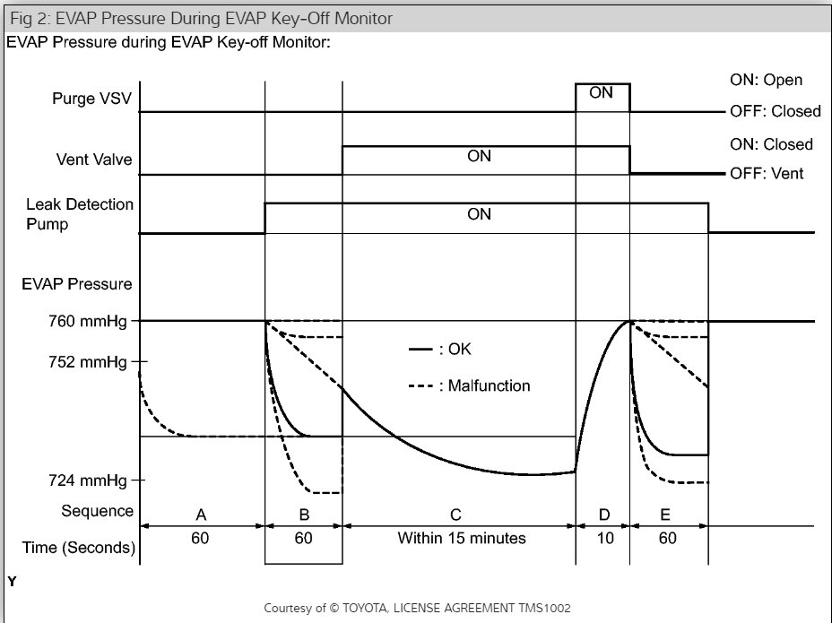

Toyota has their own factory scantool (Techstream) that they use for running specific bi-directional tests. Unfortunately many manufacturers have OEM factory scantools they use that are not available to aftermarket shops.
But the information below is from Toyota.
This is for the 2.4Liter engine, but it appears the 3.5liter has the same system.

This still looks like a failure of the Evap System canister pump assembly, a problem with the wiring harness running to the canister assembly, or an ECM failure (engine computer). But if it was an ECM failure you would probably have other codes set as well. According to Toyota's information with these codes set together it's a failed evap canister assembly.

Under normal testing, the whole system would be filled with smoke using a smoke machine and checked for leaks that way. By just replacing the assembly, there's a chance of misdiagnosing the problem. But looking through the information on our databases, the fix for this is replacing the whole assembly.

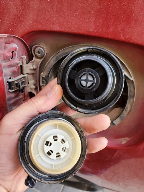

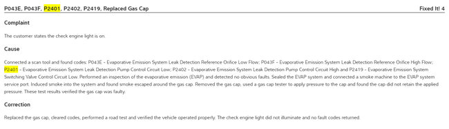

I would recommend replacing the gas cap first and clearing the codes and see if all those codes come back.
Don't fill the gas tank though, only put half a tank of gas in it, that way the system will run its tests overnight. It needs 5 hours after the vehicle is turned off in the evening for the system to cool down. If all the codes come back, then we will go through and replace the Evap assembly. It might take 2 drive cycles to set the codes again, so it might take 2 days before they set again.
Below are 2 examples of real fixes, so the gas cap being the cheaper one, I think you should do that first.
Jun 4, 2022 at 9:13 PM
NADHEER
  • 132 POSTS
I have changed the cap tank by new one and I fill 20L gas to the tank .and I cleared the fault codes.

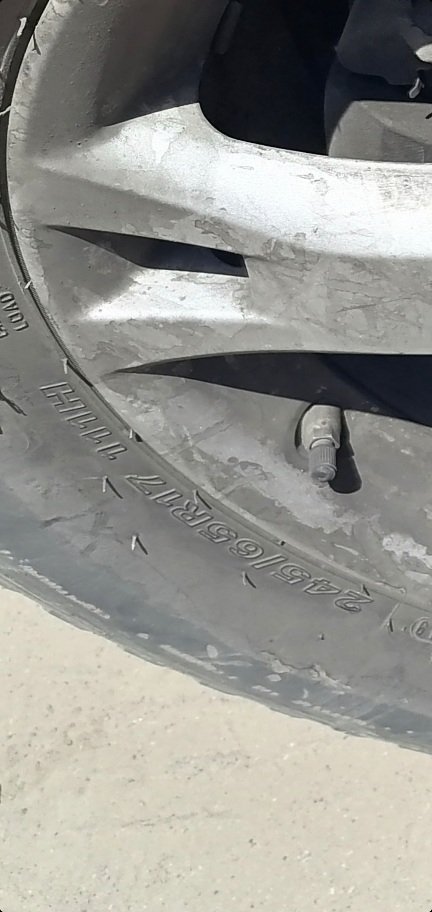

It's tire size now is 245/65 R 17 111H not as It's manufactured gauge (225/65R17 101H).

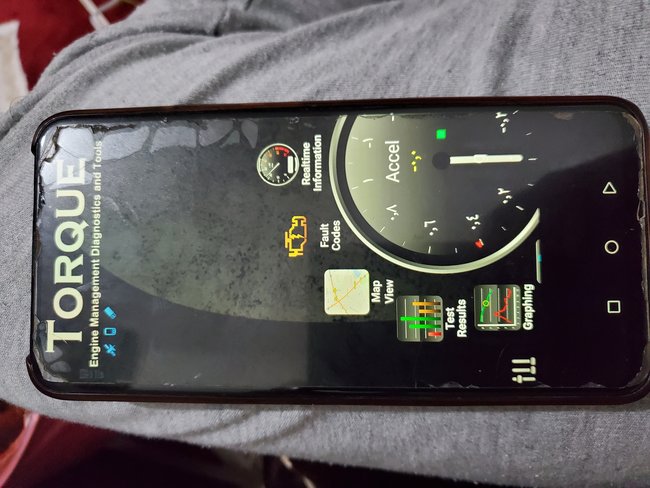

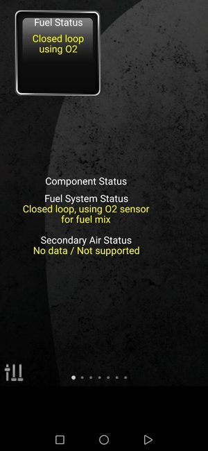

yes, that is an ELM327. What phone app are you using with it?
Jun 5, 2022 at 12:30 PM
NADHEER
  • 132 POSTS
I using this phone app.

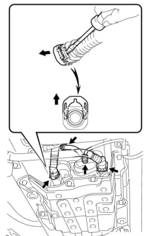

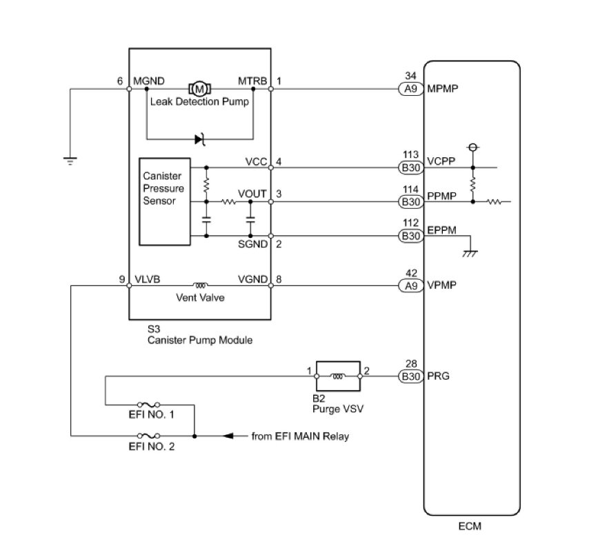

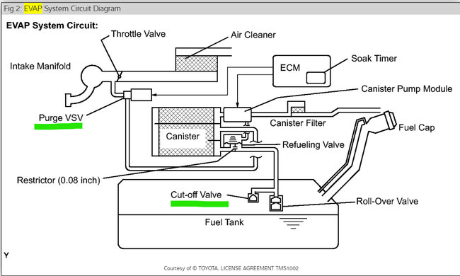

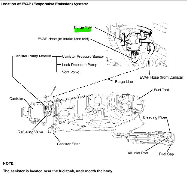

The first diagram shows the front of the canister, the 2nd shows the hoses coming to and from the canister. You can unhook these one at a time and see if any gasoline comes out of them. There shouldnt be any, only gas fumes,
the 3rd diagram is the Purge valve that is supposed to open and pull the gas vapors from the gas tank and canister. It shouldnt have any gasoline in it either.
Toyota has is located in 2 different locations, so if its not here, it will be under the hood near the intake manifold, if so we will deal with that last.

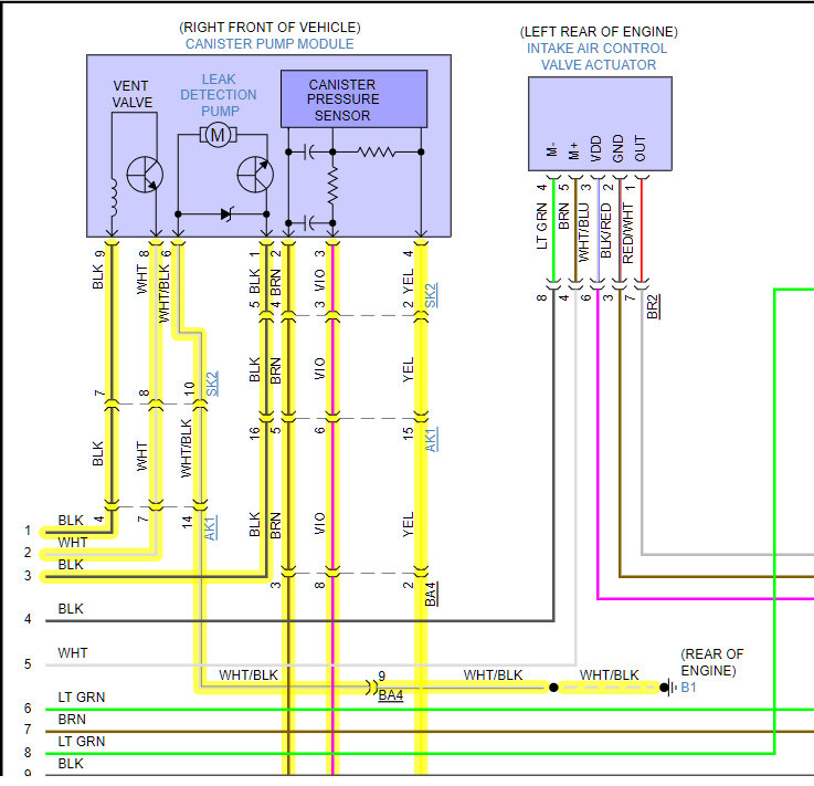

The 4th diagram is the wiring harness to the assembly. Each number (AK1, SK2, etc) are electrical connectors. So check the connectors for any corrosion inside them. Most likely you wont find any.
The 5th diagram is the Cut-Off valve, its the valve that closes once the tank is full and causes the gas handle to click at the gas station, due to vapor fill.
My worry is that there is gasoline being drawn threw the system all the way up to the Purge valve and then into the engine. And thats why your going through so much gas.

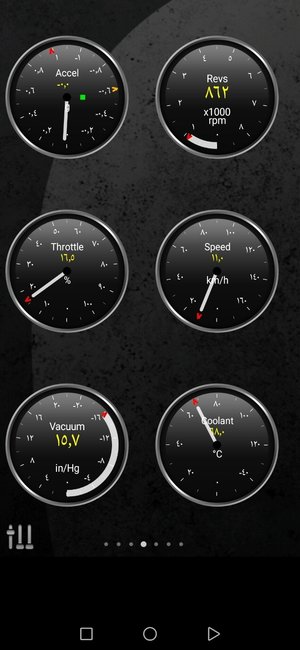

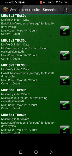

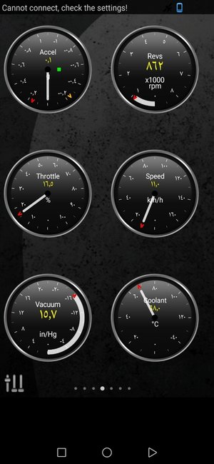

On your scan tool app push the Real Time Information and see if you can find anything that says Long Term Fuel Trim. Or anything to do with Fuel Trim and tell me what its reading while the vehicle is running.
Or I see it has CO2 emissions readout.
Jun 5, 2022 at 1:49 PM
NADHEER
  • 132 POSTS
1

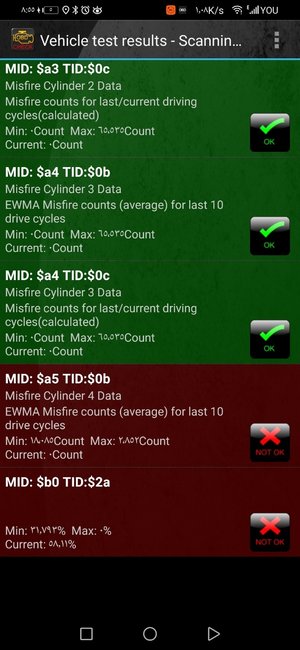

I can only communicate through here, That's the purpose of the website. This is not a forum for automotive repair. We are all actual automotive technicians.

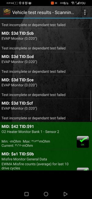

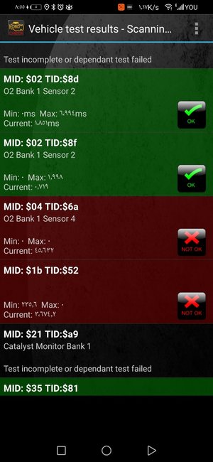

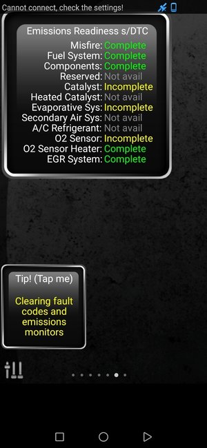

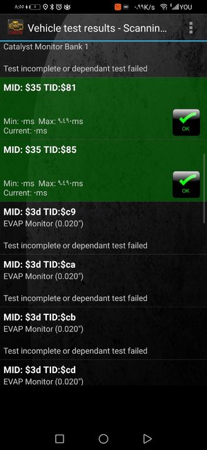

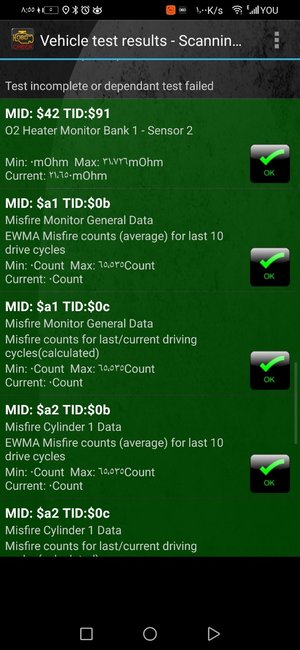

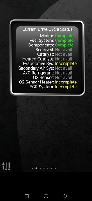

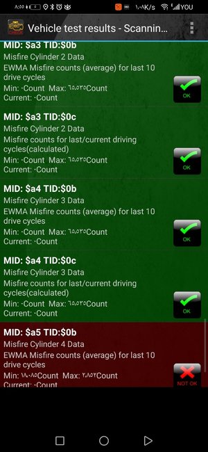

As for the scan data you posted, those 7 pages that say TID $06 for example, that is Mode ^ data from the engine computer. It is Test ID $06. MID is Monitor ID and CID is Component ID. I think you might have the 3.5 Liter engine loaded on your scan tool because its reading on the last MID an Oxygen Sensor Bank 1 sensor 4 and there is no sensor #4 on your car. It only has 2. Just so you know.
I also see that Cylinder #4 misfires happening, and I think that is happening because Cylinder #4 is closest to where the Evap Hose comes into the Intake Manifold.
You will also notice it has failed all the Evap Monitor Tests, that's because of all those codes you had. It looks like some of the data on this App is in another language.

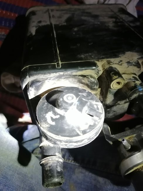

Jun 8, 2022 at 9:23 AM
NADHEER
  • 132 POSTS
I found this part is closed and I cleaned it by using carburetor cleaner and it then opened.

Okay, good you got the Evap canister down. Was there any liquid gasoline in it? It also sounds like the Vent valve was stuck shut. So, did the codes return after you cleaned that valve out, or have you not gotten to that part yet? You can see by all the dust and dirt how easy it is for those valves to get stuck closed or open. If you haven't tried the vehicle with the cleaned-out valve yet, I'm hoping that will take care of the codes. With that valve being stuck closed the system would fail all of its self tests that it runs. After you get the canister reinstalled, clear the codes again and see if your gas mileage improves. Thise codes also are Historic codes, meaning the engine computer is not seeing the fault right now. That was good work, I'm impressed.
Jun 10, 2022 at 3:43 PM
NADHEER
  • 132 POSTS
I don't find any gasoline in it.
It was dry.
Only the vent valve was closed by dust.

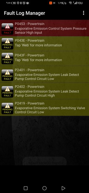

Yes, the code was returned after I cleaned the evap system. And I scan the car by may oBD2 and the fault appear as a pending fault then I clean the faults and clicked off the + and – of the battery. And then scan for the faults and it appears as a historic fault.

This fault after I cleaned the evap.
