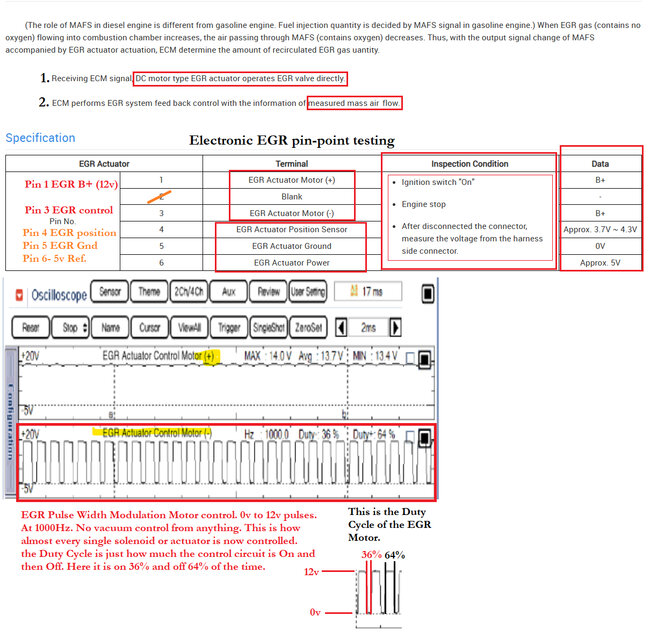

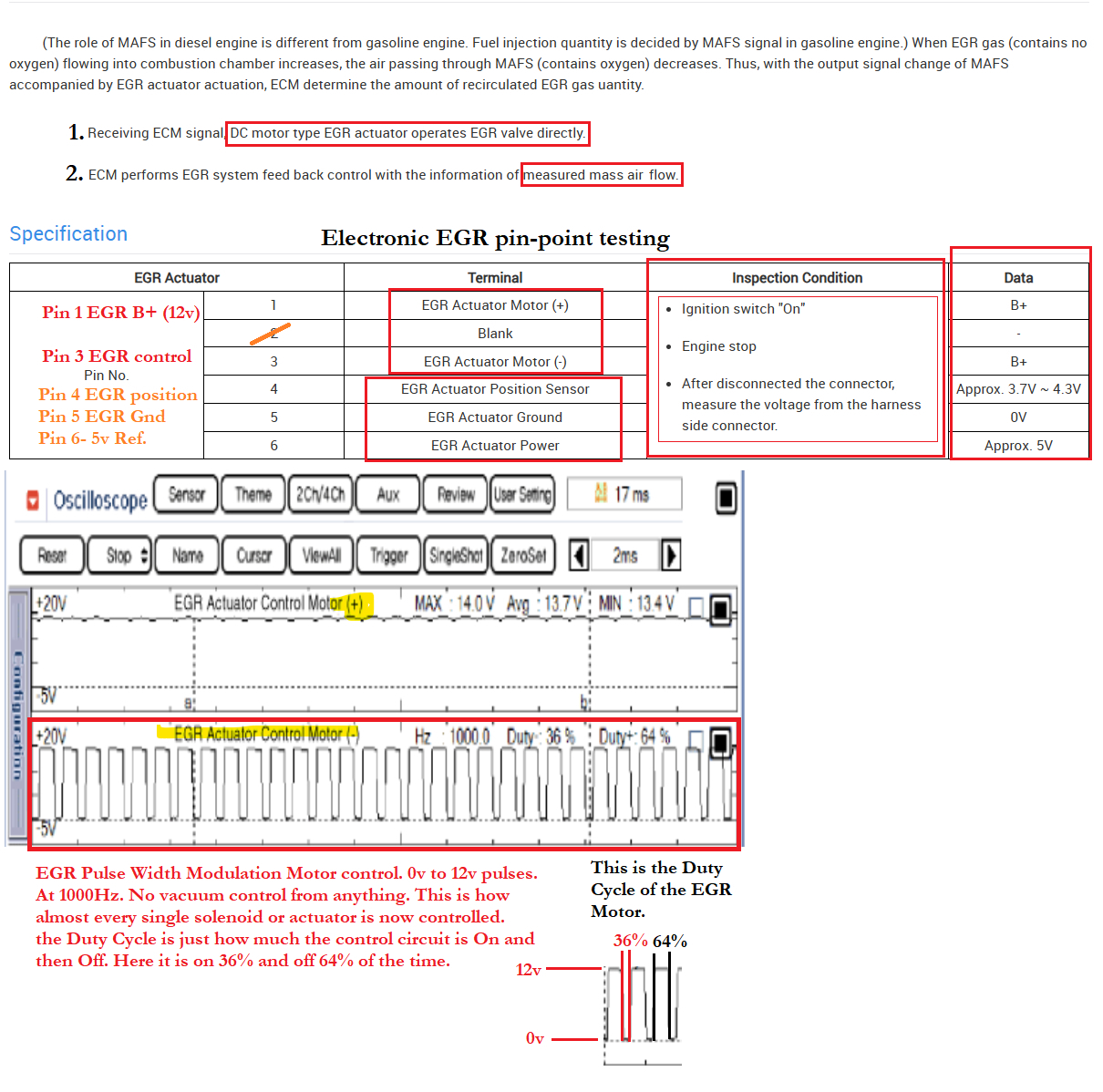

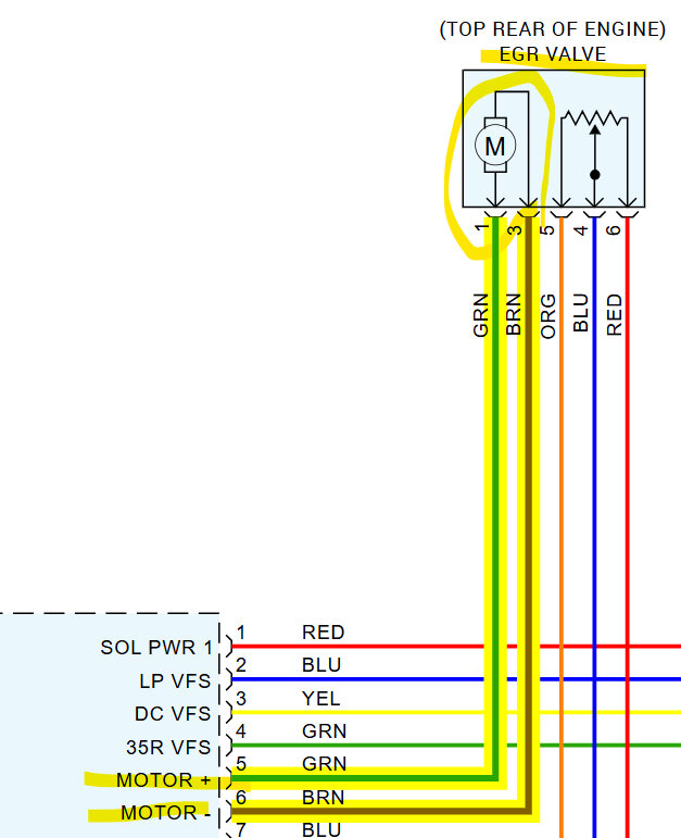

This is all that controls the EGR, two wires, thats it. You cant guess at how a circuit or component works, youre all over the map here, you cant fix something if you do not know how it works. Did you check the fuse for the oxygen sensor heaters with a test light yet?

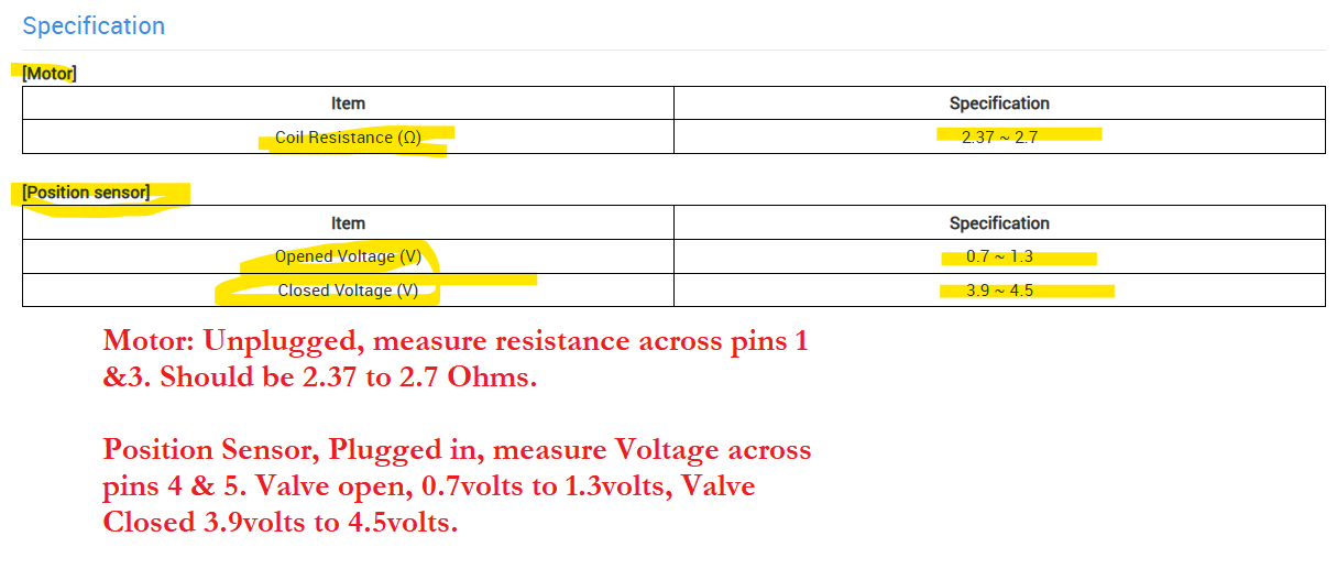

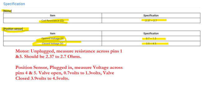

Here is all the pin point testing for the EGR valve.

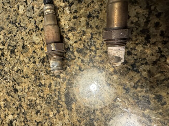

Hey Al, got parts today and put them on. I cleared the codes , sometimes when I clear them one or two might hang in there after I cleared them so I didn’t recheck it after I cleared them. Cleared them 8 all together. Took car out only. 4-5 miles so who knows what tomorrow will bring. It did feel a alot more responsive then it felt in a long time. Come home light still out. Gas milage went up to 39.8 mpg which I didn’t see in a long time, it’s been hanging around32-36 mpg. Reran the code scanner and I have as of now 1 code I can’t remember what one it was po138 or po139 just can’t remember. It’s definitely b1s2. I’ll know more tomorrow after work when I rescan it. I’ll attach a photo of the sensors . The upstream has a funny grey white coating on it I never seen before, perhaps you might recognize it, the solenoid I replaced I’m not sure on. The new one you can’t blow through but the old one you can blow right through, possibly cause warm? I haven’t a clue, i figured they worked off voltage. Anyway it’s a definite improvement on power and gas milage. Not sure either if that senor downstream has to cycle 1 or 2 times to not show on a scan, also when both o2 sensors die at same time I seen it’s usually caused by oil or coolant getting in there some how. If my EGR valve was clogged and both sensors went bad what are the odds of converter being clogged enough to throw downstream sensor voltage high? Thanks just curious on your input. Dealers way to expensive for converters.

That white carbon is due to that coolant leak. The Purge valve with the green and white (2 wires) should be normally closed when it's unplugged. So if you can blow through the old one, then its no good. Your scan tool data should list the EGR position in engine live data, and if you pull heavy throttle you should see the EGR position opening, Its used under heavy load/ heavy throttle because thats when NOX gases are produced. I thought they had replaced the EGR valve already?
