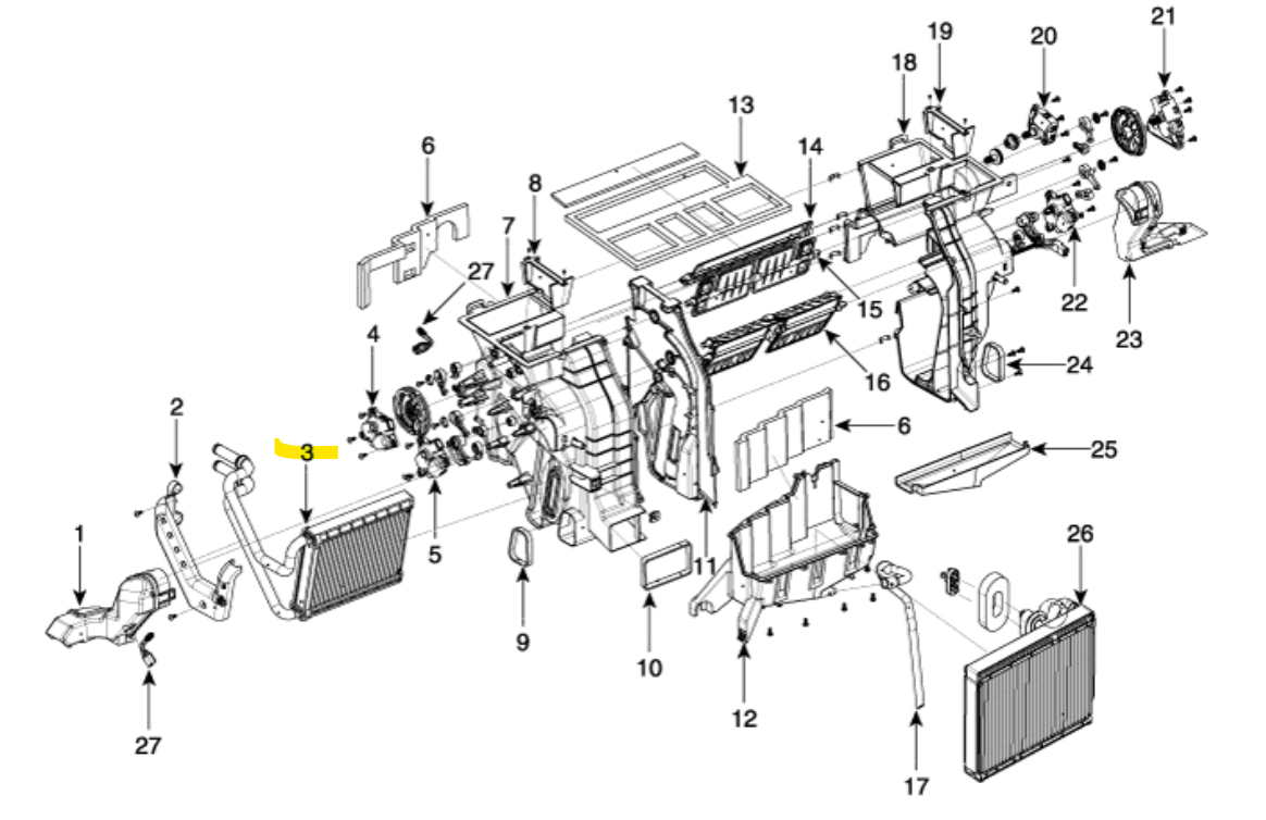

Knowing there is already dye in the system should help. I don't know 100% if the heater core leaking on this vehicle will show up inside or leak out the Evap drain hose, so keep an eye on that. You should notice it hanging down under the vehicle about where the dashboard is. I'm sorry you're having such a difficult time with this. But that coolant is going somewhere, if this one tech is right, and it's leaking down the exhaust, it might not be happening until you're moving.

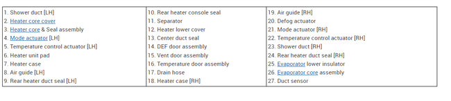

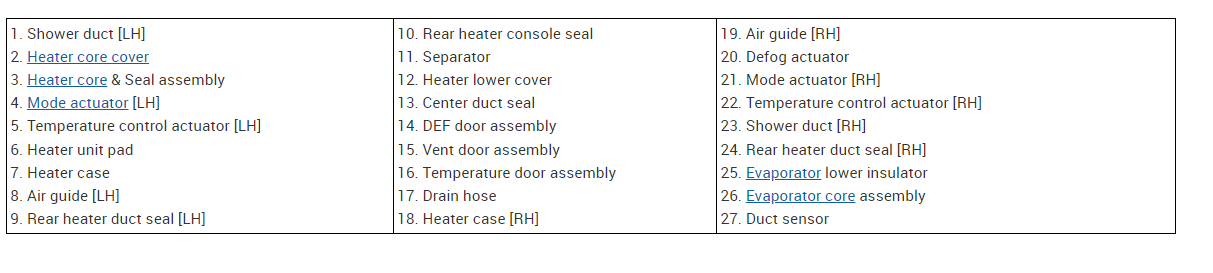

This diagram of the HVAC system is obviously expanded apart, but you can see the location of everything, and the list numbers it all. Please let us know what you find. I will keep looking through service info for anything relevant.

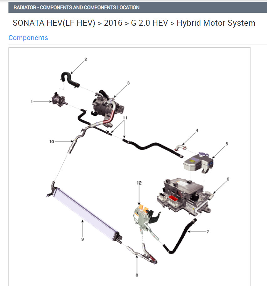

This is the hybrid side of the cooling system.

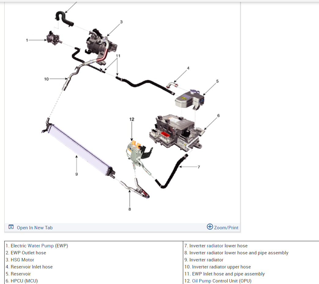

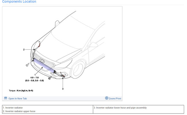

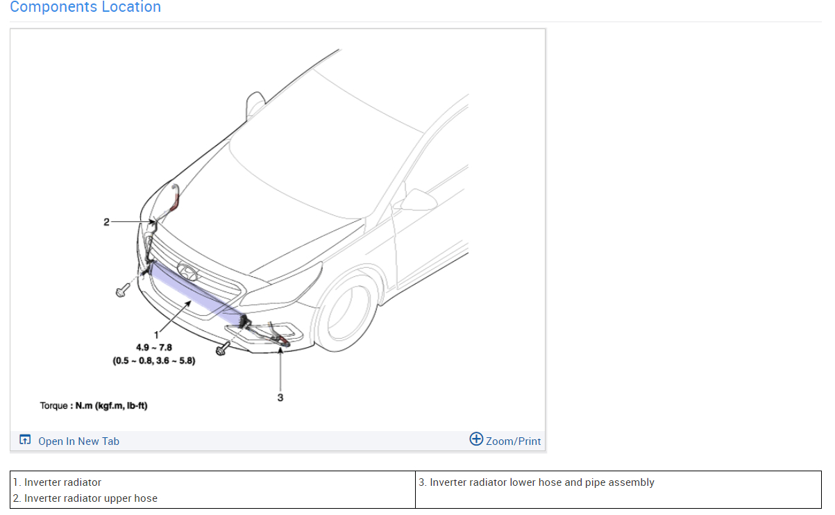

Something else I came across was this diagram of the Inverter Radiator. Which runs along the lower front end, an inverter is what changes voltages from AC voltage to DC voltage, and it produces heat due to the high voltage levels that the Electric part of the engine runs on. So, there are multiple areas where coolant is being transferred to that wouldn't be on a conventional engine. With your lower radiator hose being cold after hours of running, either the coolant isn't being circulated through the radiator or the radiator itself is clogged.

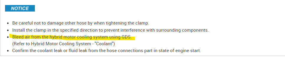

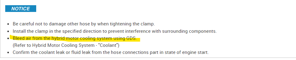

I also see this "Bleed air from the hybrid motor cooling system using GDS". So, using their factory scan tool to bleed air out the system. I'm wondering also if there were any codes stored in any modules, it should be on any work orders or receipts they gave you, I'm sure you have a mountain of paperwork from all this, but for them to replace the entire engine, along with 4 head gaskets, why would they not go after the radiator or Inverter radiator as well.
I doubt they got it very hot running in the shop while diagnosing the issue, it's going to get much hotter while you're out driving for longer periods of time.

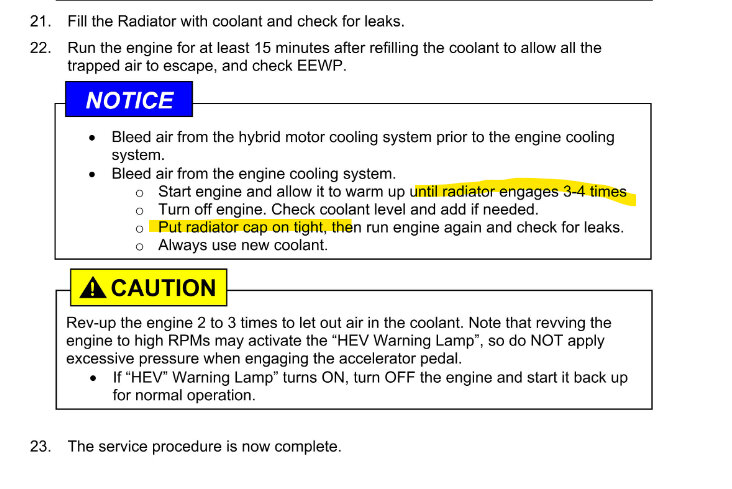

This is their service info on bleeding the system after the EEWP (electric water pump) 5th diagram. Its the same way I would bleed a normal vehicle, when cold, leave the radiator cap off and start the vehicle, and the coolant level will drop while air is escaping during warm up, then refill and put the cap on. I don't recommend you doing the water pump on this, the high voltage sections of the motor can be fatal.

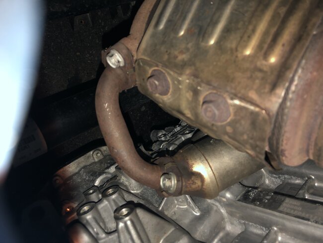

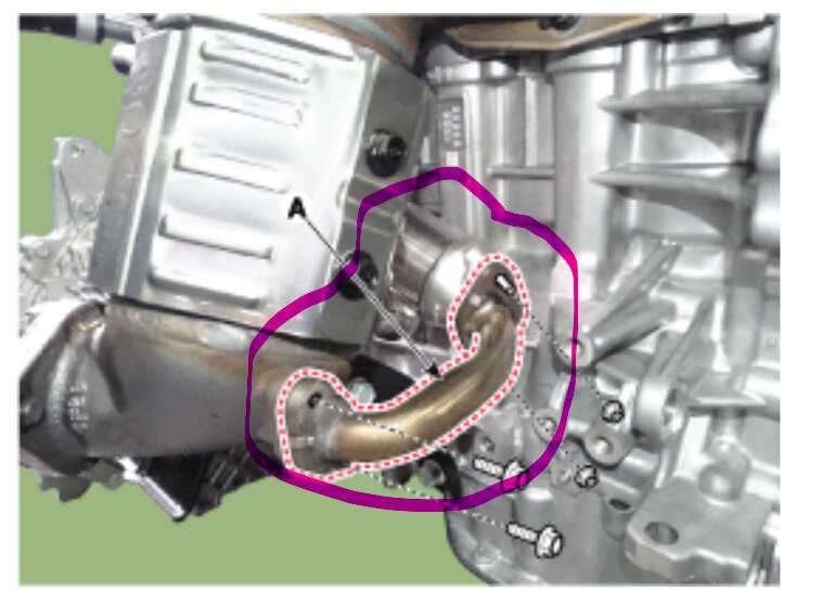

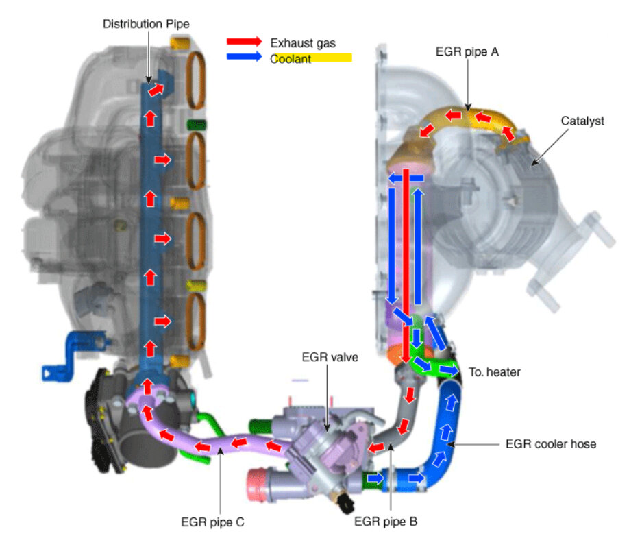

Can you take a picture of the tubes running to the exhaust manifold for me? you can post it here. I'm looking at some different setups, but not sure which one you have.
Is this what you're seeing?

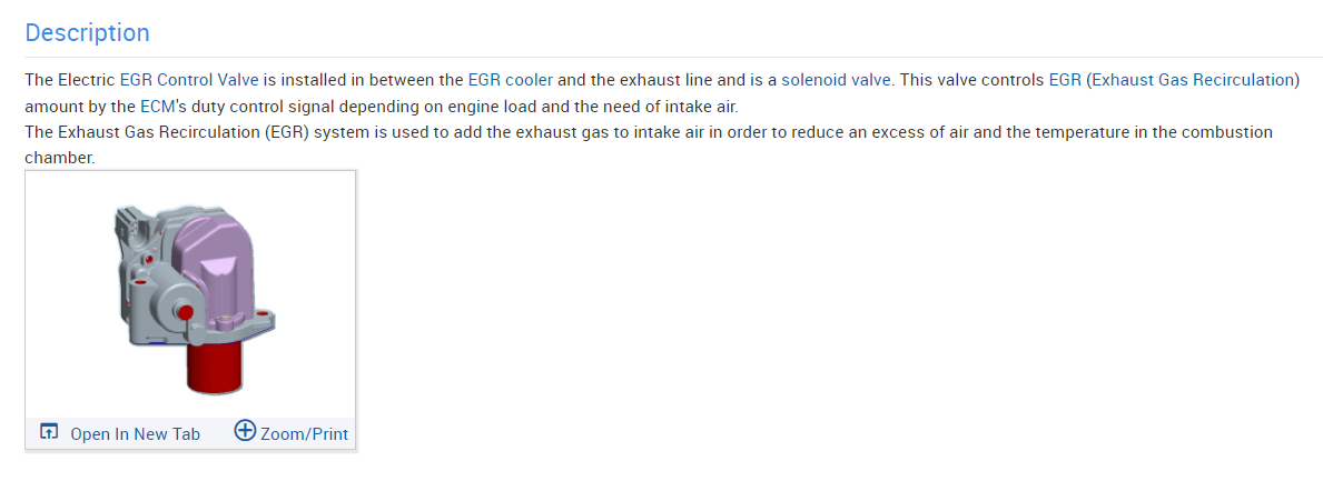

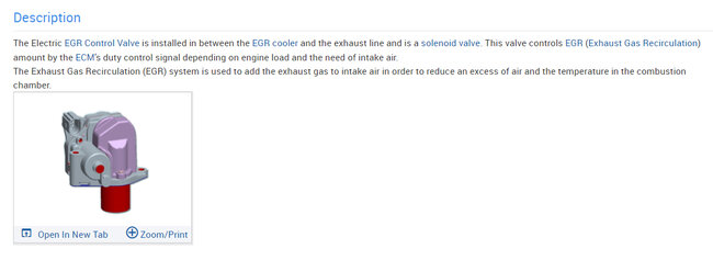

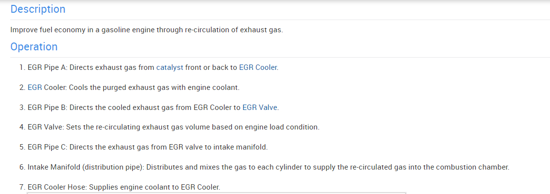

This is an EGR Cooler which cools the EGR exhaust gases with the engine coolant before its directed back into the intake manifold when the EGR valve is activated. Exhaust gas recirculation is used when the engine is under a heavier load, such as wide-open throttle pulls. It allows a small amount of exhaust gases to be metered back into the intake manifold which in turn, reduces in-cylinder temperatures so that NOX gases are reduced.

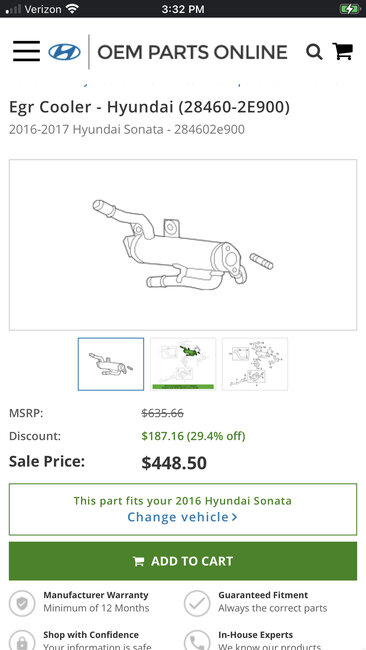

Yes, you’re right. I only got a pic of the passenger side. Did you get the VIN?

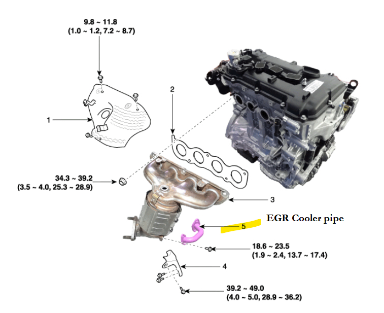

I did get the VIN; this engine does have an EGR cooler which is what I think is in your picture. So, I don't think the issue can be with the engine itself at this point, with a new engine and new head multiple times, it has to be something else external to the engine block itself. I also see a Water temperature control assembly, which is connected to the EGR valve. With all these extra components, being newer technology, I would think they should have replaced this EGR cooler (1st diagram) and the entire assembly to rule it out, they are already replacing everything else around it. The Water temperature control assembly is in the 2nd diagram, you can see it's located at the end of the cylinder head, it has a temperature sensor, and it looks like an electronic EGR valve on it as well.
I think your thought on it is leaking out the exhaust is correct, even though that is a ton of coolant to have gone through in a couple of weeks.

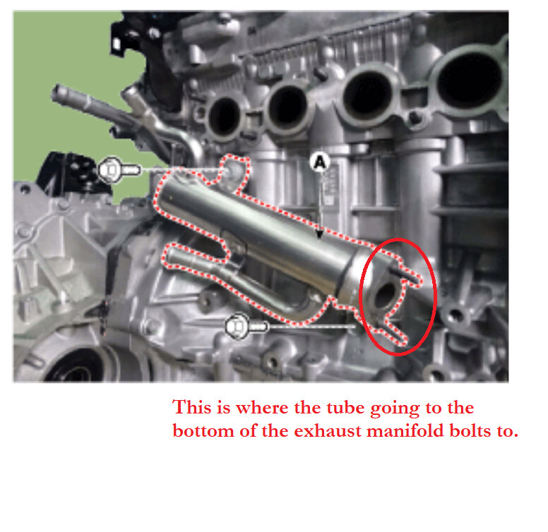

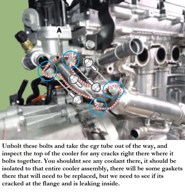

You could unbolt this tube running to the bottom of the exhaust manifold, and leave it off over night and see if any coolant is leaking out of it, thats the end of the EGR cooler, so if coolant is leaking into the exhaust, it might be at that end, especially since its the lower section.
Feb 5, 2024 at 4:23 PM
GOODY1966
  • 58 POSTS
I was trying to figure out what I could do exactly to test what parts of the EGR cooling system to see exactly what and where the leakage is occurring. If I take off the EGR cooling pipe you suggested, apparently, I’m not going to do it while hot, so once cooled off and removed would I still get leakage while sitting still not running? I do believe when the car sits with motor running and then switches to electric mode everything seems good but when it kicks from electric back to motor mode, I think I notice that I get more steam out the tailpipe than what should be. It’s kind of tricky in this colder weather for me to know what’s normal to notice exhaust wise with colder temperatures on what should be and shouldn’t be coming out tailpipe appearance wise. If that makes any sense to you. Nor can I monitor appearance while driving it on what it’s doing under acceleration or engine switching modes. Would it make sense to take the cooler pipe off as suggested? What if my coolant loss is only happening during pressure of the pump running? I’m going to also say it probably wouldn’t be the greatest idea to try to run anything with the pipe off, other than an exhaust leak could anything in the emissions system get messed up if I would try to run the car up to operating temperature after the pipe is cool enough to remove?
Feb 6, 2024 at 6:37 AM
AL514
  • 5,465 POSTS
No, you can't run the vehicle with that EGR pipe off, because it will be like a big hole in the exhaust. I was just suggesting that section for one, because you can get to it, and it's the lowest section of the EGR cooler. So, if coolant is puddling up or leaking out of the cooler jacket it should show up there. and after I posted that, I had another tech message me the same thing, "check the EGR cooler because they can leak inside." If you have thick gloves to where you can remove that pipe after the vehicle cools off a little, or you can just take it off and let it sit and see if anything drips out overnight.
There looks to be 2 bolts on the outer pipe that's attached to the exhaust manifold, and then there are 2 nuts with studs that bolt to the Cooler itself.
If you ran the vehicle with that pipe off it would be so loud and it would also affect the oxygen sensors, so that wouldn't work. The only real options are to remove it hot or cold and let it sit. If you're going through that much coolant, I think you should see it dripping if that's the issue.
Or the last option is to pressurize the system with that pipe off, that will act the same as if the engine were running with 15-18PSI of pressure. If it's cracked inside and opening up when it's hot, it should still leak with a pressure kit on the radiator opening.

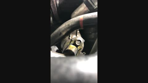

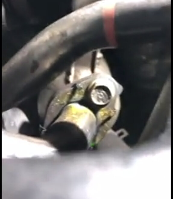

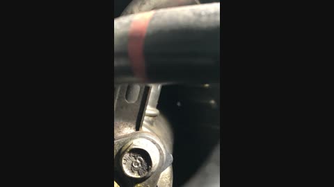

Okay, that’s what I expected. I was in Cory today and had no time to investigate anything. But I did look around when I got home, and I’ll send a video of the EGR pipe on driver’s side where it goes into cooler. So next thing I’m wondering is could the head leak fluid into the EGR tube? Cause what I see in video is definitely not much of the amount I’m going through. Not to mention this was not noticed all the times I looked prior.
Feb 6, 2024 at 2:12 PM
GOODY1966
  • 58 POSTS
Here’s another but still bad video. And I just want to let you know how grateful I am for your help, people like you are hard to find these days.
Feb 6, 2024 at 2:20 PM
AL514
  • 5,465 POSTS
It's difficult to see what you're seeing there. I do see the dye.

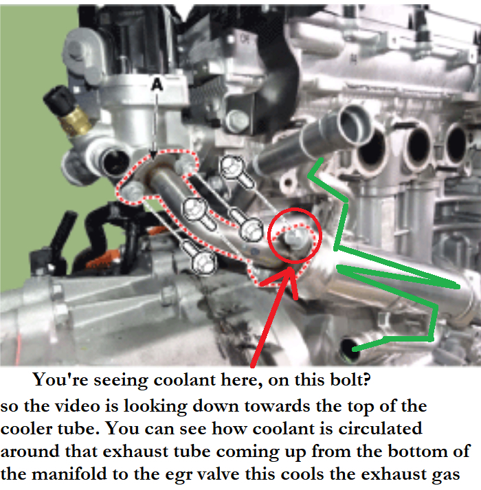

Is this the same bolt as in your video? I can't tell if you're looking at the EGR possibly by the side. Are you meaning the head gasket leak coolant out externally onto the EGR tube? If so. I would hope it wouldn't considering how many times it has been replaced. That being said, yes it possible for head gaskets to leak externally.
Although looking at the video a couple of times, that looks like you're looking directly down at the cooler tube and that bolt is the upper bolt for the cooler to EGR tube. The cooling hoses above that and below it is where the coolant is circulated around the EGR tube, cooling off the exhaust gases before they reach the EGR valve.

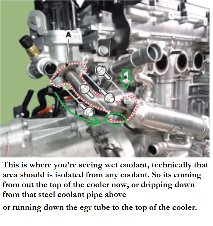

I'm glad to help, this is a tough one, but I do now see liquid coolant there on top of the cooler. so, the problem is getting worse.
Almost looks like it's starting to seep out of the top of it now. And I'll bet that thing has been taken apart a bunch of times.

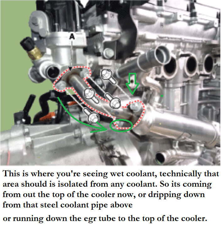

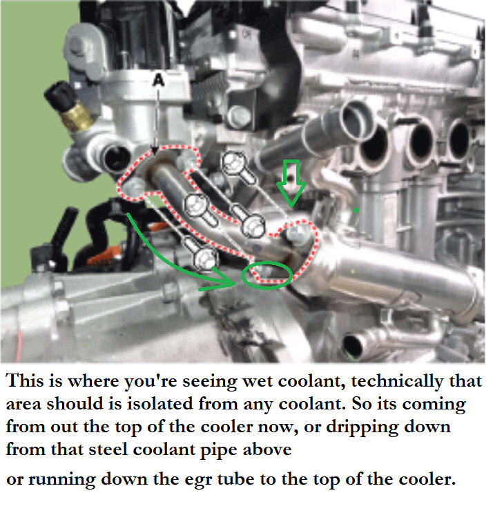

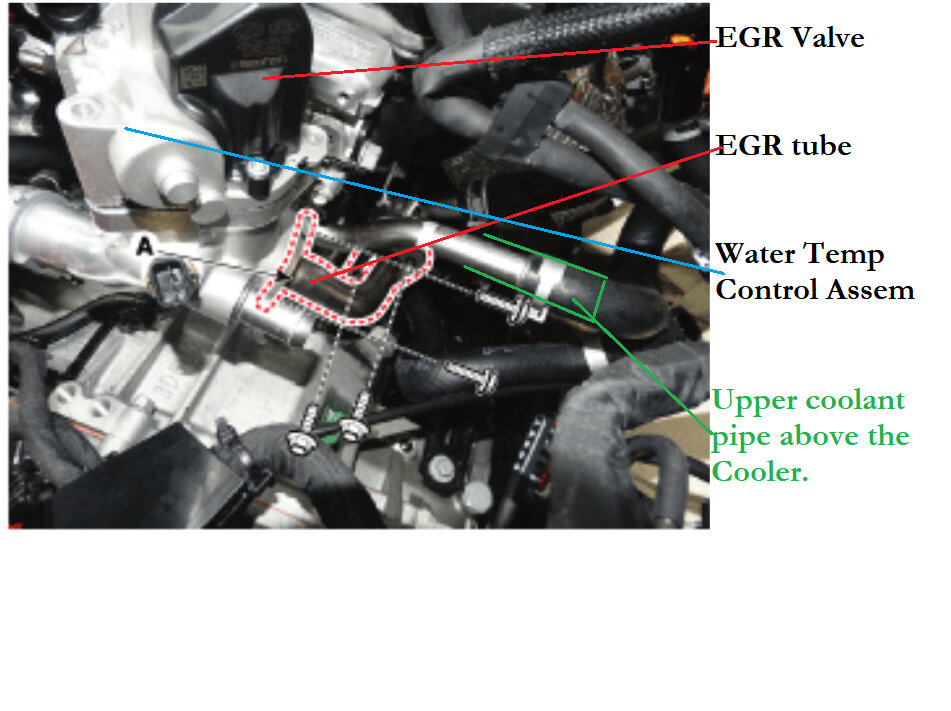

Sorry for all my wonderful artwork but check to see if that EGR tube has coolant running down on the underside of it, if it's not too hot. I didn't see anything in the video from the hoses above it, although I could have missed something.

On the hoses it looked like dry spritzes of the die and at the bottom of the flange was an actual drop or two accumulations coming out of flange. I don’t believe anything is running down the tube itself, I had my hands and phone in there and didn’t feel any wetness, but I will double check and keep an eye on it till I can verify it’s just the cooler and not somehow running out of the head into tube for gases.
Feb 6, 2024 at 3:07 PM
AL514
  • 5,465 POSTS

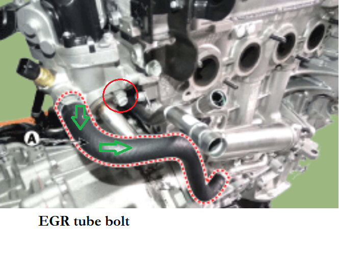

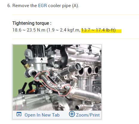

I think if anything, it's leaking probably out of the top of the cooler, and then probably into the tube right where it bolts up there. So here is what you need to do: when it has cooled off, unbolt the EGR tube from the EGR valve, and check that flange you mentioned where it bolts up, check for any cracks where it's leaking out and most likely internal as well. I think you're on the right track there. That tube will have gaskets on either end that will need to be replaced but let's find our leak there first.
The torque specs for those bolts are 13-17 ft lbs.

Just rechecked the EGR pipe and nothing on the underside like it would be coming out the EGR valve housing. I keep calling it the head. And nothing dripping down onto the pipe that I can see or feel. I believe it’s coming out between the pipe and the flange itself or possibly a pin hole in pipe. Regardless it’s either the cooler or coming down the EGR tube from valve, sound correct?
Feb 6, 2024 at 3:29 PM
AL514
  • 5,465 POSTS

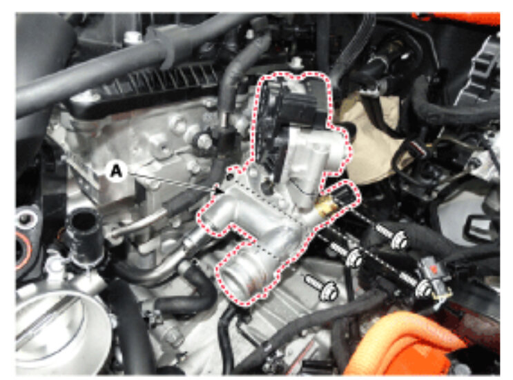

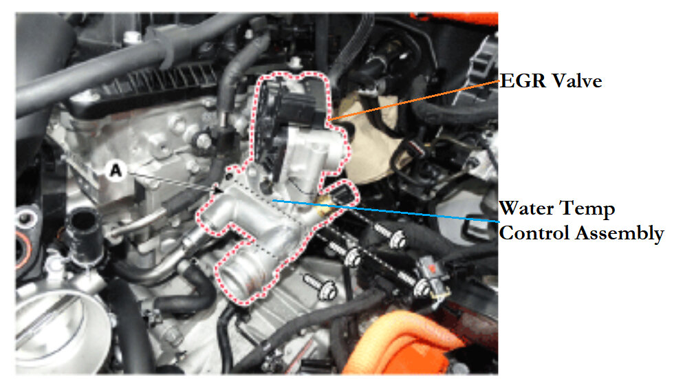

That entire assembly the EGR valve is bolted to is that Water Temperature Control Assembly, the 1st picture is from the back side of the Temp Control assembly, and the 2nd picture is from the front, that tube above the EGR tube in my last post is also a coolant pipe, it just doesn't have its rubber hose attached to it, but you would notice more coolant on the ground if it was coming from any external cooling lines. So, we want to be 100% sure of what's leaking, especially with a $450.00 part.

Where I am seeing coolant is the driver side EGR tube on the bottom bolt of where it bolts to the cooler. Not appearing to run down or drip off of anything. Looks like it’s coming from in between the pipe and the flange that holds it on. So, in order to lose the amount of coolant that I’m losing it would need to run in to the cooler and out the EGR tube that goes from the end of cooler to exhaust manifold. Sound right? I have a habit of overthinking and doubting myself. So, it’s got to be the jacket inside the cooler that went bad unless it’s coming out of EGR valve housing and running in that way. And my wife just returned from store, and she said she heard it gurgle again across the front under her dash when she was inside car before she left, and I was outside feeling around for wetness on pipe and hoses and I heard nothing.
