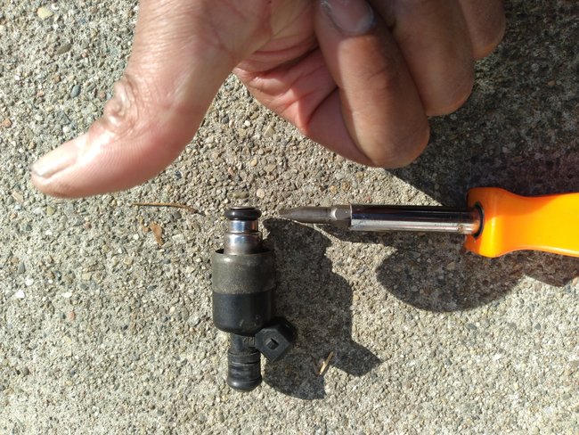

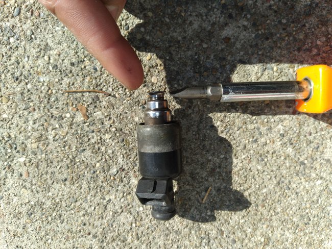

Oh my goodness, I finally found it! It's a clip that has a slight crack in it coming from the back fuel injector! Whew, so now just replace the one fuel injector and we're good! Then figure out that 6 cylinder misfire.

So as obsidian I found the leak coming from one of my fuel injector o rings and I replaced it and now no more leaks! Great so about the p0306 I replaced the coil piece from one from the junk yard now instead of a p0306 I now have a p0300 multiple cylinder misfire instead of my cylinder 6 cheap Amazon spark wires I think. :-)

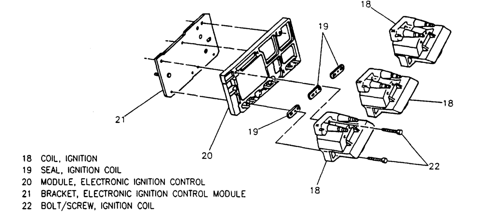

I attached the procedure for the coil below and a picture.
If that does not repair it, I would check the fuel pressure.
Pressure
48 - 55 psi
REMOVE OR DISCONNECT
Electronic ignition control module.
DISASSEMBLE
1. Ignition coil bolts/screws (22).
2. Ignition coil (18) and seal (19) from ignition control module (20).
3. Ignition control module (20) from ignition control module bracket (21), if necessary.
ASSEMBLE
1. Ignition control module (20) to ignition control module bracket (21), if removed.
2. Ignition coil seal (19) and coil (18) to ignition control module (20).
3. Ignition coil bolts/screws (22).
Tighten
Ignition coil bolts/screws (22) to 4.5 Nm (40 lb. in.).

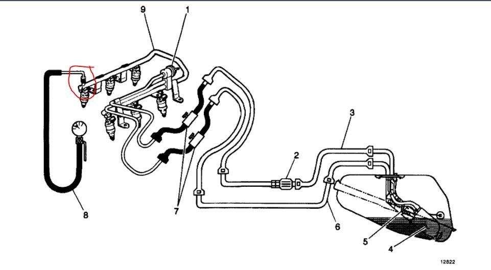

I attached a picture of the test port where you attach the fuel pressure gauge.
The spec is below.
Pressure
48 - 55 psi
Dec 1, 2020 at 9:06 AM

Try this. Sorry.
Dec 1, 2020 at 9:30 AM
IGENIUS92
  • 205 POSTS
Got it, thanks. so on the fuel injector rail that little knob is my test point great. thanks I will keep you updated.

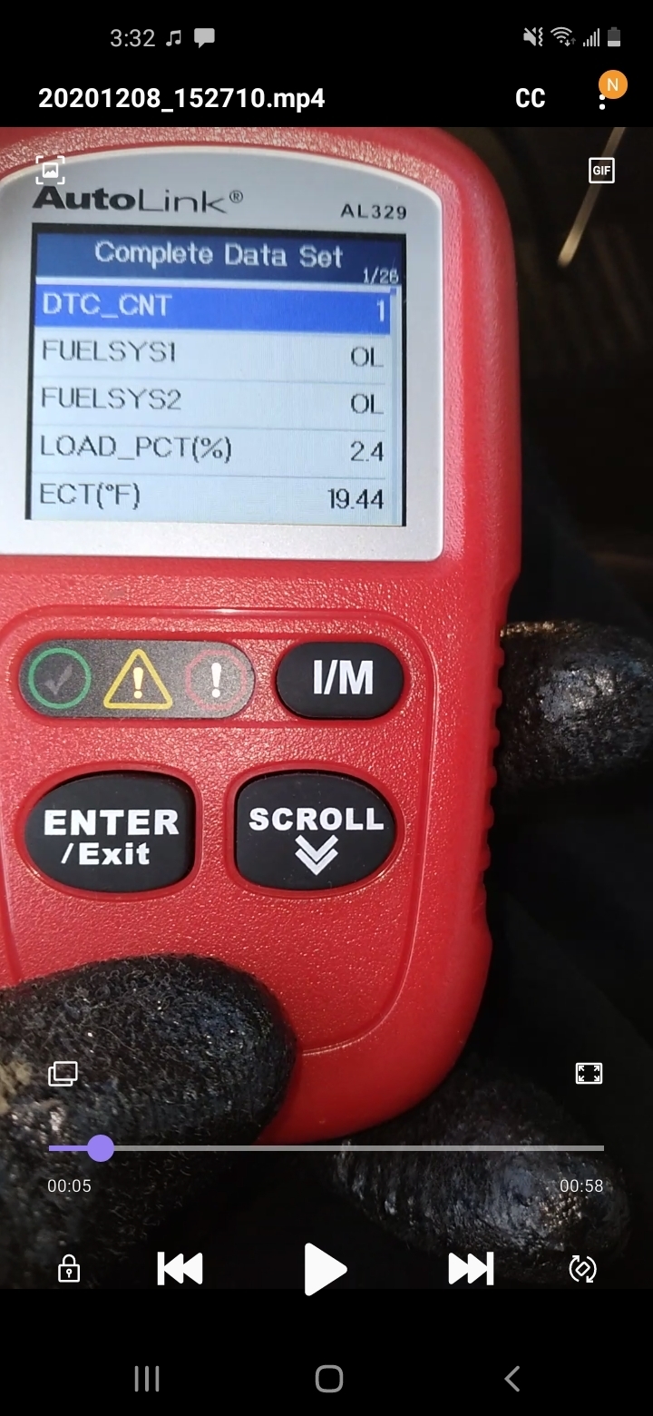

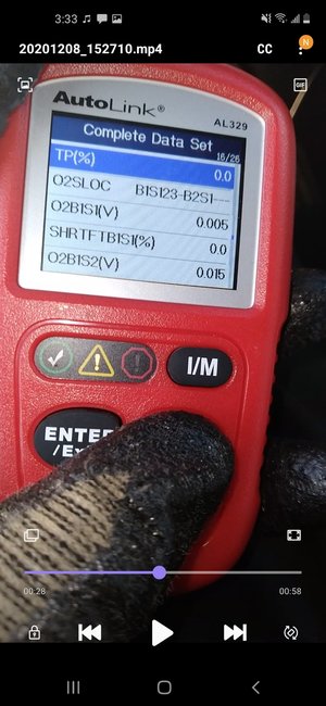

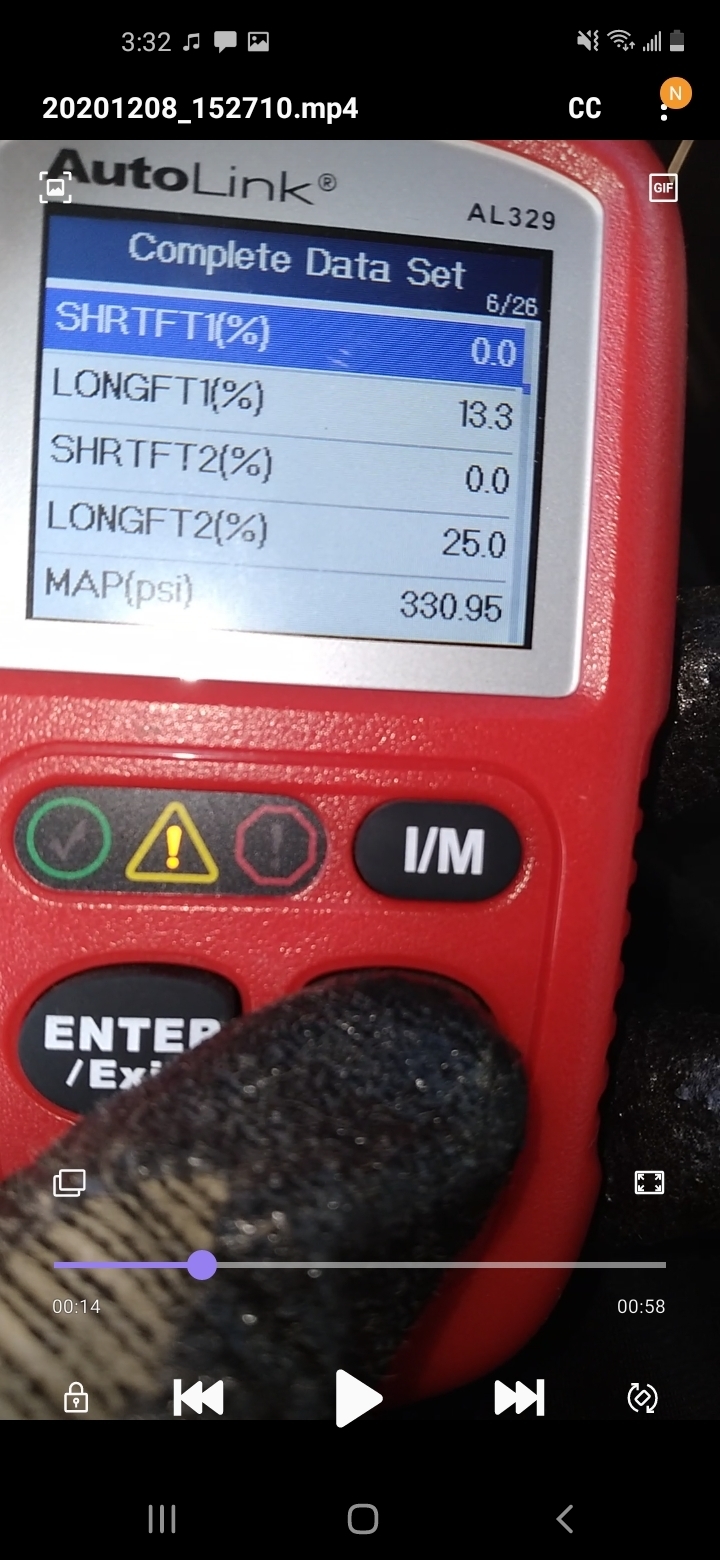

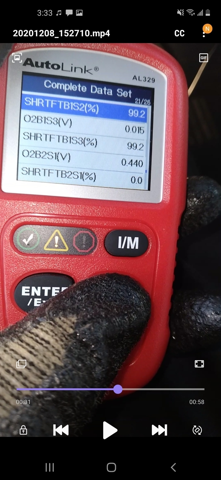

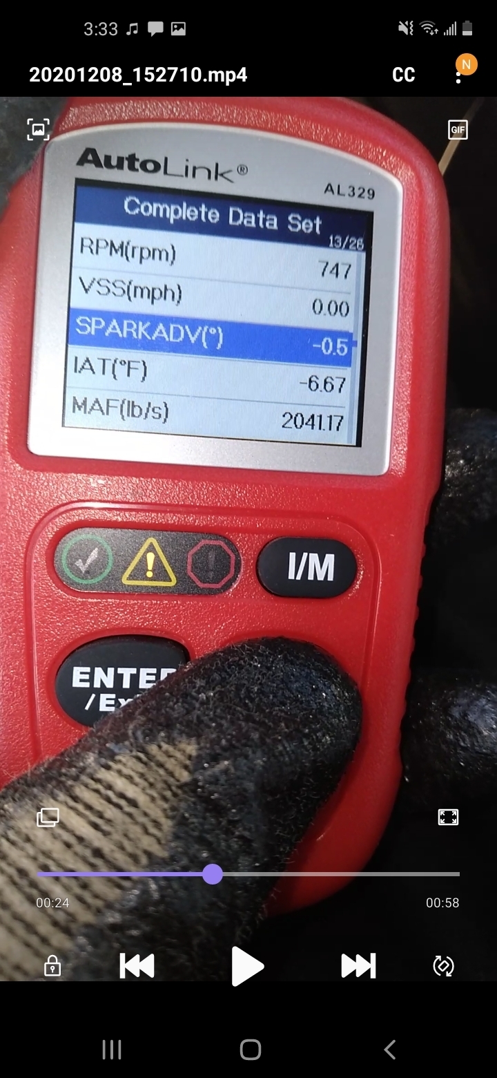

Okay, here is the results from perfectly gaping the sparks .
Dec 8, 2020 at 3:36 PM
Did you use new plugs? Gapping the plugs will have little or no effect on the issue at hand.
What is the fuel pressure?
Dec 8, 2020 at 3:39 PM

One issue i found is one of my fuel injectors was missing another o ring, but I replaced it!
Dec 20, 2020 at 11:58 AM
Good find.
Did you replace them all?
Dec 20, 2020 at 5:39 PM
