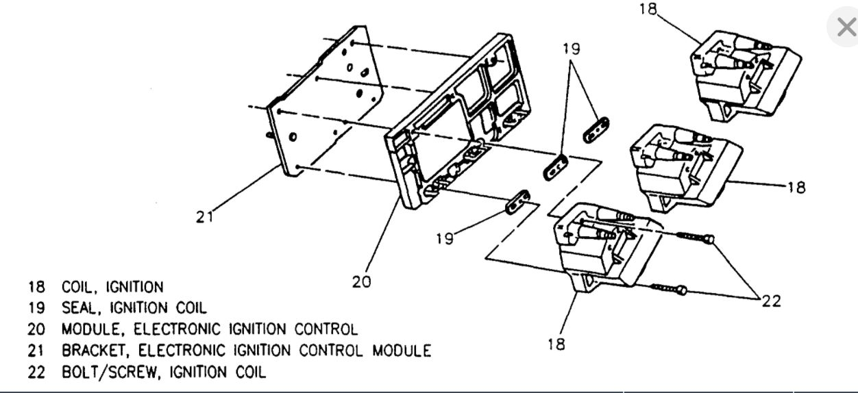

Hello, I have the car listed above that I'm working on and I need to know what size is the lug nut that came of the coil pack plate? It's two nuts and I lost them. I think I took a 13mm to get them off but to replace them what size is the thread? Not the bolts on the coil packs but the two lug nuts that hold the coil pack plate on.
Nov 10, 2020 at 12:15 AM
Good morning,
They are 8 mm, 1.25 thread pitch.

The bracket plate there's two screws that has has two nuts i need the size for those.
Nov 10, 2020 at 1:31 AM
The size wrench or socket will be 13mm.
Is that the information you need?

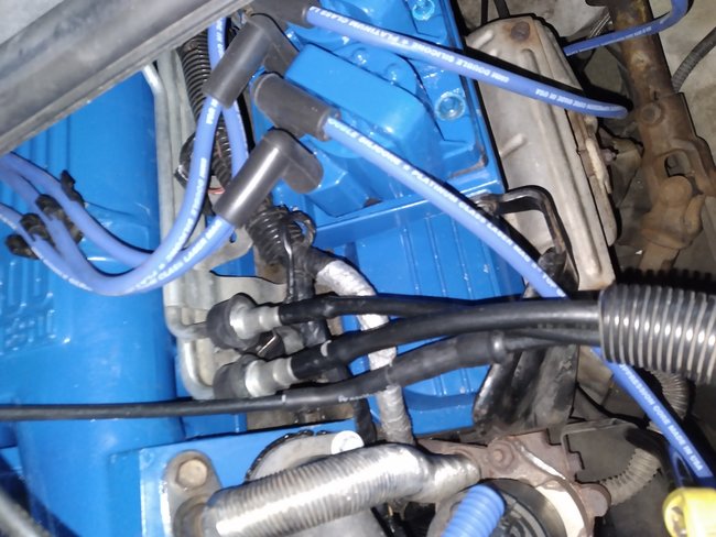

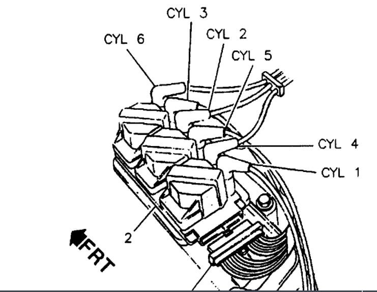

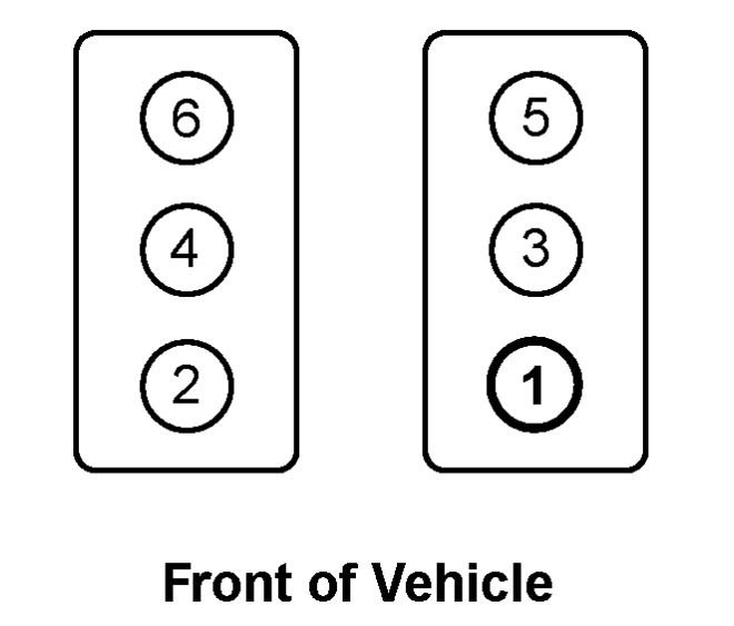

No, I'm sorry. the lug nut thread size for the 13mm nut, and do you know the firing order for the spark plugs? Also the firing order for the coil packs? I'm trying to get the right order for the spark plug wires to connect to the coil packs. guess I should of marked them, lol. but I was in a hurry.
Nov 10, 2020 at 7:49 AM
The stud size is 8mm 1.25 by 1 1/2 inches.
I attached the wire location for the coils and the cylinder identification.

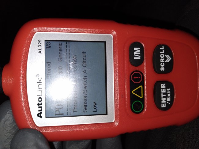

So I took of the fuel lines, air box, MAP sensor, fuel injection system and cleaned up the engine. tried to put it all back together some I marked some like the fuel lines I didn't now it started but running very rough and a few pieces of metal shot out the tail pipe red hot. Also I got a check engine code light on with this code.
Nov 22, 2020 at 5:14 PM
okay, the fuel lines are correct.
I do not like the metal out the tail pipe. I would do a compression test to see if something got into the engine and went out the back.

I do yes, but maybe I mixed up the firing order along with the fuel line? Can you send me a diagram?
Nov 22, 2020 at 5:49 PM
I sent you one already of where the the cylinder numbers are located and the coils where the wires go.

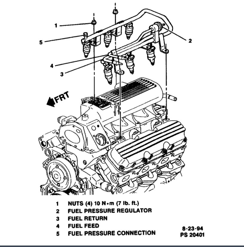

Did you do a compression test on number 6? You need 140-160.
Do not drive the car with a fuel leak. It could catch fire very easily.
Check around the injectors for a leak. I attached a picture for you of the rail.

Can't really see where the leak is coming from the fuel injection system looks fine and dry. it is dripping down near my oil pan just can't see where it's coming from. how would I know if I hooked the fuel rails to the fuel injection system up correctly? If I crossed them up would it even start? This is so annoying i'm ready to drive this car, but the leak is my issue.
Nov 24, 2020 at 7:43 AM
Look carefully around the fuel rail where the injectors attached. Make sure you do not see any fuel leaking.
Check the lines to the rail as well. Make sure there is not leaks where the hoses connect.
