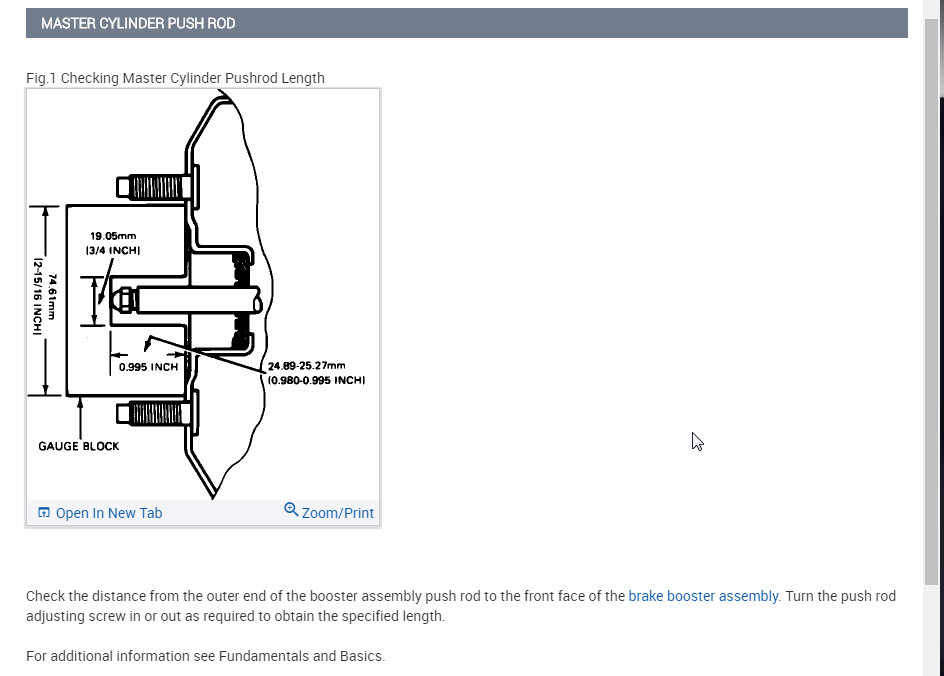

Okay. Today friend stopped by and finished adjusting the rear brakes. Have a little pedal, he mentioned to adjust the brake rod that goes into the master cylinder to get more pedal. What is your thought on that? before I do it.
Mar 10, 2021 at 11:30 AM (Merged)
This is possible but I have never had to do that. I attached the process and is worth a try.

Okay, I'll give it a try. Just wasn't sure if I should try it or if I could make things worse. Keep you posted and if this doesn't do anything I'll get my bolts and start that process.

Well Kenny, I tried adjusting it out a little and basically it may have made the brake pedal a little harder while it's off. But when you start it still goes to the floor. Just trying to figure out what needs the truck to run, to work? Don`t know if there is anything electronic? Or if the booster not working? I guess I`ll need to get to the hardware store for those bolts and basically start from there.
