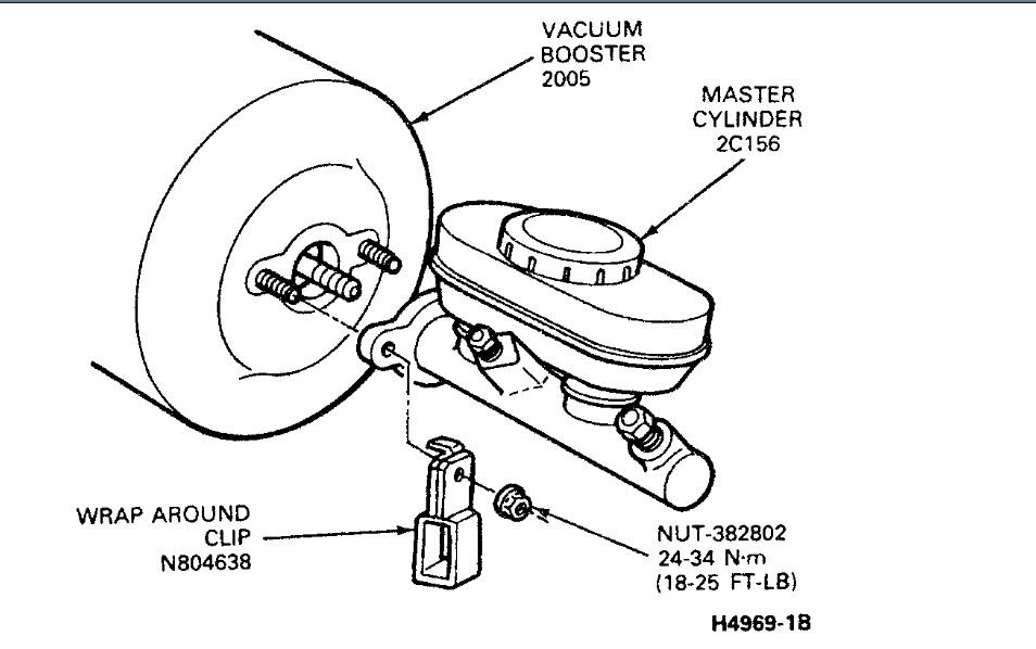

On the the push rod adjustment diagram which is the 1 and which is the 2?
Mar 10, 2021 at 11:22 AM
(Merged)
Hi:
In the picture, number 2 is the push rod (brake booster side) and number 1 is the distance. Is that what you needed?
Let me know,
Let me know,
(Merged)
So 1 is the 24mm and the 25mm is 2?
(Merged)
Never mind that last question. maybe I screwed it all the way back in bled the brakes when I got to to rear driver's side I kept pumping with hose and bottle and a lot of air came out. I don't know if it was getting empty in the reservoir. But I filled it back up. And kept pumping so I move on to the next brake no air bubble came out the drivers front and no air came out .

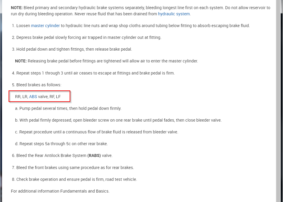

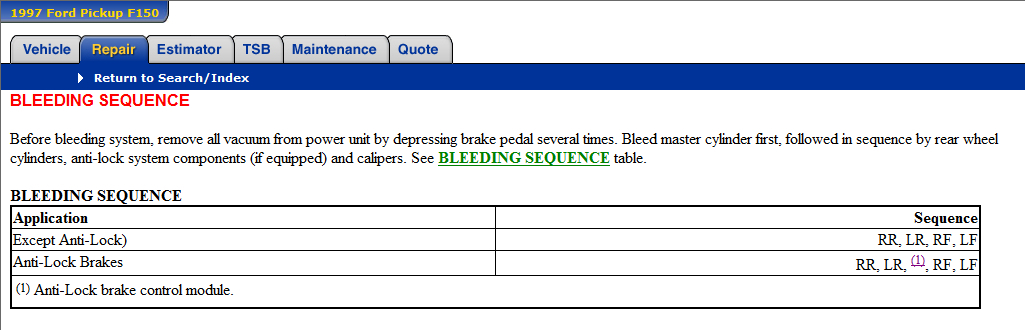

Hoping to get to the store on Saturday, figure I`ll get the bolts and probably get the master cylinder. I don`t get there to often due to transportation. so that way if it turns out to be the master cylinder I`ll have it to change out, if I don`t need it then I can bring it back. Thanks for the bolt size information, didn't think of that. to bleed the brakes do I need to take the spring out of the ABS unit. I seen a thing on YouTube that said you need to take the spring out, and I actually have no idea. But I can take it out if needed. thanks
Mar 10, 2021 at 11:30 AM
(Merged)
No. I don't believe you do. I am not sure what you saw on the internet but once the ABS is bled it doesn't need to be done again. If you can post a link to that video, I will take a look and see what they were saying.
Thanks
Thanks
(Merged)
it`s on YouTube, (how to bleed brakes with RABS ( Ford ABS ). When I was checking to see if there was another way to bleed brakes. Now when I bleed the brakes, start passenger rear, driver rear, passenger front then do I bleed ABS valve ? then driver front?
(Merged)
Hi Kenny, well put the new master cylinder in and bench bled it. Then I was going by the process sheet you sent, but not really getting any fluid out of the ABS valve. Is there a certain way ? I even left it open and pumped the brakes and got very little fluid. I would say it has to have fluid somehow going through it because I bled the rear brakes okay. Could there be that much air in it? Thinking of trying to gravity bleed it and just hook a tube to it and crack it open, not sure what to try next.
