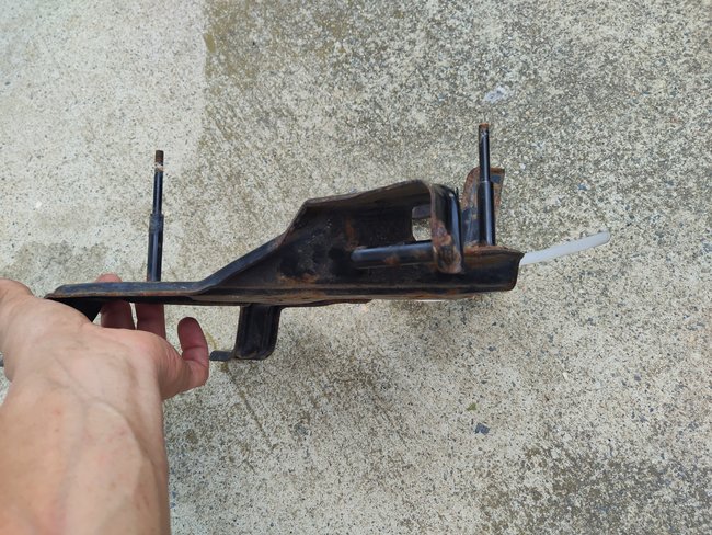

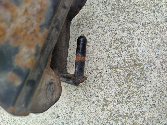

Here is the bracket. One of the posts snapped off. Also, the little ring of rust on the hanger caused a small gap between it and the bushing. Those two small things lead to that very intense vibration and noise.. only two bolts hold it into frame. Unfortunately, the Mercedes top mounted it and I had to remove the bumper and headlight to get to bolts. Was not the easiest thing to do by yourself.

Thank you for trying to give me a hand. Companies like making things difficult. To remove the bracket, I had to remove the bumper and headlight. It doesn't sound like much but remember it's a Mercedes. To fix that all Mercedes had to do was weld 2 nuts in top of bracket and use longer bolts. Pretty much doing a bottom mount. But now they can charge a poor person $600.00 for something that should only take 10 minutes.
