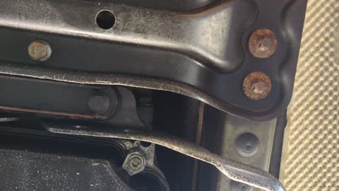

Jun 29, 2022 at 9:34 PM
I posted two videos, what do you think is causing it? It seems to be louder on the right side.

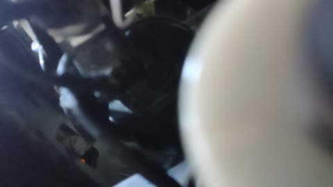

To rule out the drive shaft or bearing flex plate. I'm going to place my phone in the middle of the car around the transmission. If those noises are louder and more pronounced, it means something with the drive shaft is bad. It's just so freaking weird that all of this started when I replaced the compressor for airmatic. It's located behind fog light in wheel well. I had to reinstall the main hose as it blew off. Now it's worse after touching the compressor again. Nothing is rubbing that was my first thought. It's driving me nuts since everything happened after, but nothing is causing it.
Jun 30, 2022 at 3:47 AM
So, I put the phone about 6 to 8 inches from the center of drive shaft next to bearing. While the rumble/grinding barely happened. It did that binding scraping when coming to full stop slightly. While it barely happened, you cannot hear any of those noises from yesterday at all. So that rules out that part of the drive shaft. Now I have to find a way to get my phone to stay under or on side of transmission. If there is little to no noise that means the problem comes from the right wheel. As that was the loudest pronounced so far.

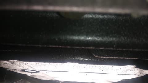

This video is under the bearing for drive shaft. I don't hear anything that screams bad shaft flex plate ECT unless I'm just missing it. Out of all the videos the right side seemed the loudest and worst by far. Both hubs are Brand New. They came with new races, bearings and seals already pressed and prepacked. Yesterday when I drove around and did heavy acceleration, I realized what it feels like.

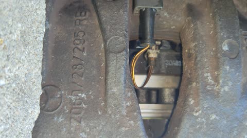

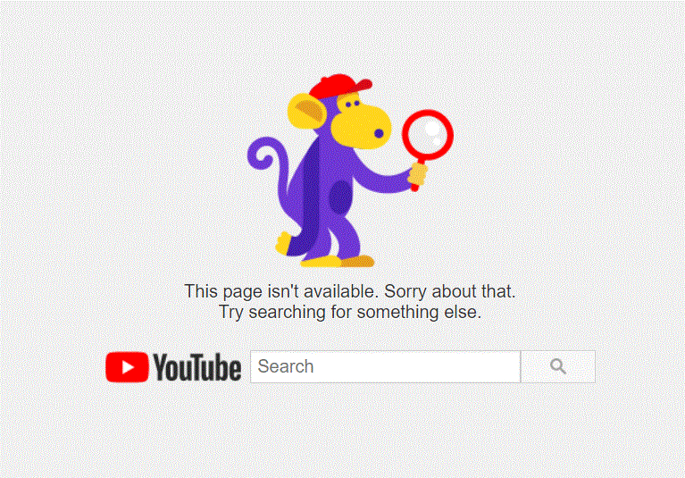

The brake pad is an issue. If the pad doesn't make contact, the pins are clean and lubricated, and where the pads mount to the carrier are clean and the pads move freely in them, replace the caliper.

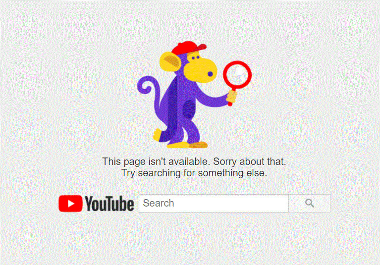

As far as the YouTube link, it wouldn't let me go to it. See pic 1 below for what I get.
Also, what am I listening to in the first video you made?
See pic below.

Jul 4, 2022 at 10:18 PM
The first video on this page is my driveshaft right at the center support bearing. The video on YouTube is someone with a very similar car who's bearing and rubber support is bad. It's the exact same noise and movement. Also, on Mercedes they use flex plates/ flex disc (5 different names used) at each end of drive shaft that connects to differential and transmission. They are a documented known failure point and consider a must replace every 10 year or less item. I'm not talking about the flex plate in transmission. I'm not sure if that's mixing anything up. Just letting you know to clarify. I'm not sure if that's causing all the issues. The support is definitely bad and has to be replaced anyway. Since the driveshaft has to come out you might as well do the flex plate also. As for the breaks everything is cleaned and lubed 5 times now. Nothing is sticking or binding. I'm waiting for the shop next to my house to open. I'm just going to drop it off to them and see what they say.

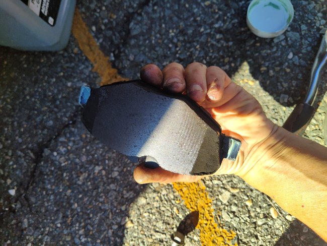

I am going to replace the right caliper as well. It definitely has something wrong with it. Also, I have noticed something but haven't thought about it much until now. My steering will pull randomly to one side then it will slowly correct itself. I didn't think about it until now since I knew my outer rods were shot. Since then, I replaced both and it still happens. Since the noise seems to be from the right of car I'll start there.
Jul 5, 2022 at 7:45 AM
That is either coming from the rotor or the new pad hasn't fully worn through the top layer.
