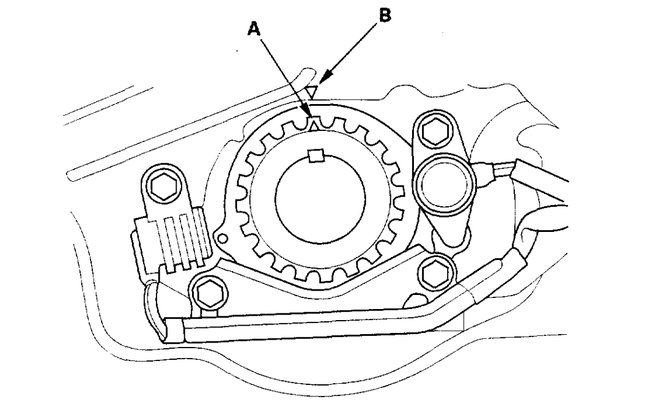

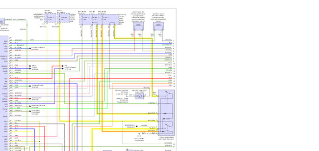

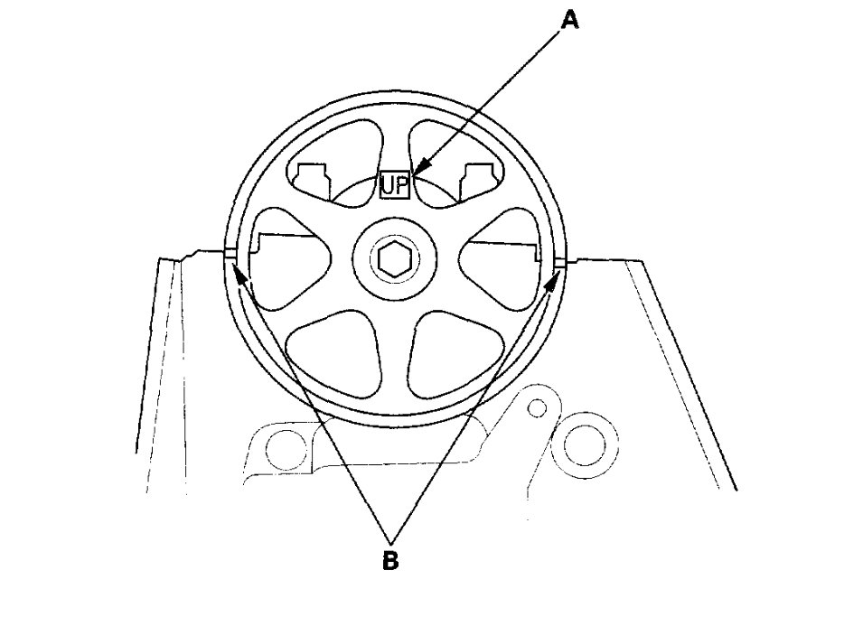

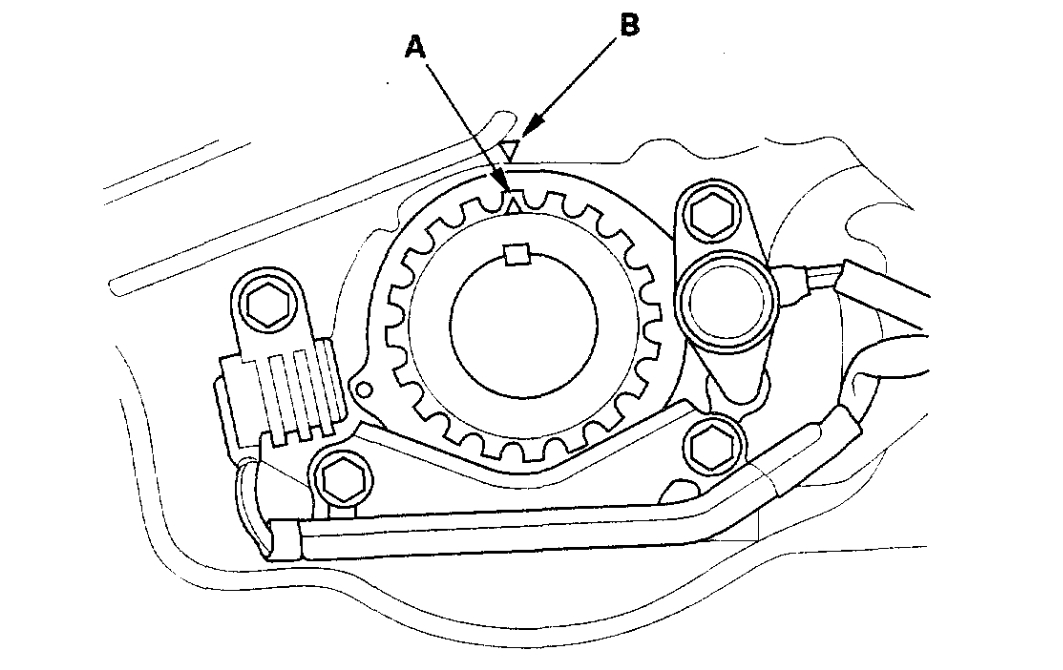

This could be the engine timing belt has jumped out 1 or 2 teeth. I'm attaching repair guides and the timing marks below. Let us know if you need more information.
https://www.2carpros.com/diagrams/honda/accord/1999
When you turn the key to the on position without cranking the engine over can you hear the fuel pump run in the tank for 5 seconds?
Check out the diagrams (Below). Please let us know what happens.

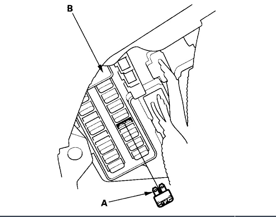

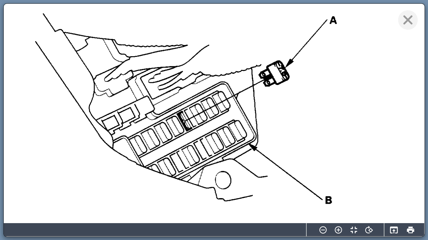

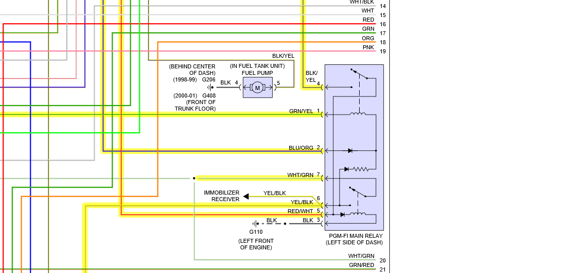

What is the third image of? Or what fuse is that and is it in the car or under the hood?
Mar 24, 2020 at 10:37 AM
TOUGHDIVER
  • 224 POSTS
I attached the third imaged by mistake the fuse is the one you pull to reset the computer.
Remove the back up light fuse 7.5 A (A) from the passenger's under-dash fuse/relay box (B) for 10 seconds. But if you clear the trouble codes you might need them or a repair shop my need them for diagnostic purposes. Let us know if you need more Info.

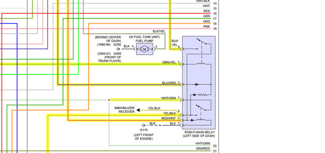

03/23/10 - Found out it is the main relay
Sep 28, 2020 at 4:49 PM (Merged)
KHLOW2008
  • 41,814 POSTS
Hi David0217,
One of the item that would cause intermittent non starting due to lack of fuel is the PGM-FI main relay.
When problem occurs, you need to check if the fuel pump is running at initial ignition on.

I am wondering how to check power supply to the distributor black/yellow wire & fuel pump? (Voltmeter? If so can you give me a few more details. I have used a voltmeter a couple times, but am not that proficient with it.
I tried pulling one of the spark plug wires and putting another spark plug in it to see if it received spark but I couldn't see any.
I have tried to listen and see if the fuel pump engages when the ignition is turned on, but I don't hear anything. I obviously need to follow your instruction and test the power to the both the distributor and fuel pump, but would greatly appreciate a little more instruction.
Thanks Again!! HRJ77
Sep 28, 2020 at 4:50 PM (Merged)
KHLOW2008
  • 41,814 POSTS
Hi HRJ77,
You are welcomed.
So far so good, we are going in the correct direction.
No sparks at plug means the distributor is not providng any, hope you did ground the plug while cranking.
To check for power supply to distributor, unplug the coupler and connect the Black/Yellow wire to a voltmeter or a test lamp to ground and turn ignition switch on. Battery voltage should be present/test lamp lights up means power is available.
If no power supply, you need to check for broken wires, blown fuses, bad or disconnected wire connectors.
We settle this first.
