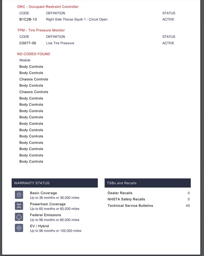

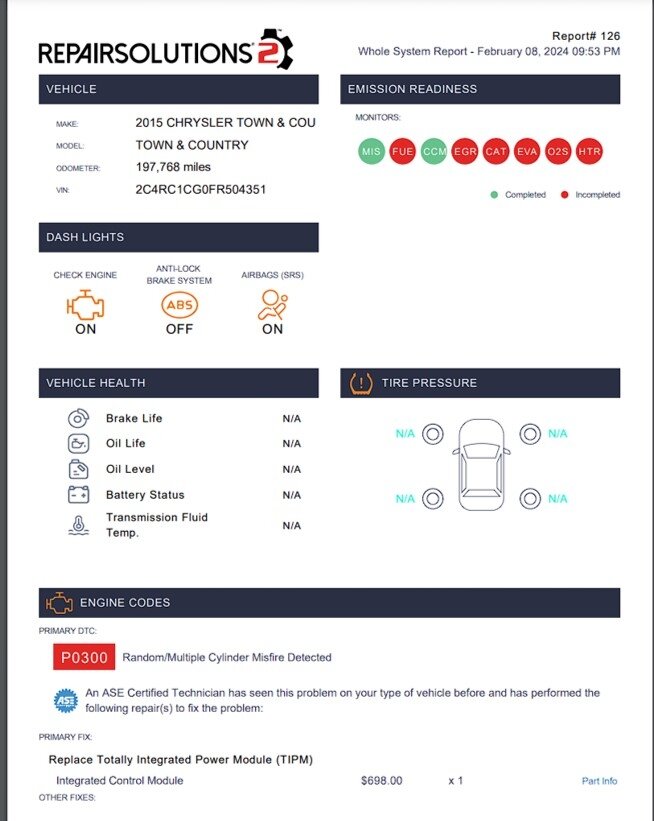

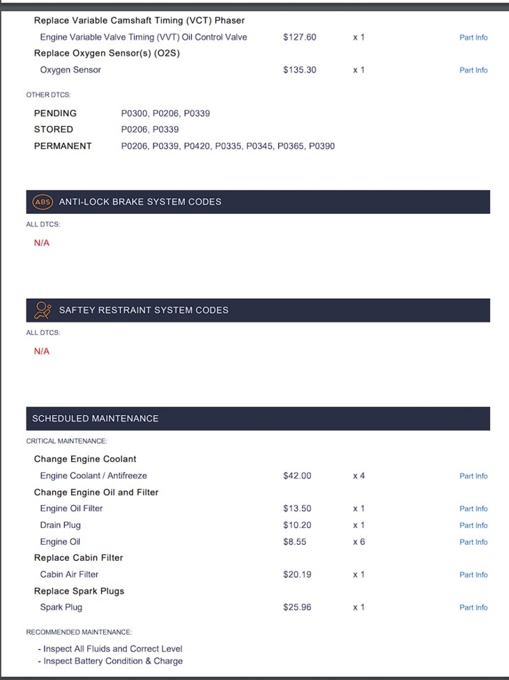

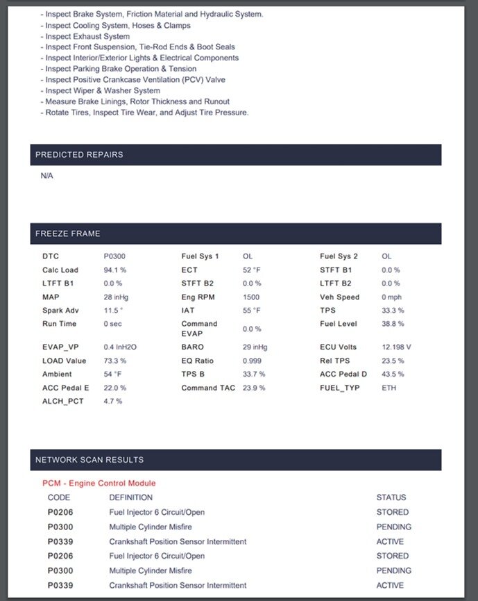

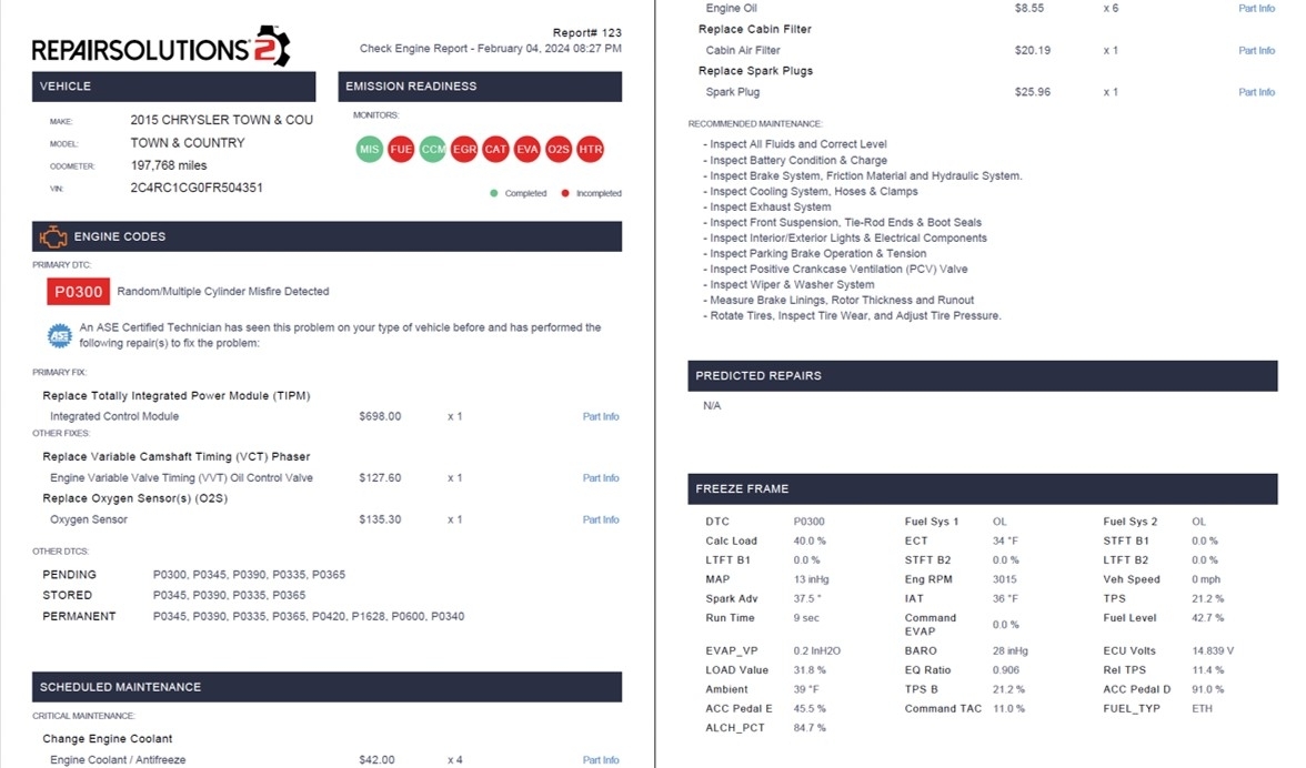

You shall notice in this report the five wiring codes came back, plus other. This report recommends changing oxygen sensors, which I can easily. But I'll wait for your recommendation. I'm not at all against changing all plugs and Packs, it's cheap easy and needed. But I'm not sure about the "Recommended fixes" and changing the VVT oil control valve. I am so glad it ran on its own for a few minutes. White smoke and stunk like a Skunk.
Feb 4, 2024 at 2:25 PM
Yeah, I wouldn't rush into those "fixes". Most of the time those are the same things the parts store is going to sell you for parts. Many times they don't actually track parts sold = actual repair. So, you have a random multiple misfire (P0300), they sell you a set of plugs, except they rarely fail in groups! Same with coils. However, it goes on the books that "we sold X number of sets of plugs to fix a P0300 code", so that is a possible fix that pops up.
Remember it hasn't run for a while and you have been trying to start it. Every attempt dumps fuel into the exhaust and that is going to take a bit to clean out. It's also likely the P0300 is from that and the cam codes. The cam sensor circuit codes returning that way though isn't a good sign for the ECM. You tested that they have ground, they have power, but the ECM still doesn't see them. Makes me think that there is corrosion or a failure inside it. Unfortunately, there isn't a great way to find that for a DIYer and they are not plug and play. However, you could check the powers and grounds to the PCM. If they all check out and the sensor wiring all checks out, but you still get errors, there isn't much left.
The TIPM is doubtful as a problem as the engine will run and the sensors are not powered from it directly.

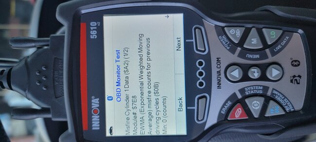

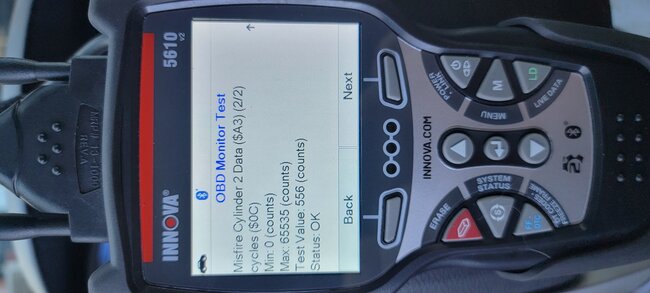

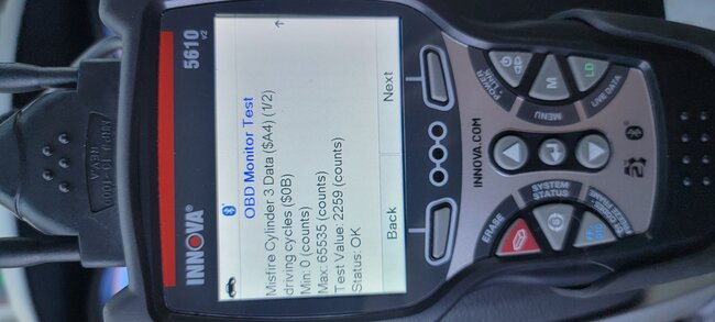

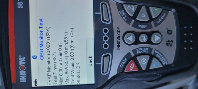

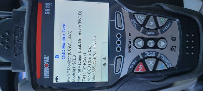

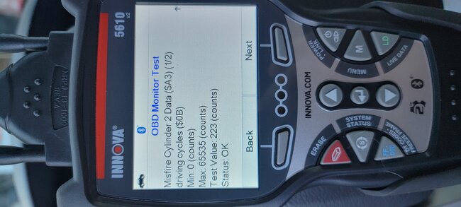

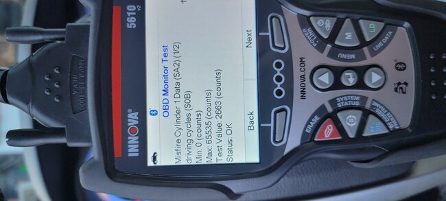

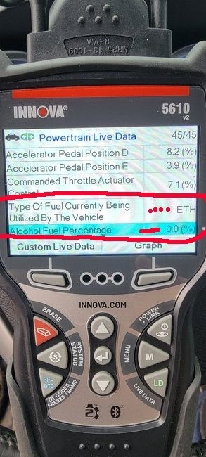

I also wanted to ask about some readings I got on the scanner. I'm sending pictures of those readings. I'm interested in the cylinder misfiring. And I'm wondering if I'm reading it correctly. Plus, an evap screen shot or two. Again, I'm not sure what I'm looking at...

Sounds like there is bias voltage at the sensor and it's likely okay. Running as long as it did shows that the sensors are working at least most of the time. Pin 3 to ground should be 5 volts (which it is pins 3-1) Pin 1 is ground pin 2 is a simple square wave signal that changes state as the engine rotates, and the sensor reads the reluctor. It basically turns on and off and tells the PCM where the crankshaft is by the pulse count from a trigger notch.
For the misfire readings it looks like 1&3 are the worst offenders and 2 might be clearing itself out by the counter trending down. Typical of an engine that hasn't run for a while but had several starting attempts, the plugs get fouled from the fuel.

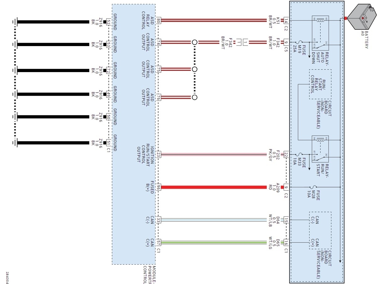

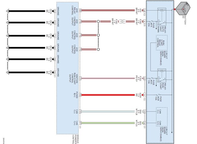

It uses the Auto Shut Down relay for the engine shut down, but that relay is easy to test. Pick any coil positive feed, turn on the key, do you have voltage? Yes= ASD is okay.
