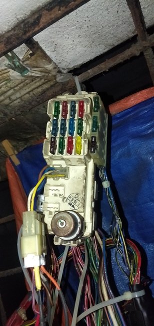

I need wiring back fuse relay block junction how to read wiring colour & pin diagram directions tq
