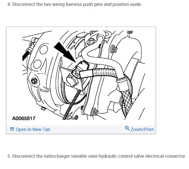

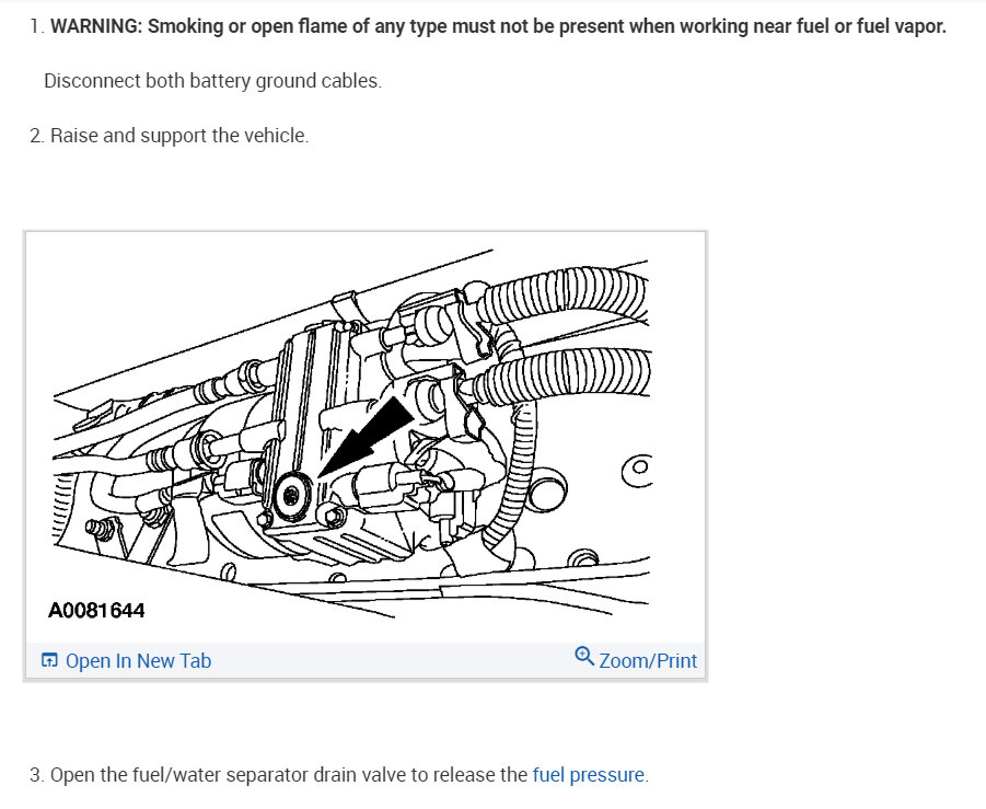

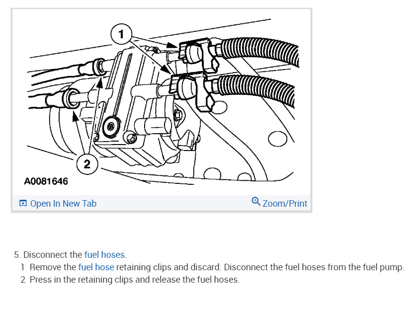

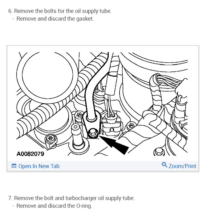

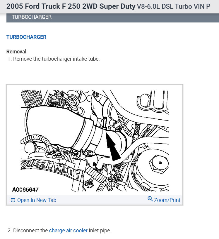

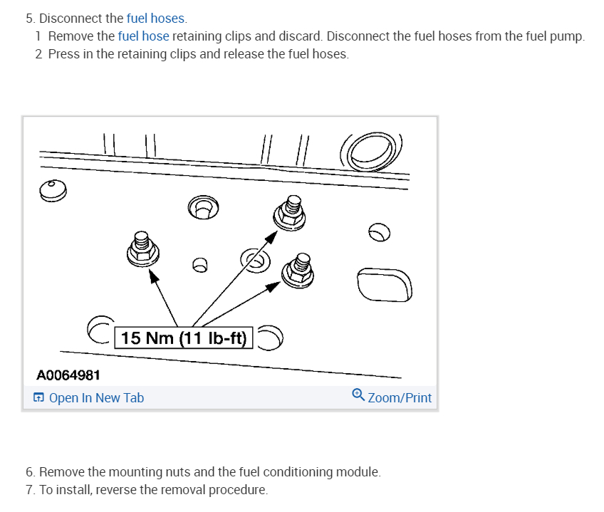

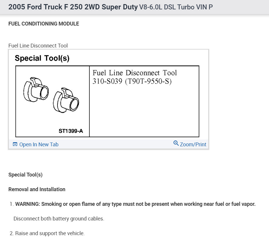

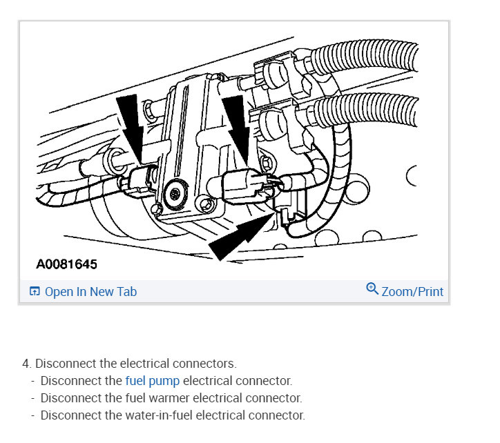

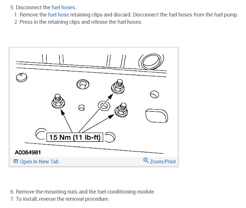

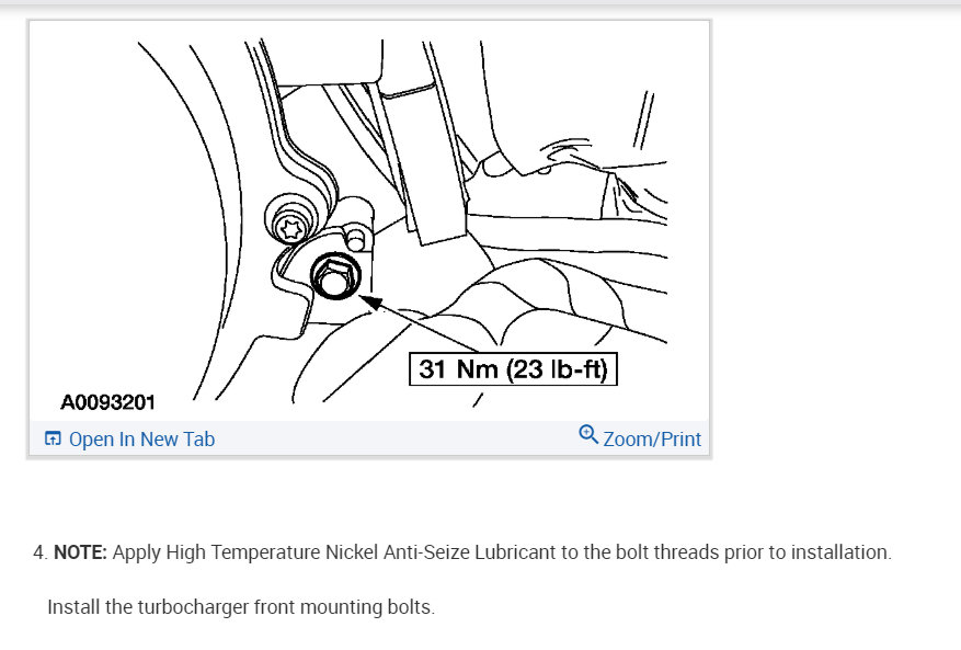

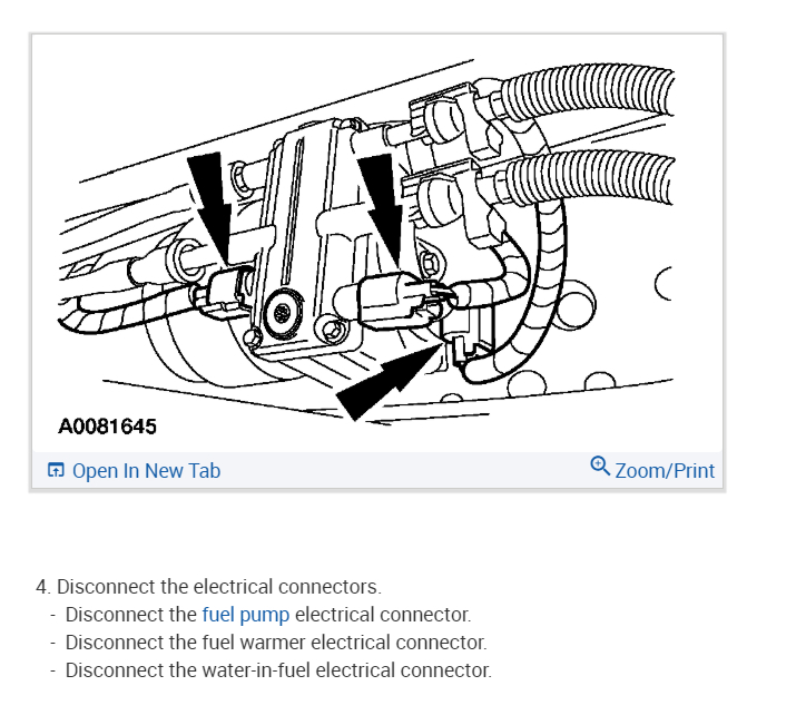

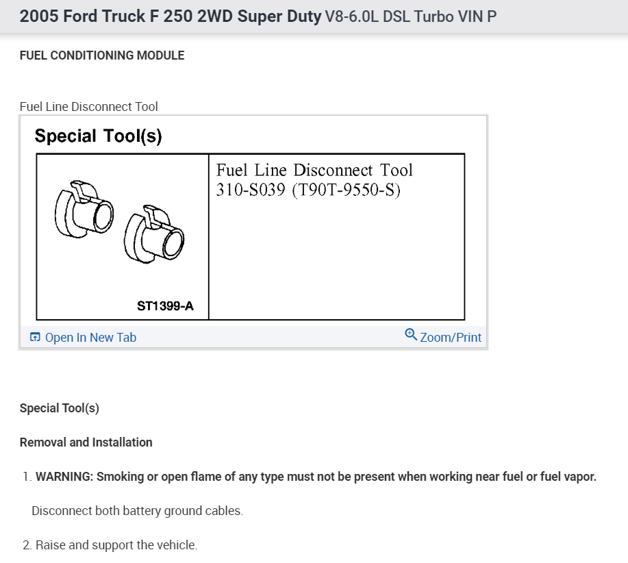

This sounds like a fuel filter needs to be replaced or the turbo has gone out, Lets try the fuel filter first here are the instructions in the diagrams below. Check out the diagrams (Below). Please let us know what happens.
Jul 29, 2020 at 12:47 PM (Merged)

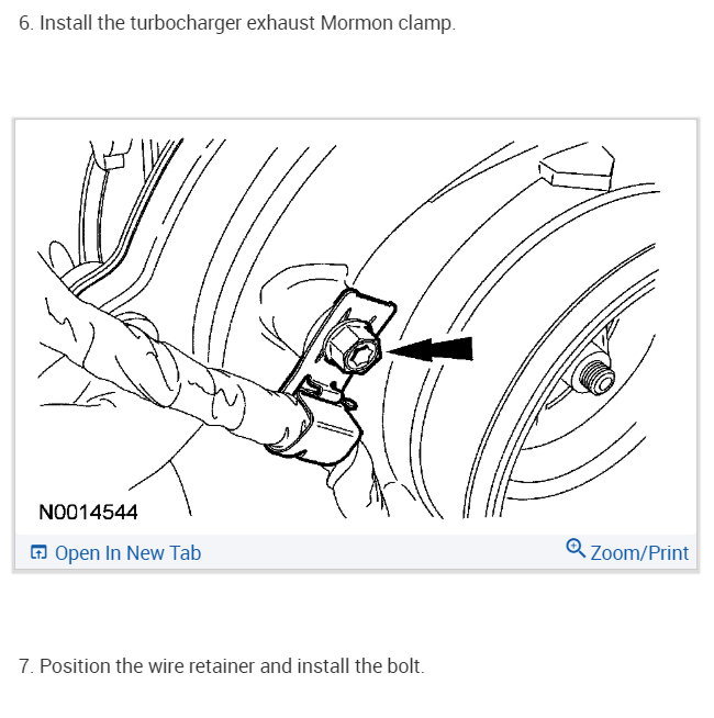

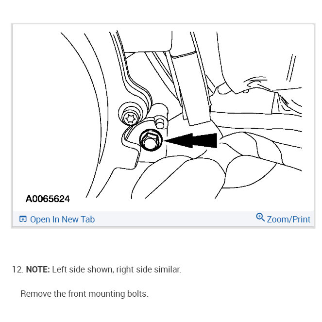

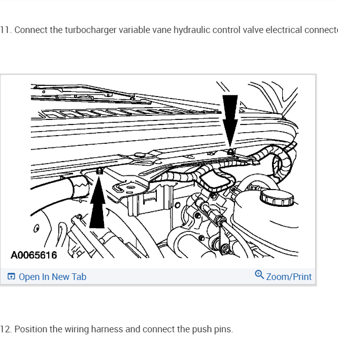

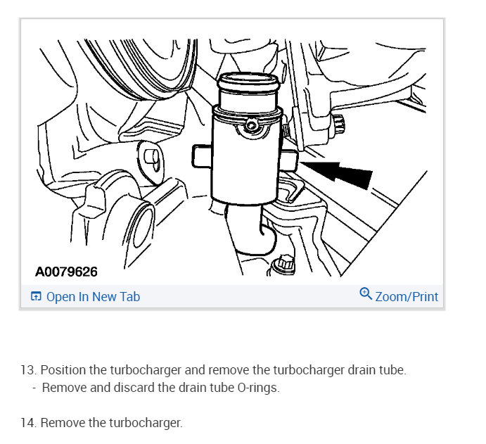

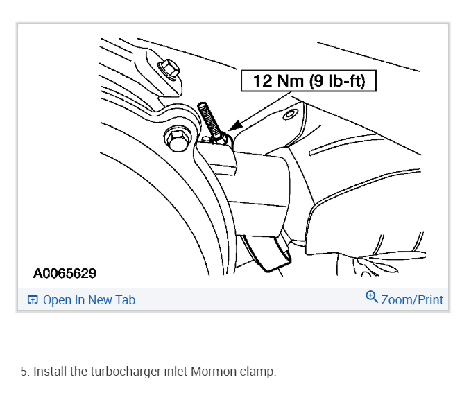

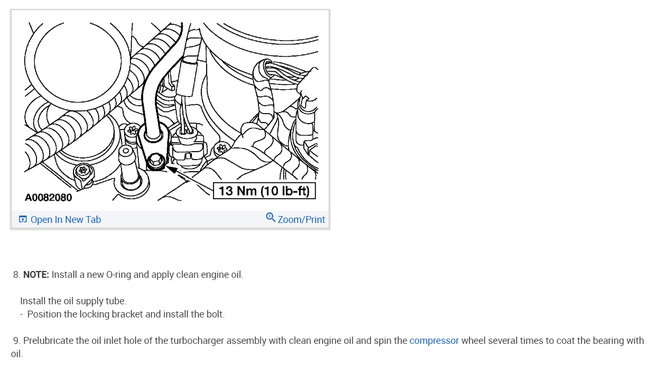

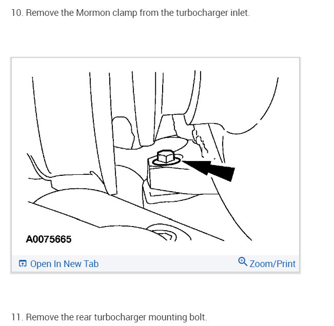

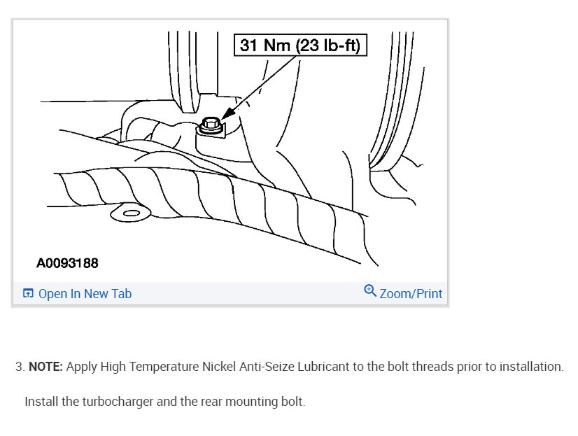

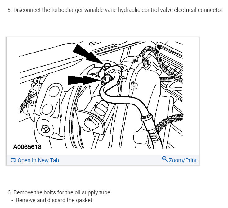

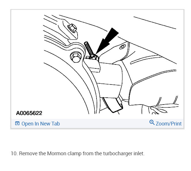

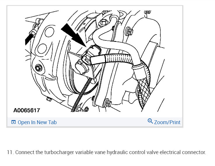

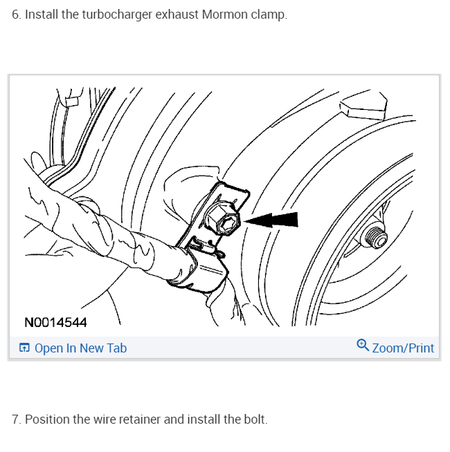

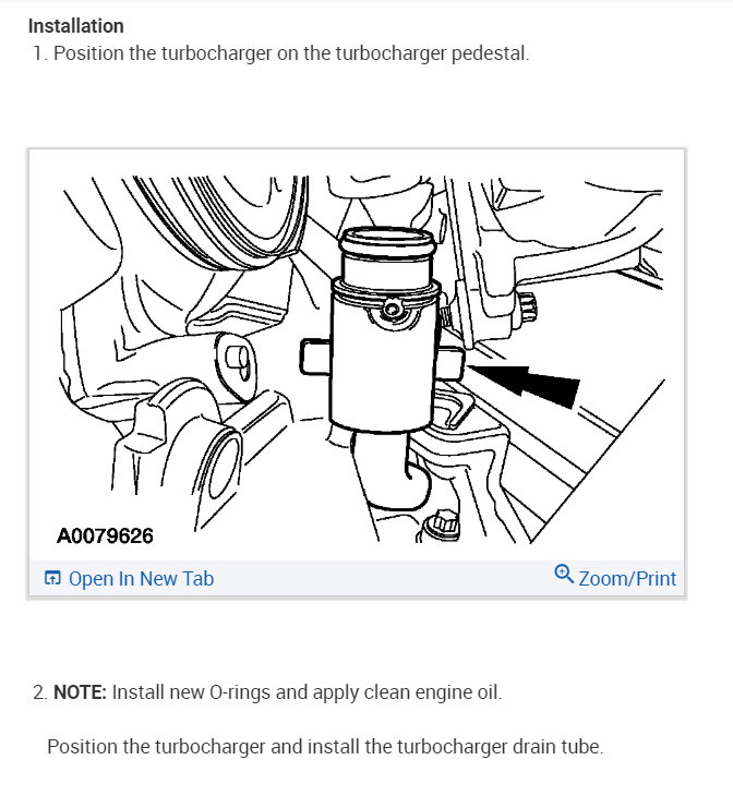

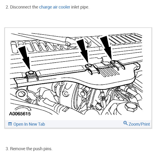

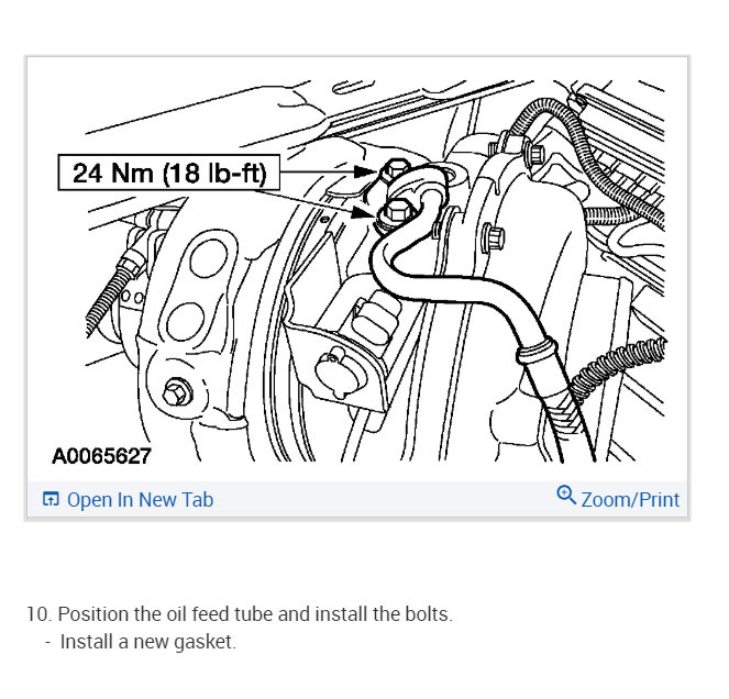

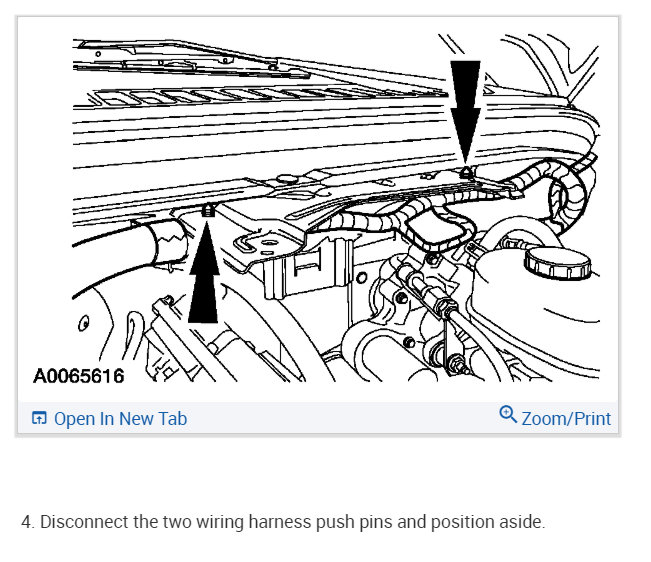

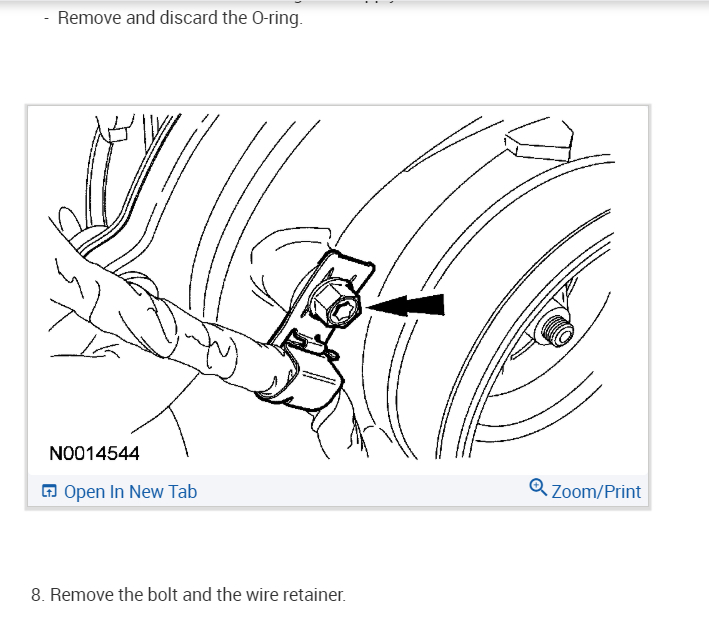

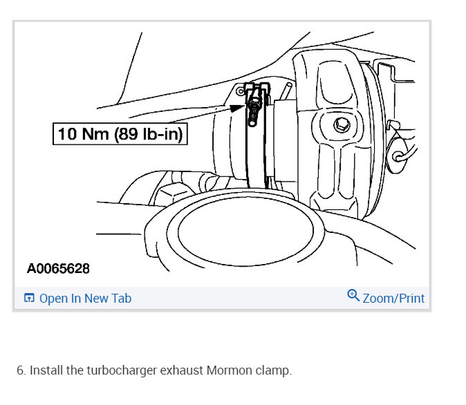

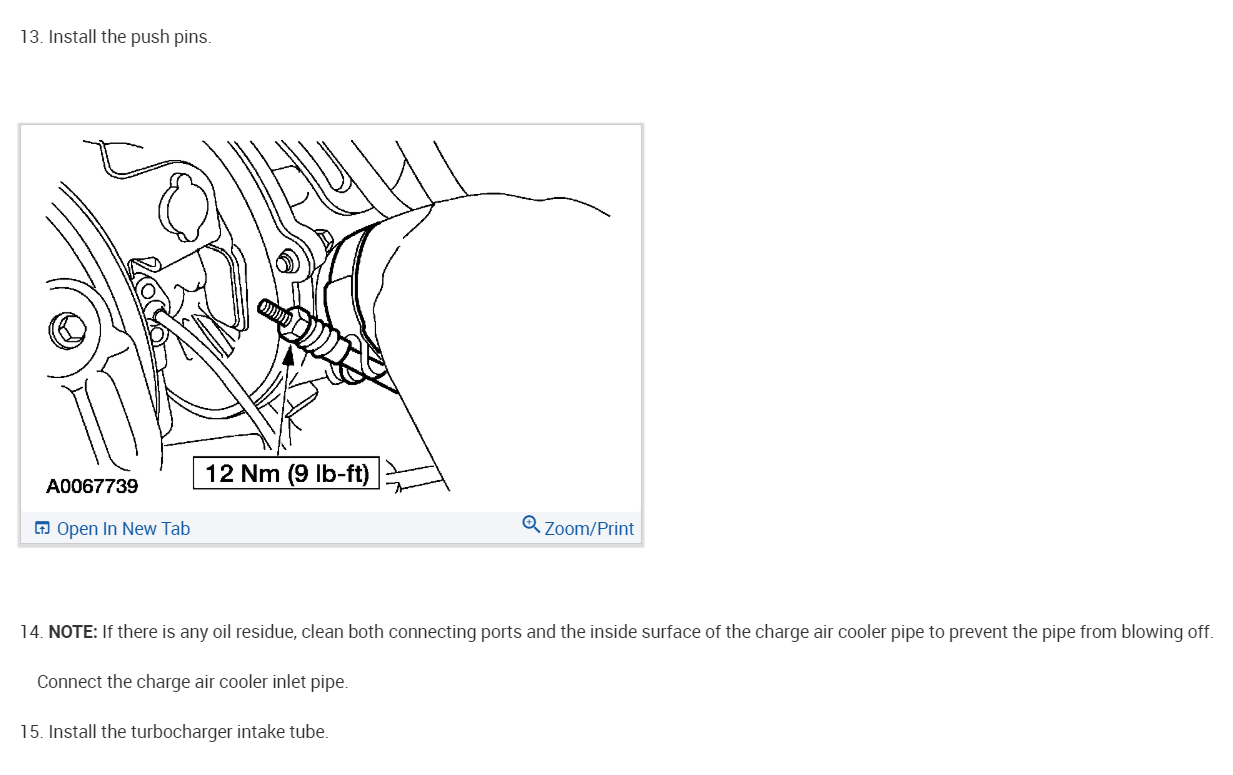

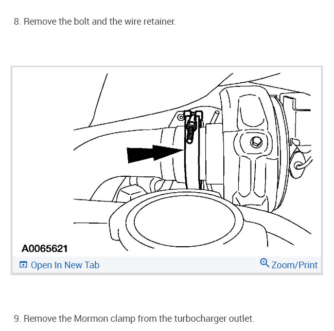

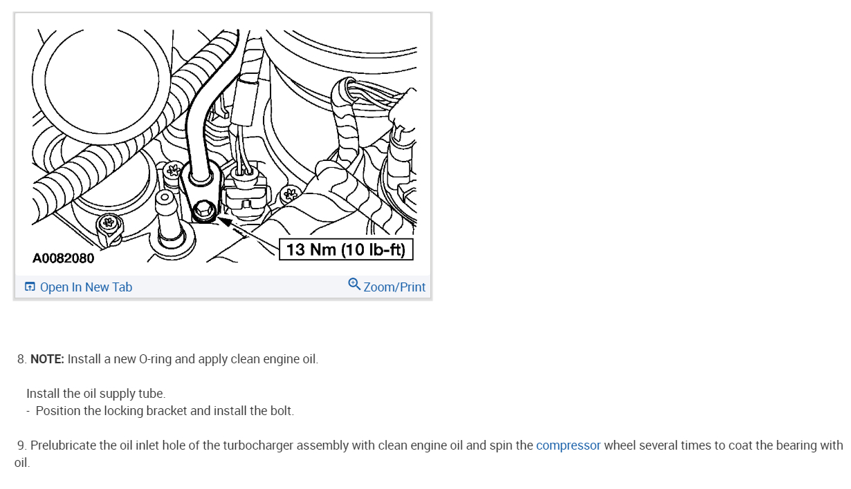

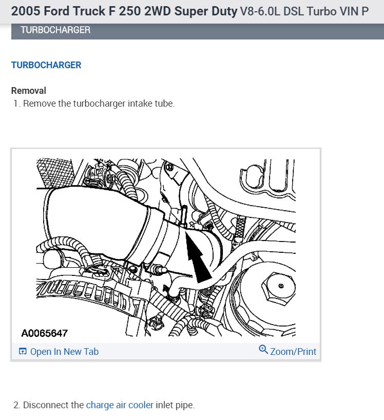

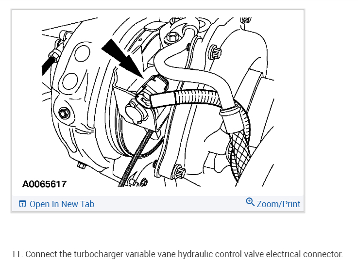

The only way you can tell is to remove the inlet or exhaust side of the turbo and check the endplay, if excessive here is a guide to help see what I am talking about with instructions in the diagrams below to show you how to replace the turbo.
Turbocharger - 4C3Z6K682CBRM $1332.44
https://www.2carpros.com/articles/how-turbo-chargers-work
Check out the diagrams (Below). Please let us know what you find.

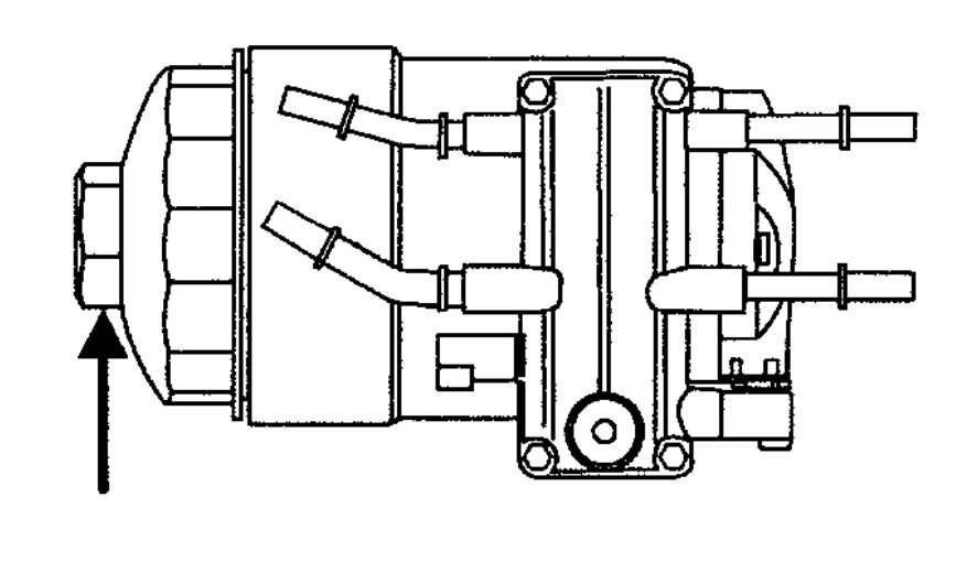

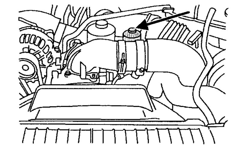

Good afternoon.

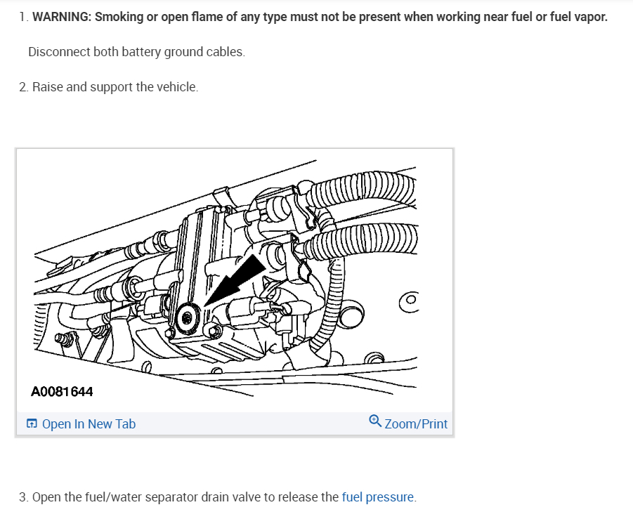

The first thing I would do is change the fuel filter. A partially clogged fuel filter will cause this.
I attached both styles. There could be a frame mounted one or an engine mounted filter. Both are easy to change.
