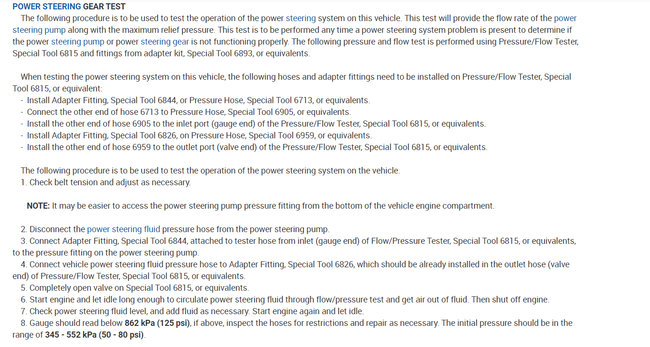

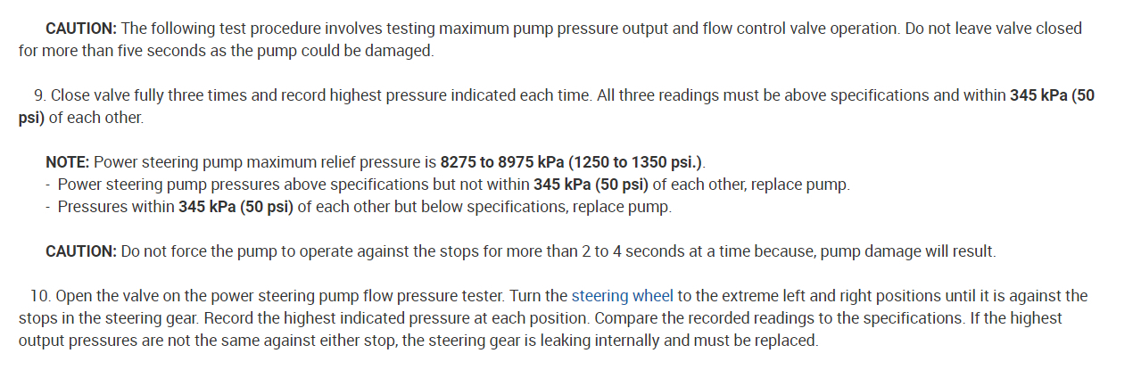

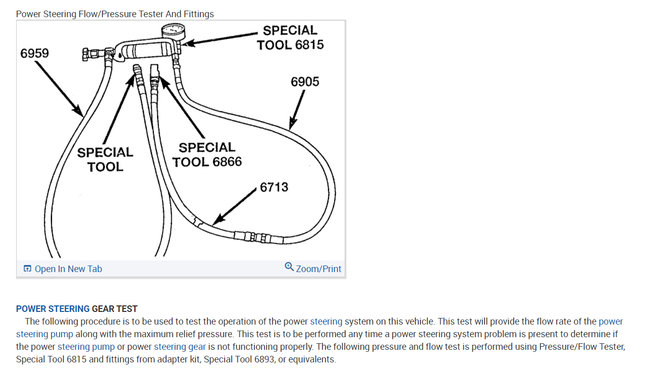

First i want to test system with pressure tester.
Apr 15, 2021 at 12:51 PM
Good afternoon,
I agree with the guy from NAPA. It sounds like the seals got damaged from the incorrect fluid.
https://www.2carpros.com/articles/power-steering-problems
https://www.2carpros.com/articles/power-steering-fluid-flush
I attached the procedure for testing below for you.
Apr 15, 2021 at 1:08 PM
