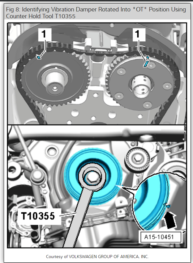

It sounds like the timing belt might be still off a tooth. Here is the camshaft timing so you can double check check it.
Nov 26, 2018 at 9:33 AM

It is sorted. Now mpg is better. Cannot wait to see the mpg on motorway now. :) Thank you.
