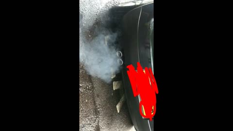

Can you explain me the problem of this car please? It does smoke when you idle it.

Here you go a video.
Aug 26, 2018 at 6:18 AM
DANNY L
  • 5,648 POSTS
Hello, I am Danny.
Just a quick question. Does it do this all the time or does the smoke go away? I have attached a tutorial for you to view. Hope this helps and hope to hear back soon. Thanks for using 2CarPros.

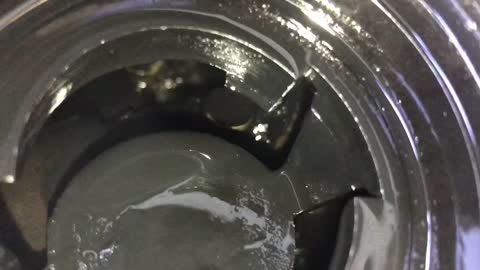

BUJAR
  • 33 POSTS
Here you go.
Aug 31, 2018 at 1:05 AM
Yep, you can see the build up inside the cylinder head. Lets remove the valve cover and take another video to confirm the issue. Here is a guide to help us get started:
