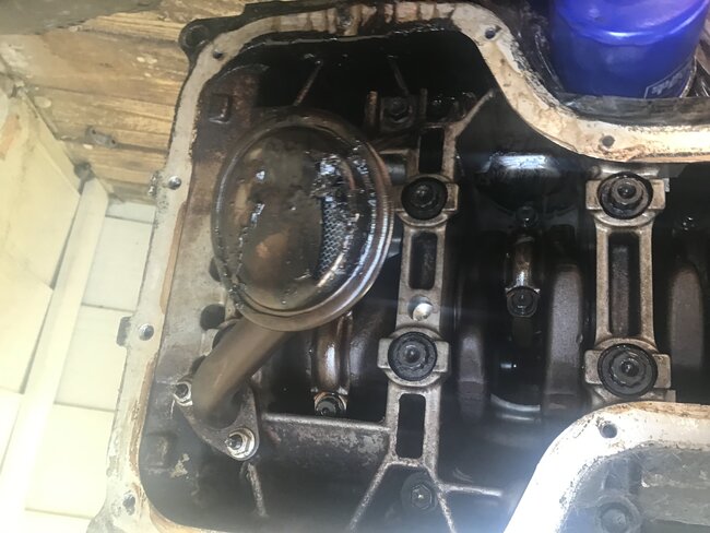

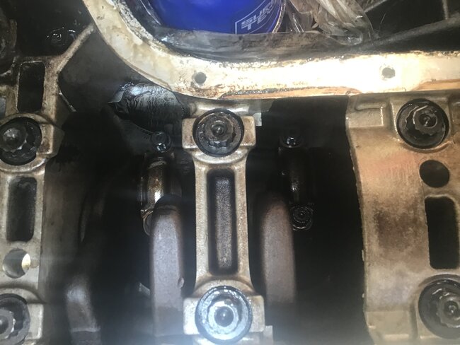

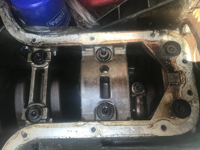

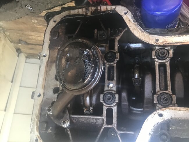

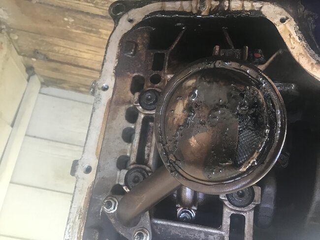

Not sure if you see the scorched oil stains, but to me it screams a problem. Correct? Or does this part of engine look like this usually?
No, it doesn't look normal. Wow, that did a lot of damage. Not being there makes it difficult, but I feel confident that it is done.
If you can, take a few pics of the other engine. Make sure you take it apart for inspection before using it.

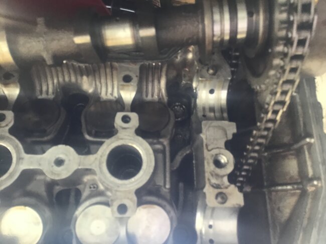

Looking at the pictures, if I had to guess, you had an oil pressure issue that led to bearing problems. Do you remember it knocking, ticking, or the oil light being on? I ask because the oil pick-up tube/screen looks corroded.

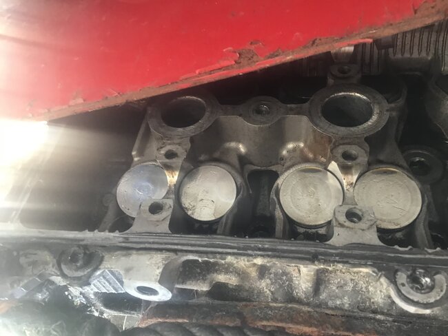

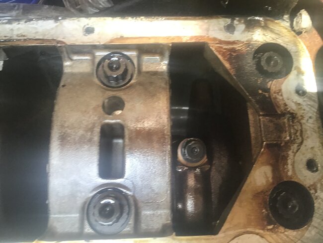

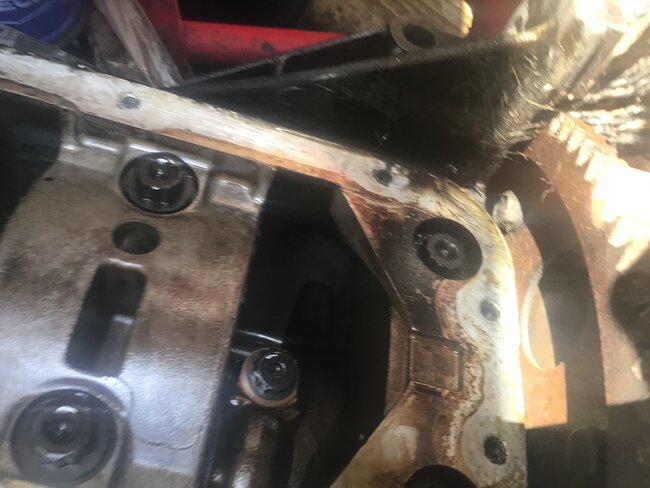

Before it was towed, it ran just fine as far as I remember. The reason I swapped it out was because it locked up i believe. It would have to be an issue with the top half locking up. As you see the bottom half looks good. Do I just unbolt the bottom half as I would the top half? Then just swap out. Or do you have any suggestions on how I should proceed with repairs?
Mar 26, 2023 at 11:12 PM
I just remembered that I believe that it had overheated once, and it must have reached a certain temperature because the car had shut off on me, I think the oil light was on and I couldn’t figure out why it was. The night it overheated and shut down I had it towed to the house, and I believe the next day it started up and ran. Then a few days later that’s when it was towed the wrong way.

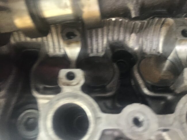

If the engine was overheated and the oil light was on, you likely will have engine bearing damage. Plus, if it got hot enough, the cylinder head could be warped or the block.
I'm afraid to tell you to try fixing it because I don't know what has been damaged. By the time we have everything checked and tested, you would have been better off replacing it with a known good engine.
Does that make sense? I wish I had a better answer, but it doesn't feel right to me. There are simply too many variables.
Let me know your thoughts. I will do what I can to help in any way. I just don't want to direct you in the wrong direction. I hope you understand.

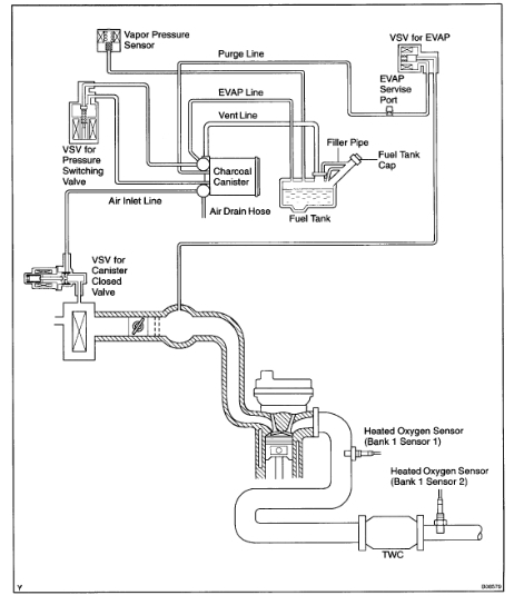

If possible, do you have a diagram for the way vacuum lines connect?
May 14, 2023 at 4:37 AM
As far as vacuum schematics, I have one which I attached below. Now, the engine size is for a 1.8L which is the only one listed for this vehicle. Let me know if that is correct.
