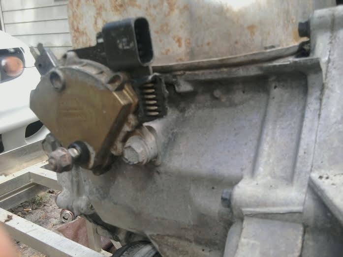

LILRED25
  • 27 POSTS
https://www.2carpros.com/files/temp/3039591979.jpg
Jan 21, 2016 at 6:53 PM
SATURNTECH9
  • 30,869 POSTS
That's a picture of your old broken one on your old transmission.
Jan 21, 2016 at 7:33 PM
LILRED25
  • 27 POSTS
On the new transmission. The other has a broken ground prong
Jan 21, 2016 at 7:46 PM
SATURNTECH9
  • 30,869 POSTS
The one the ground wire goes too?
Jan 21, 2016 at 8:20 PM
SATURNTECH9
  • 30,869 POSTS
If it's broken you should just replace it.
