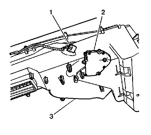

with the a c on warm air blows out on passenger side , drivers side is cold , also hear clicking noise behind dash area on passenger side. I removed the plastic cover under the dash on passenger side and the blend door actuator there seems to be working properly ,it seems to control the air from hot to cold on the drivers side , a little confused but I seen a youtube where there is a second blend door actuator in the middle of the dash up under the dash pad.is this the problem ?
Jul 16, 2020 at 12:01 PM (Merged)
WRENCHTECH
  • 20,761 POSTS
Yes, if you have separate left and right temp controls, you will have 2 actuators. I don;t see any Yukon that has a 5.7 and you don't say if this is ATC or not so my info may not be accurate. Alldata states the dash has to be removed to access the right side. https://www.2carpros.com/images/external/119068527.gif

RICKY GRANT
I need to replace one of more blend door actuators on my SUV. My understanding is that the passenger side one is pretty simple but the driver side one is harder. Do you have a video about the driver side replacement?
I have hot coming out on both the driver and passenger sides. Is this a clear indication that both need replacing?
Thanks.
Jul 16, 2020 at 12:13 PM (Merged)
STEVE W.
  • 15,113 POSTS
Which control system do you have the manual or automatic version?
In both the Left (driver) side is the easier one to replace, It is on the bottom of the HVAC case and you only need to remove the console (depending on option) and lower
insulator panel to get to it.
The right (passenger) side on the other hand is a pain. For it the dash has to come out to get to the top of the HVAC case and the actuator.
Then you need to calibrate them.
It could be the actuators or it is possible it is the control head itself. It is possible to test them if you have a dealer level scan tool. I would opt to test them first before tearing the truck apart.
