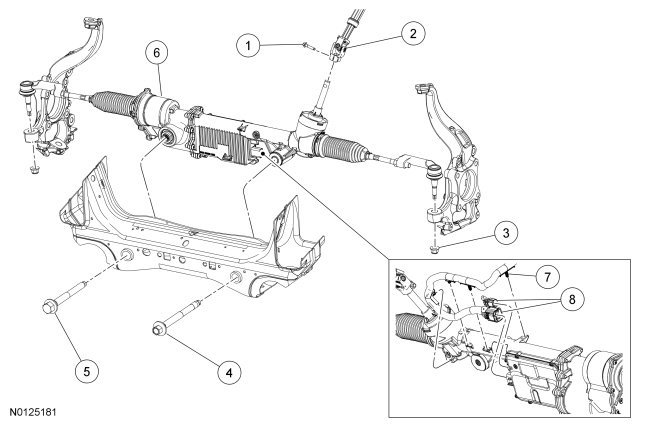

Also, I see a recall maybe for the electronic power steering. If this went out, would there be any programming involved? I can replace a rack no problem.

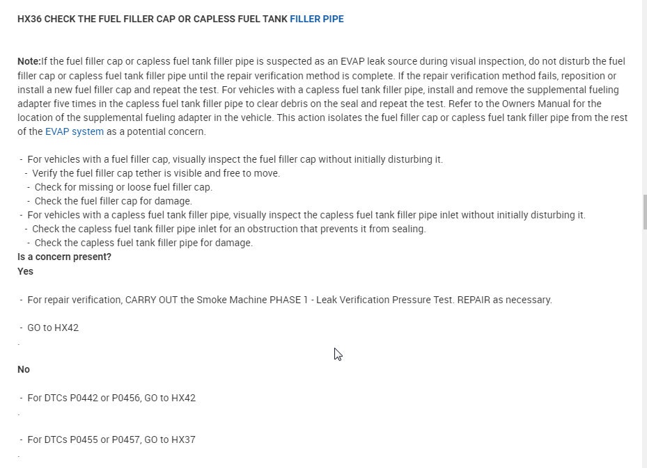

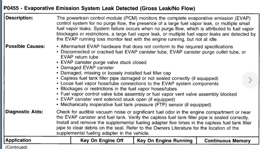

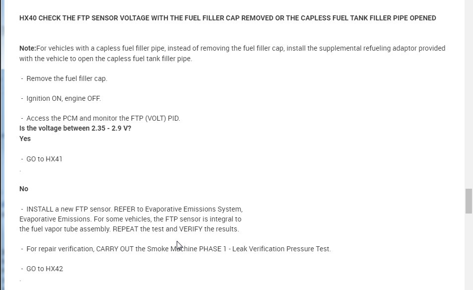

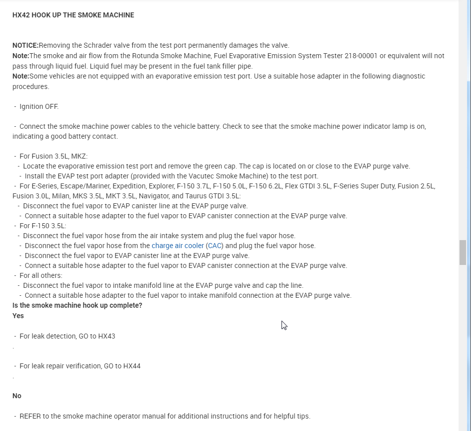

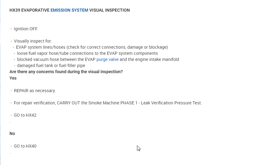

Well just got the truck today and it's not leaking a drop of anything. However the engine codes are p0420 and p0455. Need to know which cat to replace and where this evap leak may be.
Also the driver seat belt receptacle will not latch. The little black tab inside gets stuck and stays down when pushed down and won't latch with the belt. Have to use a screwdriver to spring the tab up and make the button work, but putting the belt in only causes it to stick once again. I've tried shop air, wd-40, brake cleaner.
Mar 19, 2020 at 6:01 PM

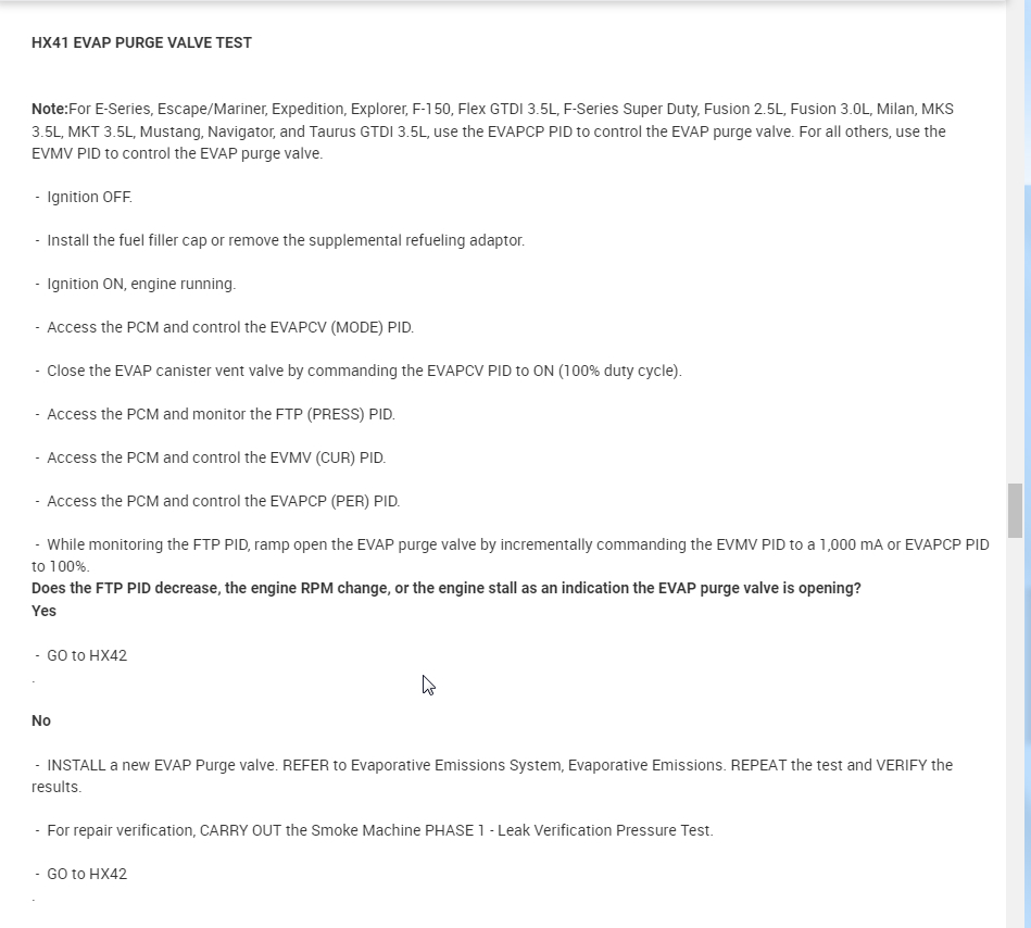

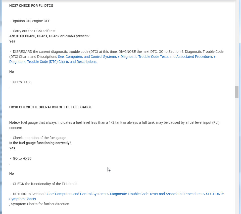

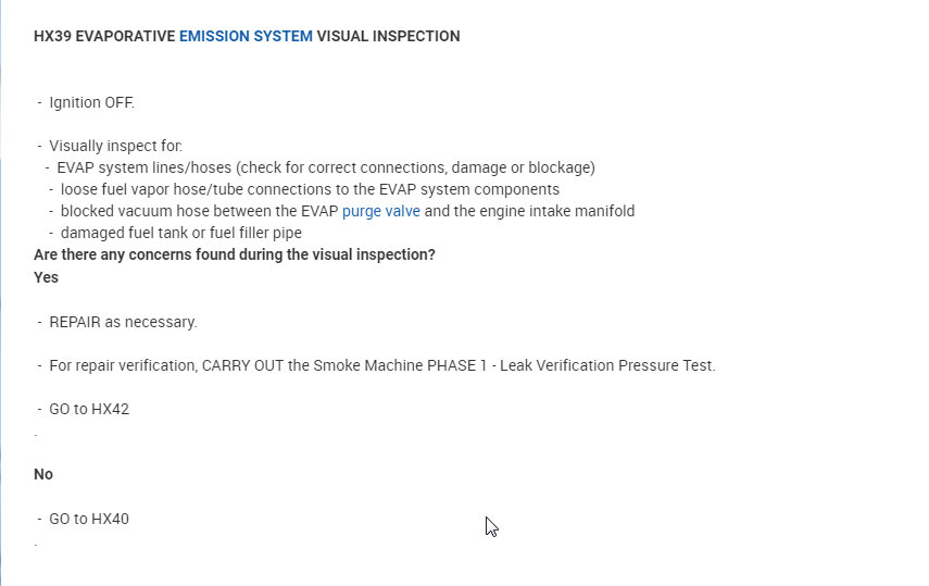

If I can jump in here. You have a large leak in the EVAP system so I suspect it is the fuel cap or purge valve but I attached the test that you need to run through.

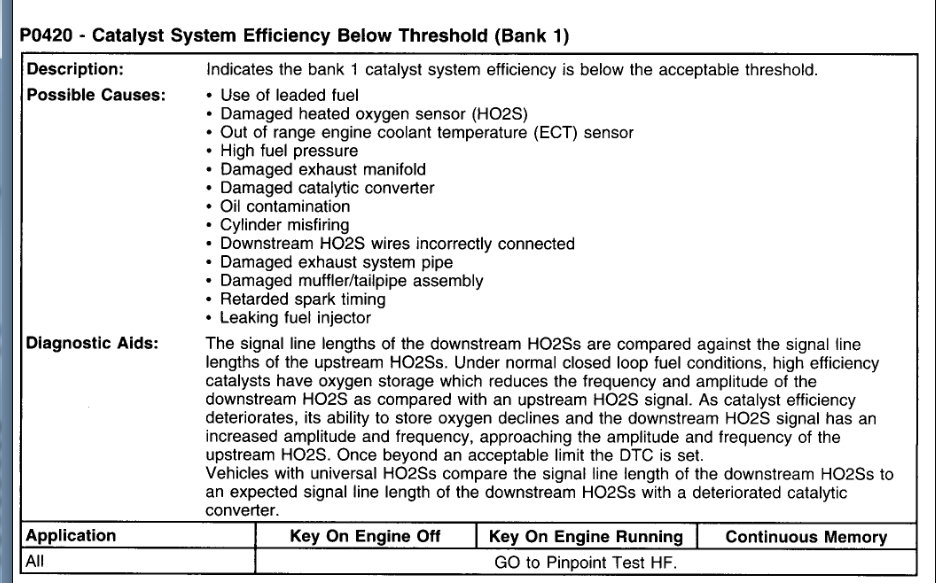

As for the P0420 code, that is bank 1. More than likely it is the converter but I attached the other possible causes.

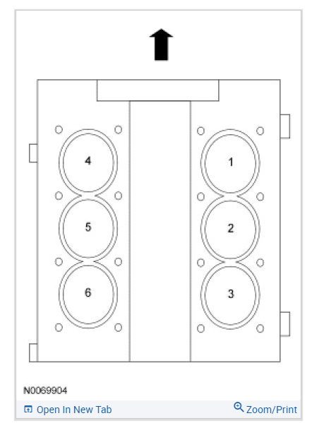

And bank 1 is the passenger side on this?
Mar 19, 2020 at 7:24 PM
Correct. Bank 1 is the one with cylinder 1 on it. In this case it is passenger side.

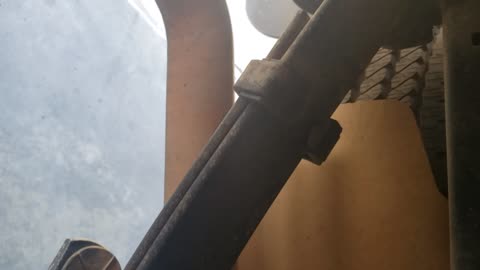

Wondering what this looseness is back here. I can lift the rear end up. Maybe leaf springs?
Mar 20, 2020 at 1:56 PM
We have to keep each post to the same question or topic. Others won't find the questions or answers on different topics under a heading that doesn't match the issue.
Lower the vehicle and put the weight on the suspension and see if it is still loose and then post that info with the video on a new post. However, if it doesn't do it when the weight is on the suspension then it is normal.

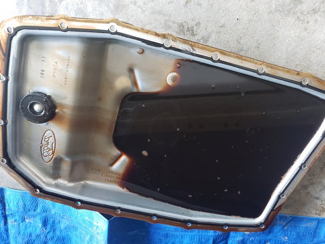

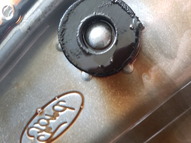

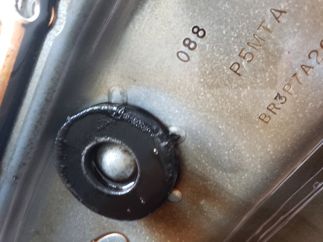

Back on topic about the trans service: the fluid is a little dark, but still has the red tint and doesn't smell burnt. Also I didn't find the ford dipstick plug from the factory, so I assume it's been serviced before. Does this look normal ?
Mar 21, 2020 at 1:41 PM
The magnet looks good. That is normal wear and tear.
Mar 21, 2020 at 3:19 PM
That amount of metal is absolutely normal. The fluid is dark which is just a sign of it wearing which is what it is supposed to do. Go ahead and replace the fluid and filter since you have the pan off and you should be good to go. I would not worry about flushing the unit to get all the fluid out. If it is not burnt then it is fine to just drain and fill it. Clearly you can clean that magnet off but again, that is nothing to worry about.

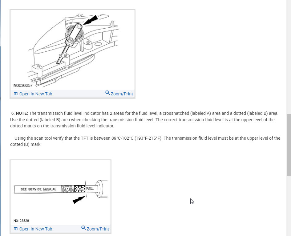

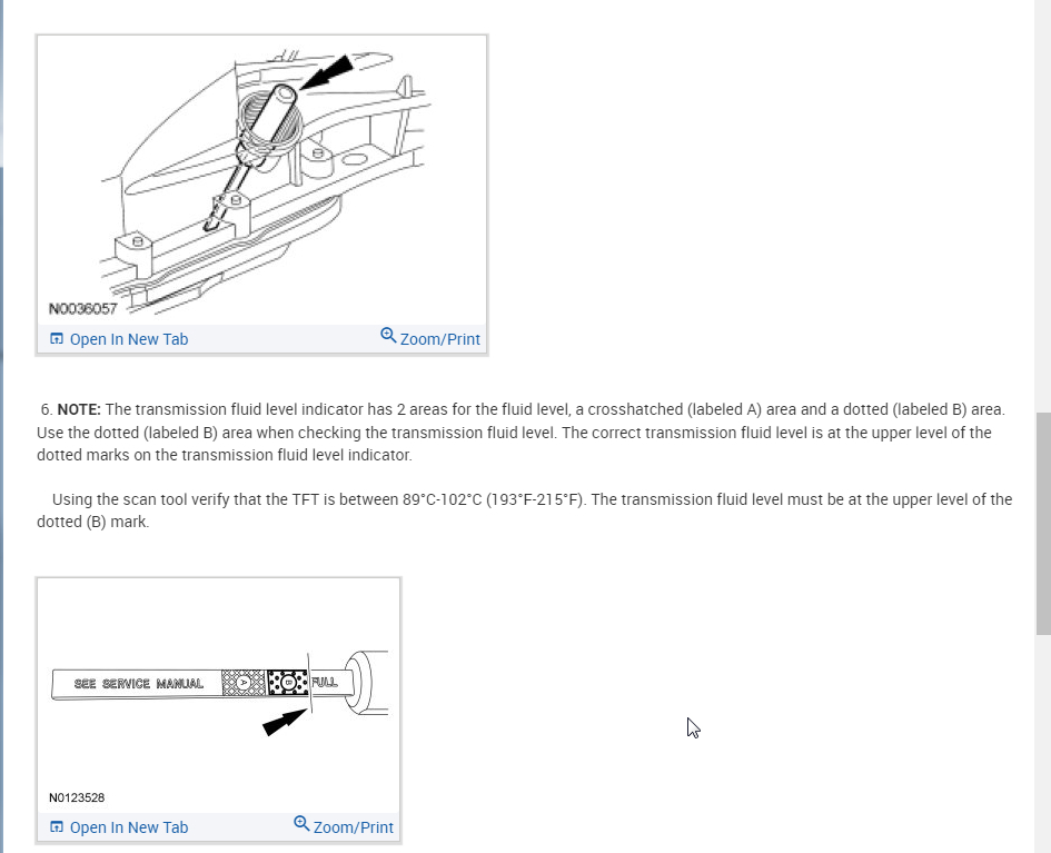

Well, it's taking forever for the transmission to get up to temperature. Should the fluid level be in the A or B area?
Mar 21, 2020 at 4:41 PM
Here it is from the manual. Figured it may be easier to see it as well.
Just make sure you do your final check when its to operating temperature.
Mar 21, 2020 at 4:45 PM

Well the temperature gauge is close to the middle, but not exact. I'm at 7 quarts adding and I'm at the top of section A. This is weird considering I measured 6.
Mar 21, 2020 at 5:10 PM
It is never 1 for 1 meaning you put in just what came out. If someone did this before and didn't follow the process I attached before then they under filled it. Stick to the process and it will take whatever it takes.
Mar 21, 2020 at 5:15 PM
CANNON1349
  • 861 POSTS
Well, after I wrote that it started reading in the middle of B. It's running by the way . should I leave it alone? I hear this type expands.
Mar 21, 2020 at 5:17 PM
Correct. It expands when hot.
I would leave it alone.
You are good.
Mar 21, 2020 at 5:25 PM
Nope. Stick to what it says. The fluid doesn't "expand" but it does thin when it gets hot which is why it is critical to do this check with the engine running and up to temperature. But you can't be wrong at this point if you want to leave it.
Mar 21, 2020 at 5:26 PM
Just saw Roy’s answer. Either way. You will be fine. You are only talking a half quart or less at this point so if you are checking at operating temp, top it off. If it is not completely to operating temp then just stop.

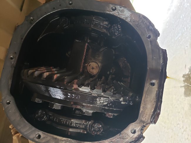

How about this differential? It's a bit bubbly. I just drove it 15 miles before removing the cover. The fluid was a dark gray with yellow tint with light behind it. Kinda sludgy too. But no movement of the pinion.
