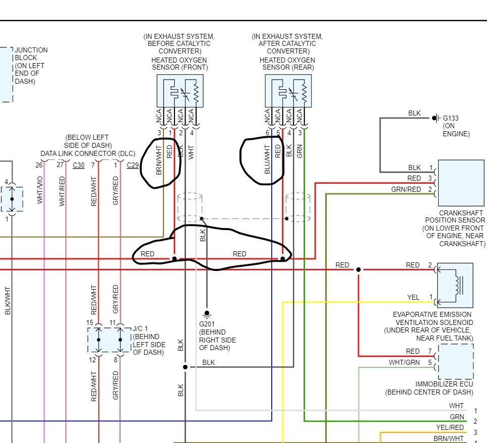

P0135 would be a heater circuit code for the upstream sensor. It is set when the ECM decides that it's taking too long for the sensor to heat up from the heating element inside it and start switching. It does that by checking the current and sets the code if the heater current continued to be lower than 0.2 ampere or higher than 3.5 ampere for 6 seconds. The sensing part is still working so on the scan tool it will look normal. I don't think that system has the bi-directional ability to turn the O2 heaters on and off to make testing easier. The way it works is simple, the red wire should have battery power with the key on. This same power feeds the crank and a couple other sensors so it should be okay, the brown with white stripe wire is the control wire from the ECM, it grounds to turn the heater on. Same thing happens on the blue with white wire on the downstream sensor.
Testing with a scan tool would be simple, connect a test light to the bed and brown with white and turn the heater circuit on, if the light comes on, that part of the circuit is okay, and you replace the sensor. Without a scan tool you are sort of stuck with just unplugging the sensor and doing a resistance test to see if the heater is still intact. For that you unplug the sensor and use an ohmmeter across the terminals to find if the reading is between 4.5 - 8.0 ohms. If it's lower it's shorted if it's higher it's either open or has a wiring corrosion issue, in either case you replace the sensor. Check that you have battery voltage at the red wire.
