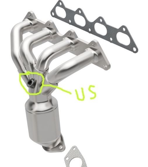

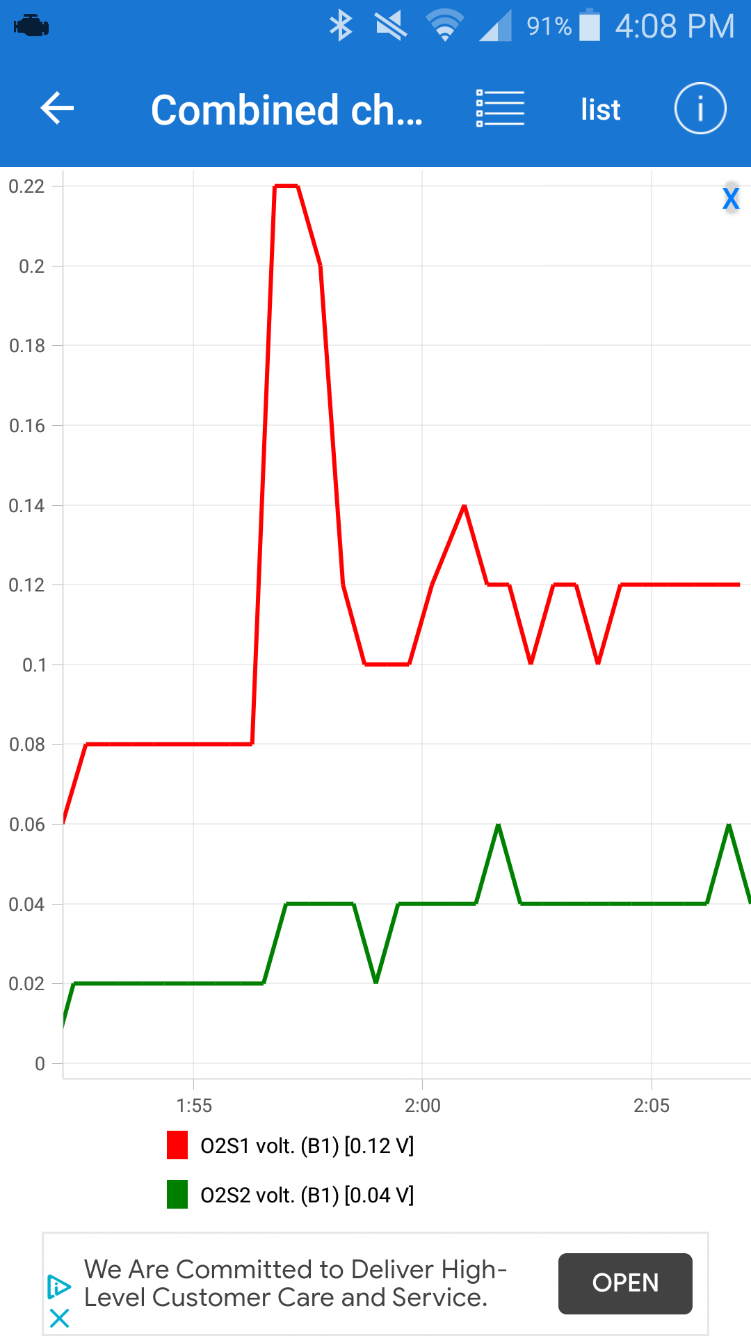

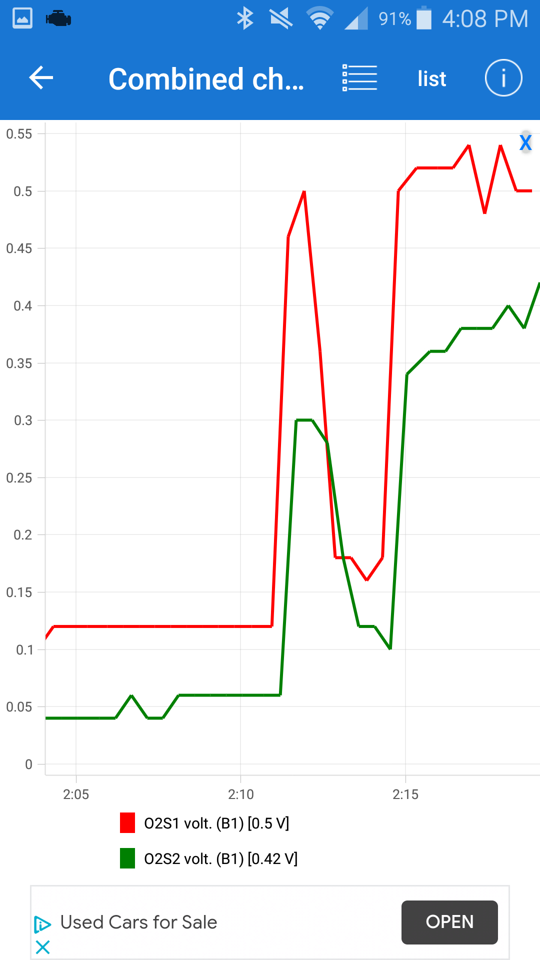

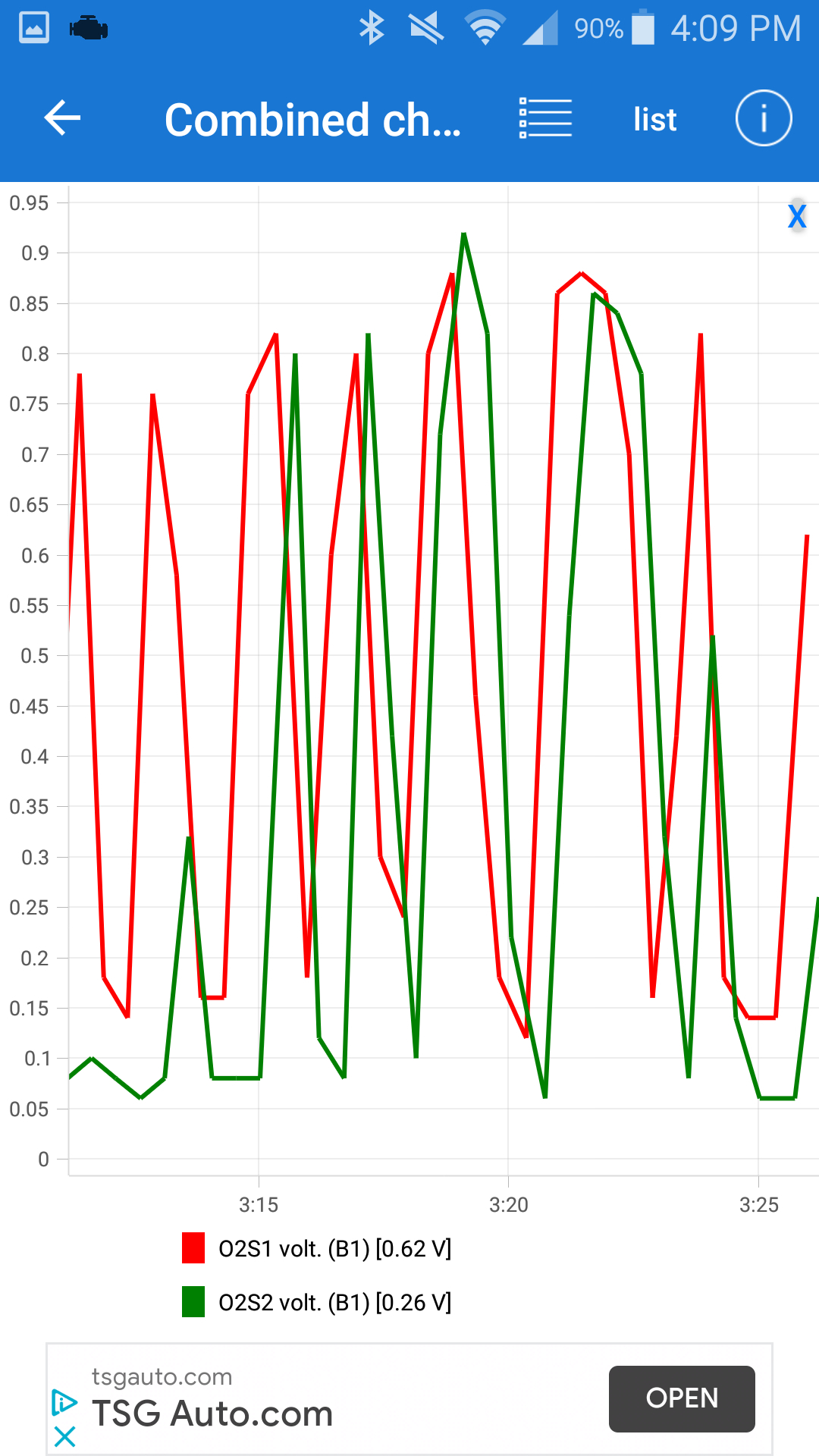

My car had 2 P0421 codes stored when it threw a check engine light tonight. I believe I accelerated from a stop up to around 30 mph when it went off, and the freeze frame says 32 mph, 1414 RPM, 199 ECT, Shortft1% -1.6, Longft% 1.6, Load % 25.1%, Fuelsys1 CL, Fuelsys2 N/A.
I've never done any exhaust work on my car. From searching online, it sounds most likely to be the catalytic converter if it doesn't have any other codes (which it doesn't). If it is the catalytic converter, is it better to unclog my existing part or replace it? It would definitely be aftermarket if I replaced it, unless I got a used one. OEM new ones are $600.00 to $700.00, which is not an option for this car.
