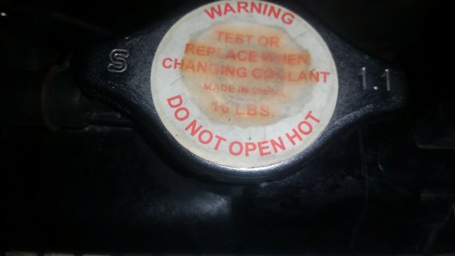

I replaced the radiator cap 6 months ago or so just to be sure. It was a Stant which seems to be a pretty well respected brand. The radiator itself was replaced only 13 months ago. It was a warranty replacement from roughly 3 years before ( September 2016), it had a leak out of the bottom left front area, I never found out exactly where. I also replaced the radiator sometime in 2012 or 2013. I recall multiple times checking the radiator during all those years and having the same issue, where the reservoir area appears bone dry and I have to refill it. Anyway, the mechanic who replaced it the past two times told me he did a carbon monoxide test on the coolant and it tested positive, which is where the idea of the head gasket leaking started.

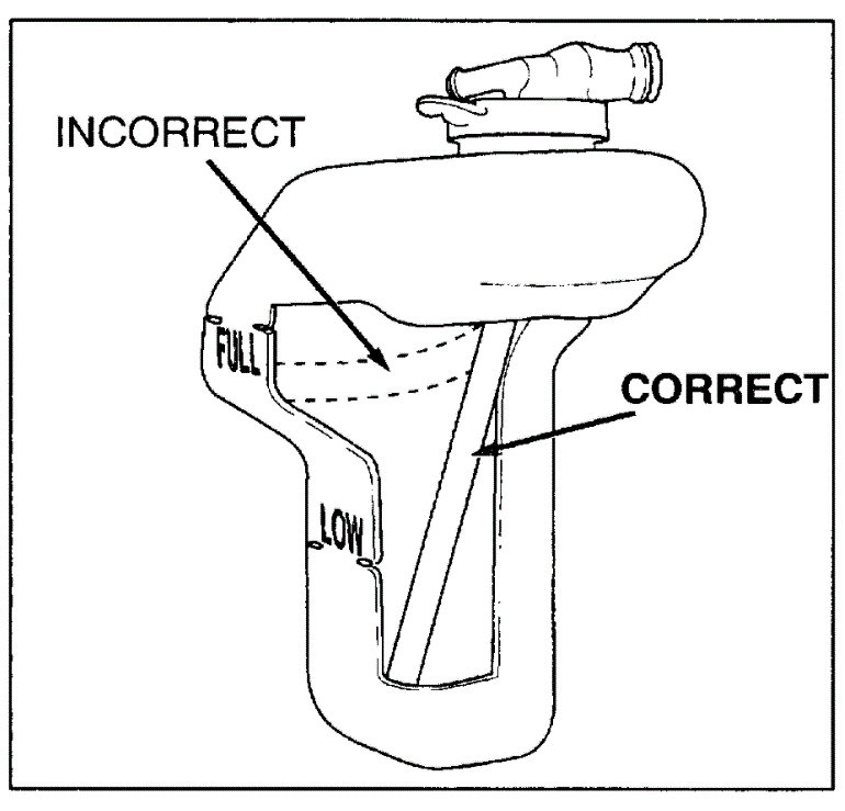

Is it also normal for the coolant to pool up on the rim of the reservoir filler area just beneath the cap? I noticed that happening and was curious if maybe it was getting really hot and evaporating. I thought about maybe trying to block off that area so that doesn't happen anymore. Thanks for your help.

Does running the A/C on high all the time cause coolant to be consumed? I think I heard that running the heater causes a bit of coolant to be consumed, not sure about the A/C though.

It shouldn't be to the top of the reservoir. There is a line indicating full. It shouldn't be higher. Also, there was a service bulletin years back that indicated an overheating concern when the hose in the tank was not position properly. Take a look at the attached pic just to make sure that isn't an issue.

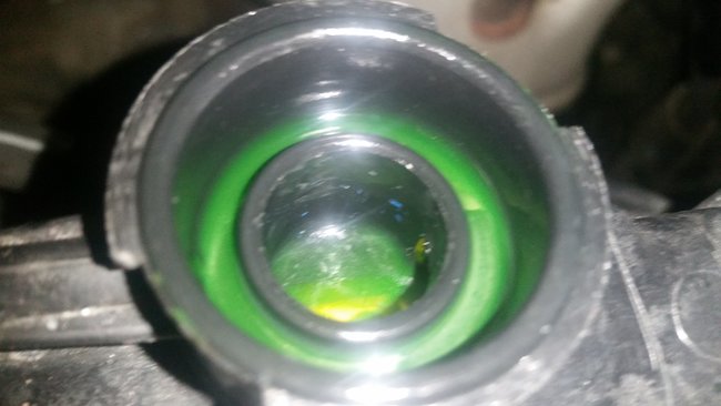

I was referring to the radiator itself. I fill it up to the filler neck, and the pressure from the system shoots some of the coolant up into the rim around the cap area. I was thinking maybe with such a small amount in there, it could get really heated up to the point of evaporating. I also noticed the sticker on the radiator cap was rather damp. It did rain tonight but nothing else was wet in that general area, so it seems to have come from out of the radiator itself. I switched back in the old radiator cap, but noticed the sticker on that is completely worn out. So it may have had the same thing happening. I've attached pictures.
Also, yes it does shoot out coolant with the cap off and engine started. It seems to pressurize properly, and the pressure test at Midas showed it continuing to hold proper pressure. I don't fill up coolant in the reserve tank / reservoir, it is currently sitting maybe a half inch above the low line. It doesn't seem to vary much when I check it. Also the reserve tank is only semi translucent so it's hard to see the hose in there, but I pulled it out and put it back in, and it goes all the way to the bottom, doesn't seem to be bunching up or anything.
Maybe I should spring for an OEM radiator cap and see if that helps any? I do know switching to an OEM gas cap fixed my P0442 gas cap issue before, when an aftermarket one was still triggering the code.

Well, it didn't spray out this time on a cold start with the radiator cap off. This time I had just filled it to the bottom of the filler neck, and when I started it, it began slowly expanding and rising. At which point I had to quickly put on the radiator cap before it overflowed.
The time it shot out coolant was back when I tested it with the heater on full blast, so perhaps that's what caused it to shoot out that time. In any case I'll probably have my mechanic check it out. I just had to put in another 6 to 8 ounces of coolant in there today.
