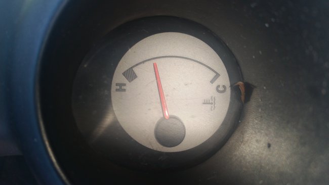

Hello guys,
For a while now I've been noticing my engine temperature creeping above halfway up the thermostat gauge while idling. Today it actually got up to the red while idling at a drive thru for 15-20 minutes with the A/C going on a hot day (80 degrees but car was sitting in the sun first). The thing is, the radiator is basically new, it was replaced in August of last year. I also have seen no coolant leaks or white smoke, so I don't think it's the radiator or any hoses. Also, I turned the defroster onto hot and the highest blower setting, which did get the temperature to drop a bit, indicating that it's not the Engine Coolant Temperature sensor either. So I've reduced it down to mainly water pump or thermostat. I've heard the EGR valve can also cause overheating issues, but if it's clogged it generally produces black smoke out of the exhaust, which I don't have. Does it sound like water pump or thermostat or something else? FYI water pump is 4 years old, and the timing belt that I got in the same kit wore out faster than it should, just replaced it a couple months ago. So that also makes me think the water pump is on its way out.
Thanks,
Adam
