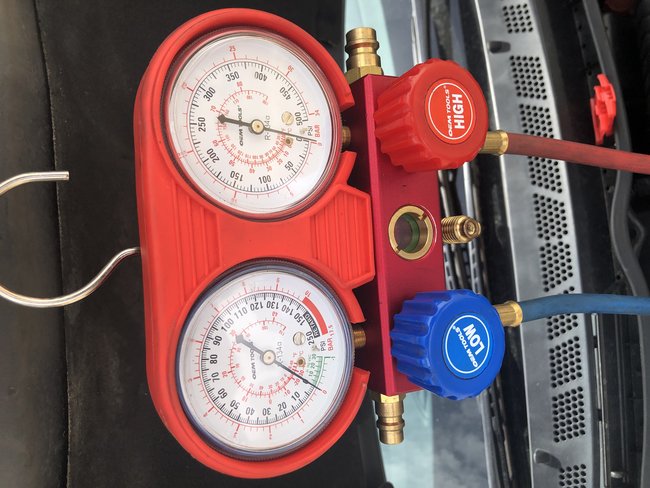

Let's rent a gauge set from a tool rental just to see what the pressure is even though we can probably assume it is pretty empty.

Okay. That is positive news towards the fan issue but the set back is your A/C pressure sensor is a 3 wire sensor that is wired to the PCM. That means it is not an on/off sensor. It actually has a resistor in the PCM and tells the PCM what the pressure is. That means we can't jump the switch and "trick" the PCM that the pressure is above the minimum. If it were a two wire switch then if the pressure is above the minimum threshold then the switch closes and the PCM just senses 12 volts and knows the pressure is not too low.

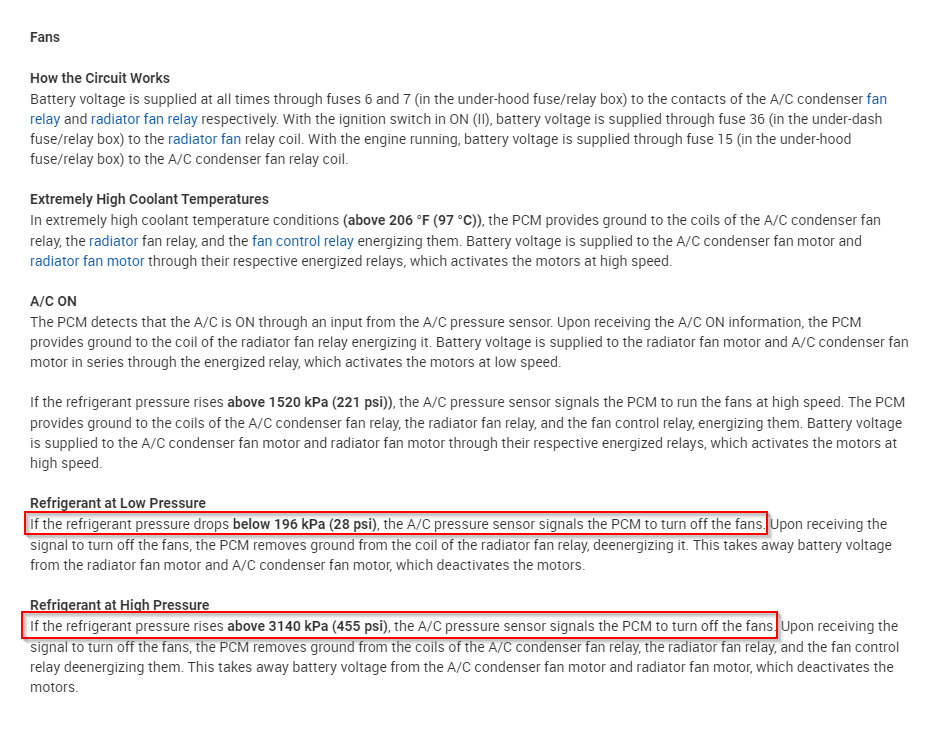

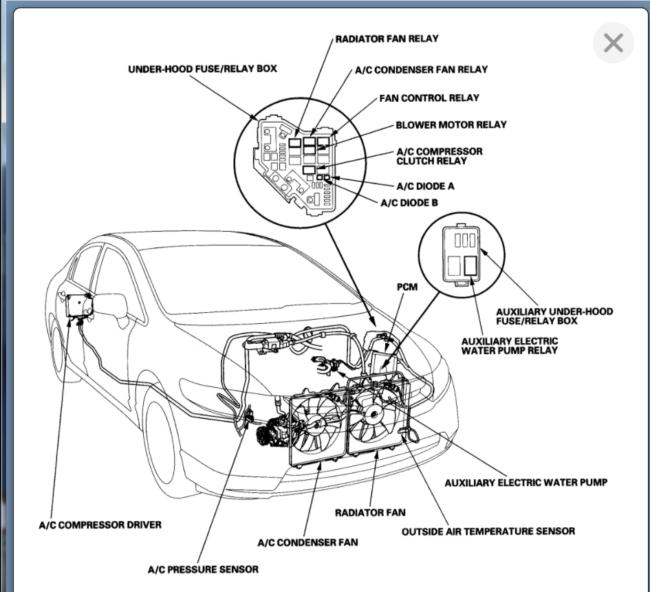

So this is what I would suggest: Get one of those refill cans so that you can get the A/C pressure above 28 PSI so the PCM will allow the fans to run.

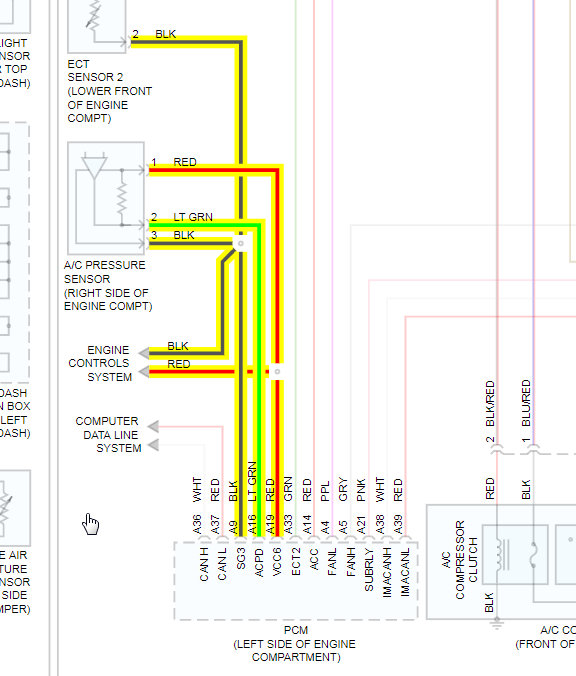

Take a look at the attachment and tell me if you read that the same way I do. The PCM will shut the fans off if the A/C pressure is below 28 PSI. If you agree, let me know what happens.

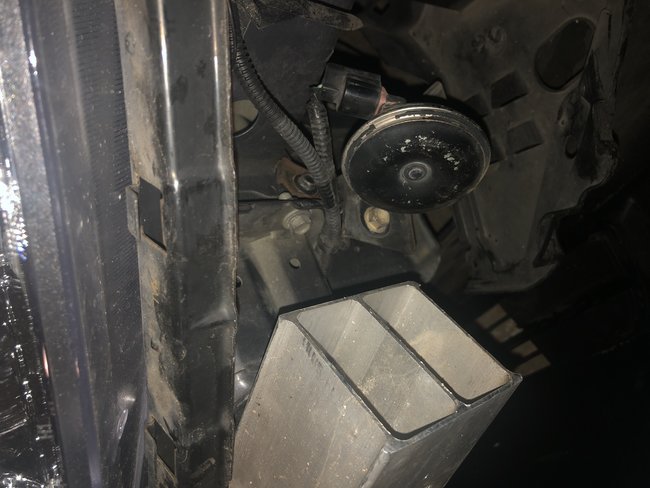

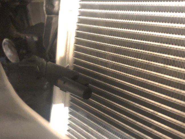

Okay. Replaced the condenser. Recharged the A/C to 35. Everything is holding good. Cold air coming out of the vents. Both fans are spinning. That has got to be an improvement.

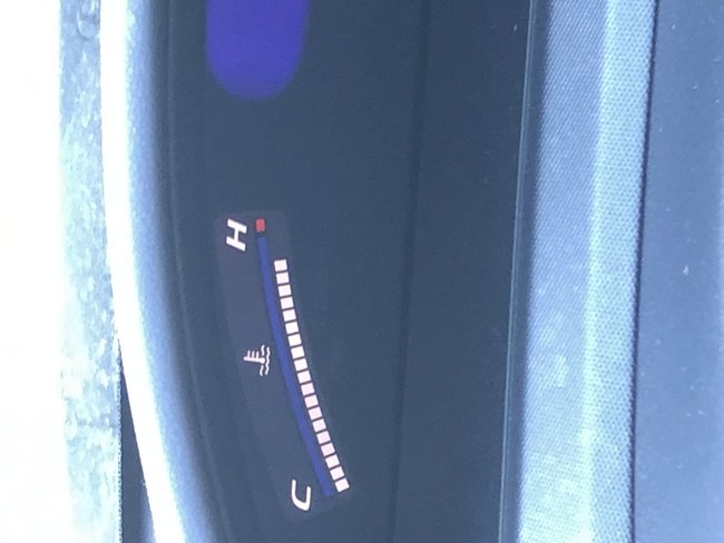

Took it for a drive, and after about 10 minutes, temperature drastically started to rise, and starts to overheat. I pull over, and it slowly goes back down to 1/3. Tried again, and same thing. Did not let it get that hot though. Figured over half, it is going to do it again.

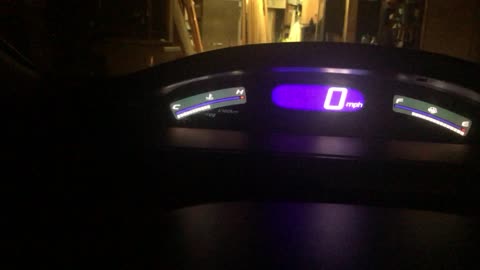

Just to note, I was idling with A/C on. Both fans going. After a while, the temperature got to the middle, and I could hear the fans kick on high for a moment, then shut off. Then come on again. Temperature gauge doesn’t move.

You are correct. The fan is cycling due to the temperature but if it stays half way and does not continue to rise with the A/C on and idling, I would consider that normal.
If it is overheating while driving then I am pretty sure we have a flow problem. Just confirm for me that when you drive it actually overheats by the temp gauge getting 3/4 of the way up or it boils over?

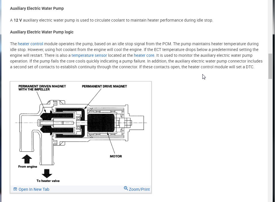

This might be interesting and maybe give you more clues. When it overheats, the heater is now getting cold. Got it back home, and used a spill free funnel again, and I notice that when the radiator fluid gets hot, it just keeps expanding and rising the liquid level of the funnel and the heater still blows cold.
Also, after it gets to 3/4 where I have to shut it down, after I let it sit for a few minutes, it’s back to under half and the heater starts to blow hot again. I Just replaced the water pump, so that cannot be it. I’m kinda stuck here.

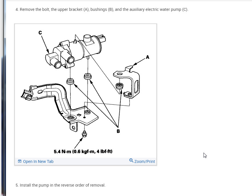

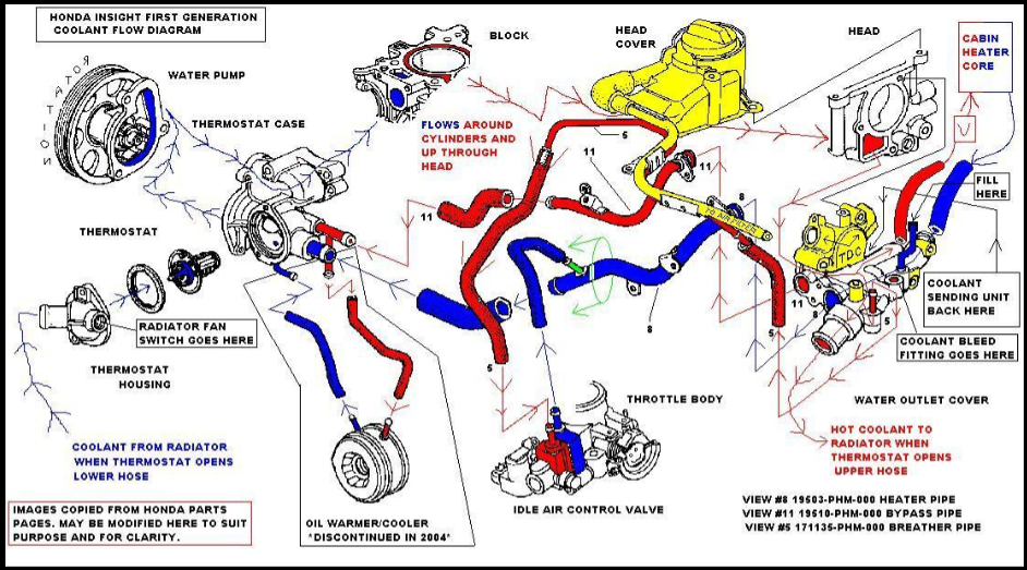

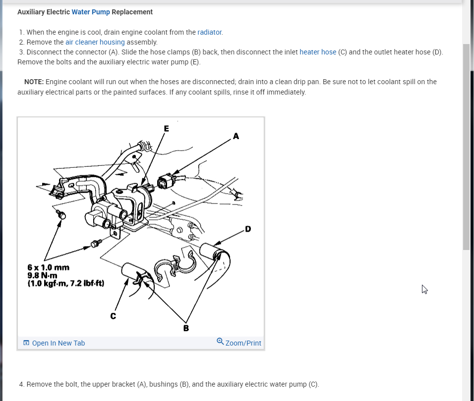

So, that coolant hose that goes from the back of the engine to the firewall is next to impossible to get off. I couldn’t do it. I just ended up splicing it, and will run two clamps and a coupler when I’m done. Anyways, the issue still is there.

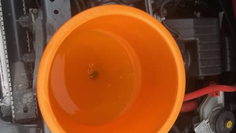

Here’s something interesting though. After about 20 min of running, there’s still air in the system. Something else, if you look, it seems like the air coming out isn’t being replaced by coolant. The coolant level isn’t going down.
Unless you have any ideas, I am starting to think there is a small crack or something in one of these hoses that is introducing air. The bumbling isn’t very much. I am wondering if that’s possible without any visible leakage?
Another interesting thing when I put the heater core hoses back into the system, when I turn on the heater, there is a rise in air coming out of the system. When I turn off the heater, it goes down to that level shown in the video, and bubbles slowly just like that.
Sep 18, 2020 at 3:43 PM
Here’s something interesting though. After about 20 minutes of running, there’s still air in the system. Something else, if you look, it seems like the air coming out isn’t being replaced by coolant. The coolant level isn’t going down.

That is interesting. Clearly the air bubbles are air so it is either from compression (head gasket) which I think we did a block test. The fact that the bubbles increase when you put the heat on frankly doesn't help because all you are doing is pushing air over the heater core. Unless this is where the leak it, that doesn't make sense.
Let's confirm that you have done a block test and then did the air bubbles come out when you bypassed the heater core?

So, here is an update: I found out the constant air bubbles were from the seal of the connector for the funnel. Added an extra rubber washer and no problems there.
What I did is bypass the heater core, and noticed drastically lower temperatures and no overheat.
Next day, I did a complete flush of the coolant system with the heater core bypassed, and flushed the heater core separately.
Refilled the system, and it ended up taking an extra 1/3 gallon of coolant. Bled the system, and I took it for a drive for 20 minutes and no overheating.. However, it seems like the overflow is overflowing. Not sure yet. Also, another concern I have is after driving for 20 minutes, 5 minutes at freeway speeds, the bottom radiator hose is still cold.
I don’t know where I am at, nor where I go from here.

Also, another thought. Is there an “auxiliary water pump” on this car? I had a friend tell me that his Beamer had a coolant flow issue, and thought it was the water pump, but ended up being an auxiliary water pump. Don’t know if that applies to 8th gen 1.3l hybrid motors or not.
Sep 26, 2020 at 3:53 AM
Actually you do. I attached all the info for it. I didn't think that you have to have that due to it being a hybrid and it circulates coolant when at a stop and the engine is off (in hybrid mode).
Also, the coolant does not expand. Air expands when it heats up so that is what is pushing the coolant out so we still have an air issue but I didn't think to focus on the hybrid system. Let me know what you find with this because this may explain why the lower hose is cold.

So how does the cooling system work on this car? What is the path of flow for the coolant?
