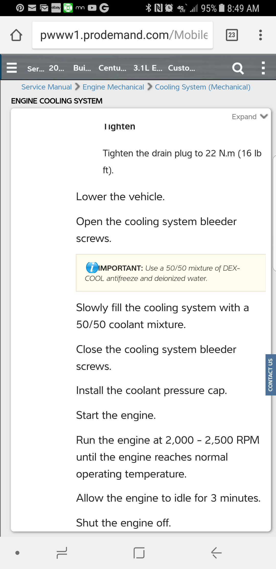

I think we have been bleeding it wrong. It has two bleeder screws. How do you bleed it correctly? Water pump was rusted when we replaced it.
Dec 12, 2017 at 8:01 AM
SATURNTECH9
  • 30,869 POSTS
Here is what I have about filling the cooling system after draining it:
Dec 12, 2017 at 8:50 AM
