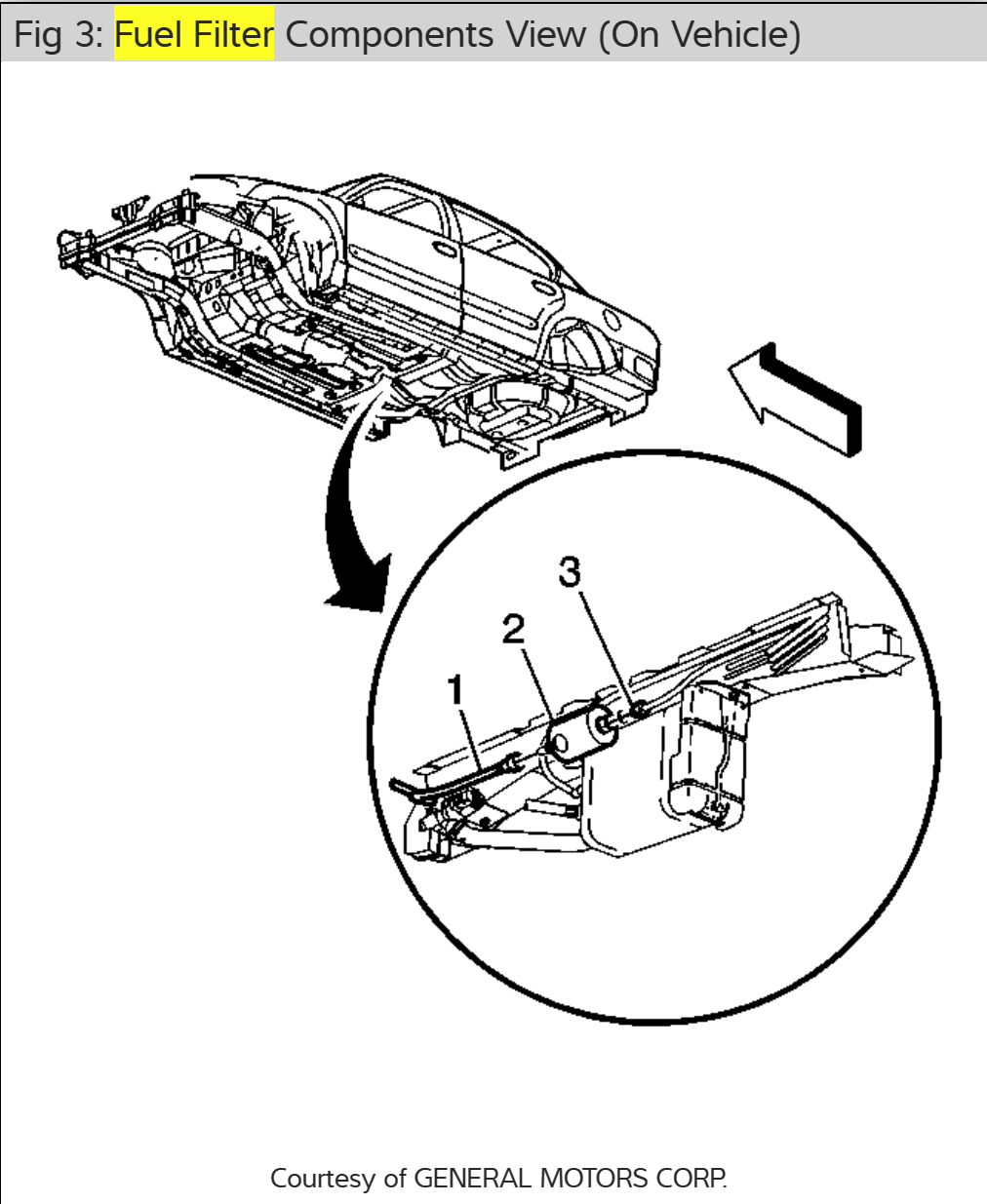

It seems for now that you have sufficient spark from what I can tell but it may be getting starved of fuel.

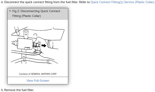

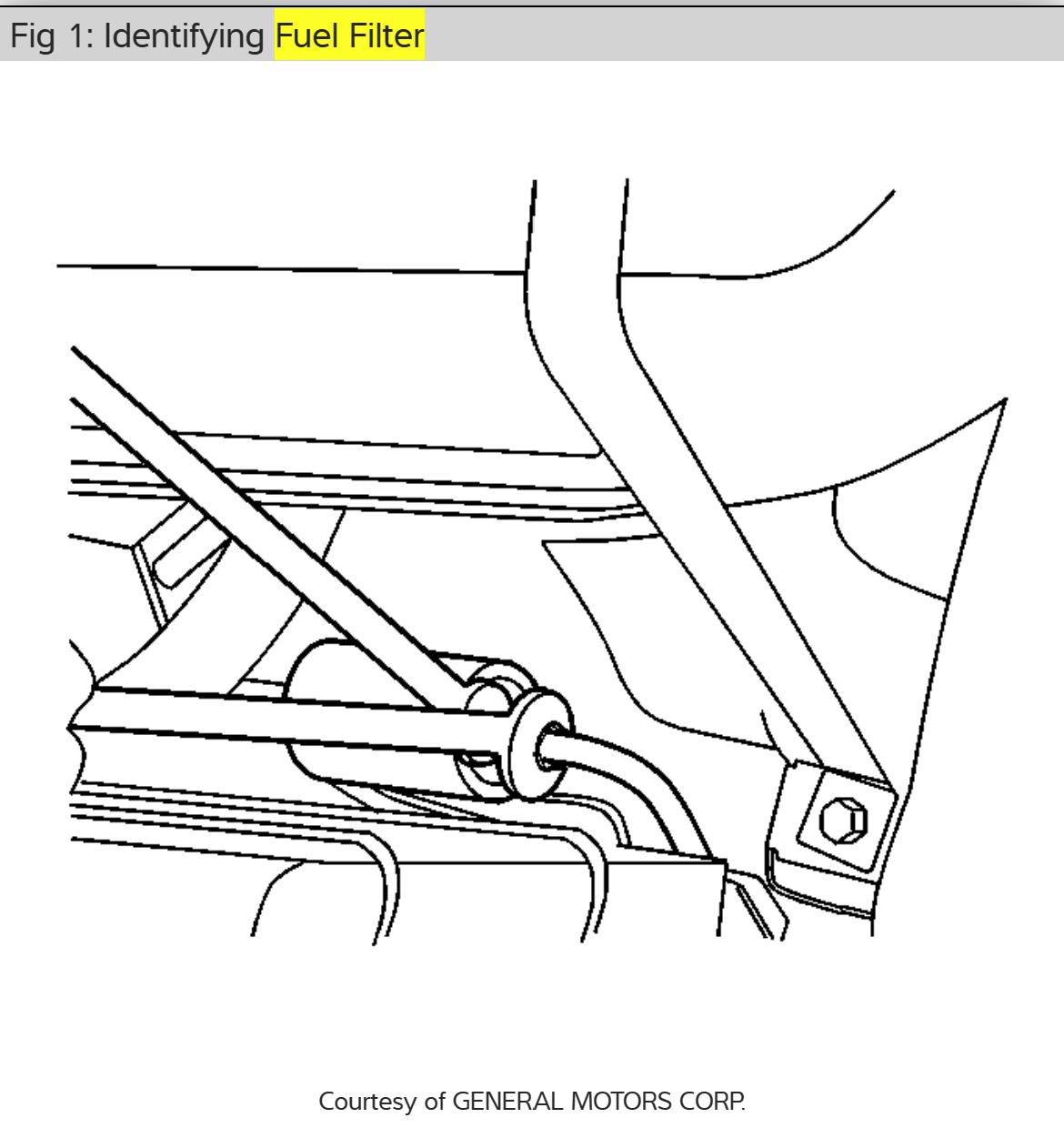

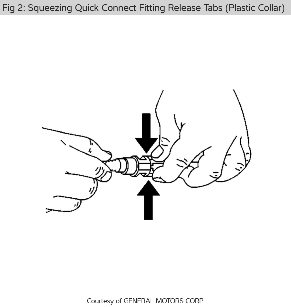

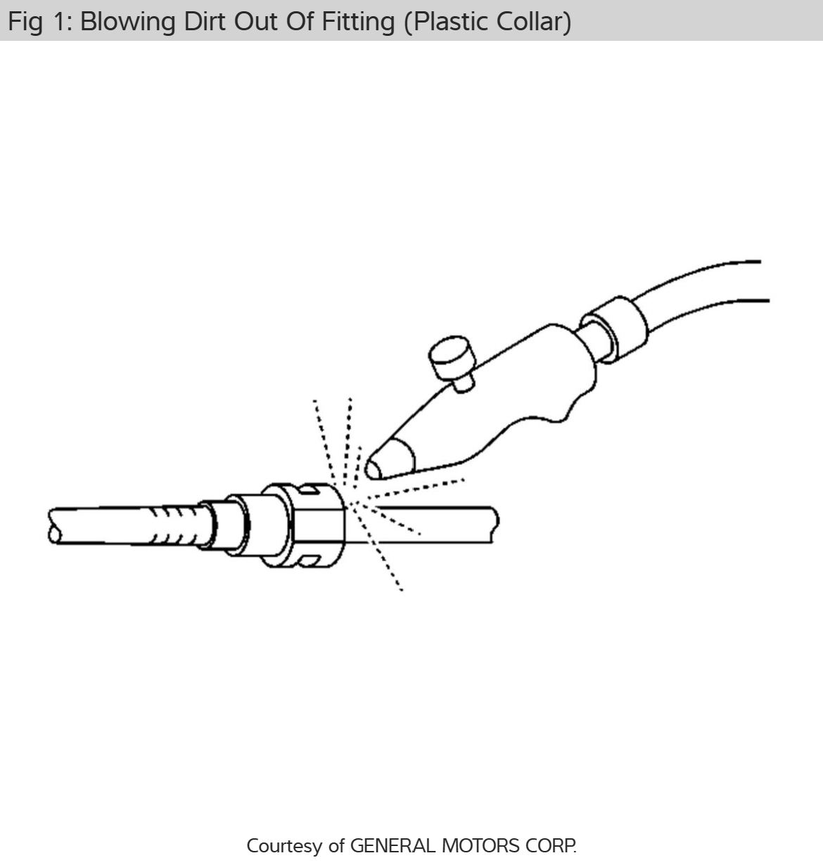

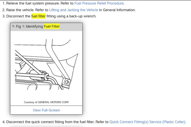

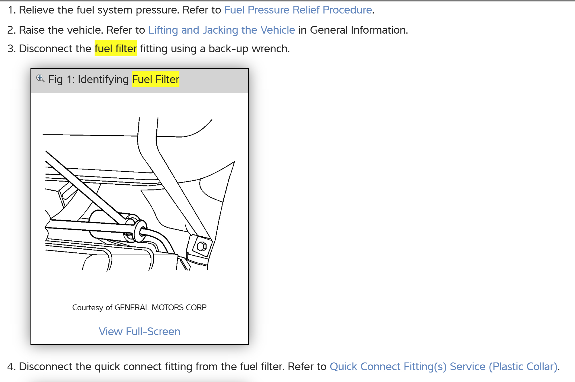

When was the last time the fuel filter was changed? If you are not sure, they are pretty cheap so it may be worth switching out with a new one.

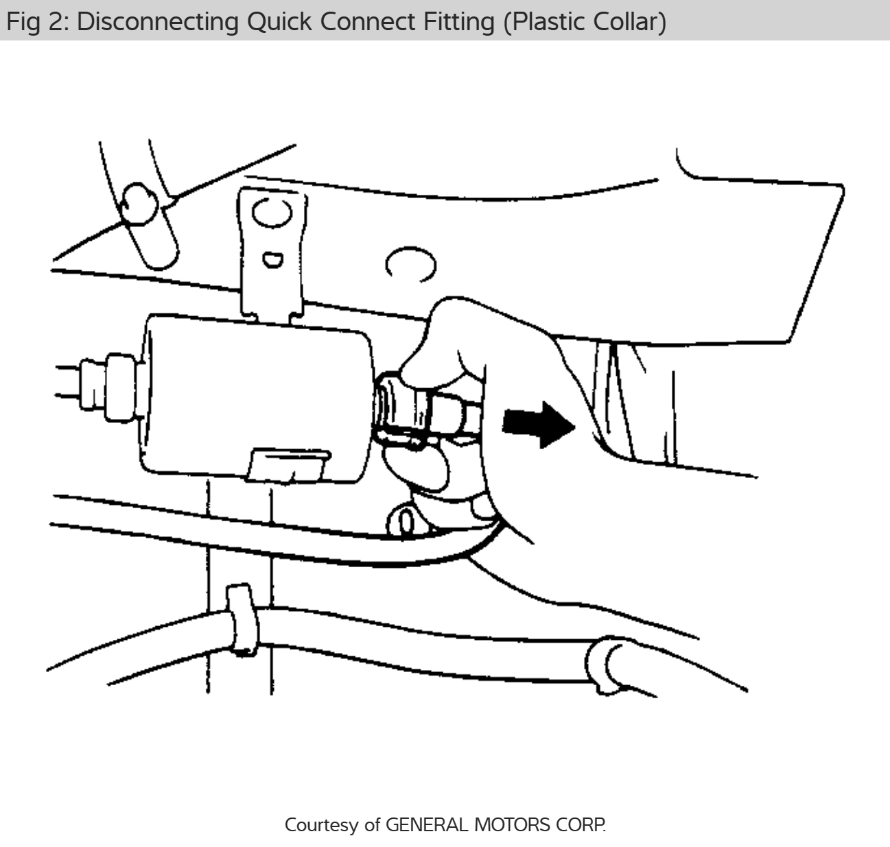

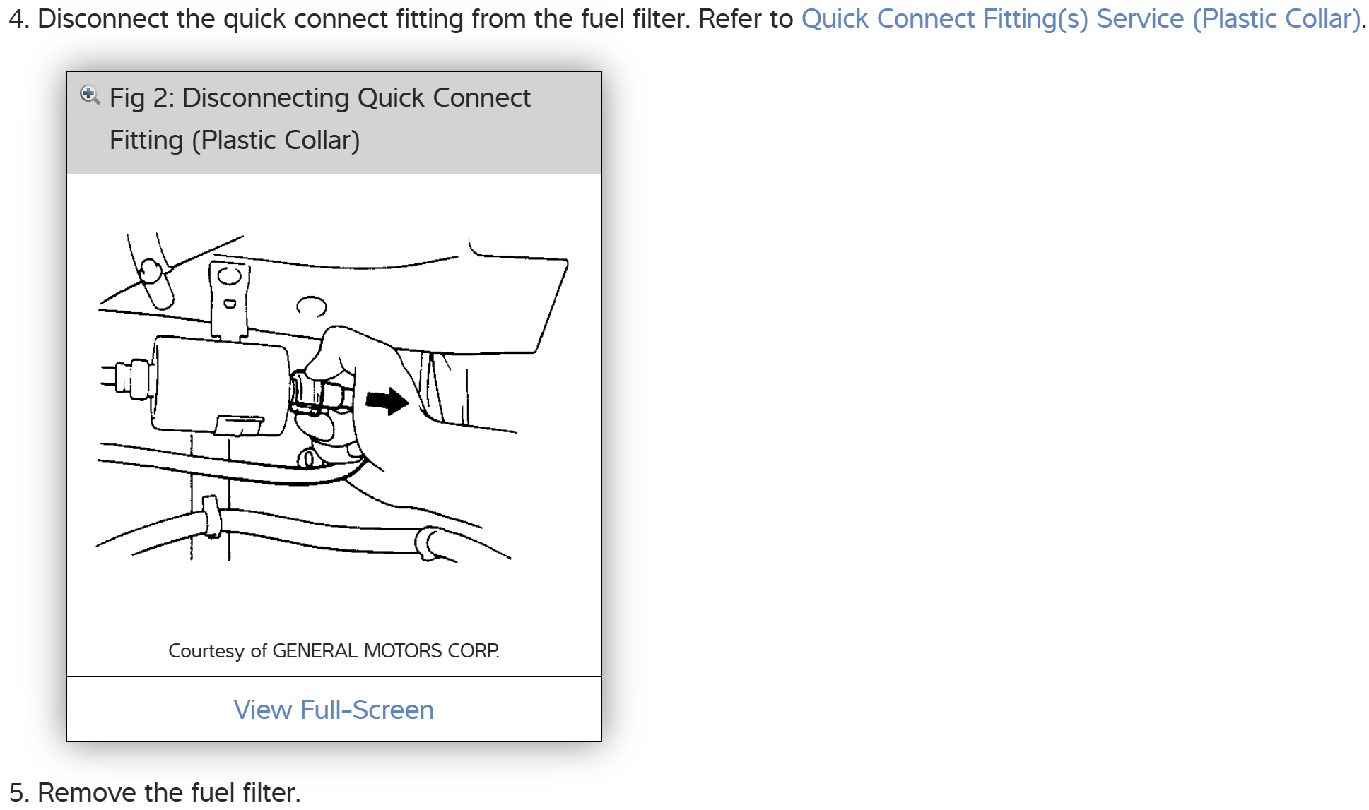

I have added an image of its location for you along with instructions on how to remove/replace it.
To do this, you will need to relieve fuel system pressure. This is pretty easy. There is a Schrader valve on the fuel rail. Looks like a tire valve mostly. And just like a tire valve, it will have a pin in it when you remove the cap. What I normally do is take a pic or something else pointy and wrap a rag around it. Then using that push on the valve and this will release the pressure in the system.
I would wear safety glasses because getting gas in your eye is not a pleasant experience.

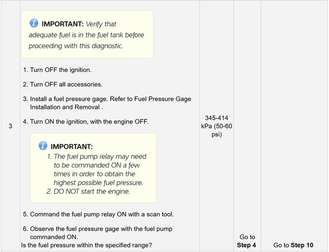

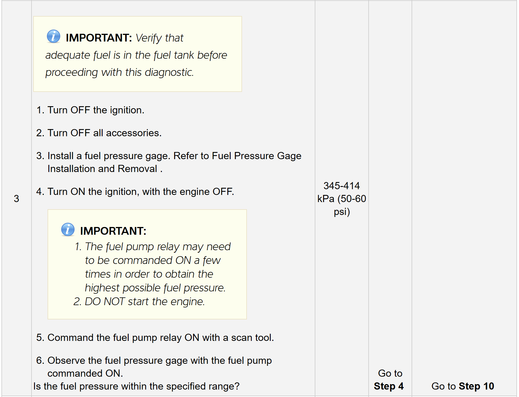

When you got the key on and hit the valve on the fuel rail shouldn't it continue to pump gas out if it's got a good fuel pump.
Sep 13, 2023 at 12:11 PM
Hey TRAVIS BUTLER2,
With the key on the fuel pump will run about 3 seconds and turn off. It should be between 50-60 PSI my information is telling me.
So, install the gauge and turn the key on and see what you get. Then just leave it and see if it holds the same pressure. You might have a variation of about 5 PSI when pump turns off, but it should stay constant after that.

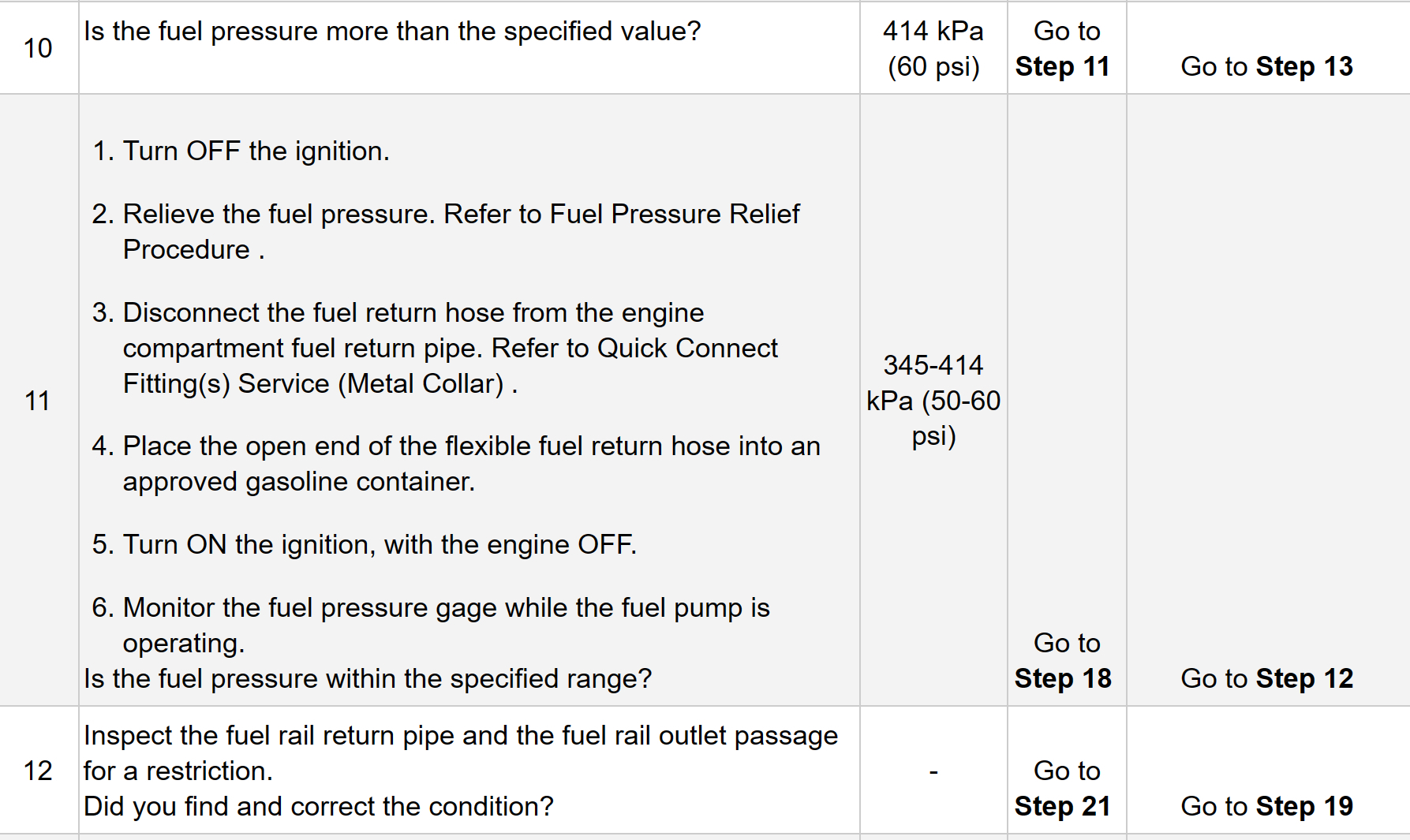

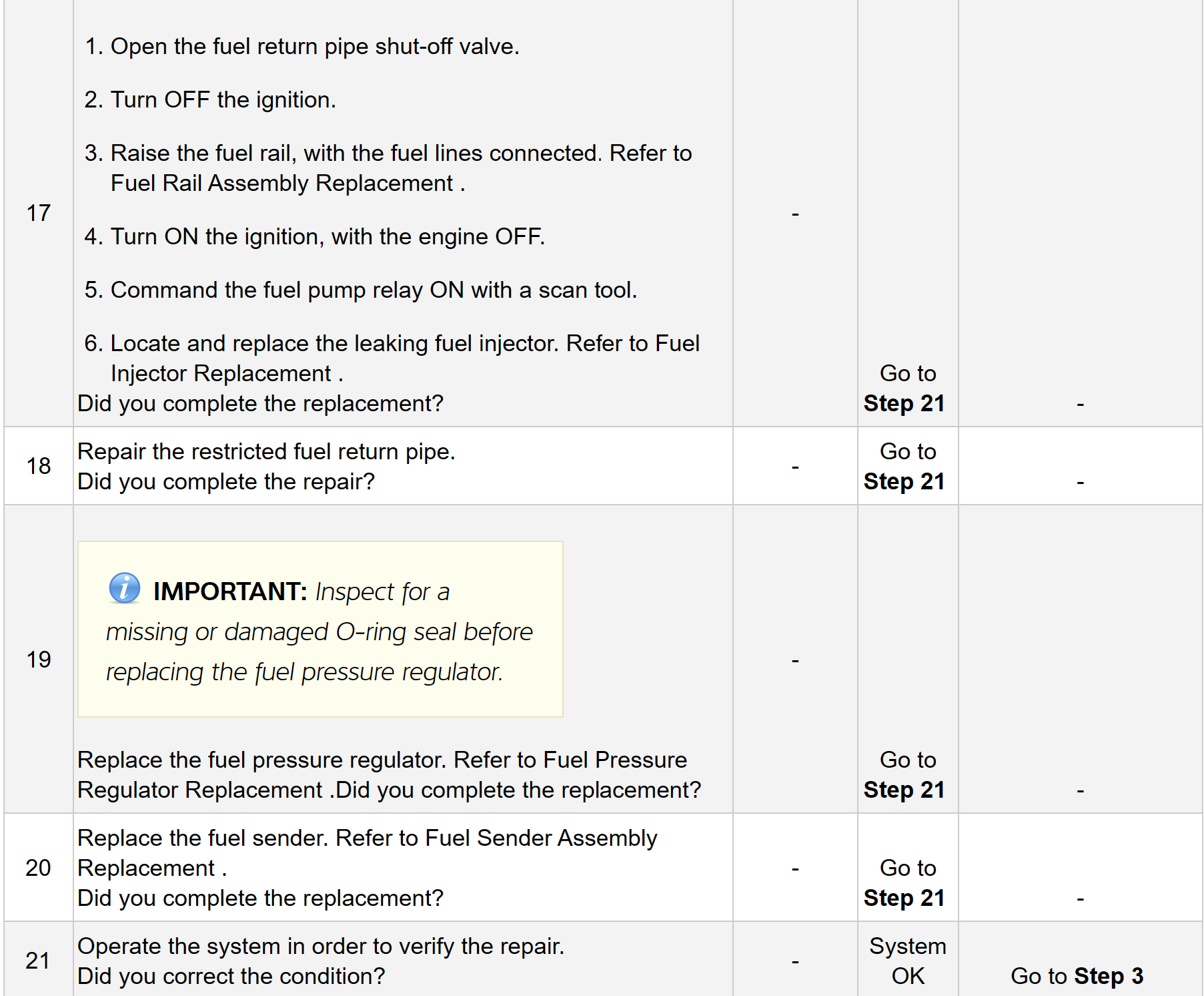

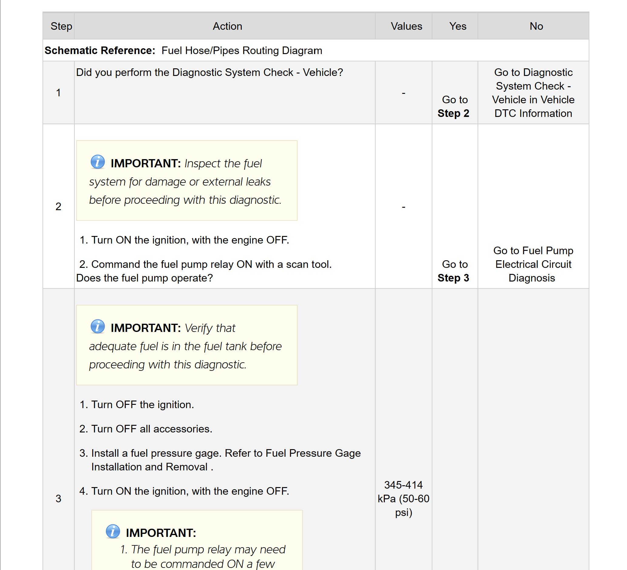

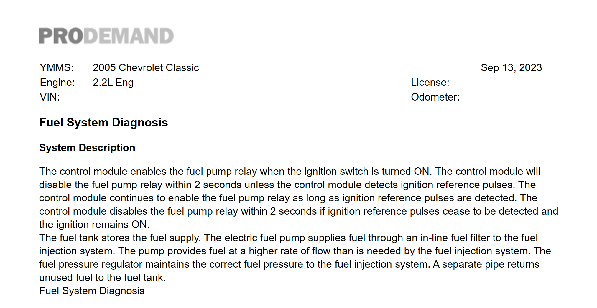

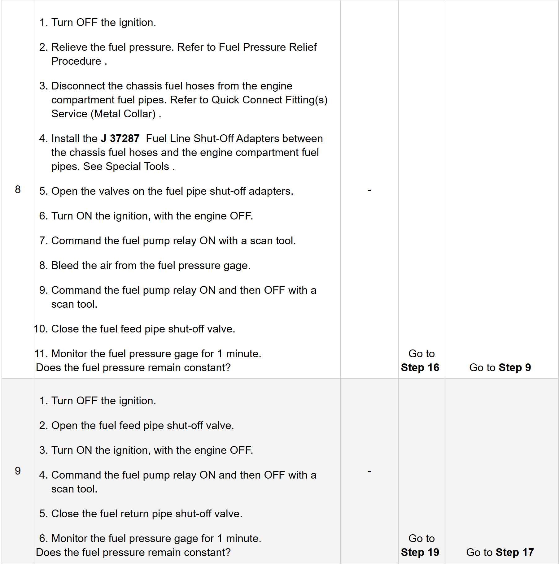

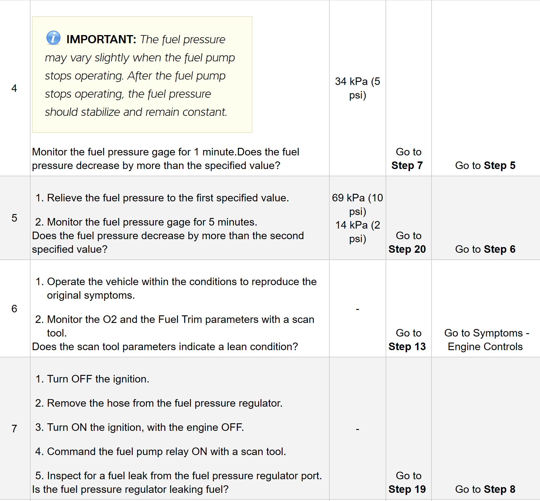

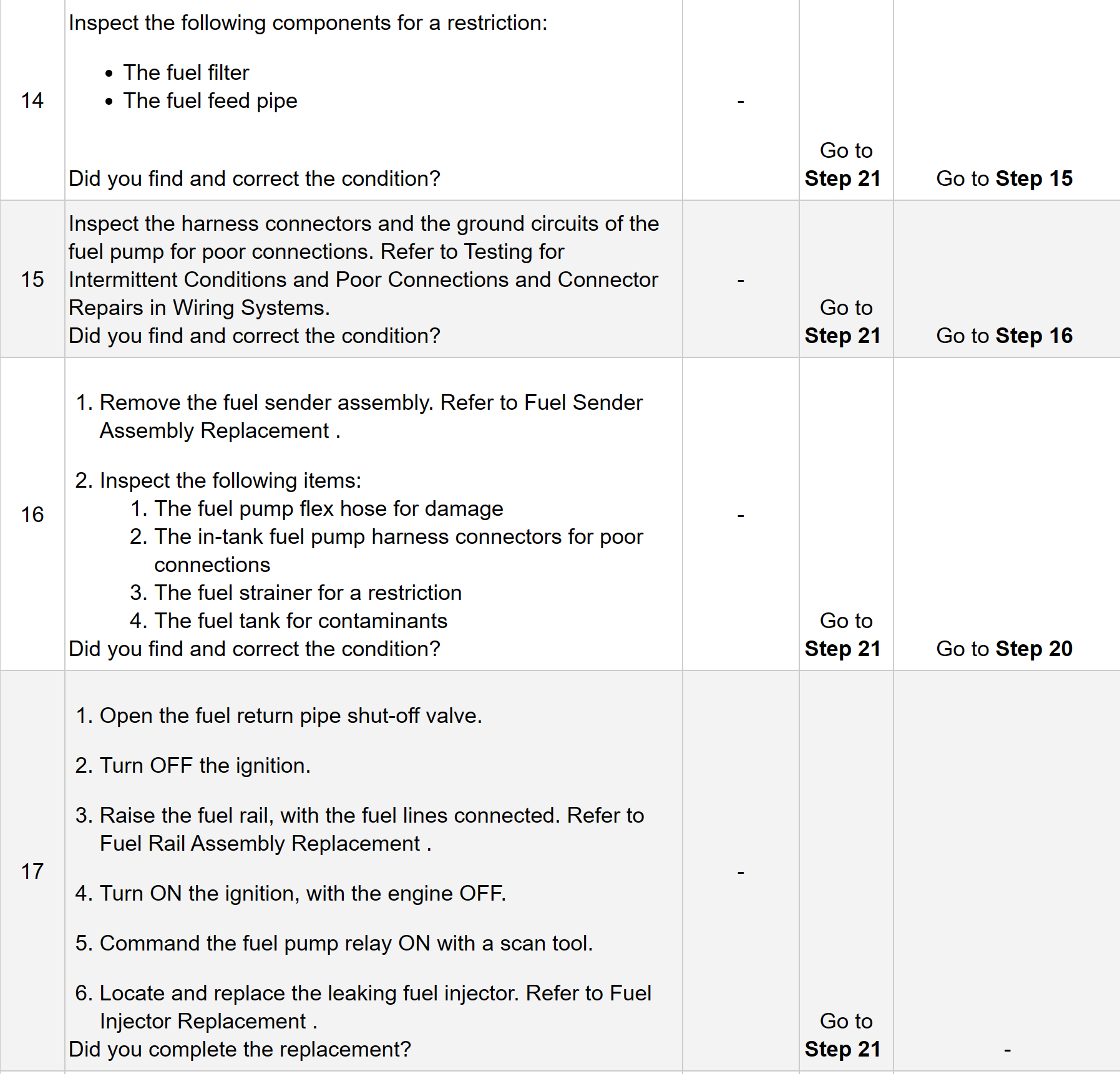

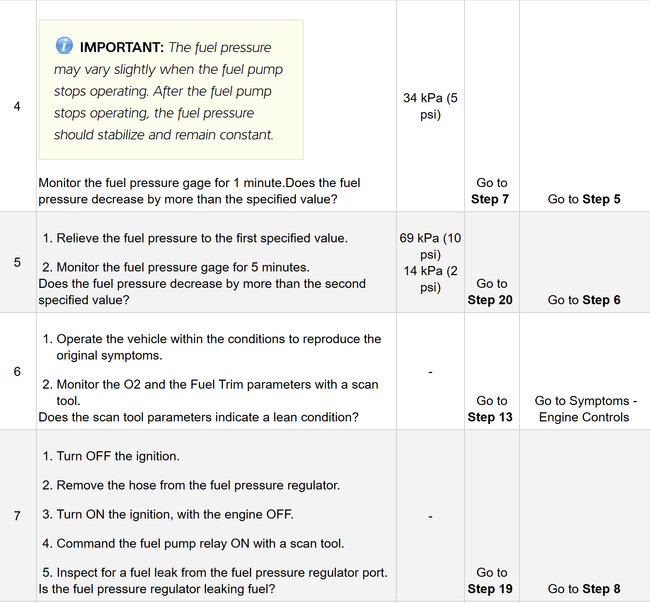

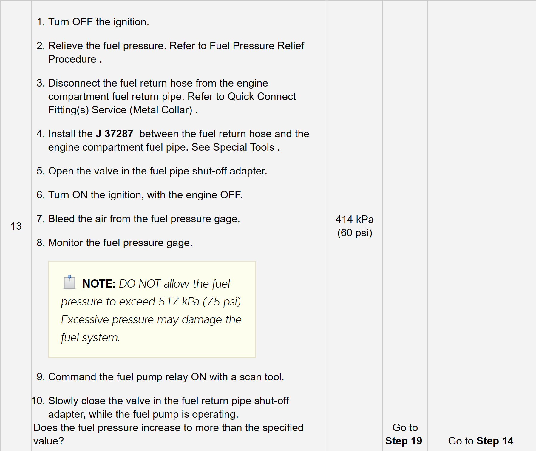

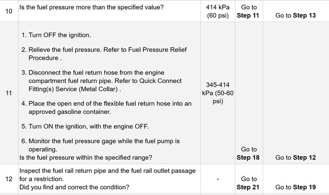

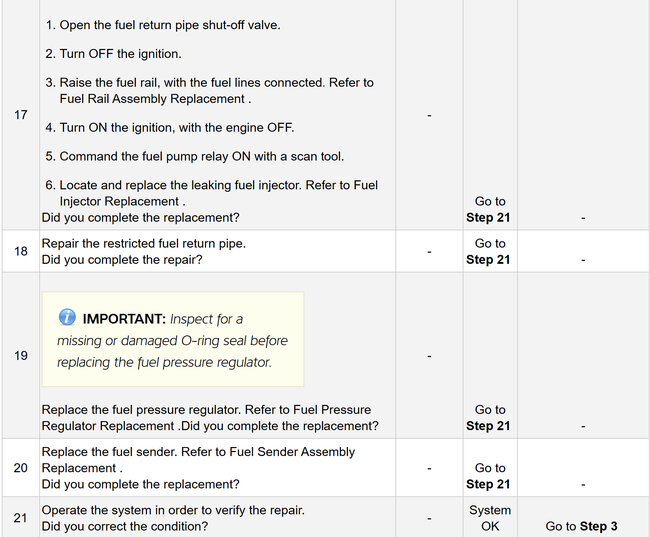

Do you have a fuel pressure tester? If not, you can rent one from an auto parts store if someone could give you a ride. If not, you can get them on Amazon.
I found this one for you. It seems decent and comes as a kit, but it also has a bleed valve on it that some cheaper ones don't.
Here is the link:
https://www.amazon.com/BETOOLL-0-140PSI-Injector-Injection-Pressure/dp/B00VV29NHM/ref=asc_df_B00VV29NHM?tag=bingshoppinga-20&linkCode=df0&hvadid=80470559180558&hvnetw=o&hvqmt=e&hvbmt=be&hvdev=c&hvlocint=&hvlocphy=&hvtargid=pla-4584070137775968&th=1
I have never bought from this seller, but it looks like a good product and it's inexpensive. Definitely a good tool to have.

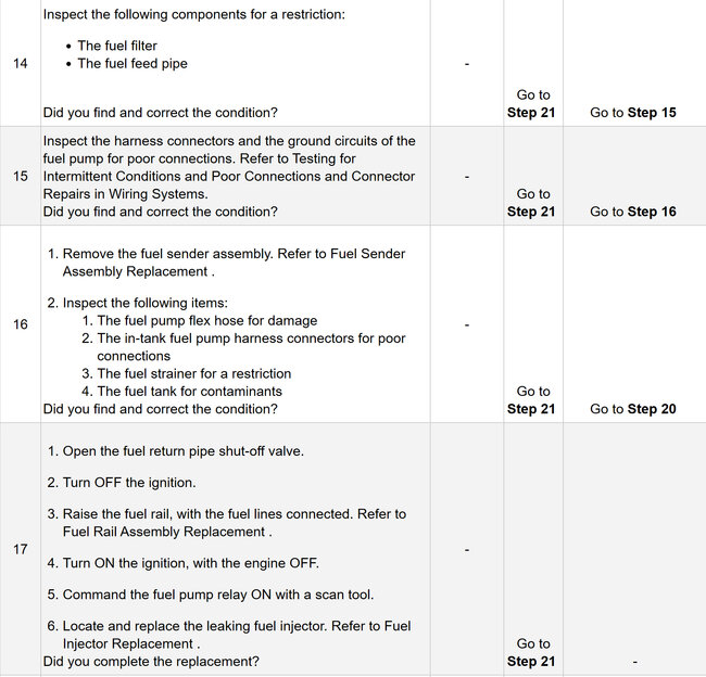

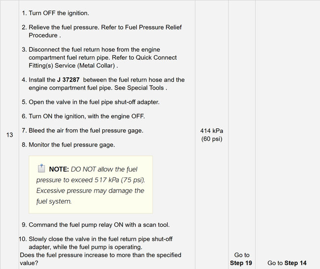

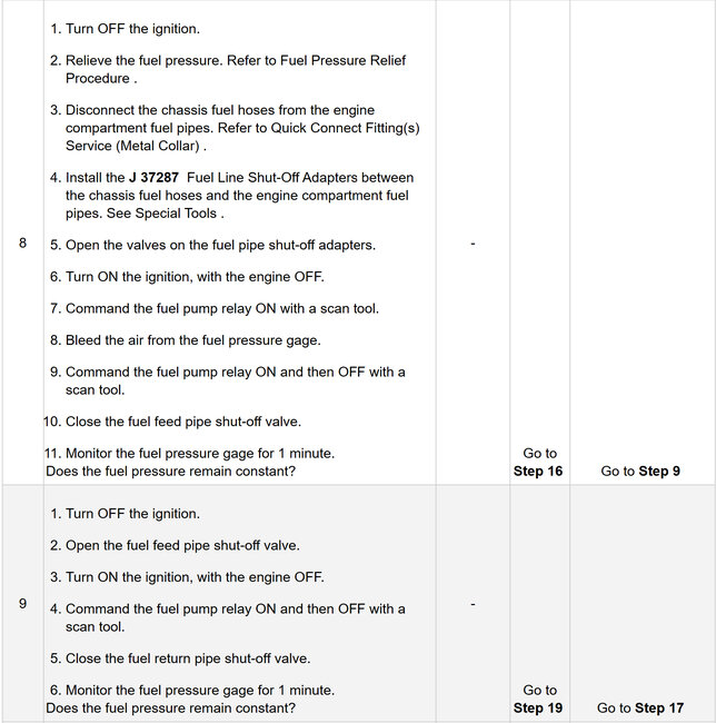

Also, I am adding a flow chart for Fuel System Diagnosis for you from my information. Let me know if you have any questions about it. It is designed for use with a scan tool and GM specialty tools, so some of the information is irrelevant.
I apologize it is in pieces. It is the only way I can send it unfortunately.
Also, that Salmon fishing sounds fun. I live in NY, so we don't have that here. Plenty of other fish but I wouldn't eat them. The water around here is just nasty looking unfortunately. Salmon is delicious though.
Hope this helps.
Let me know what you get for readings.
Thank you,
Brendon
