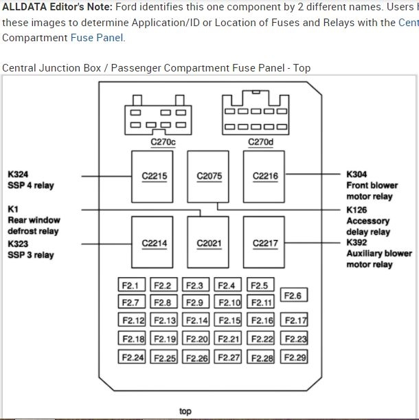

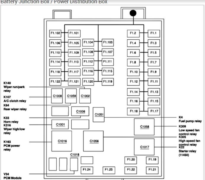

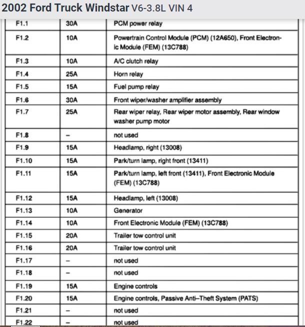

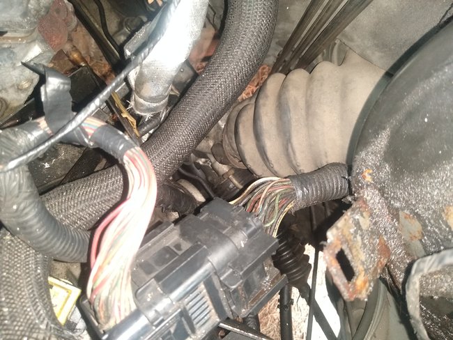

Check all power and grounds at the PCM. Check under hood fuse #8 being blown or missing and Inspect connector C213 for corrosion this connection is in the left side of the foot well inside the car. Look under the battery for harness connections as well.

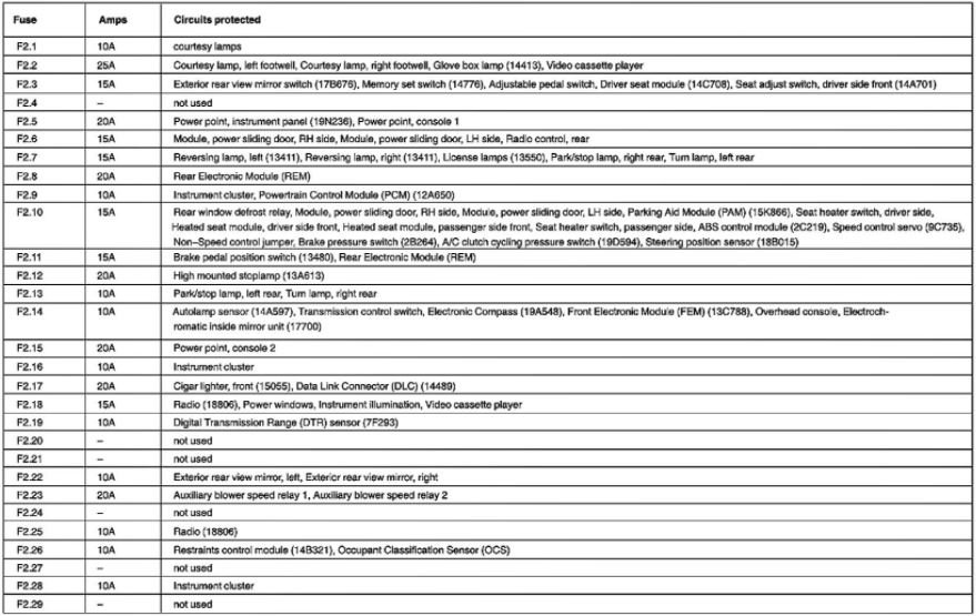

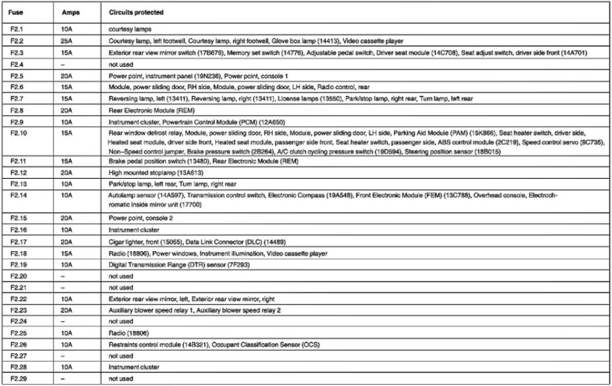

Here are the two fuse block diagrams and legends. As a matter of habit I always check all the fuses with a test light, I recommend doing that with the car on and everything on as well, ie, headlights, heater fan, radio, etc.
