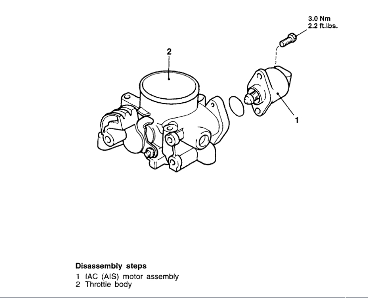

Obd II port
1999 MITSUBISHI ECLIPSE
185,000 MILES • 2.0L • 4 CYL • 2WD • MANUAL
Picture attached.
Jun 29, 2018 at 5:31 PM
MAGSENTONE
  • 85 POSTS
The opening for the throttle is facing away from the firewall and not up. Is that just the placement of the picture?
Jun 29, 2018 at 5:49 PM
Yes, just for reference.
Jun 29, 2018 at 6:00 PM
MAGSENTONE
  • 85 POSTS
Yeah, it is sandwiched between throttle body and firewall. Kind of hard to get to or get a tool to take it off. Any ideas and does it need to be cleaned or is the throttle plate and walls enough?
Jun 29, 2018 at 6:08 PM
Throttle body definitely needs to be cleaned. The IAC should be removed and the passages cleaned out. You cannot clean the idle air control valve.
Jun 29, 2018 at 6:13 PM
MAGSENTONE
  • 85 POSTS
Yes, I meant the passages and not the part itself. Thank you so much. Roy!
Jun 29, 2018 at 6:17 PM
You are welcome.
