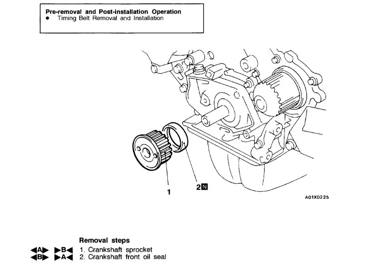

Hey Roy, I noticed an oily area located on the bottom part of the timing belt cover. I am thinking an oil pump seal but it is just below the drive belt that runs the alternator yet it appears oil keeps getting on it and sometimes causes a noise.. Any idea why? Thanks for your help Roy.
Michael
Jun 5, 2018 at 5:37 PM
That is the front crankshaft seal.
Picture below.

MAGSENTONE
  • 85 POSTS
Oh okay, I figured that too but is not the oil pump sprocket and seal just beside it? Also, how is oil getting on the alternator drive belt because it is up a little higher? Thanks again Roy!
