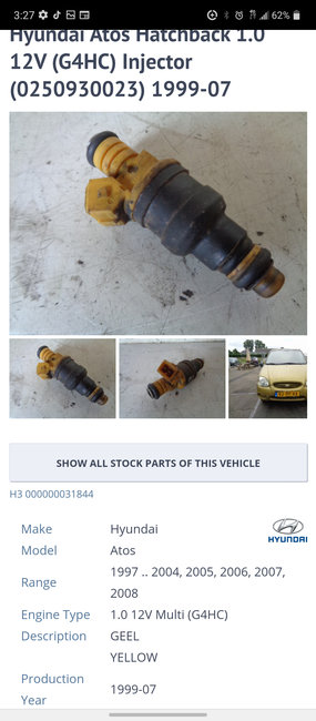

I just pulled injectors and the number on it came up with this. I have not rotated injectors yet but i thought you might be able to shed some light on what year motor the injector belongs to.
Dec 14, 2020 at 1:32 PM
STEVE W.
  • 15,113 POSTS
Okay, if the plug was wet that injector is likely bad. The black is from excess fuel and it sounds like it is sticking open. OEM number for the injectors for the 2.0 is 35310-23210.
So I think you found the culprit. Because the other plugs looked dark as well I'm going to say someone stuck a set of salvage yard injectors into it and were not real particular about what part they used. Then one of them failed and is dumping a lot of extra fuel into the engine and that is also why the trims are so high, it is trying to lean out the mix because of the extra fuel. I would probably replace all 4 with the correct part numbers and do an oil change as it's very likely the oil now has a lot of gas in it.
Dec 14, 2020 at 2:23 PM

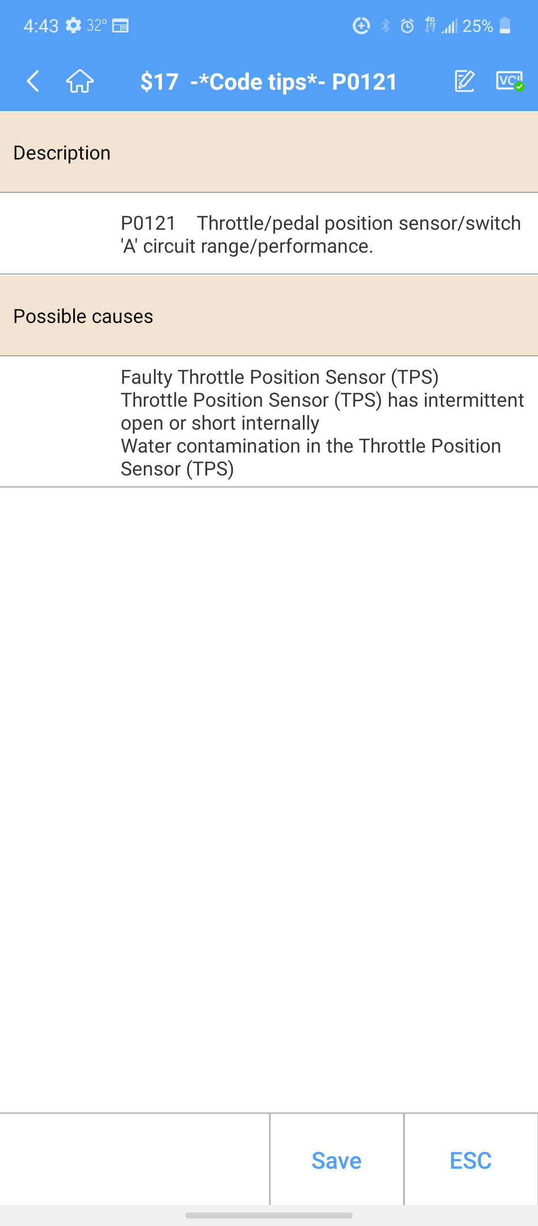

I just drove the car again and It did excellent except for whenever I stop or give it gas. and I got a code P0121. I sent you a picture of that code.
Dec 15, 2020 at 2:46 PM
STEVE W.
  • 15,113 POSTS
Great to hear it runs. okay, it looks like you answered your own question about the TPS. If your scan tool can graph the data you can watch the TPS voltage and slowly press the pedal down. If it's got an issue you should see the voltage drop out, just go very slow as the data has to go through the network and that time lag can hide a momentary drop.
Dec 15, 2020 at 6:09 PM

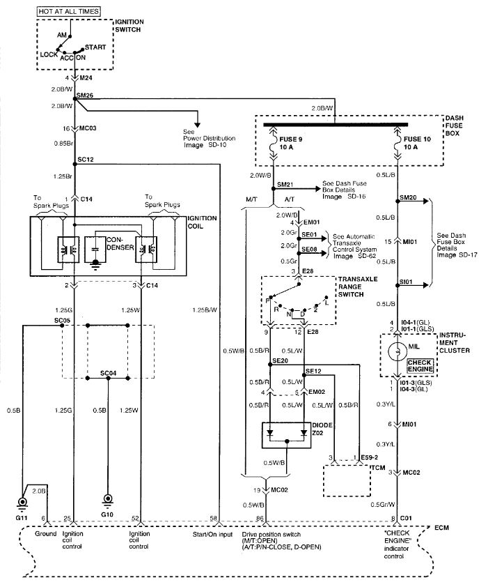

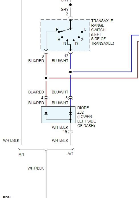

P1586 Encoding Signal Not Rational - MT/AT Encoding. IE the ECU doesn't know if you have a manual transmission or an automatic. I'm thinking you have a "parts" car. They took various bits from one car and tossed them onto this one to make a runner. Very possible that engine and ECM came from a manual transmission vehicle and now it doesn't know it's running an automatic. Look at the wiring diagram attached and you will see the "drive position switch" connection. Check the two fuses listed (9 and 10) and see if either is blown. Then look at pin 86 on the ECU. Should be a White wire with black stripe. On an automatic that wire should have battery voltage when the transmission is in park or neutral. The rest of the time it should get nothing. That could be the cause of the idle and lurching as the ECU doesn't know what to do.
Dec 17, 2020 at 6:51 PM
LOREN STOVER
  • 130 POSTS
Do you by chance know the location of these two fuses?
Dec 18, 2020 at 4:00 AM
STEVE W.
  • 15,113 POSTS
Should be in the fuse panel in the dash.
Dec 18, 2020 at 4:10 AM
LOREN STOVER
  • 130 POSTS

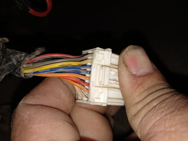

Number 9 and 10 fuses were okay and I followed the white wire with black stripe up to the throttle position sensor and I back probed the connector. If its not the correct way by all means tell me but the wire was getting 5.08 volts running in park. I didn't know if i needed to check with car running or shut off.
Dec 18, 2020 at 8:53 AM
STEVE W.
  • 15,113 POSTS

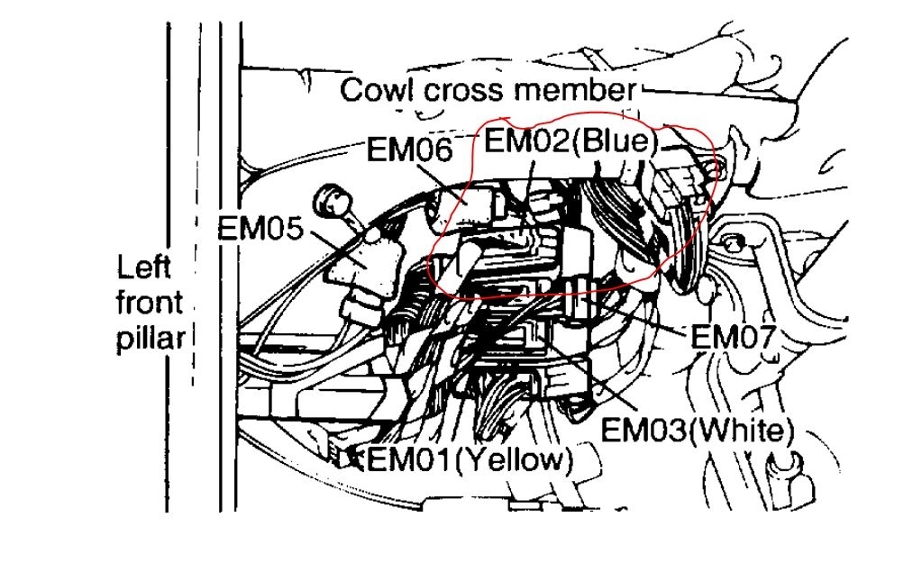

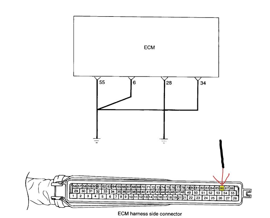

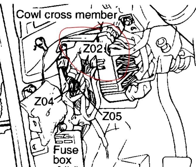

Different wire. The white with black you need should be from the transmission park neutral switch up to the ECM, it feeds battery voltage from fuse 9 to the TR switch which then tells the TCM which gear you are in for starting and then goes up to the ECM and through a diode set and that tells the ECM if you are in park or neutral. For the rest of the gears it sends no voltage to the ECM. The signal to the ECM is on pin 86, To test it the easy way you can use a test light connected to ground and stick a pin through the insulation on the wire that you can seal with a dab of glue or liquid tape. With the key in the on position that wire should have battery voltage when the transmission is in Park or Neutral. In all other gears the light should stay off. If it doesn't come on at all you have a broken or disconnected wire, if it stays on in all gears it is shorted somewhere to power. Use the meter and see what voltage it is at.
Dec 18, 2020 at 11:53 AM
LOREN STOVER
  • 130 POSTS
The connector doesn't have any numbers on it and I only found a few white wires with black stripes and if that wires supposed to be in that connector like the attachment you sent me it's not there.
Dec 18, 2020 at 3:21 PM
STEVE W.
  • 15,113 POSTS
It should be 3 pins in on the end in position 86. If it's not there then that is the problem and it will need to be fixed to cure that code and likely make it run better as well. That wire should be there on both the manual and the automatic cars. Could you take a picture of that connector up close on each end and post it please? The diode Z02 that feeds the wire should be in or near the EM02 connector circled in the image, it will have Black wire w red stripe and a Blue wire with white stripe in one side and the White wire with black stripe out the other. If that is there it would be possible to run a wire or trace the wire that comes out and see where it goes.
Dec 18, 2020 at 5:44 PM

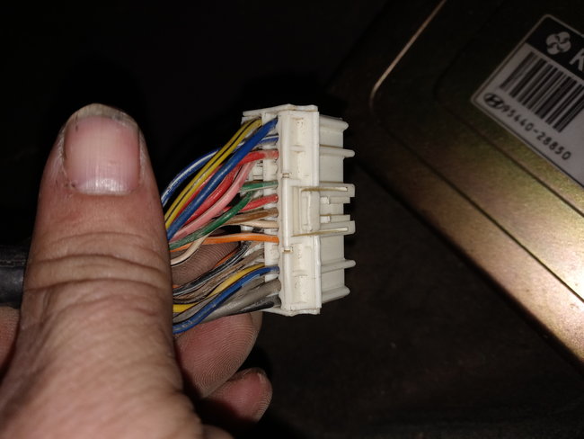

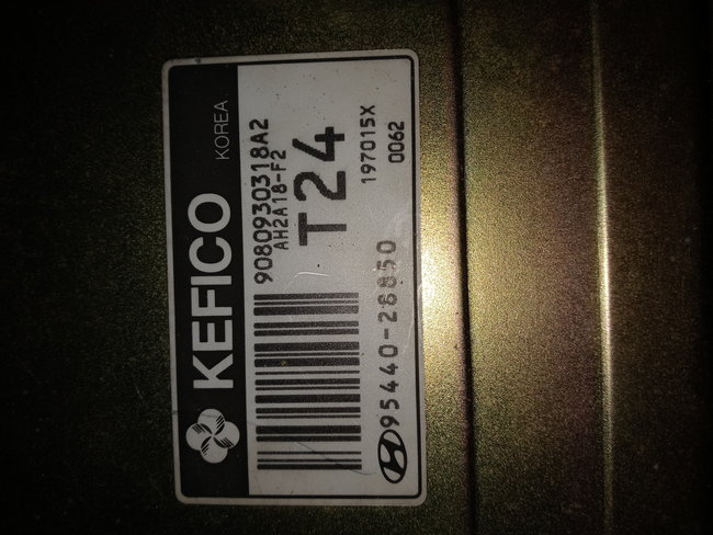

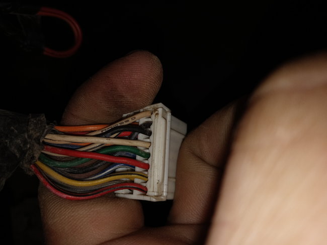

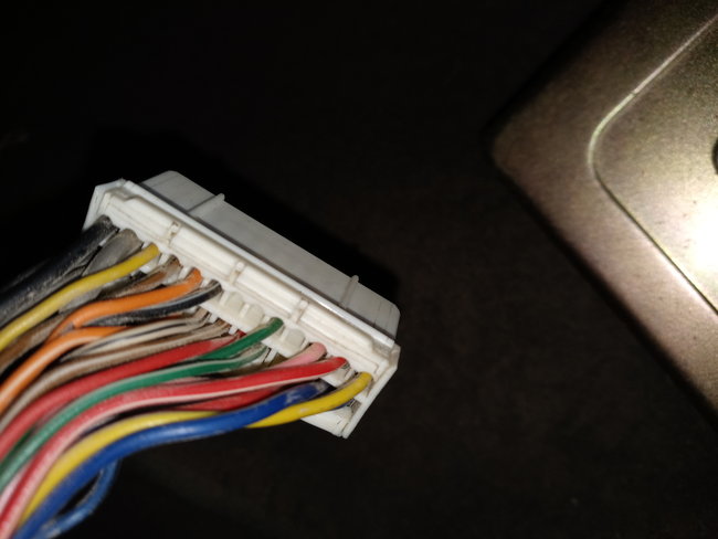

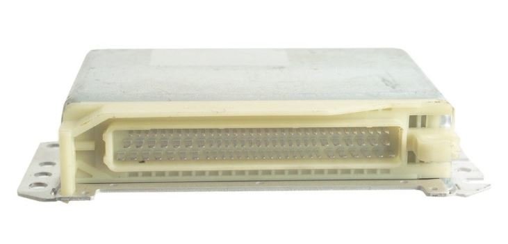

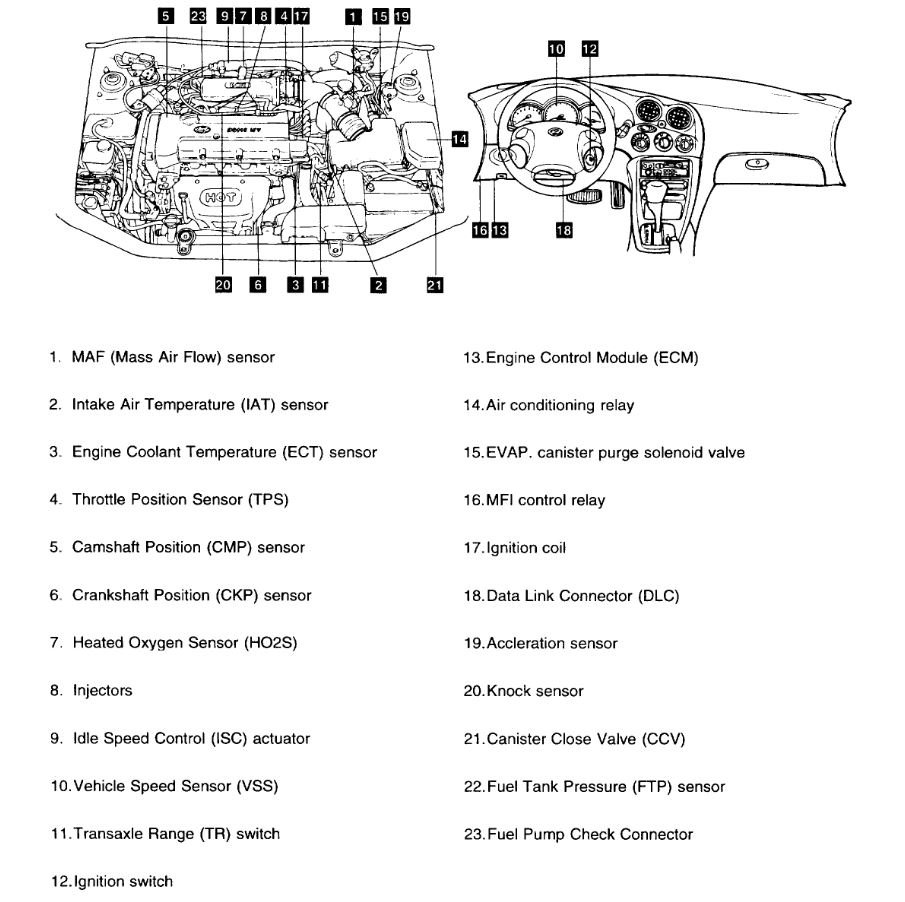

There's two plugs on the ECM so I took a picture of the front and back side of each connector and I took a picture of the ECM itself. maybe you can look up part number and see if it's the right computer.
Dec 19, 2020 at 3:35 PM
STEVE W.
  • 15,113 POSTS
The ECU for your car should have a large single connector for the wiring harness. The part number should be 39150-23956 or 39150-23951 as in the first image depends on the emission package. It is inside the car up under the dash.
The unit you are showing is the Transmission Control Unit. By the part number it is the correct unit for a 2000 at least.
Dec 19, 2020 at 7:30 PM

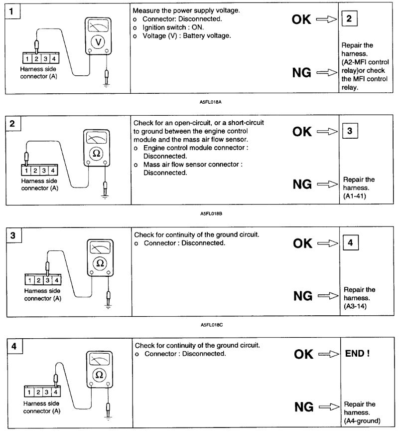

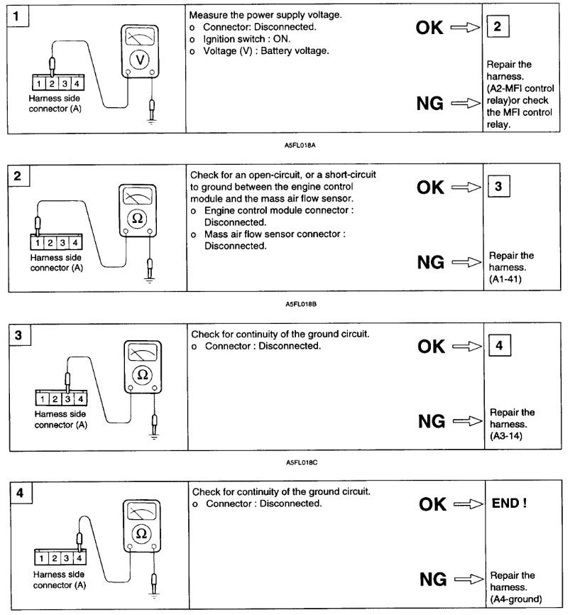

I haven't gotten to that wire yet. it's a booger to get to. anyways, I started messing around under the hood and so happened to unplug the mass airflow sensor and the car started running pretty straight and if I plug it in it will shut off. so any thoughts?
Dec 20, 2020 at 9:13 AM
STEVE W.
  • 15,113 POSTS

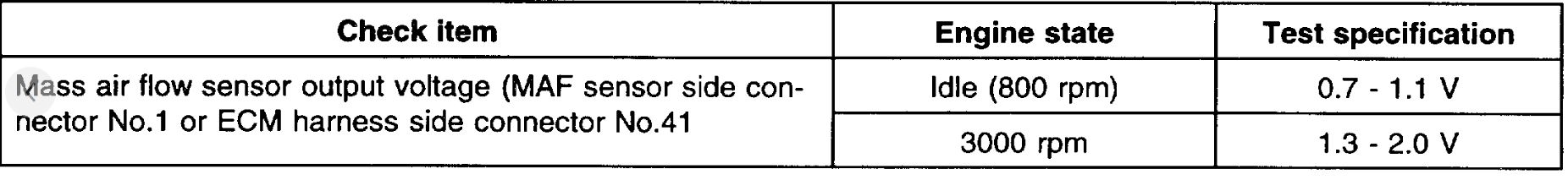

That is due to the engine switching to a default programming with the MAF unplugged. However it's possible the MAF does have a problem, they can skew a bit and still not set a code. Normally they will set a P0102 or P0103 if they are out of range.
This is the testing for the MAF-
1. If the engine stalls occasionally, start the engine and shake the MAF sensor harness. If the engine stalls, check for poor contact at the MAF sensor connector.
2. If the MAF sensor output voltage is other than 0 when the ignition switch is turned on (do not start the engine). Check for the faulty MAF sensor or ECM.
3. If the engine can be idle even if the MAF sensor output voltage is out of specification, check for the following conditions:
Disturbed air flow in the MAF sensor, disconnected air duct, and clogged air cleaner filter.
Poor combustion in the cylinder, faulty ignition plug, ignition coil, injector, and incorrect comparison.
4. Though no MAF sensor malfunction occurs, check the mounting direction of MAF sensor.
Dec 21, 2020 at 7:06 AM
