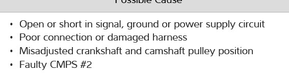

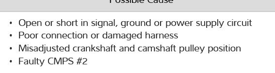

the first codeand 2106 may be related it may have one of the things wrong in pic or you have a cam problem like timing chain and noise so have that looked at it may have jumped time. the 365 may be from same thing or the gas pedal/ or throttle body are bad. try cleaning throttle plate on both sides and iac hole with choke cleaner it may fix it but will still show until it is erased with a scanner. with the compression on #2 it's not with in 20% so it may have a bent valve especially if timing chain/belt jumped or slipped.

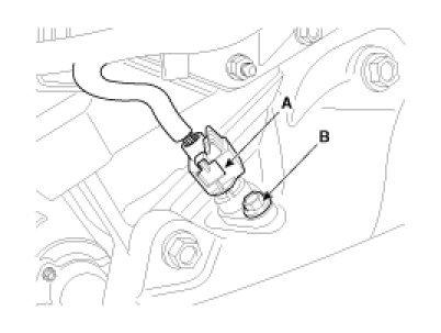

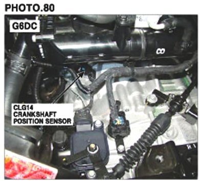

If you suspect the crankshaft position sensor is the problem, here are the specific directions for replacement.
Removal
1. Turn the ignition switch OFF and disconnect the battery negative (-) cable.
2. Remove the air cleaner assembly .
3. Disconnect the crankshaft position sensor connector (A).
4. Remove the installation bolt (B), and then vertically remove the sensor from the transaxle housing.
See Pic 1
Installation
CAUTION:
- Install the component with the specified torques.
- Note that internal damage may occur when the component is dropped. If the component has been dropped, inspect before installing.
CAUTION:
- Apply the engine oil to the O-ring.
CAUTION:
- Insert the sensor in the installation hole and be careful not to damage when installation.
1. Installation is reverse of removal.
Crankshaft position sensor installation bolt:
6.9 - 9.8 N.m (0.7 - 1.0 kgf.m, 5.1 - 7.2 lb-ft)
Picture 2 shows its location.

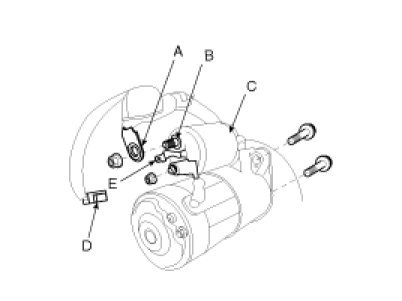

If you find the starter is the issue, here are the directions. The attached picture correlates with these directions. Make sure before starting to remove it that you disconnect the negative battery terminal so power can't get to the starter.
_____________________
REPAIR PROCEDURES
Removal
Starter
1. Disconnect the battery negative cable.
2. Disconnect the starter cable (A) from the B terminal (B) on the solenoid (C), then disconnect the connector (D) from the S terminal (E).
Pic 1
3. Remove the 2 bolts holding the starter, then remove the starter.
Tightening torque :
49.0 - 63.7N.m (5.0 - 6.5kgf.m, 36.2 - 47.0lb-ft)
4. Installation is the reverse of removal.
5. Connect the battery negative cable to the battery.
