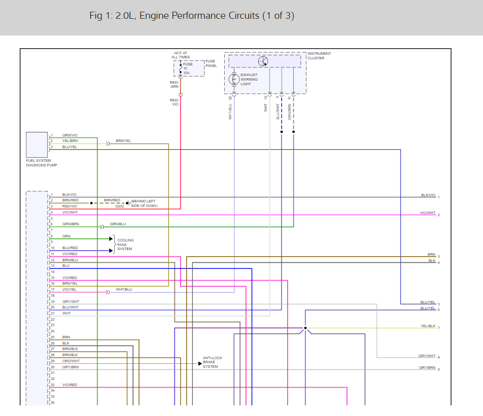

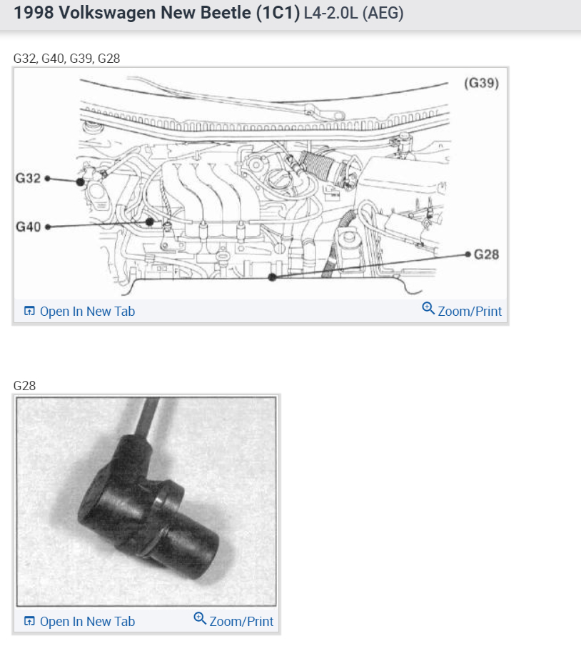

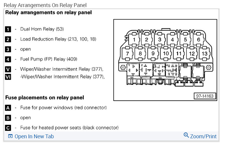

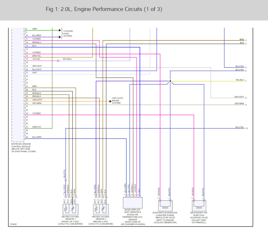

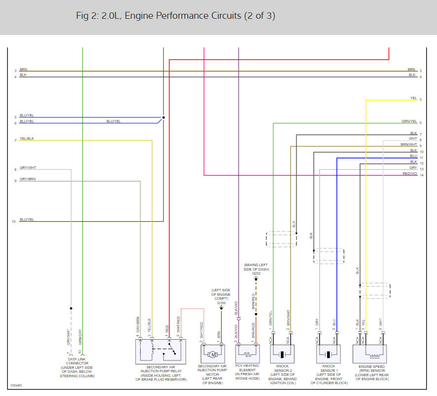

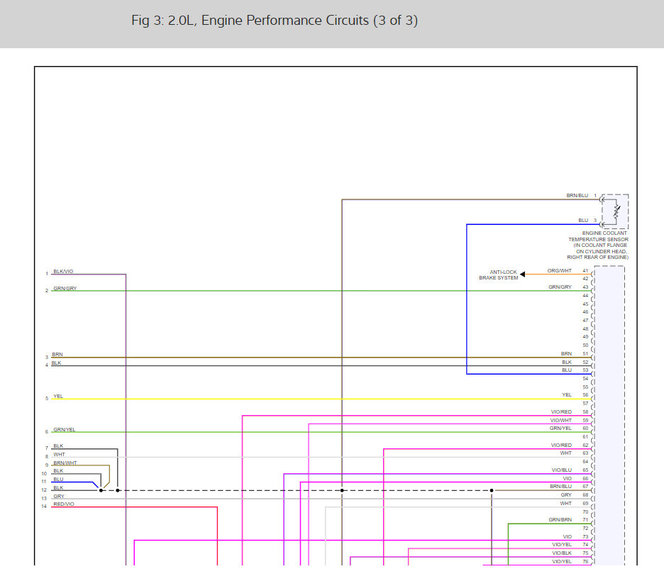

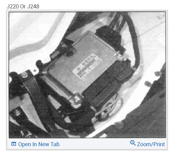

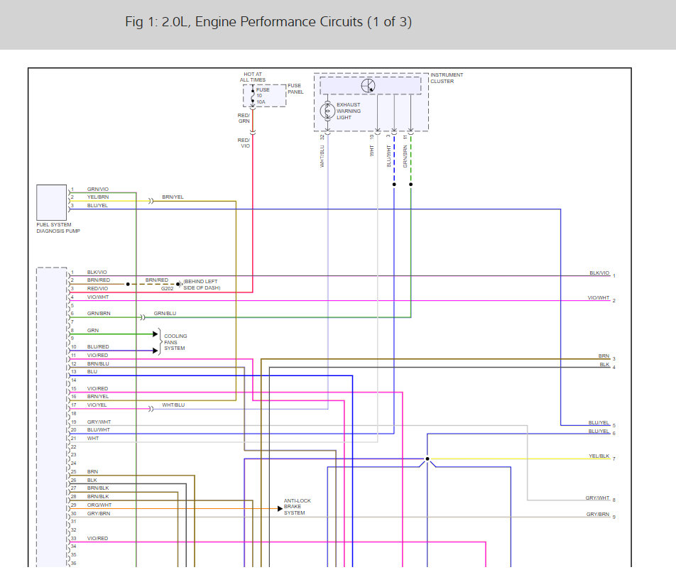

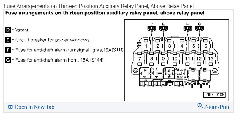

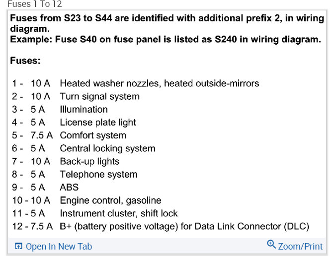

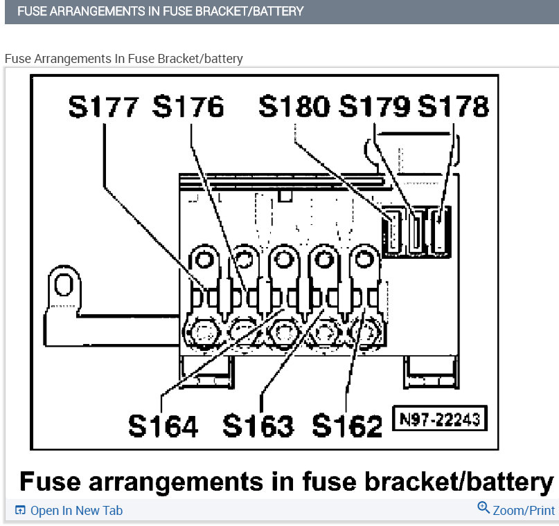

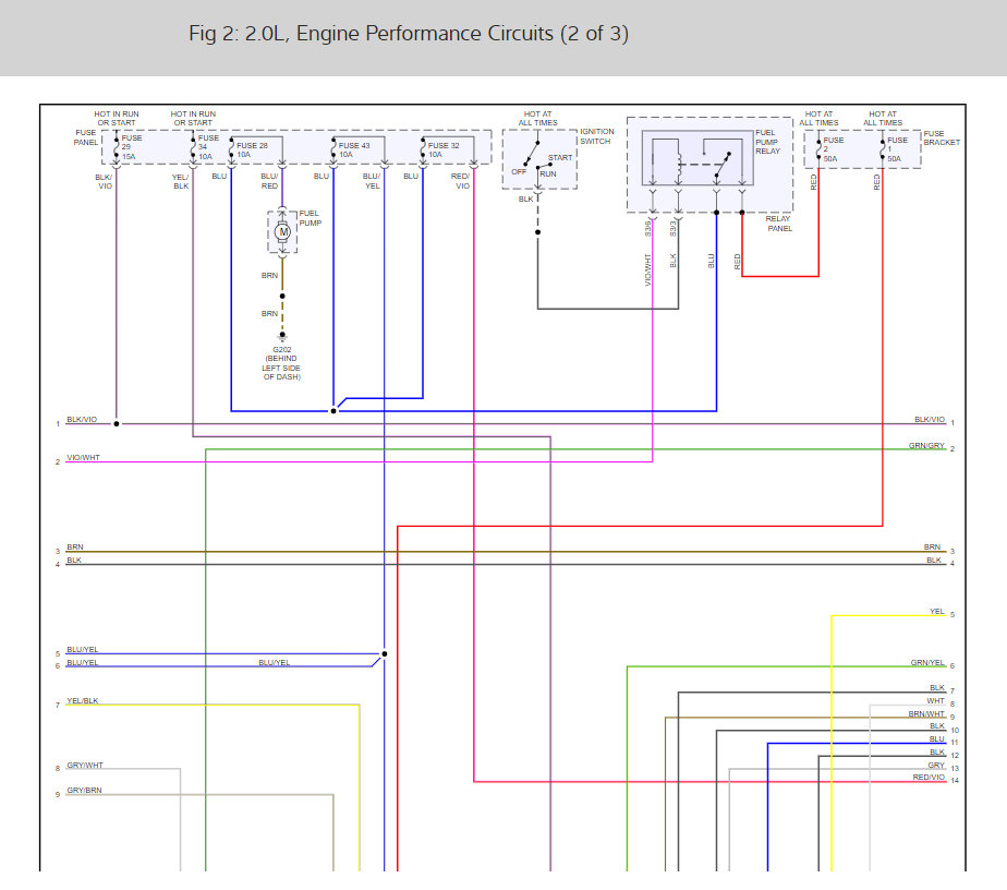

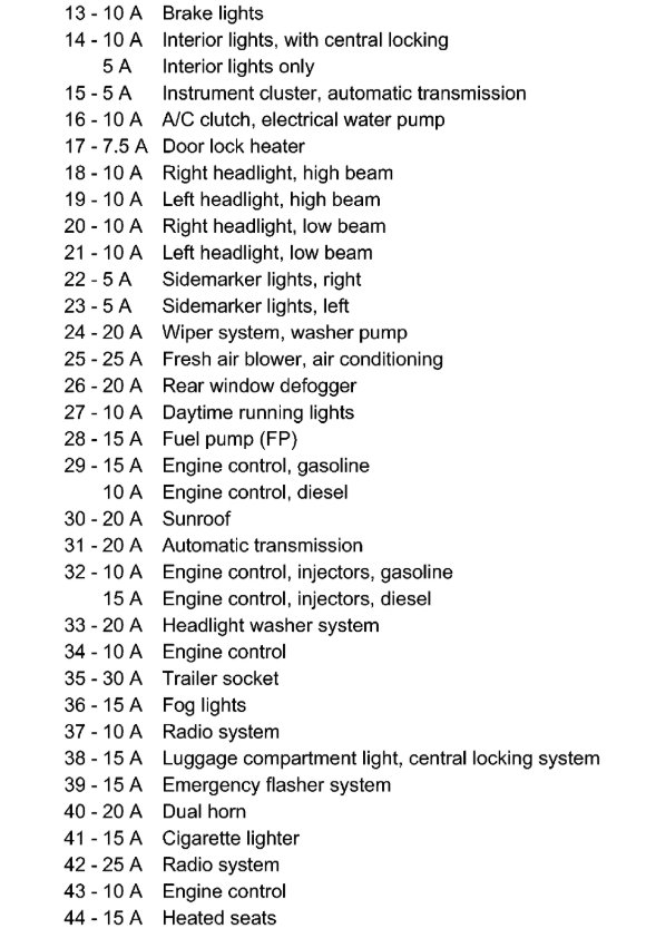

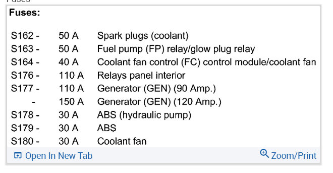

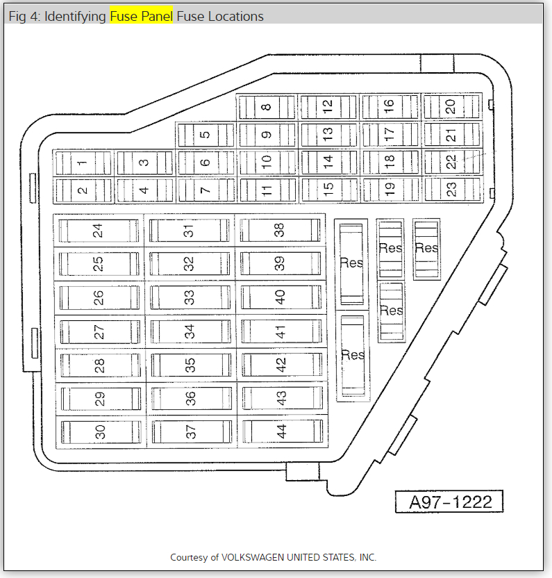

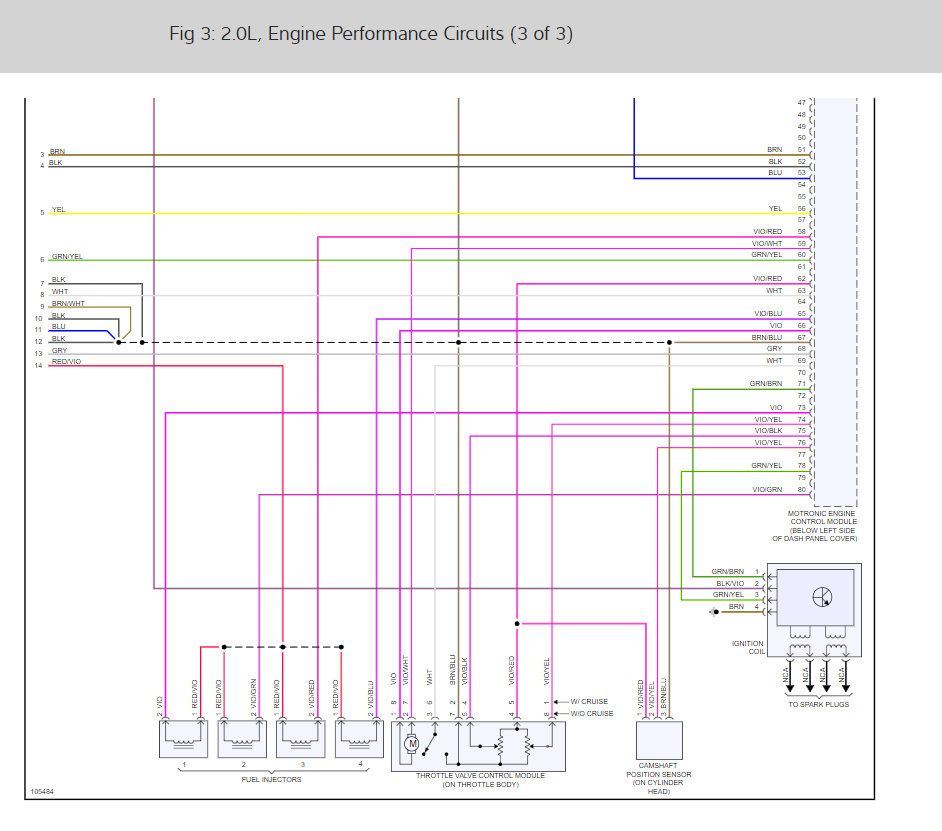

Car will not run unless starting fluid is used. Fuel pump relay has to be jumped to get fuel pump on but it was working normal after the no start. Seems like the fuel system has shut down and will not deliver gas to plugs.
