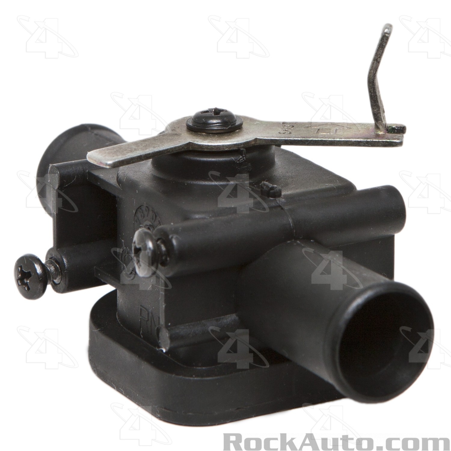

JOHNNY G.JR
  • 320 POSTS
Check the heater control valve. it is vacuum controlled. move lever on dash and see if control moves and check for vacuum at source and valve.
Jan 11, 2017 at 12:07 PM

SATURNTECH9
  • 30,869 POSTS

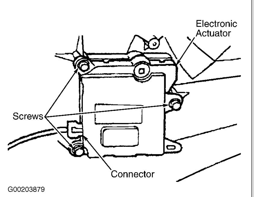

There is your heater valve. I posted a picture of it.
Jan 12, 2017 at 6:44 AM

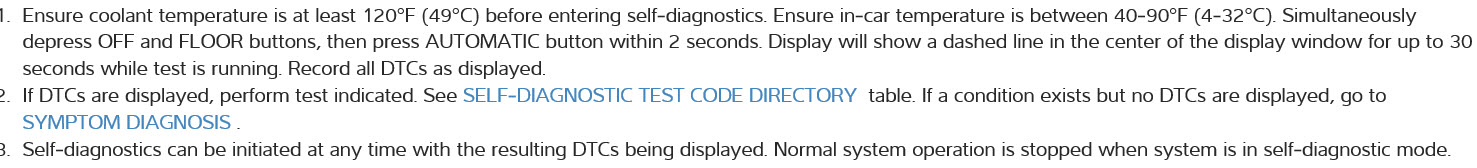

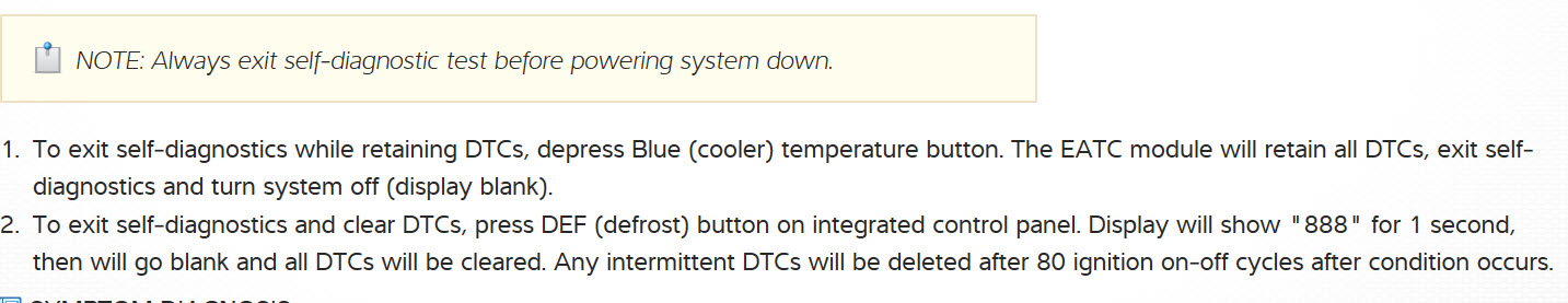

HMAC300
  • 48,601 POSTS
guys, it automatic temperature it may be a sensor bad. see pictures on how to enter and exit self test for automatic temperature control then get back with codes if any. also, check for vacuum leaks at vacuum motors.

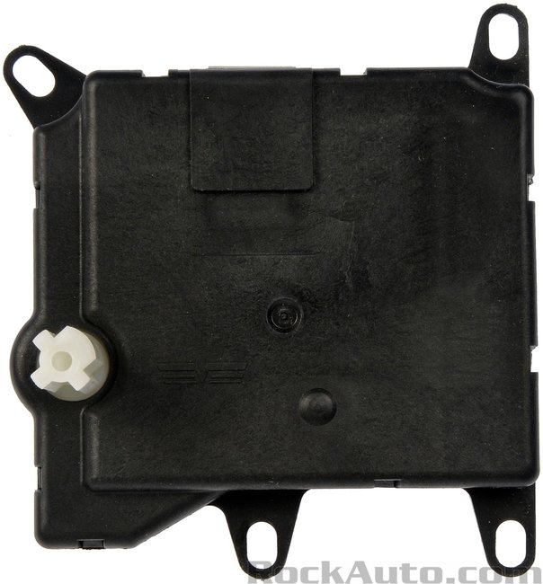

SATURNTECH9
  • 30,869 POSTS
I posted a picture if the blend door actuator. It still has coolant going in and out of the heater core blend door actuator etc.Those are basic checks ether way it is automatic or manual controls.
Jan 12, 2017 at 6:48 AM

SATURNTECH9
  • 30,869 POSTS
The blend door actuator is behind the center of the dash.
Jan 13, 2017 at 7:19 PM

SATURNTECH9
  • 30,869 POSTS
No it's a electric actuator and the glove box part is if your replacing the blend door with the dorman repair kit.
Jan 13, 2017 at 7:59 PM
SATURNTECH9
  • 30,869 POSTS
Should be able to see it to the left side of the glove box up under the dash
Jan 13, 2017 at 8:00 PM
