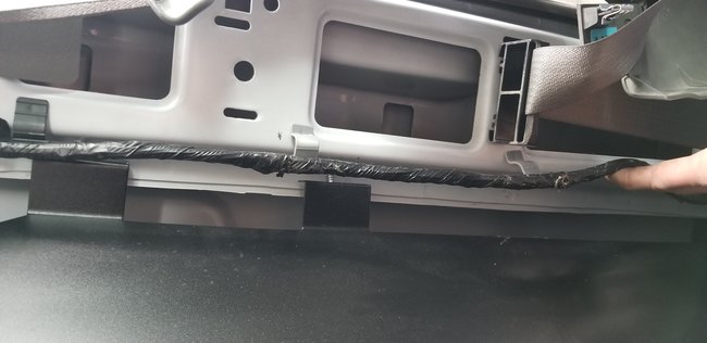

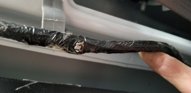

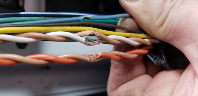

BTW, the damage was caused by the people who installed my partition two years and three months ago! I'll be having a chat with them!
Feb 24, 2019 at 12:30 PM
That's poor workmanship.
Feb 24, 2019 at 12:32 PM
DEACON DAN
  • 29 POSTS
Yes it is! Surprised it took that long for issues to surface.
