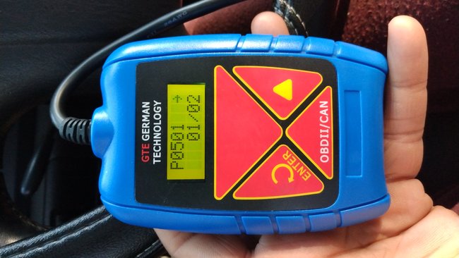

Rough idle and codes P0303, P0305, P0300, P0030, P0036, P0501, P0136, and P0304
2004 HYUNDAI SONATA

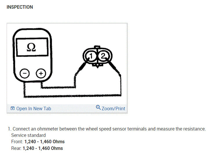

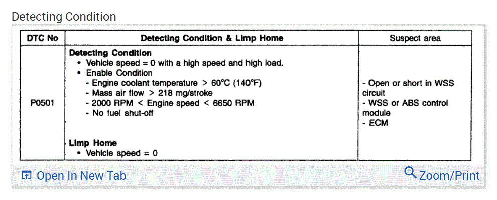

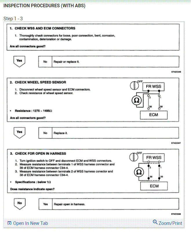

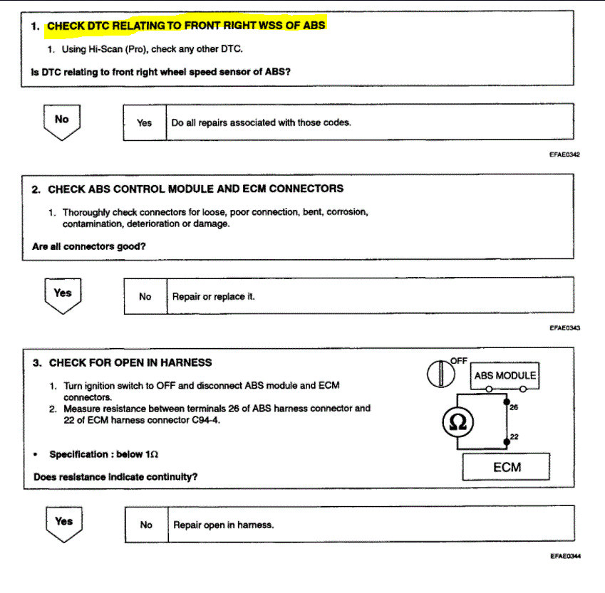

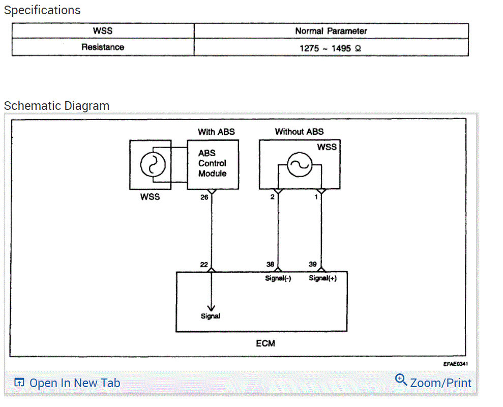

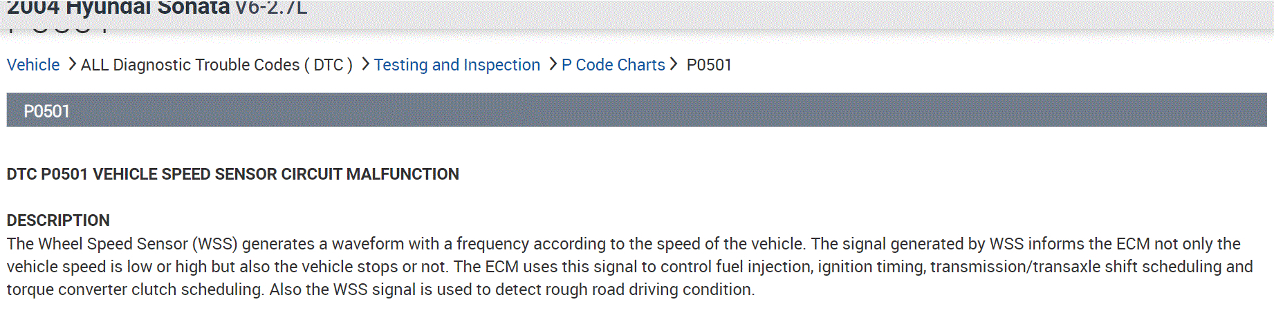

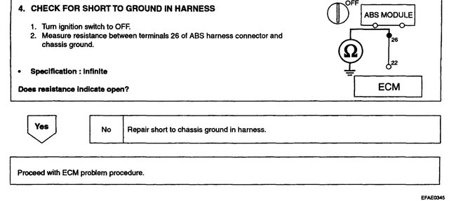

That code is specific to the right front wheel speed sensor (WSS). If you look below at the attachment, it explains everything that the sensor is responsible for. One would think just speed, but it's a lot more.

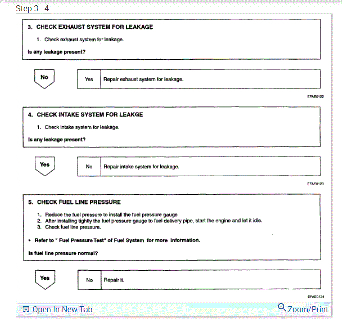

I included the diagnostics related to the P0501 as well. That is what needs to be done to determine the cause.
See pics below.
See pics below.
Jun 23, 2021 at 9:07 PM
Thank you Joe. Is this related to the ignition system and should have the shop owner look at and cover labor on? Or is this a new and separate issue?
Jun 23, 2021 at 10:03 PM
From what I'm reading, the WSS can be causing several different issues. The ECM uses it for several different controls. Let me know what you find. I'm interested in knowing.

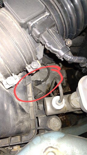

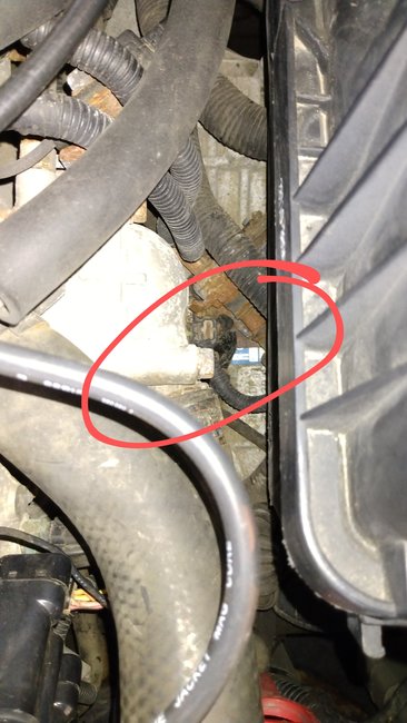

Hey Joe. It's been awhile. I'm adding the attached convertible to my car collection in August. Before I dive into that I'm continuing on with the speed sensor code P0501. I was under the hood today locating the sensors. I watched a YouTube video after reviewing the attachments you provided me. I want to make sure they are the two that I circled in red in attached pics. Todd

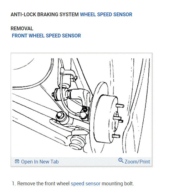

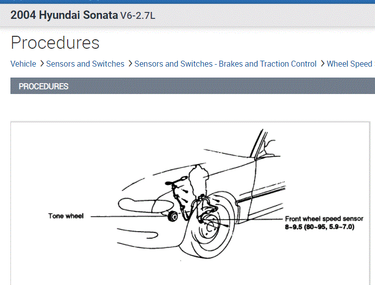

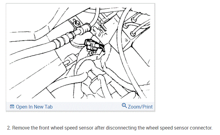

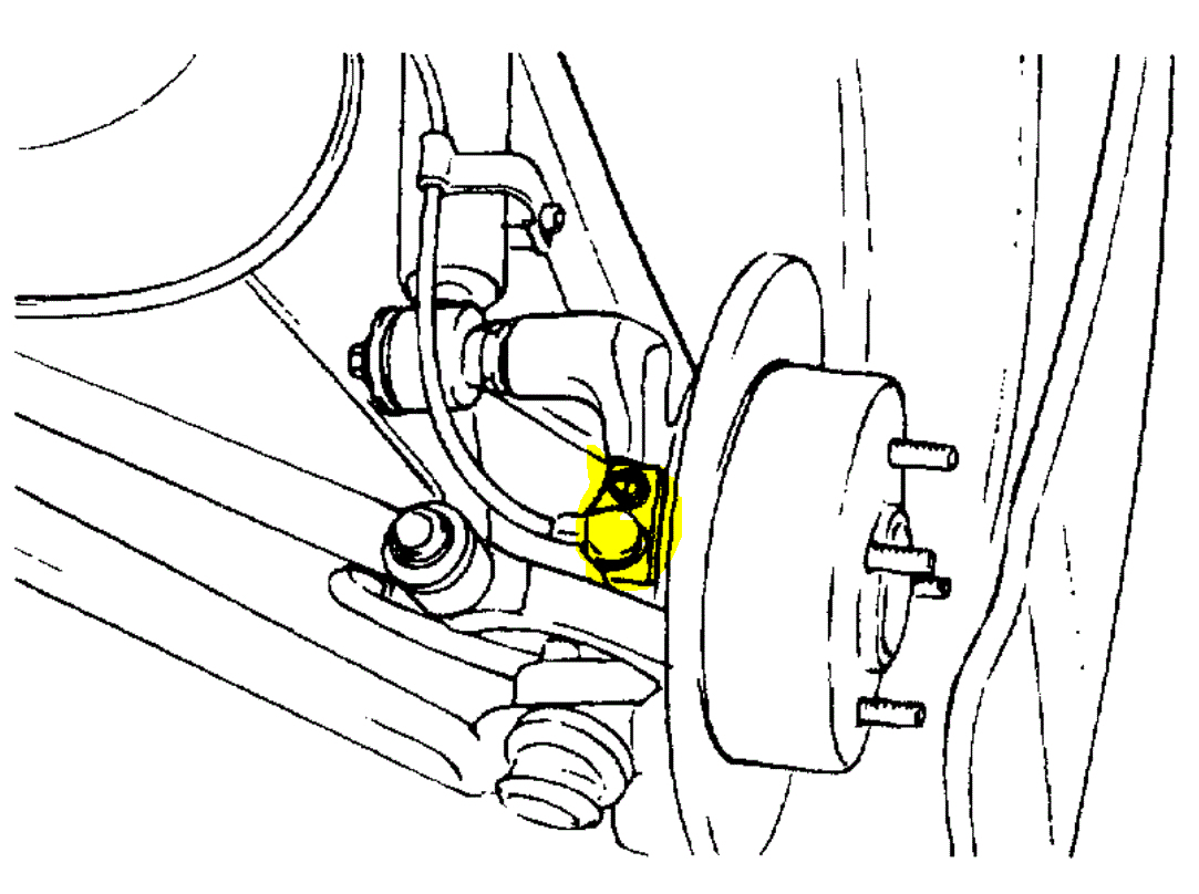

As far as the wheel speed sensor (P0501), it is mounted on the steering knuckle. I'm not sure what you circled, but that isn't a WSS.
Take a look at pic 1 below. I highlighted where to look. Also, the code is specific to the right side front (passenger side).

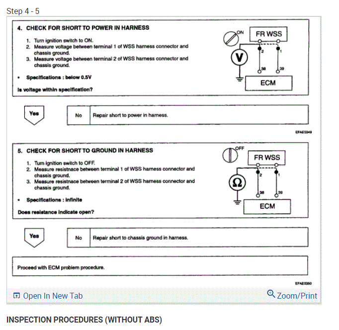

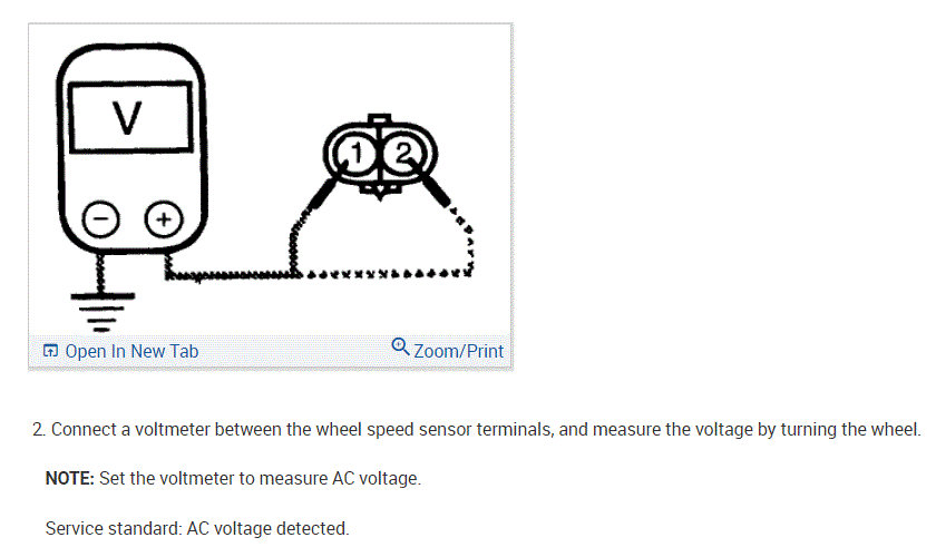

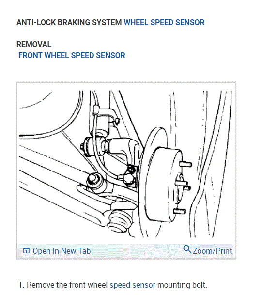

The remaining pics are the directions for the removal and replacement of the sensor. It's only one bolt that holds it in place. Also, the last two pics are for testing it.
Let me know if this helps.
See pics below.

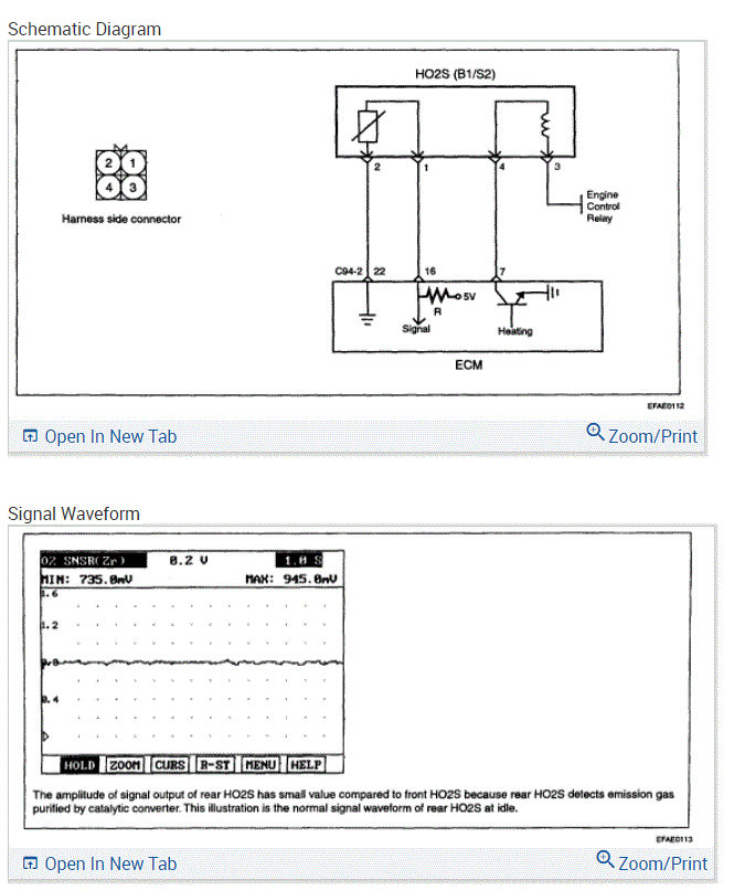

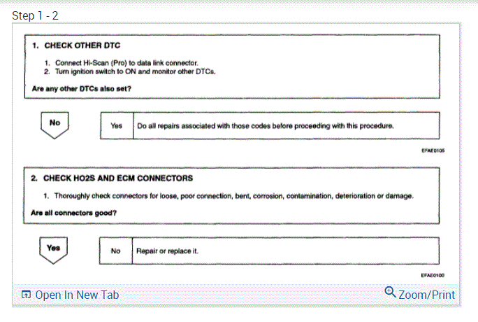

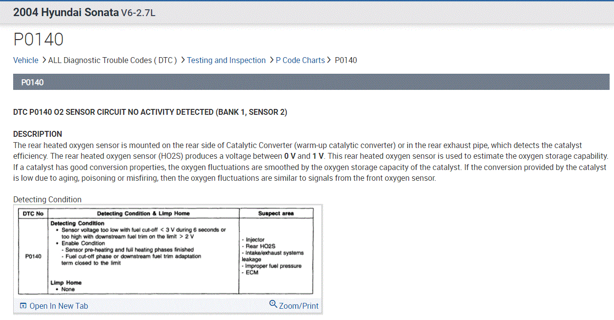

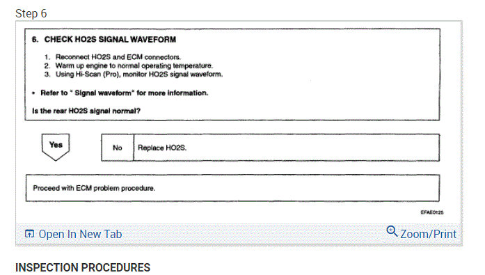

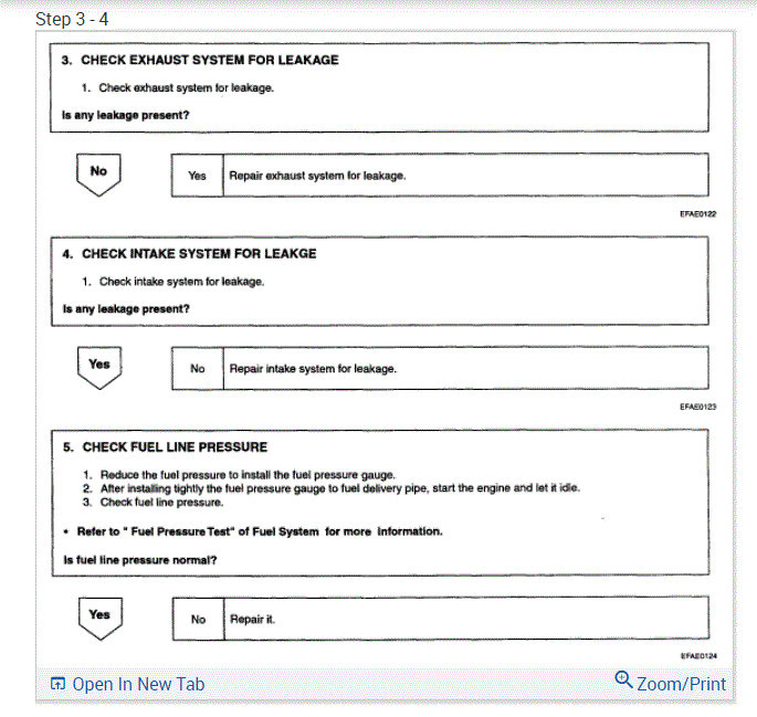

First, the code is related to the o2 sensor. It has nothing to do with the ABS or fan.
I listened to the video. That sounds like a mechanical problem and not electric. Is everything tight on the wheel, brake caliper/mount, CV axle, and so on? If you pull the ABS fuse, does the sound stop?
I attached the diagnostics for the P0140. I hope they help. I like the car. What scares me is it's being pulled onto a flatbed. Ugh!!!
See pics below.
See pics below.
