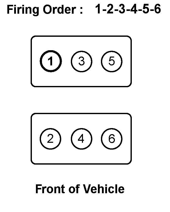

The p0030, P0036, and P0136 are related to the heated oxygen sensor. P0501 deals with a wheel speed sensor (ABS). The remaining codes all deal with specific misfires and random misfires. If you look at the pic below, it shows cylinder location.
Check cylinder 3, 4, and 5 ignition coil. See if the connectors are properly installed and not damaged. I'm starting here because I feel it may be the cause of the other codes. Cylinders 4 and 5 are in the rear of the engine, so he may not have connected things properly.
One more thing. If you have a live data scan tool, let me know what the short-term fuel trims are at idle.

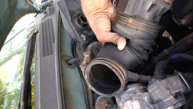

Hi Joe. It's been a while since I've written back because I've been trying to get help in my neighborhood, but everyone is too busy to follow-up what they started.

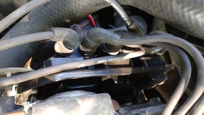

I have checked the ignition coils for cylinder banks and they all appear to be okay. The ignition coils actually look new. I did notice a bad spark plug or two, and the intake hose has a hole in it.
I have included pictures for you, if they will attach without fail. A buddy helped yesterday by pulling up the plenum to get to the back spark plugs. When we re-assembled everything and cranked the engine there was a dull pop that came from it.
My friend noticed that the back of the plenum was too loose, meaning I have to start this all over again. My friend won't be around for a few days I'm sure.

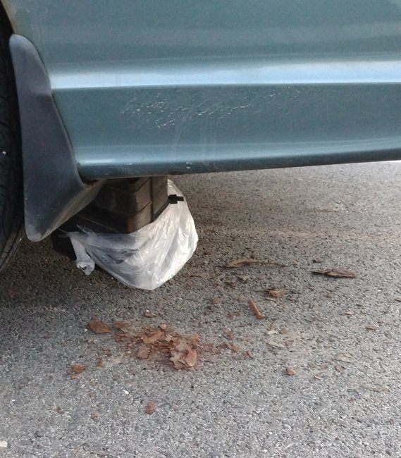

Also, last week I noticed a box hanging almost to the ground. It has rusted out of its housing. It appears to be a charcoal or evap canister. It is attached from some tubes toward its center, but its side has appears to have some tubing missing that is going up towards the gas cap. I smell gas fumes. I really need some help with this car.

The plenum shouldn't need to be removed again. You should be able to re-torque the bolts. As far as the box, that is most certainly the charcoal canister. Are you able to see what allowed it to drop? Is it rust or missing bolts?

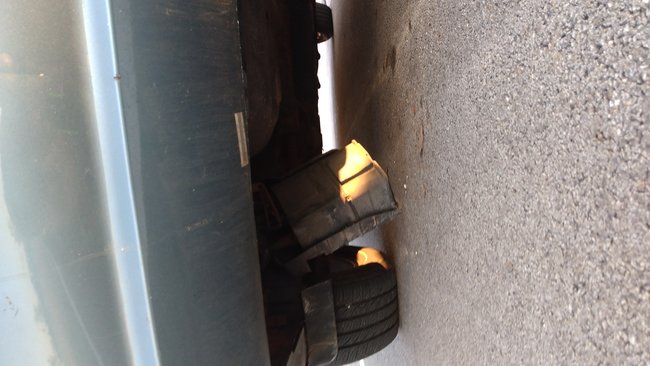

It most certainly is rust. Have a look at this pic showing my attempt to support it with a plastic grocery bag. As I was handling the canister the housing all around it was steadily crumbling on my face.
Jun 3, 2021 at 1:13 PM
Is there a place you can secure it that isn't near the exhaust and it can't be hit by road debris? Also, please use something different than a plastic bag. It will break. Also, it could melt if it's near anything hot.

That bag has been removed. If you will notice the first pic, I have it held up by shoe strings. I have changed all spark plugs and am replacing the intake hose tomorrow. After that, I'm thinking perhaps I should sell this vehicle, or trade it in.

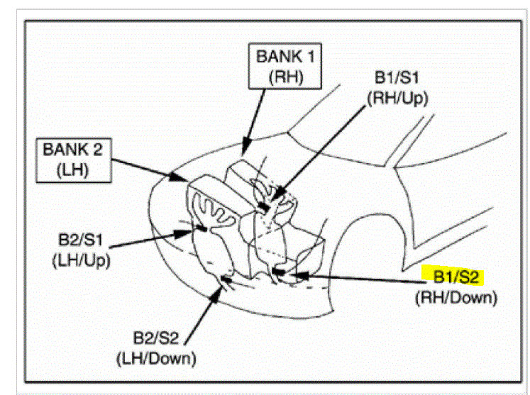

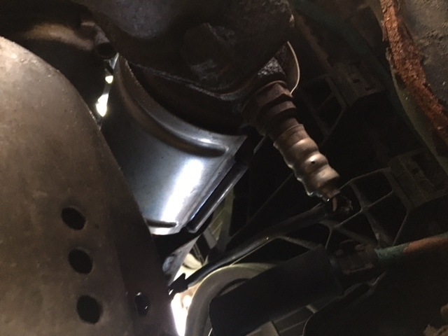

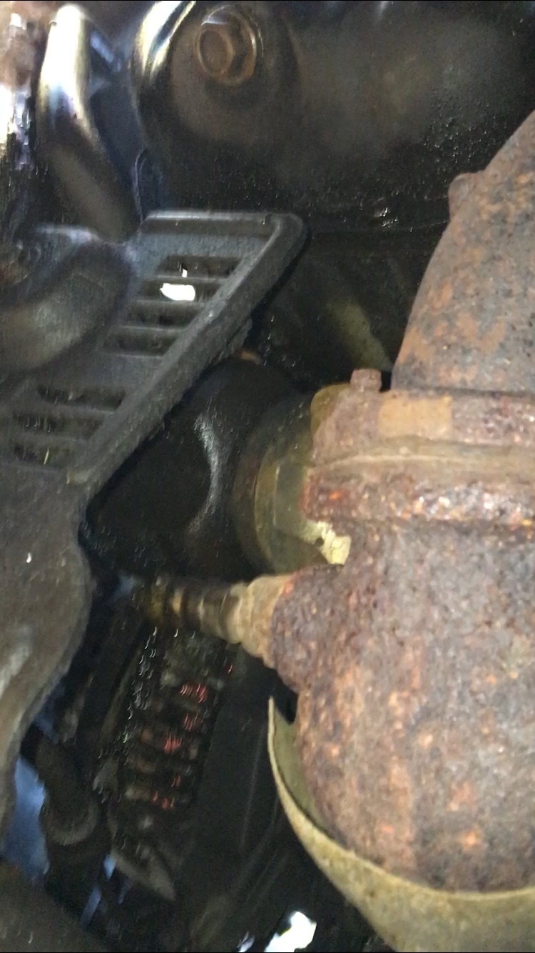

As far as the oxygen sensor (B1S2) I attached a couple of pics below to help you locate it. Note that bank 1 is close to the firewall. Bank 2 is close to the radiator. Also, sensor 2 will be after the catalytic converter.
If possible, upload a pic of the hole you are referring to. If it is before the catalytic converter, that is going to cause a lean reading at sensor 2 which will cause the computer to add fuel that isn't needed.
Let me know if this helps.
See pics below.

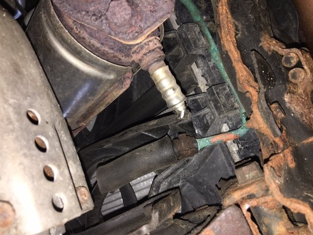

Thank you for the attachments you provided. I thought the first one was B1S1 since it was before the catalytic converter, on the firewall side and higher up. I recognized the location of B1S2 better in the second attachment. I misspoke about the hole in the catalytic converter. That was a mistake.
What I did find is the location of all the O2 sensors and I learned a lot about this engine by being underneath the car for 45 minutes. There appears to be an oil leak around the sensor that I was searching for. I attached two pics (one with natural light, one with flash) and if the video will transmit, it will be provided as well. I also saw some droplet of green substance, perhaps coolant.

It does like there is an oil leak. But, most cars on the road have one. LOL. As far as the green, I'm not sure where you are seeing it. In the third pic, I see something greenish that looks dry. Is that it?
