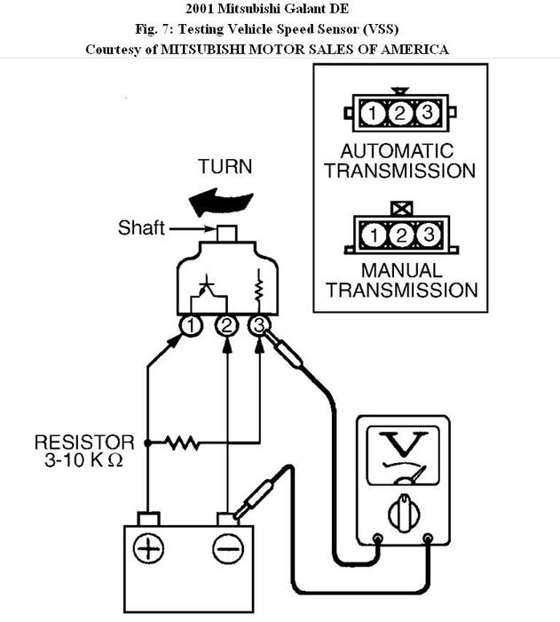

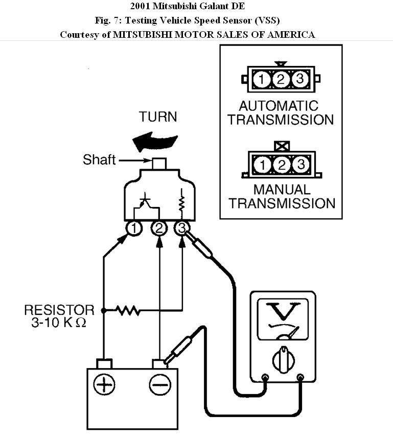

Have a scan done to retrieve the troule code for the CEL indicating. If it indicates the speed sensor, erase the code and retet. If CEL comes on and sets codes for faulty speed sensor, you either have a bad speed sensor or its wiring circuit.
Ensure wire connector to VSS is clean and securely installed.
VEHICLE SPEED SENSOR (VSS)
Sensor Test
1. Remove VSS from transaxle. Jumper a 3000-10,000 ohm resistor between sensor terminals No. 1 and 3. Connect battery positive voltage to sensor terminal No. 1 and battery negative voltage to sensor terminal No. 2. See Fig. 7.
2. Connect a voltmeter between sensor terminals No. 2 and 3. Manually turn speed sensor shaft. Voltage should pulse 4 times each revolution. Replace VSS if operation is not correct.
