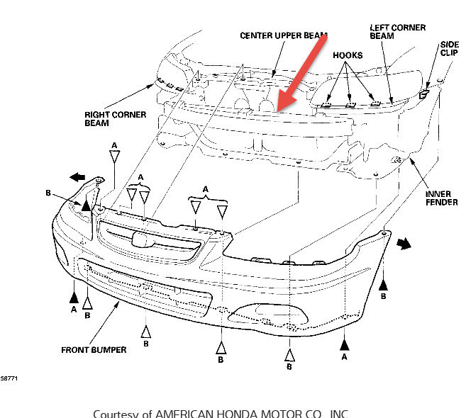

Told it's a faulty front crash sensor. Where the is the crash sensor located?
