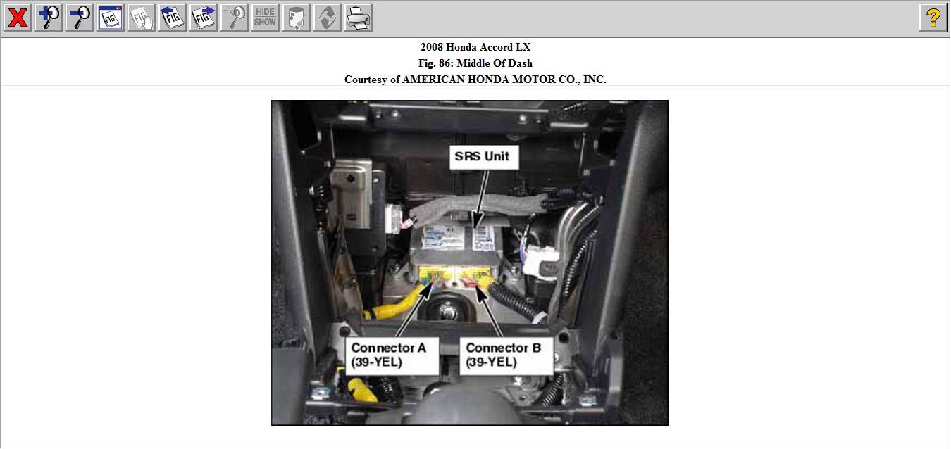

I have a 2010 Honda Accord EX-L, V6 Sedan. It has the SRS light illuminated and its getting me worried. I hear that there is an MES connector located somewhere around under the dash but I don't know the exact point. so, please, can you help me by telling me where to find the MES connector and how to go about resetting the SRS on this model? Thanks in anticipation.

The first thing you need to do is have the codes read in the air bag computer and let me know the exact code numbers not code descriptions? Otherwise were just guessing why the lights on.

The codes are:
(1) F1-11
(2) F2-11
(3) D3-11
(4) D4-11
Thanks again.

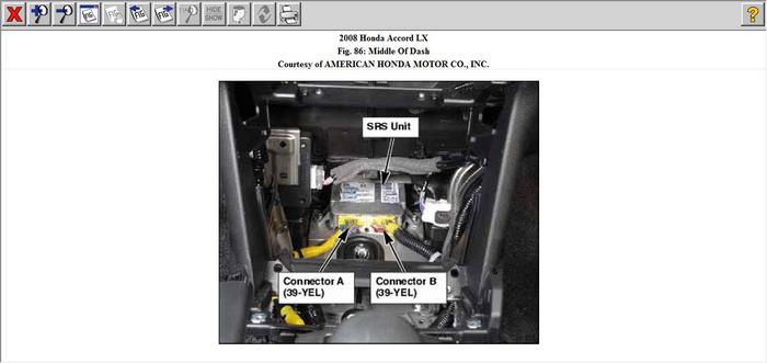

Where is located the MES connector I am trying to reset the srs unit?

SRS unit in middle of dash. here is a video that will help you reset the codes check the diagrams below for the connector location:
https://youtu.be/gnSGfEqrf_w
Check out the diagrams (below). Please let us know if you need anything else to get the problem fixed.
