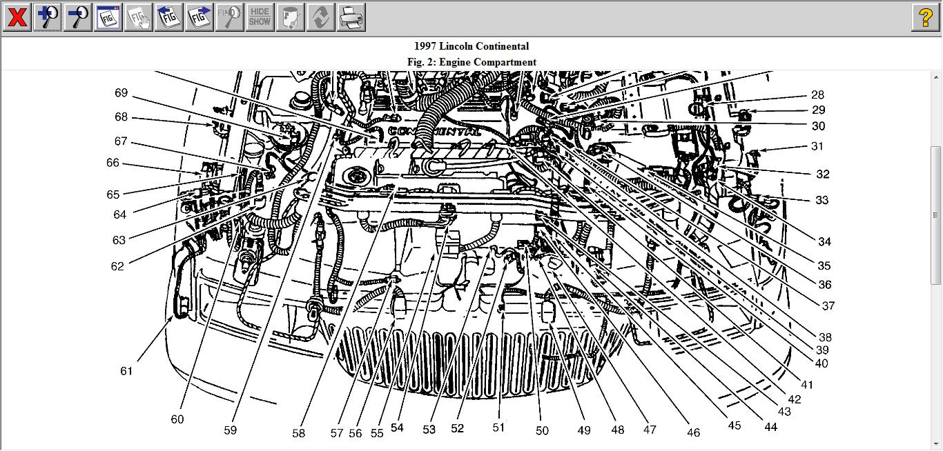

I have seen a lot of complaints about the crank position sensor causing no start issue. Where is it on my conti?
Apr 25, 2017 at 11:46 AM (Merged)
RASMATAZ
  • 75,992 POSTS
The CPS On lower right side of engine. See item no.59
SNOSAINT
  • 76 POSTS
Car did not start on multiple attempts on friday afternoon. Sunday morning i had a chance to go back with tools and info. Very first thing was to put jumper cables on it to boost up the cranked down battery. Then i popped the trunk and checked the fuel shut off-not popped & shut off the sir ride so i could hear the pump-maybe. I then checked fuse 11 inside the car and the fuses,diode & relay under hood-swaping them for identical matches in the fusebox. Then i pushed on the bleeded on the fuel rail, it spit and ran a little. then i popped tha gas cap & asked my wife to listen for fuel pump when i turned key on-she didnt & neither did i, but then i went one farther and the car started and then ran fine for 20 miles to my brother in laws shop. I am considering doing the fuel pump and the crank pos sensor. Any other ideas?
