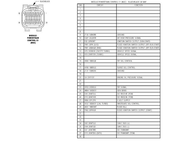

Ignition switch connector
2006 CHRYSLER PT CRUISER
120,000 MILES • 2.4L • 4 CYL • 2WD • AUTOMATIC

Is at pin 30 the PCM receives power from the TIPM?
Jul 8, 2018 at 1:19 PM
No, pin 30 gets power from the ignition switch.
Jul 8, 2018 at 1:24 PM
ZEMORZEMOR
  • 486 POSTS
On the pinout diagram it shows it is coming from the TIPM.
Jul 8, 2018 at 1:25 PM
The diagram I sent you says ignition fused feed. Check the fuse for this.
Jul 8, 2018 at 1:37 PM

Okay I will. The other thing is how to check PCM connectors have no bad connection?
Jul 8, 2018 at 2:00 PM
Remove the connectors and look for any loose, damaged or burned pins. Use some dielectric grease for a better connection.
