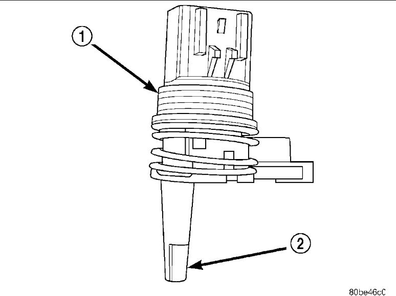

Is the range sensor and transmission temperature sensor share the same connector? Can you tell me where the transmission temperature sensor connector is at?
Jul 5, 2018 at 8:08 AM
The temperature sensor is part of the range sensor.
Yes, they share the same connector.
Number two in the picture. The rest is the range sensor.

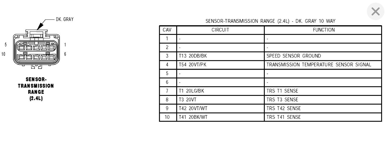

How many pins the connector has and which ones are for the temperature sensor?
Jul 5, 2018 at 8:19 AM
Diagram attached of the connector and pins.
If you have a scan tool, you can read the actual temp through the scan tool to see if it is working
