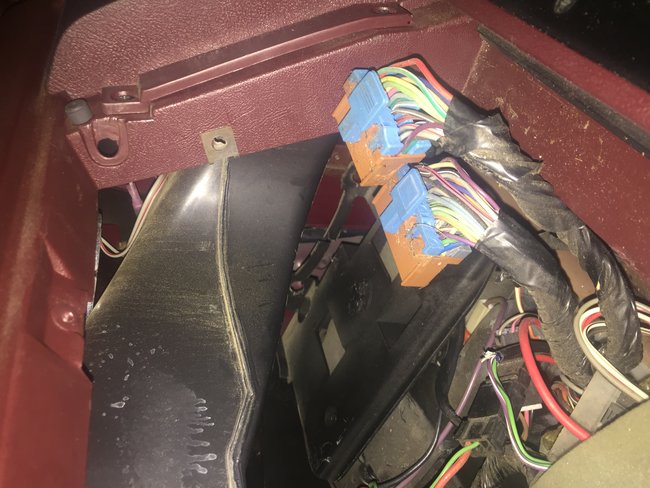

It’s righr n front of me but don’t see any bolts to remove
Feb 24, 2018 at 4:35 PM
ERIC HOWARD
  • 74 POSTS
NO bolts it slides in onto a tray, I guess before I chase this rabbit I want to make sure this is a good fix
Feb 24, 2018 at 4:40 PM
it comes down to the floor. try pulling it down

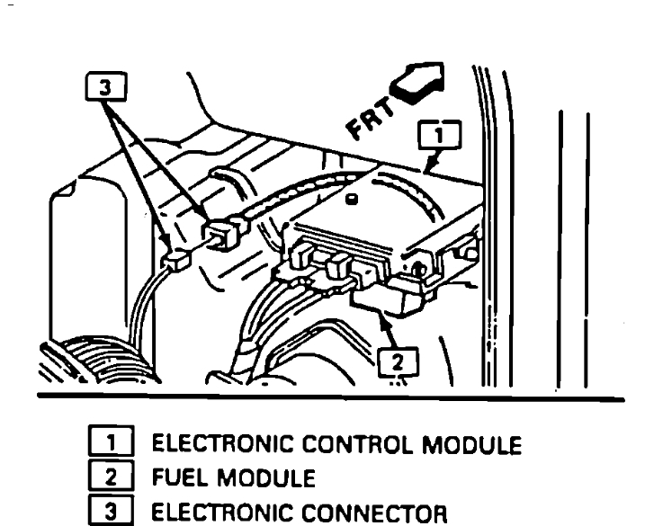

REMOVAL:
1. Disconnect the negative battery terminal.
2. Remove glove box panel.
3. Remove mounting brackets and/or retainers.
4. Remove control module from tray.
5. Disconnect control module harness connectors.
6. Remove access cover and PROM (MEM-CAL).

Here’s the tray
