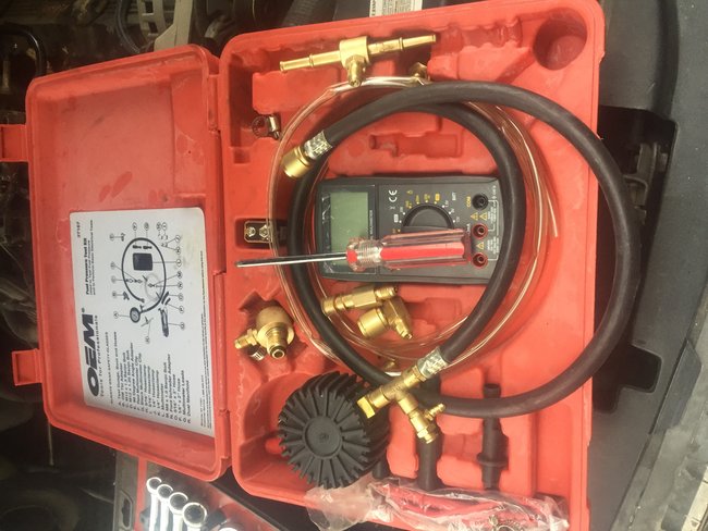

9-13 Psi if I remember correctly for that application.
Feb 18, 2018 at 12:05 PM
correct.
Feb 18, 2018 at 12:06 PM
ERIC HOWARD
  • 74 POSTS
Cannot hook it up, steal line in the back does not have a enough room to put in port.
Feb 18, 2018 at 12:53 PM
ERIC HOWARD
  • 74 POSTS
Not enough adapters in the kit to put it in like in place of the filter.
Feb 18, 2018 at 12:54 PM
ERIC HOWARD
  • 74 POSTS
But I cannot quit, lol.
Feb 18, 2018 at 1:07 PM
Does not have a T fitting in the kit??
Feb 18, 2018 at 1:08 PM
ERIC HOWARD
  • 74 POSTS
It does.

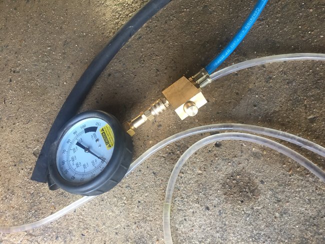

Friends of mine as a bigger kit I will get from him tomorrow, it may have in like fitting to put in place of the fuel filter, be way easier then trying to make this work. last thing I want to do is kink a like or mess up threads on throttle body.
Feb 18, 2018 at 1:32 PM
ERIC HOWARD
  • 74 POSTS
Now if I can get one side of the throttle body plumbed in with tester how good of a test would it be only burning on one injector?
Feb 18, 2018 at 1:34 PM
ERIC HOWARD
  • 74 POSTS
Still no good, only thing is I cannot and maybe check the pressure at the pump if I disconnect fuel filter, but that would be the only way this kit will work if it will?
Feb 18, 2018 at 1:36 PM
ERIC HOWARD
  • 74 POSTS
Nope!! This kit will not do it, more to follow tomorrow.

At first then gauge jumped up to around ten the I sprung a leak so took all off and get everything sealed back up now zero on the gauge, but the truck runs still for about five minutes or so then shuts off. I can fire it right back up but still zero on the gauge. Fuel pump is the problem I am thinking.
Feb 19, 2018 at 2:51 PM
ERIC HOWARD
  • 74 POSTS
Now if I take gauge off as the truck runs and bleed the line it will stall then shut off.
Feb 19, 2018 at 2:52 PM
ERIC HOWARD
  • 74 POSTS
Something sure not right though, if I disconnect everything and let it free flow with the pump on it will sling some fuel. now it does not look like it under a lot of pressure but it does come out .
Feb 19, 2018 at 2:54 PM
Okay, the pump can work but not supply enough pressure for the system to work.
it sounds like you need a pump.
Feb 19, 2018 at 2:59 PM

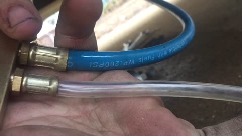

If you look closer at the clear line the bleed off
line , I am holding the JR button down and see how fast the pressure Ian bleeding off it should really really really slow so either my
like is plugs some way or the fuel pump is putting out less then 10 PSI.
Feb 19, 2018 at 3:01 PM
Nice video. yes I still think you have a failing pump. not enough fuel.
