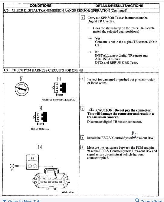

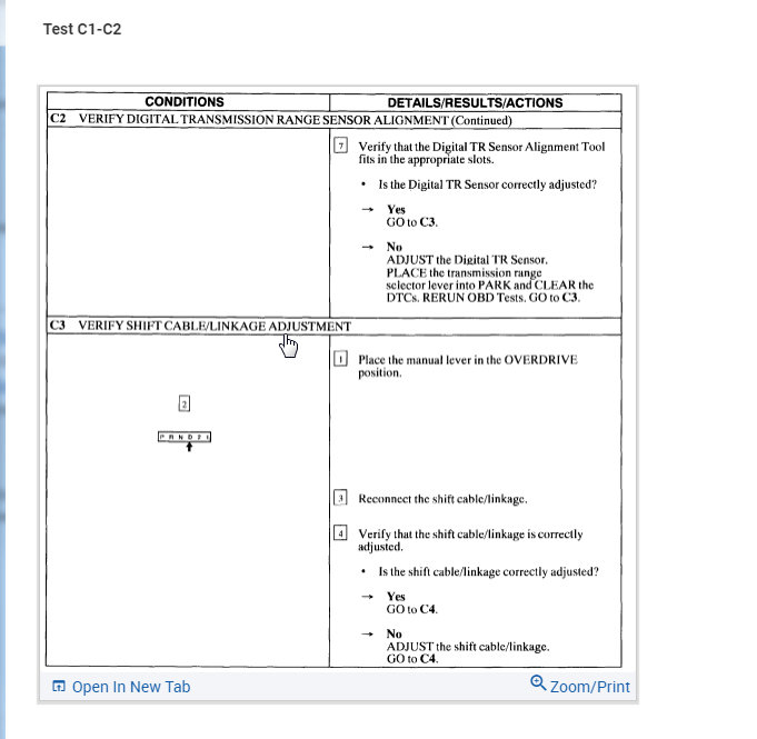

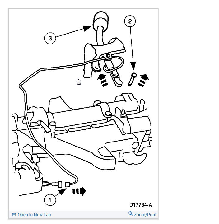

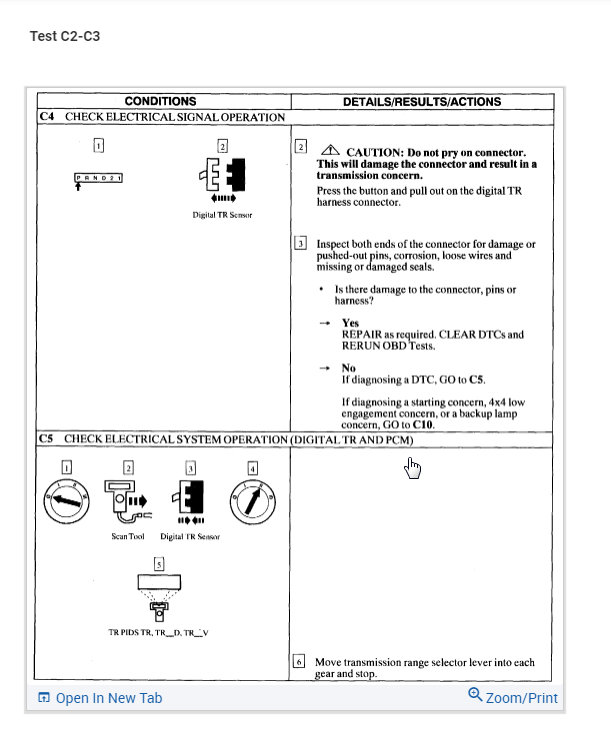

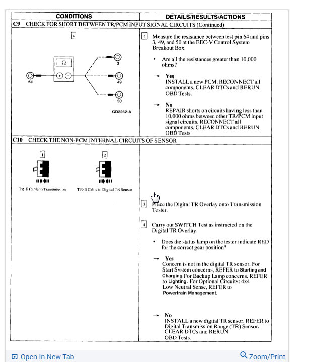

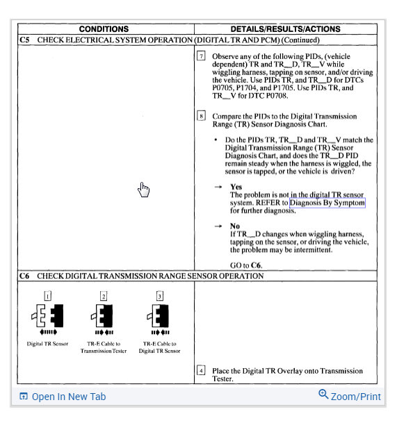

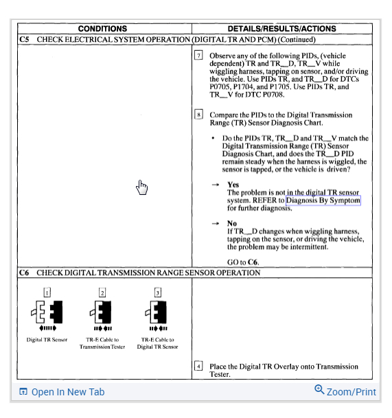

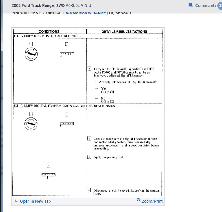

This is one of two things. Either the transmission range sensor is faulty causing the PCM to not see the vehicle in park. Or the shift cable is stretched.
Either way, it is the same issue happening which is the PCM needs to see the vehicle in park or neutral in order to allow it to start. If the TRS is faulty then it doesn't recognize when it is in park. If the linkage is the issue then the transmission is not actually fully in park and the TRS is accurate.
I suspect the sensor is the issue so I supplied the testing for it but also the replacement for the linkage if that checks out okay. This guide can help us fix it
https://www.2carpros.com/articles/starter-not-working-repair
Please run down this guide and report back. Let me know what you find. Thanks

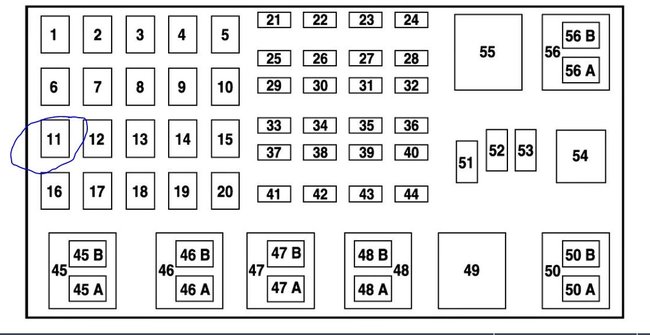

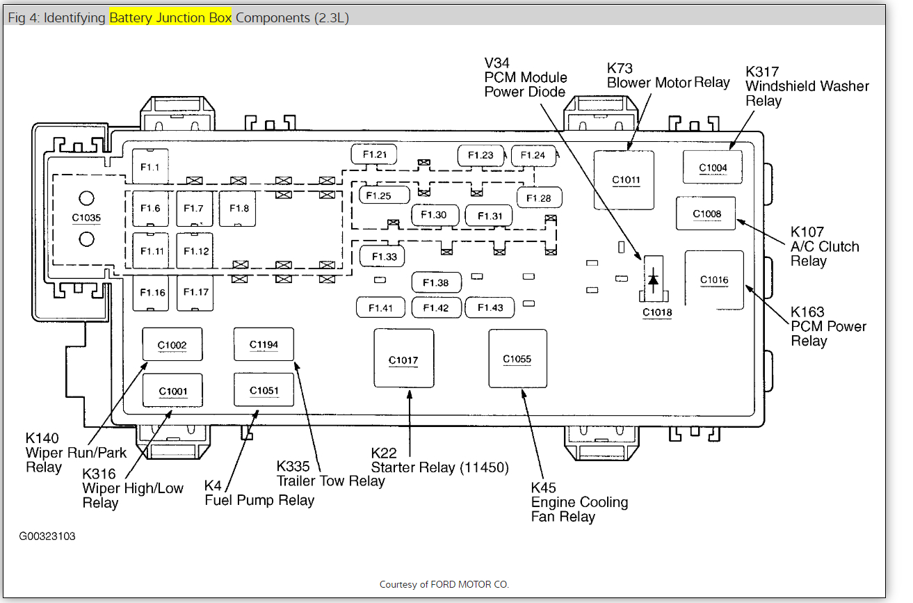

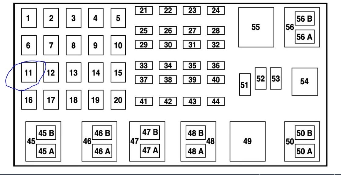

If the starter isn't working and turning the engine at all, check to see if it will start in neutral. Also, check fuses 11 under the hood and 24 under the dash. See pic 2. Also, switch the starter relay with another one that you know is good and has the same part number to see if that changes things.
If everything appears good, check to see if there is power to the yellow wire with a light blue tracer at the starter when the key is in the start position. (see pic 3). Also, here is a link that you may find helpful:

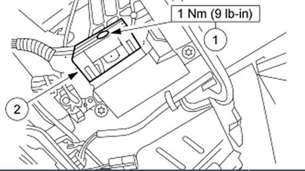

When you say no power, does anything work? For example, the radio, dome light, radio, headlamps and so on?
If nothing works, first make sure the battery is fully charged and confirm the terminals are tight and clean.
Next, confirm the battery negative terminal is connected to the engine block and to body. Make sure the connections are clean and tight.

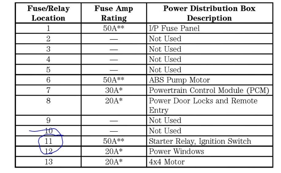

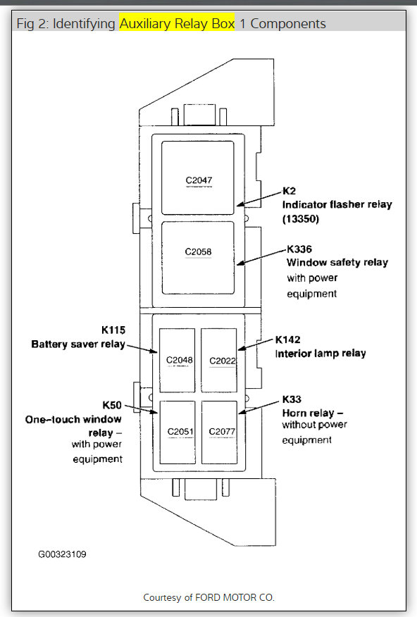

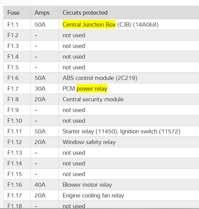

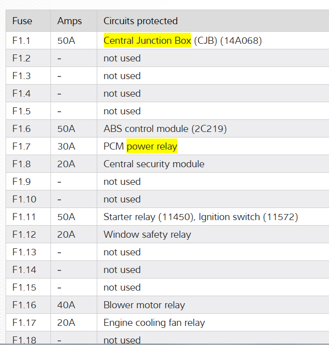

If that is good, next check for power at the number 1 fuse in the fuse / relay box under the hood. See pic 1. It is a 50 amp fuse. Also, if the fuse appears good, make sure there is power to it.
Here are a few links you may find helpful when testing:
I am basing this on nothing working. Let me know if that is different than what happens. Take care, Joe

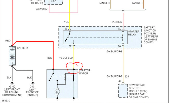

Sometimes it would start sometimes it won't. I've check the positive and negative cable for the battery, no erosion. replaced the starter, tightened the bracket at the bottom of the steering column for shifter cable. I messed with the neutral safety switch and got it to start and continued to start for a couple week's. Then it started not to start again. So I replaced the neutral safety switch and fired up every time for about 20 times. The owner got up the next morning for work truck fired up he stopped at QT came out truck fired right up. He worked all day gets in the truck to go home and again didn't want to start. Got power all the lights work just not starting. I go to his work and mess with the safety switch for a good HR and still nothing. Now there is a bushing in the steering column that totally wore itself to nothing. Surely that's not causing it not to start. After the neutral safety switch I'm not sure what the next step would be. Any advise would be appreciated.
Mar 8, 2021 at 5:20 PM (Merged)

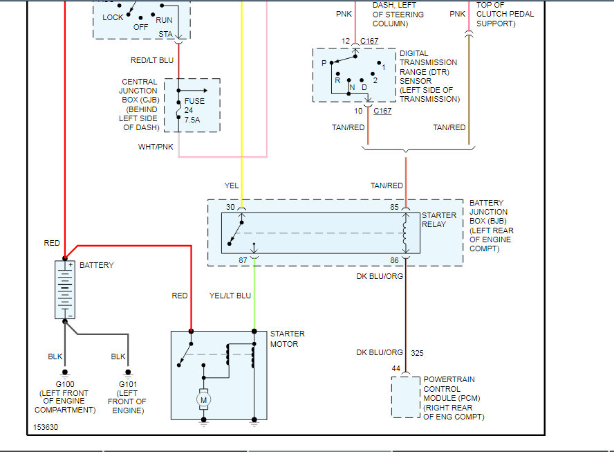

SCGRANTURISMO
  • 4,897 POSTS

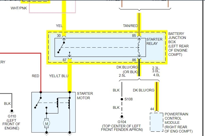

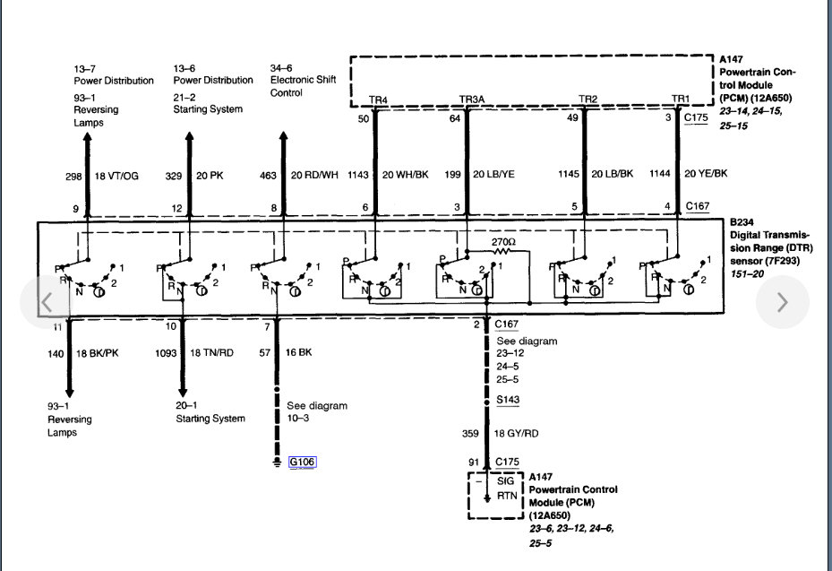

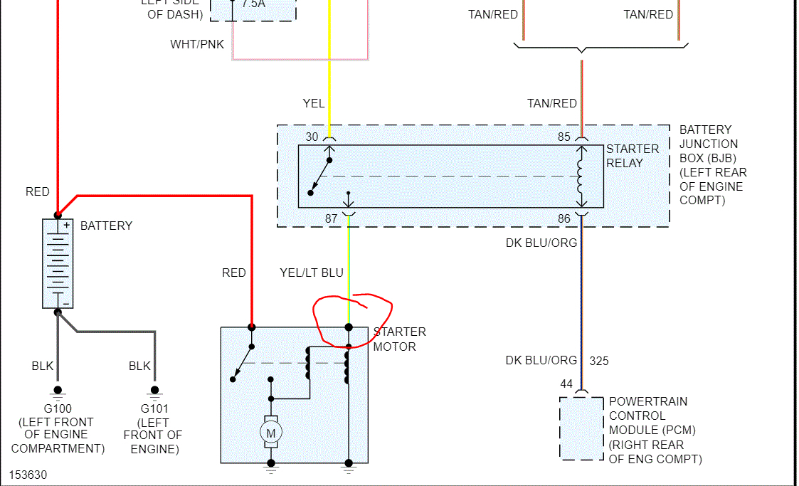

In the diagrams down below I have included a wiring diagram of your vehicle's starting circuit. The first component I want you to check is a component called the Clutch Triple Function Switch Jumper, which I have included it's location in the diagrams down below as well. With a helper turning the ignition key please take a voltage reading at each side of the component and get back to us with what you are able to find out. We can go from there.
Thanks,
Alex
2CarPros

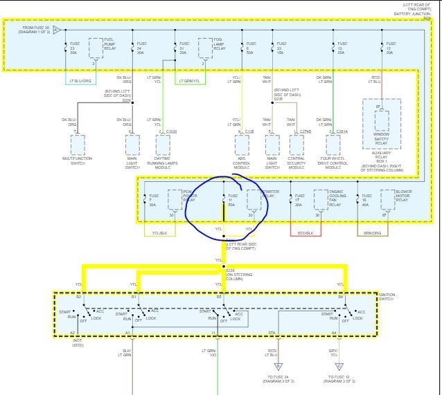

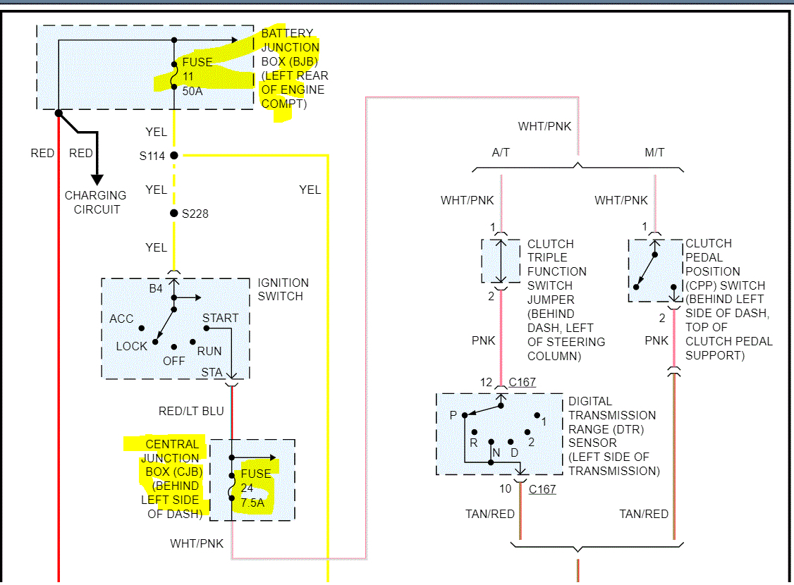

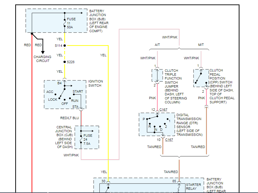

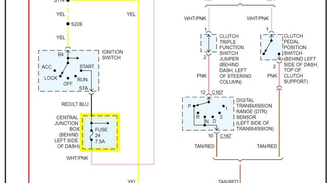

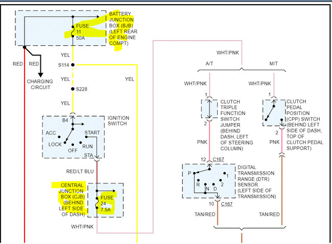

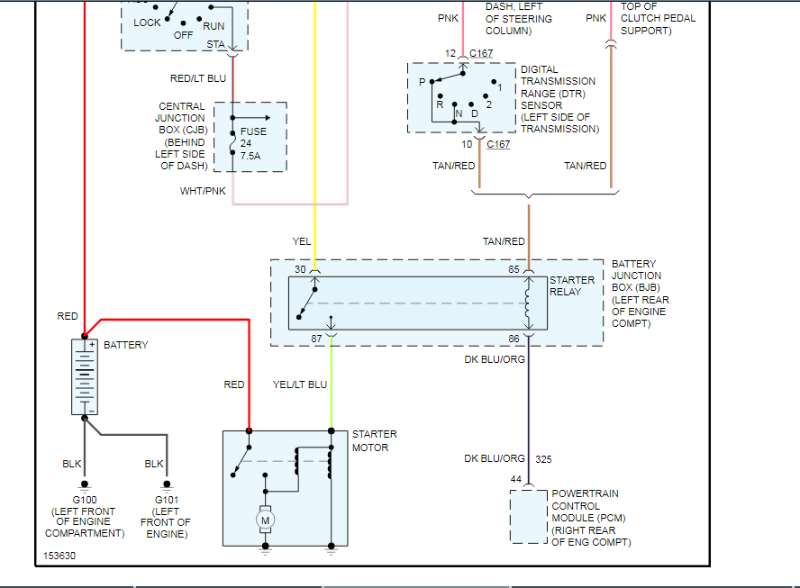

Good morning,
I attached a wiring diagram for you to view. Do you have a test light or voltmeter to do some testing?
What wire is grounded?
Do you have a security or theft light? If you do, does it go off after about 10 seconds with the key on?
Mar 8, 2021 at 5:21 PM (Merged)
JIMEL48
  • 32 POSTS
Hello Roy,
Thank you for responding to my question.
The wire triggering the solenoid is showing it is grounded (continuity between battery negative post and wire) and is not hot. Checked with voltmeter. Starter wire is getting 12+ volts. No dash lights working except when you turn on there is a very faint instantaneous glow of the theft light (about 0.5 seconds). Do you know if the transponder key needs reprogramming would it automatically ground out the solenoid wire. If not maybe a wire in the ignition switch has chaffed and grounded out. 7.5 fuse is good but shows no power getting to it when trying to crank engine. Again thanks for your time.

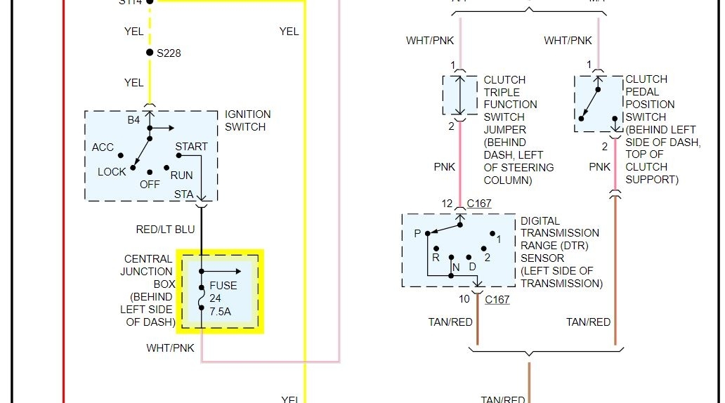

Okay, first, we need to address the 7.5 amp fuse. It needs to have power in the start position only.
Can you verify that? That comes directly from the ignition switch. We need to start there.
Do not worry about anything else at this point.
JIMEL48
  • 32 POSTS
7.5 fuse has no power when turning key to start position.

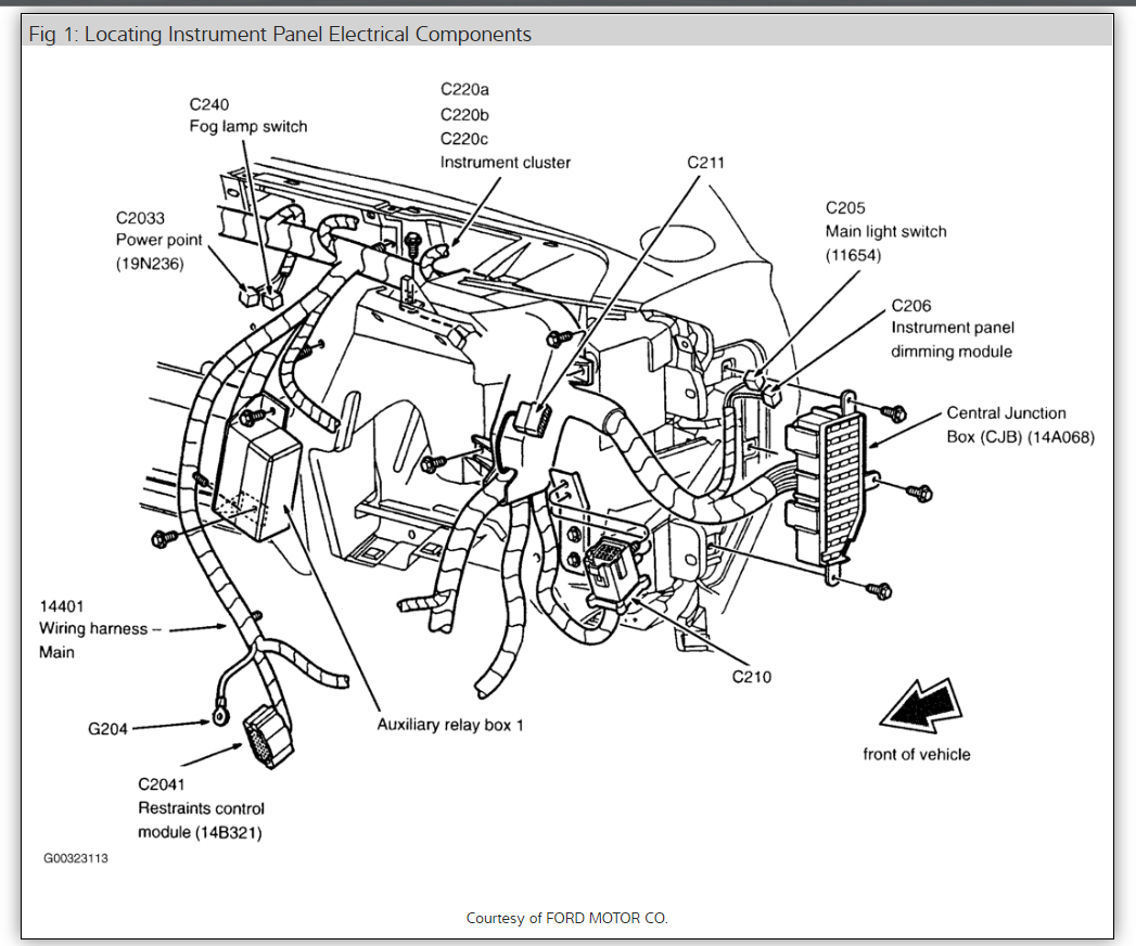

Okay, then if you looked at the diagram I sent you in the beginning, the ignition switch sends that power. You need to test for output from the ignition switch itself. You may have a bad ignition switch.
The switch is under the dash. Check the wire listed in the diagram I sent for power in the start position.
JIMEL48
  • 32 POSTS
Thanks Roy,
It will be this weekend before I can get to the ignition switch. Looking at diagram I will be looking for the red/light blue wire. Also I double checked power at fuse and I am getting 0.04 volts when trying to crank engine. If that matters.
You need battery voltage at the fuse in the start position.
Keep me updated.
JIMEL48
  • 32 POSTS
Hello Roy,
Used test light to check red/light blue and all yellow wires coming from ignition switch when cranking and no power. Checked continuity from red/light blue wire coming out of ignition switch and 7.5 amp fuse and had continuity.
Okay, then it looks like you have a bad switch. the red/light blue should have power in the start position only.
JIMEL48
  • 32 POSTS
Okay, thanks.
One question so that I understand. None of the wires that plug into the ignition switch has any power going in or out. For the ignition switch to put out power as the key is turned where is the power coming into the ignition switch?

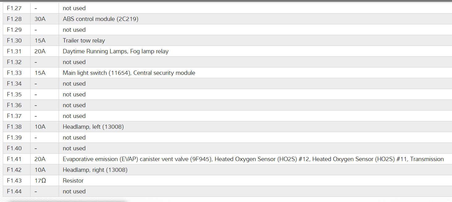

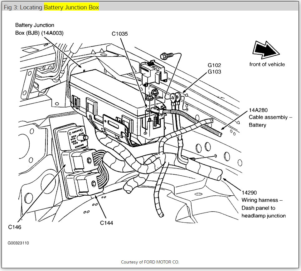

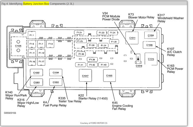

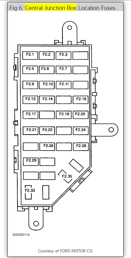

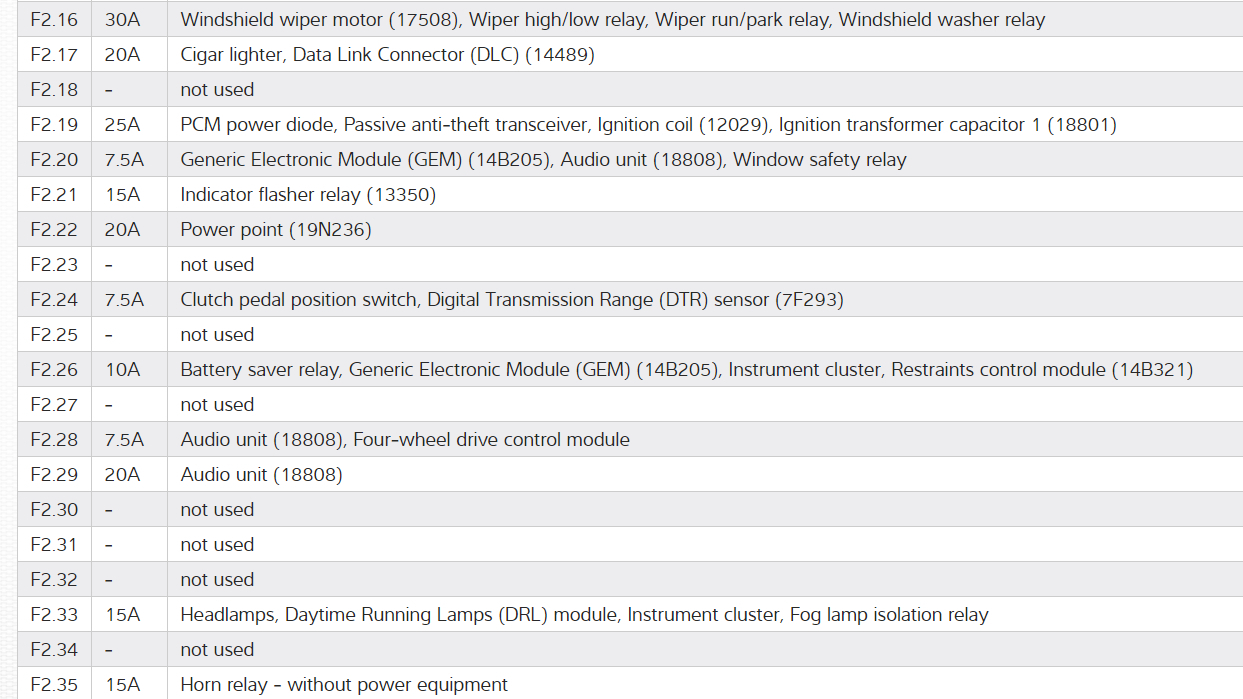

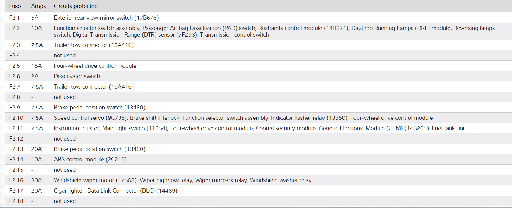

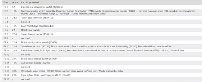

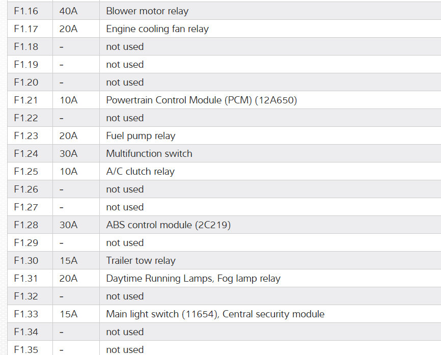

Okay, I attached a diagram for you. The yellow wires are powered by a 50 amp fuse in the under hood fuse block. Check this fuse for power at the fuse.
I also attached a fuse box diagram for the location of the fuse to be tested.
JIMEL48
  • 32 POSTS
Good morning Roy,
You were right 50 amp fuse blown. Power is getting to fuse just not going though. Not sure why fuse blew but I will replace and hopefully it will not blow again. If it does whole new set of problems. Thanks very much for your time and walking me through this process.
Mar 8, 2021 at 5:22 PM (Merged)
You are welcome.
It will fail again. Fuses fail for a reason.
I would replace the ignition switch itself as that is the most common failure for that fuse to fail.
