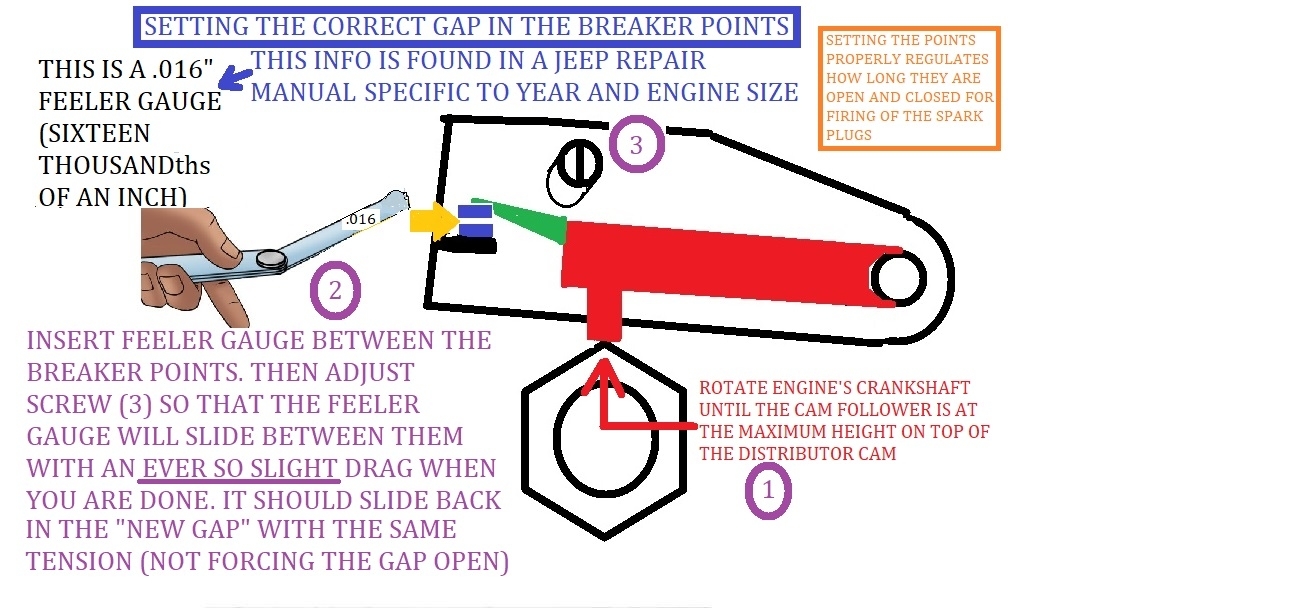

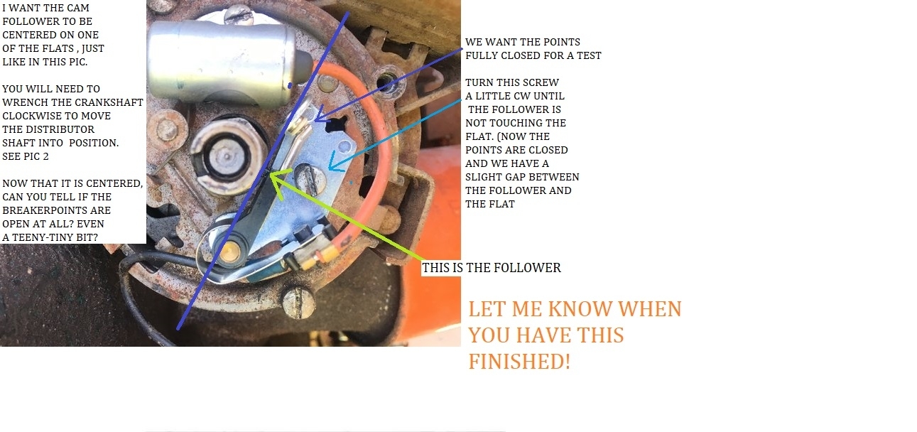

Here is where we are standing now.
Nov 10, 2018 at 1:44 PM
CJ MEDEVAC
  • 11,004 POSTS
Pictures below.
Maybe I have explained this a little better/different.
Let me know when you have done this.
Then we can move onward to a good test.
Still lost? Let me know.

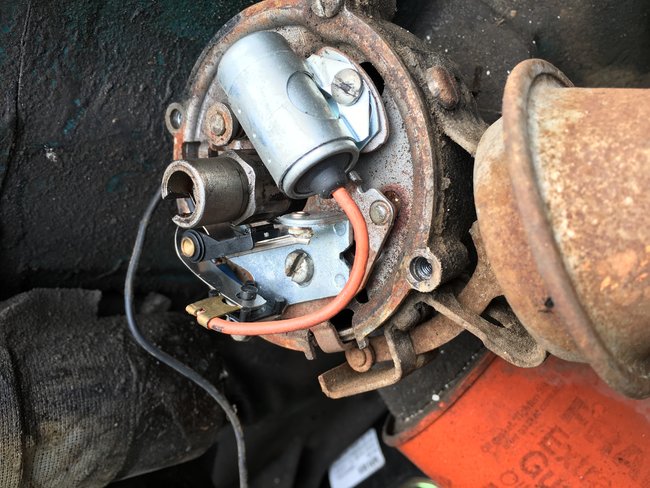

ALEESE GUAYDACAN
  • 48 POSTS
Okay, we are there.

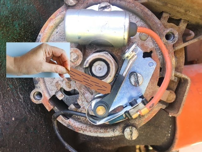

Insert a Popsicle stick or plastic whatever between the distributor shaft and the point arm.
Warning!
If you use something metal you will probably get shocked!
Twist or pry with the stick to barely crack the points apart.
You should hear a faint pop along with a blue spark between the breaker points.
Pry it open barely but very quickly over and over and over, you should get a pop, pop, pop, pop, pop along with the blue spark each time!
Nothing?
Turn off the key.
Fold a small piece of fine sandpaper in half or grab your cardboard fingernail file. Pry the points open and insert your sandpaper or cardboard fingernail file between them. Let go of the points and commence sanding for a minute or so! Remove the sanding device.
Start over!
Key on.
Popsicle stick
Pry.
Results? Popping? Spark?
Whatever happens (or does not), I am ready to tell you what to try next!
Picture below.

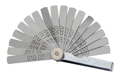

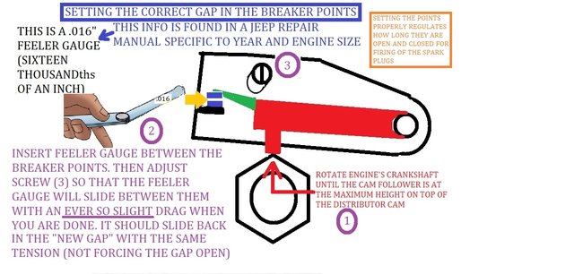

You need some feeler gauges for next task. Get them!
See picture.
The Medic

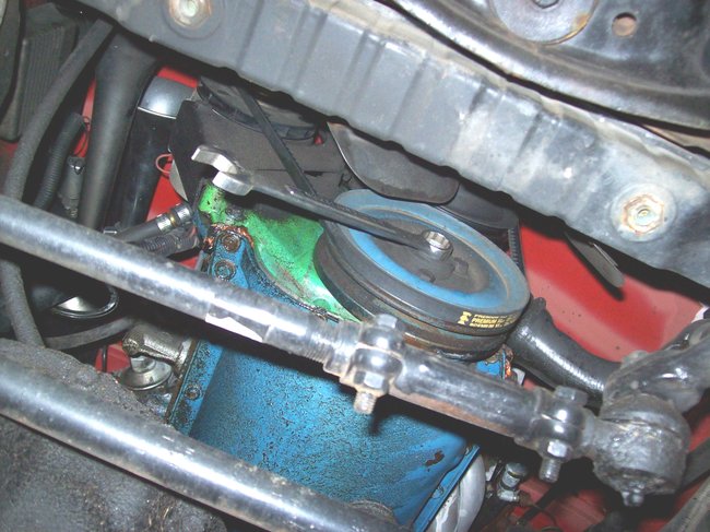

Let's see if you can figure this out.
Let me know when you are out from under the hood.
The Medic

Review
Points are now adjusted to .016" as per my last diagram?
Did you understand the diagram? I was hoping that would be self explanatory. Do I need to explain it better?

Yes I understood the diagram the points are at .016 they pop and spark. But from the distributor cap to the spark plug wires to the spark plug its self there is no spark.

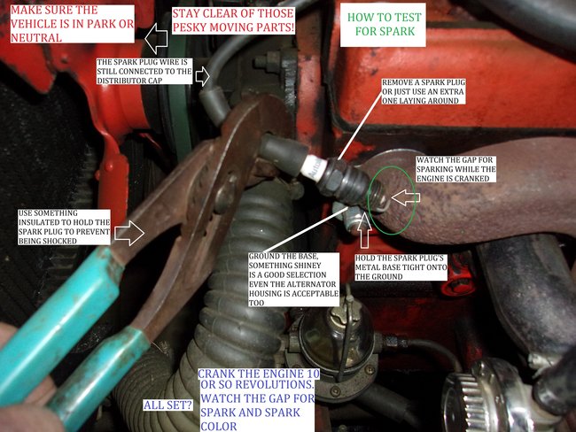

Remove one plug (Easy one to get to)
Plug the spark plug wire back onto the removed plug.
Ground the fat hex part of the spark plug to a shiny metal part under the hood (the ear of the alternator would work)
While holding it tight to the ground have someone crank the starter, watch the gap of the plug for a spark.
Watch out for them evil moving parts!
Is this what you have been doing?

Okay,
I have been meaning to make this picture for years!
I can now use it a lot for other car questions.
This is so very important for me to know.
Is this how you are testing for spark?
I do realize you are a novice at all of this stuff, I found out in the army it is sometimes easier to teach marksmanship to someone who had never done it before, as they had not picked up any bad habits yet.
So,
You are doing fantastic so far!

I want you to go back to November 12 (My answer, setting the points).
Set/check your point gap with the cam follower on a high point of the cam.
Now it is set with correct gap.
Do not turn the adjustment screw anymore!
Lets do a check.
Rotate the crankshaft with a wrench again. Let's wind up on the next high point of the cam.
The points should be open again!
Check the gap again with your .016" feeler gauge. It should shove into the gap and have "ever so light" tension against the feeler gauge.
Good? I hope so!
